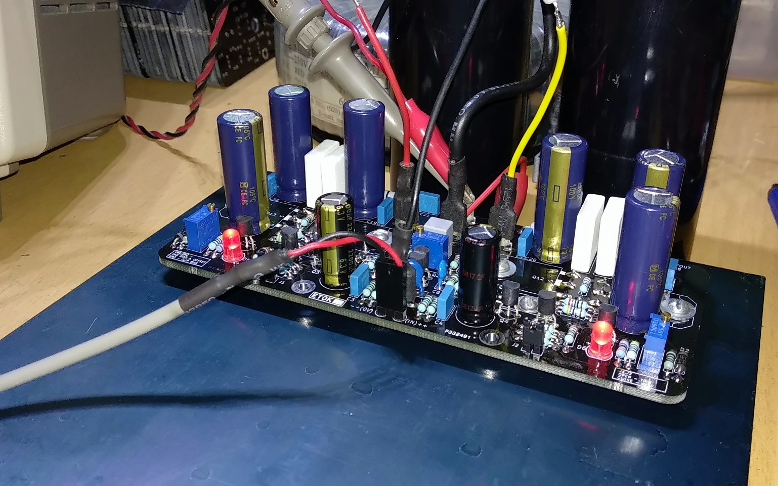

Just assembled and tested a V4H board from the batch. Trimmed as expected and running calm and stable with zero problems.

Shipping paid, crazy expensive as usual(norway). I found a used cheap toroid, 800va 2x42v. Pushing the limits with rail up to 60v.
As for crc psu, go big or go home? I have 8 x 10mF, rated at 80v. Crc with (10+10)mF or (10+30)mF pr rail? How little ripple should we aim at?

60V is too close to the small signal bjts' maximum rating so make sure that in no condition does the ps voltage rise beyond 60V.
10mF+10mF CRC is sufficient. I have run the amplifier from 4.7+4.7 and there is literally zero hum. The huge cans in the picture attached in my last post are only one 10mF per rail i.e. no CRC and it's totally silent with ear on speakers.
