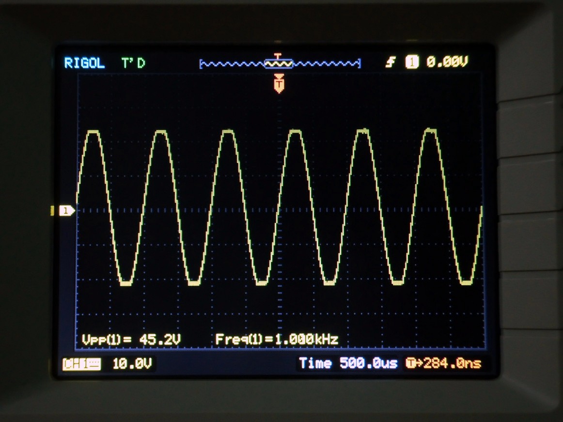

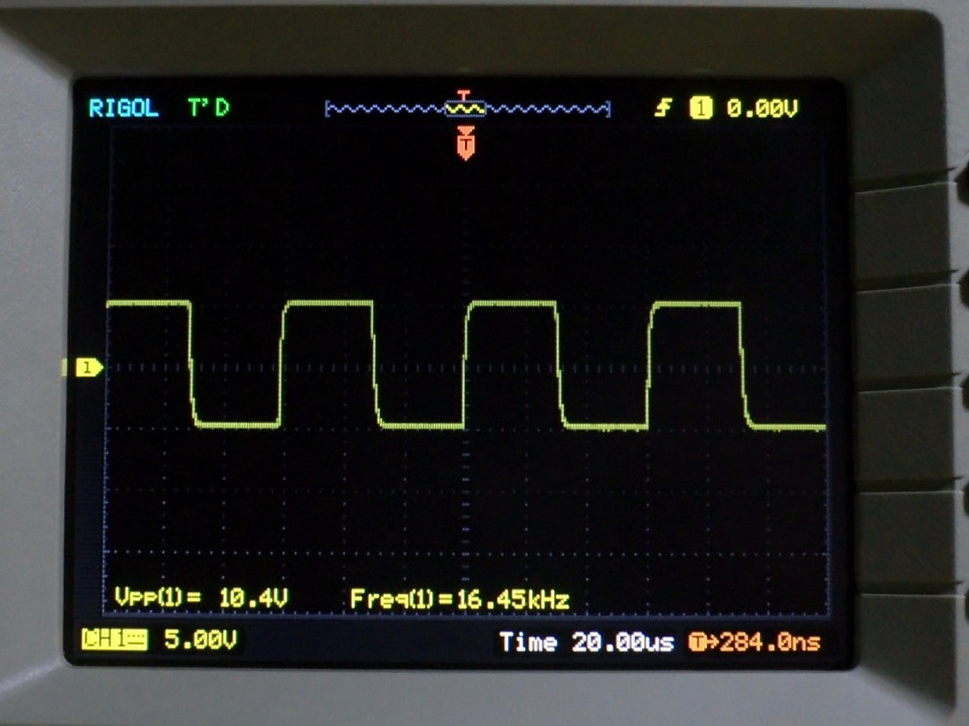

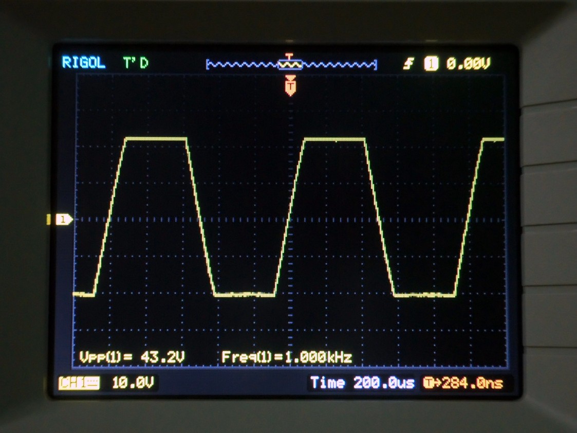

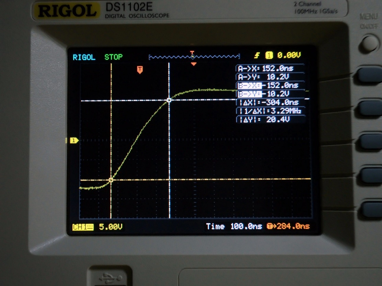

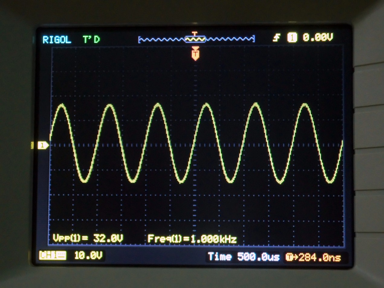

And here are some traces of the V2. All done into 10R load with +/-35V PS, zobel disconnected. VAS bias ~5mA. Offset is very responsive of trimmer control and stays once set.
Pic 1 - 1KHz response
Pic 2 - 1KHz moderate clipping
Pic 3 - 1KHz heavy clipping
Pic 4 - 16KHz square response
Pic 5 - 16KHz 80nS rise time input squarewave measured at 25VPP output. (as in V1.1)
Somewhat surprisingly, the V2 looks faster than V1.1 with about 70V/uS SR with the same PS, input RF shunt and Cdom values though the VAS bias is half, gate resistors and total capacitive load at VAS output is double
. I desoldered the film caps from the rails but that didn't make it go slow. My bet is that the MJEs are playing the role better than the BDs.
Coming later - distortion performance.

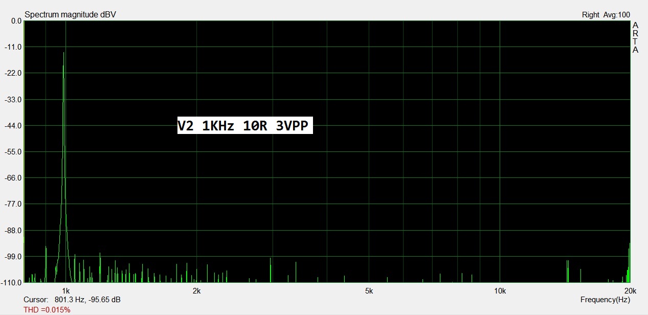

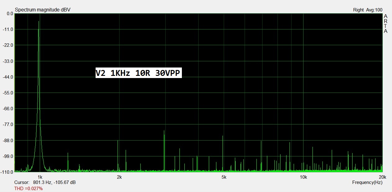

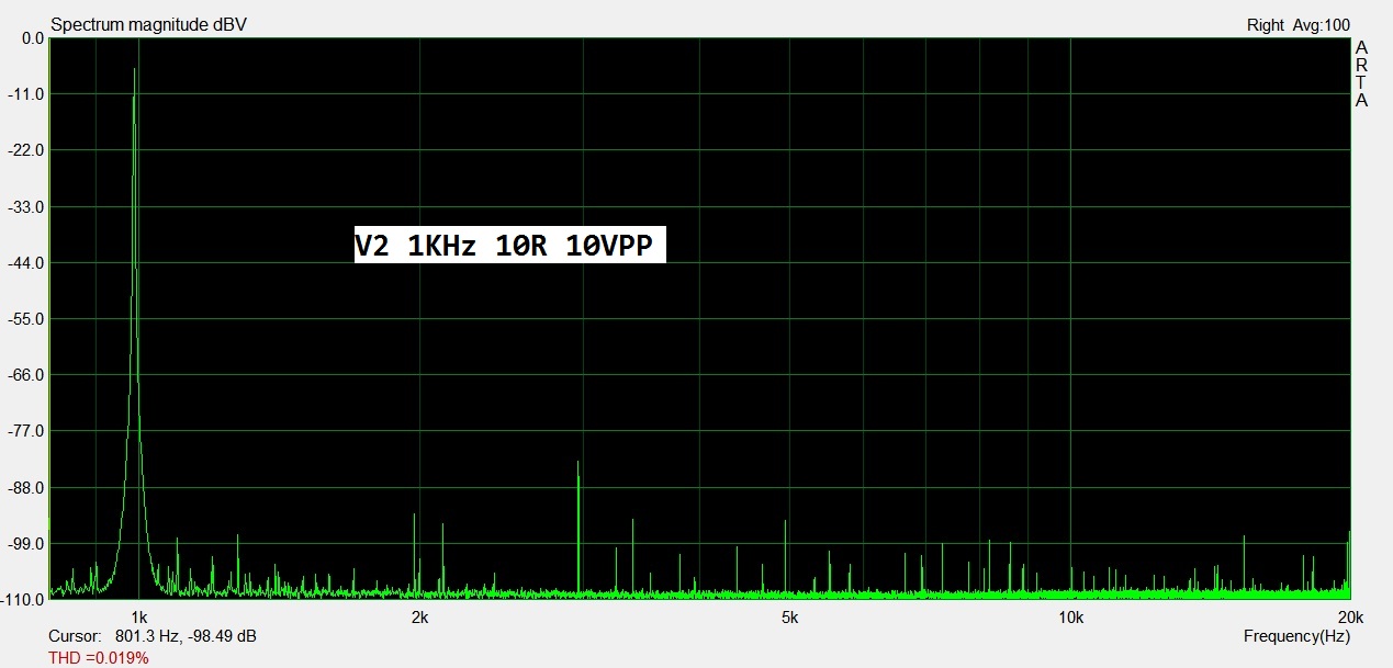

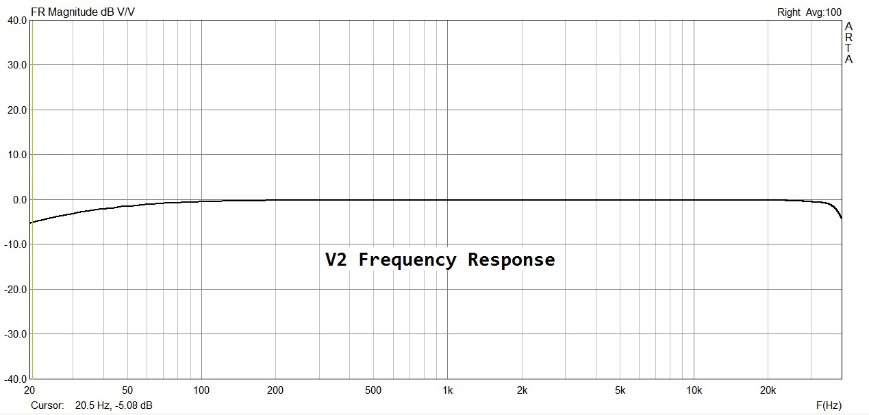

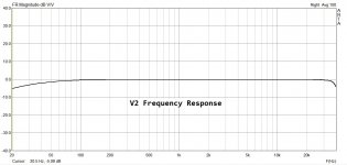

Here are the V2 1KHz distortion measurements done into 10R resistive load. VAS bias is 4mA and total OP stage bias 60mA.
Pic 1 - 3VPP
Pic 2 - 10VPP
Pic 3 - 30VPP
Pic 4 - Audio range frequency response
A bit of surprise, THD is less than the V1.1 at lower power levels. I don't match the FETs, only the input and VAS. Again, it seems the MJE trannies are better than the BDs when THD is considered. But the noise grass is higher with the MJEs, though the amplifier under test is DEAD silent at the speaker.
And about the FR curve, the attenuation in the lower and higher octaves are the artifacts of the soundcard's internal FR limitations. As can be seen, the response is flat.
Cheers!
