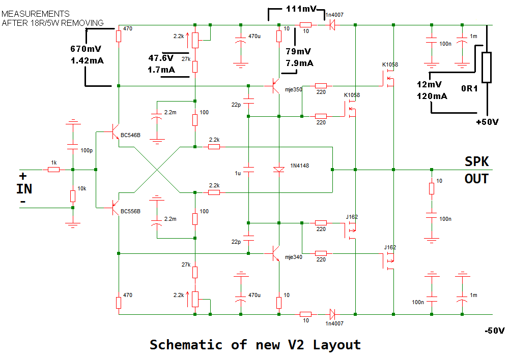

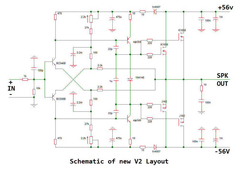

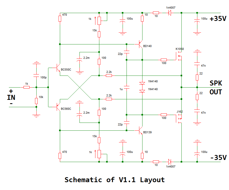

Hello guys.
Here are the schematics for the V1.1 and the new V2 layouts. (sorry for the delay 😱 )
Thanks to everyone for making the PeeCeeBee thread what it is.
Also thanks admin for the warning. Disaster avoided! 😀
shaan

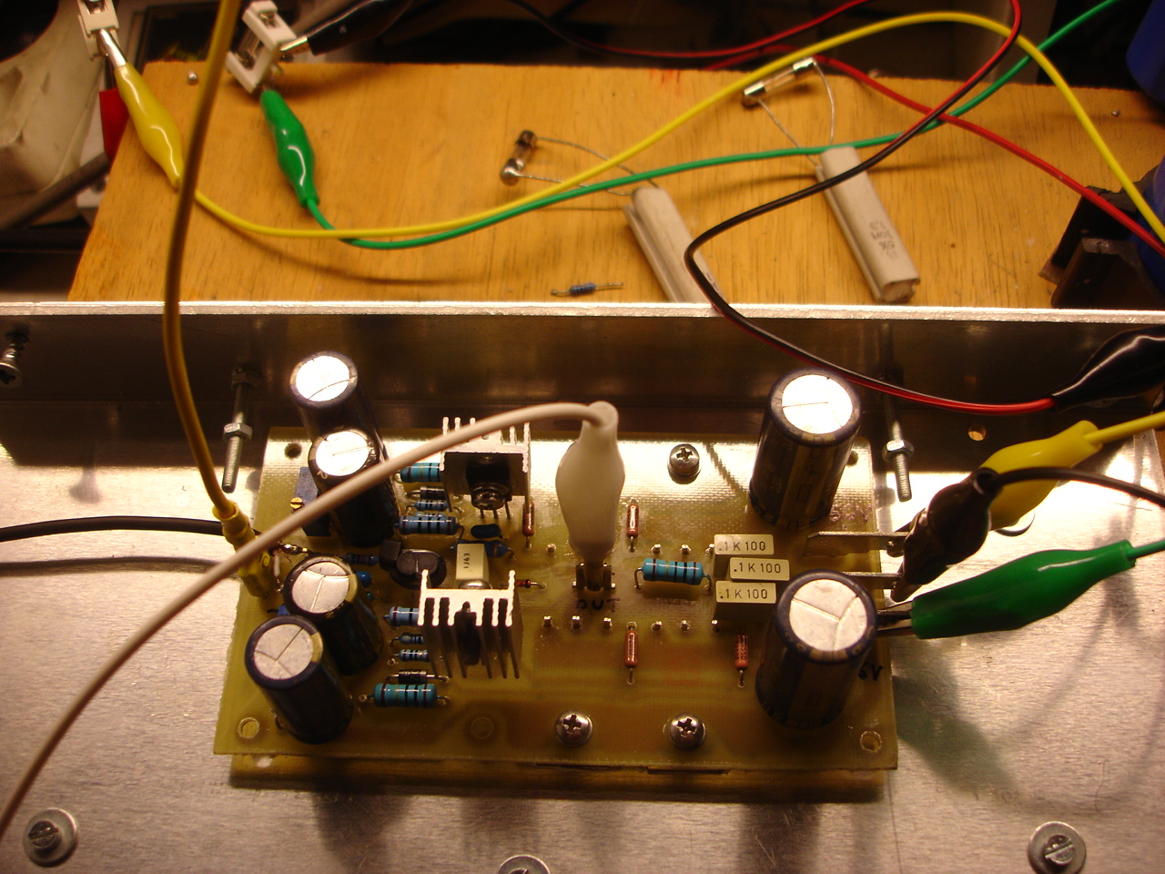

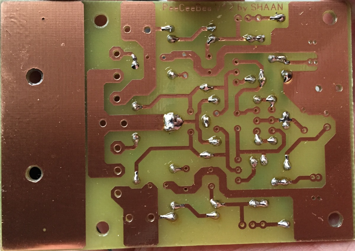

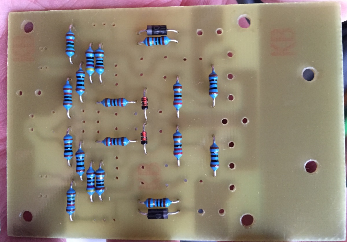

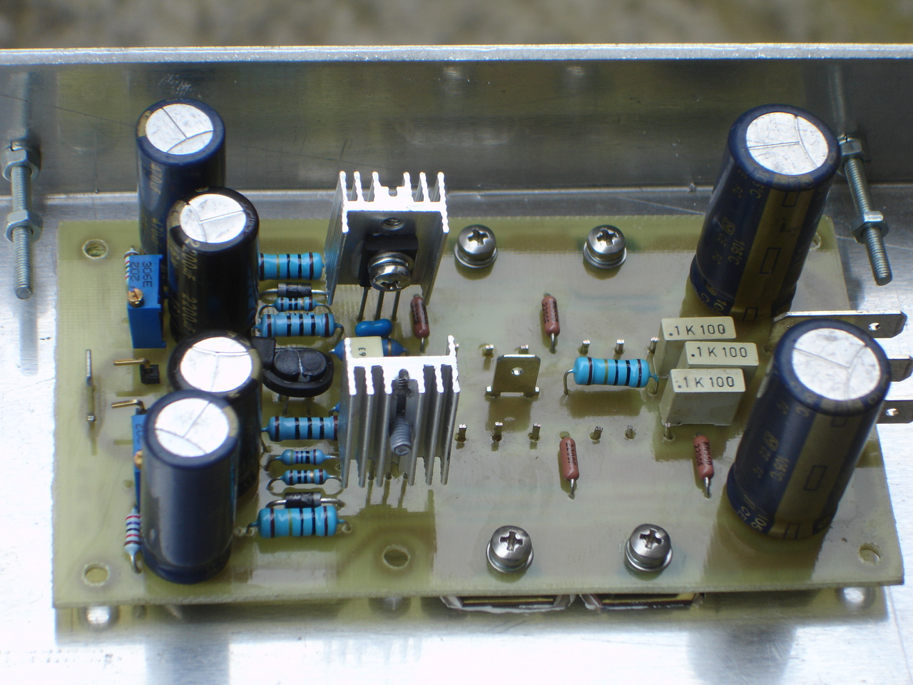

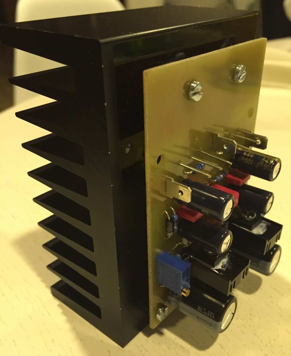

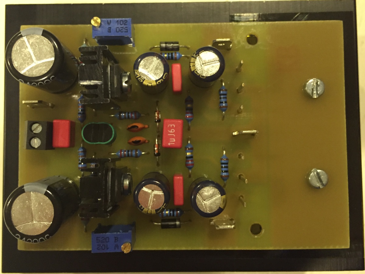

Another PeeCeeBee

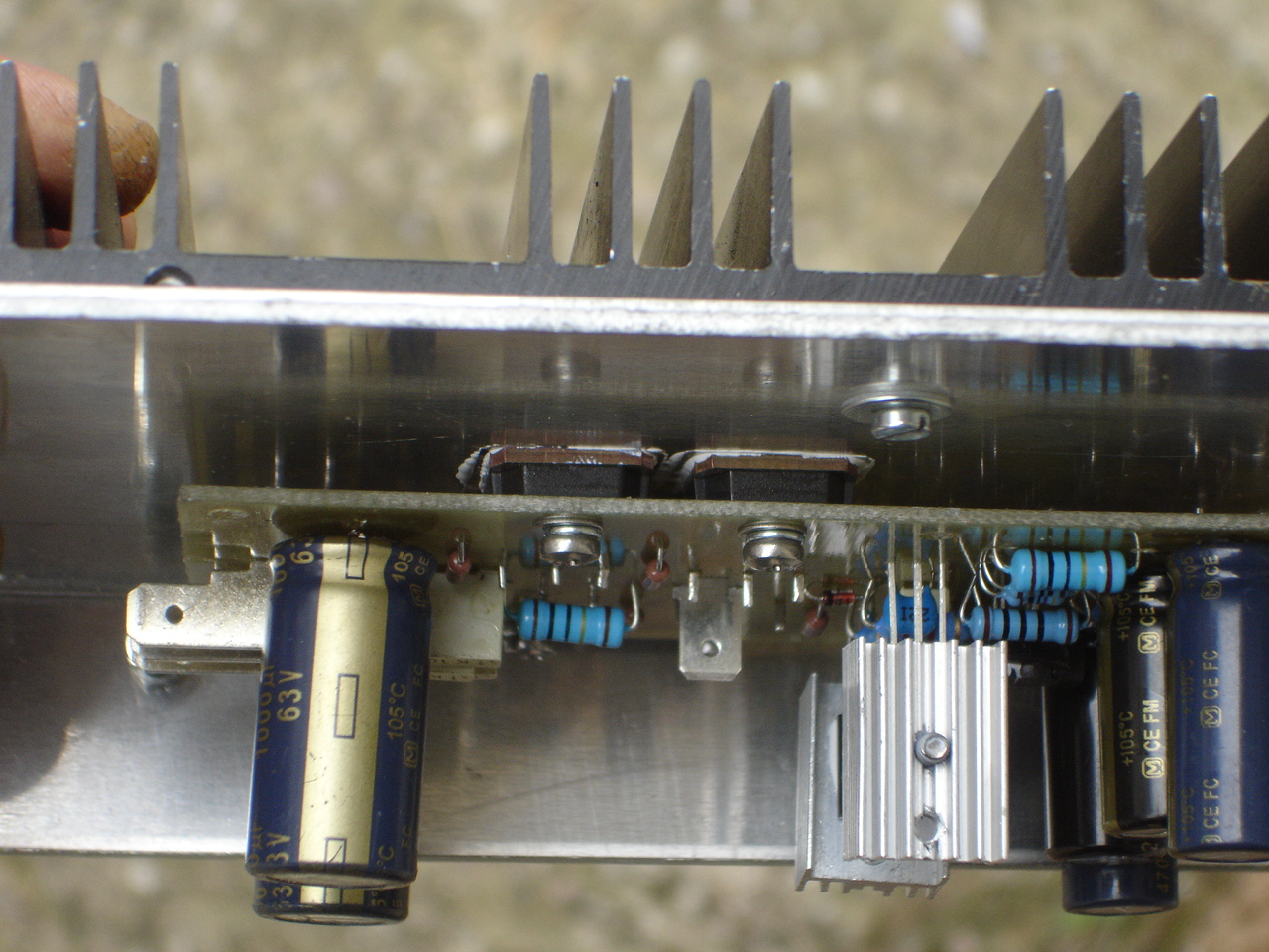

Hi Shaan,
I built this PeeCeeBee V1.1. The PCB is adapted to fit on a drilled heatsink and for some existing components..
Super sound as expected! It runs with +-35V, 20k instead 15k for 70mA quiescent current. It is a nice compact modul. Offset can easily be set to 0V.
Thank you again for the beautiful amplifier.
Regards Olaf
Admittedly not read all 197 pages. Sorry if asking stupid question.
How to reduce the VAS current , say to 3 ma ? Any formula to calculate it?
Thanks in advance.
Hi Pwan. This is a very good question.
As this amplifier uses symmetrical VAS, quiescent current through the VAS devices depends largely on their DC current gain at the PS voltage it is running. In my experience an input-stage bias of between 1mA and 2mA will give you a VAS bias of between 5mA and 15mA, depending on VAS transistor hFE. The symmetrical VAS sometimes scares users as there is apparently no current limiting at the collector node. But in practice the transistors do not explode if small heat sinks are used and if the base current is limited, which we do limit by the 15K+1K current injectors at both sides, which also gives it some flexibility as we can select the effective resistance anywhere between 15K and 16K by turning the 1K trimmers.
Hi Shaan,
Regards Olaf
Hi Olaf. :wave:
Great build!
I hope you corrected the copper trace short at the feedback node that Jay pointed out.
Sounds good? Well of course it does! It's a PeeCeeBee! 😎 😛 😀 😉
Cheers!
shaan
I got it. Thanks much Shaan!
Hi Olaf. :wave:
Great build!
Cheers!
shaan
Hi all,
yes, the short I have corrected during assembly.
And exactly - The sound is perfect because it is a PeeCeeBee:cheers:
There is no problem with the grounding. The amplifier is dead silent.
Regards Olaf

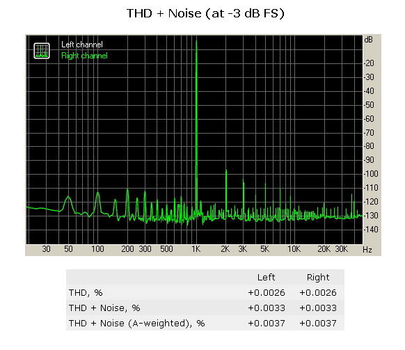

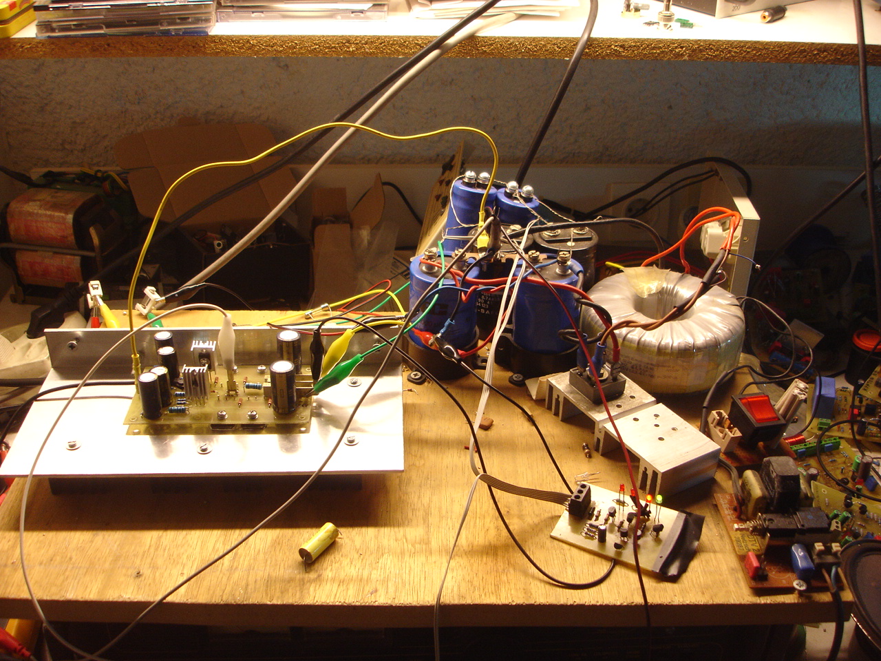

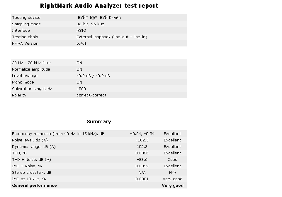

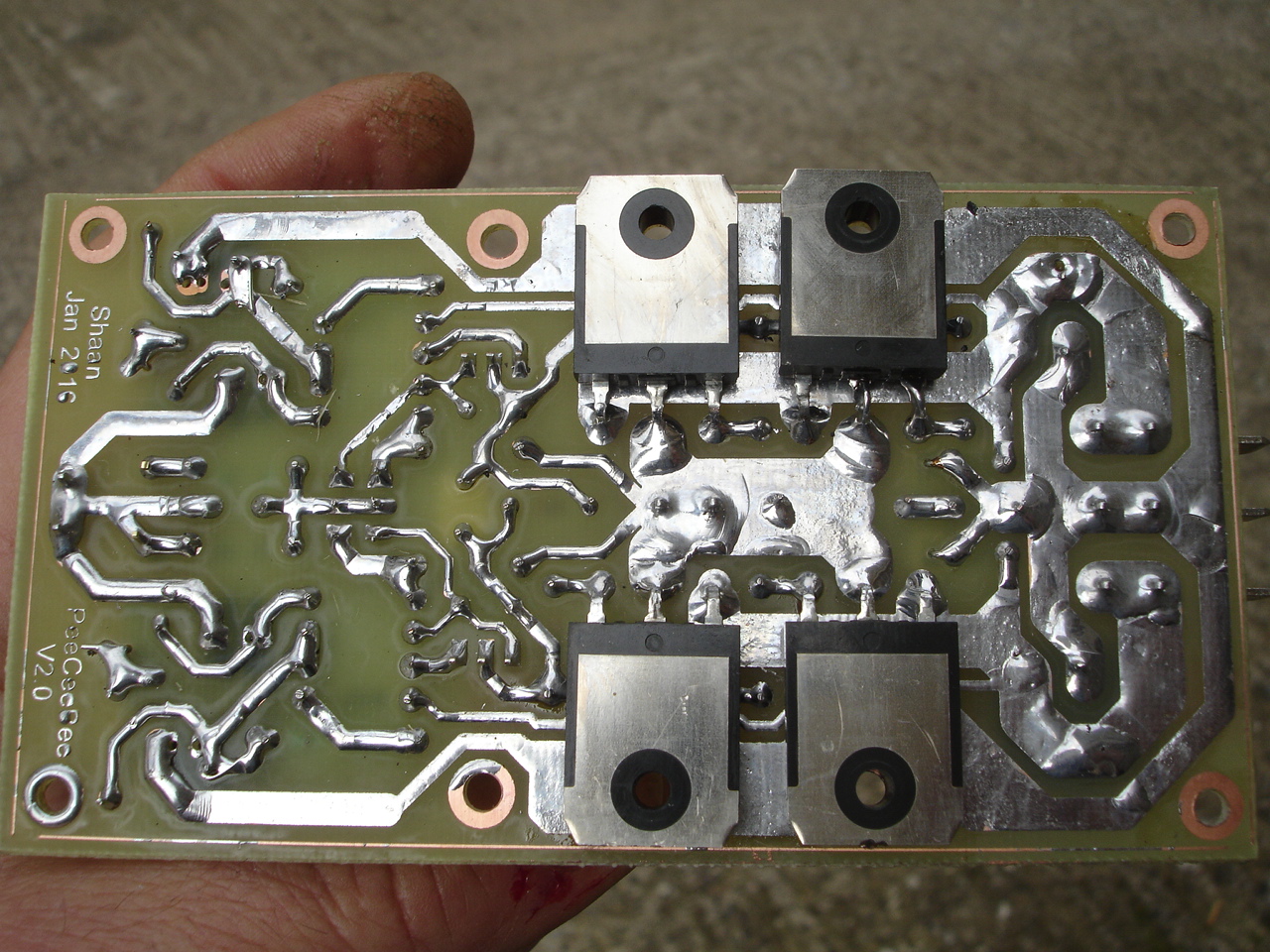

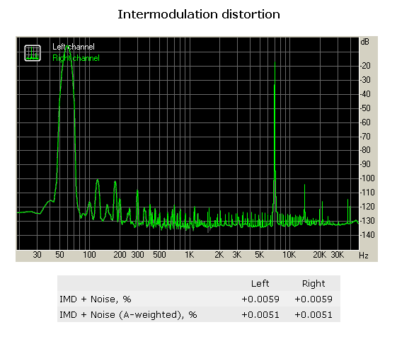

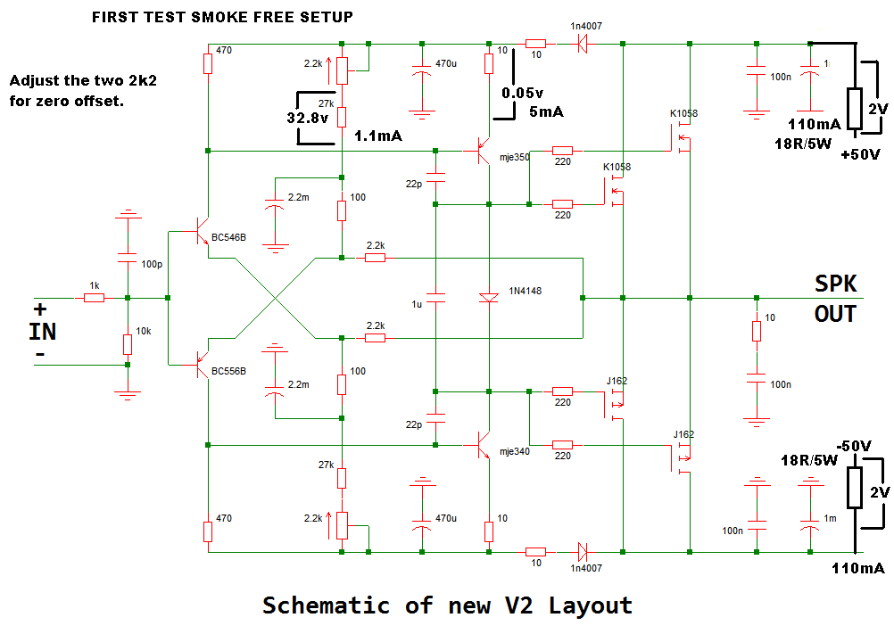

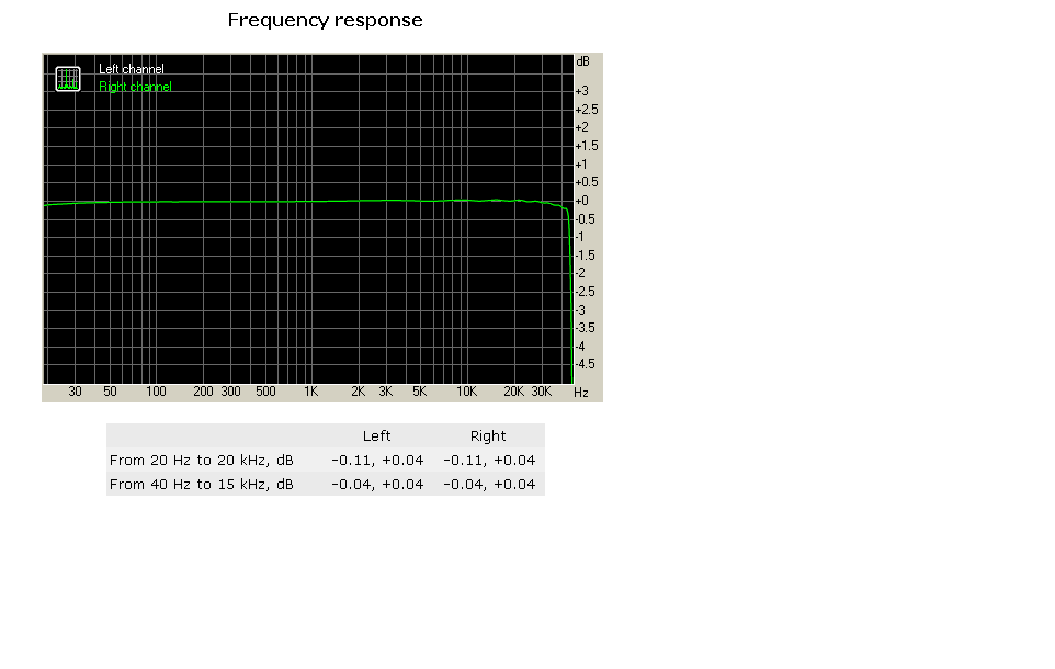

after 18R/5W removing.

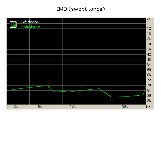

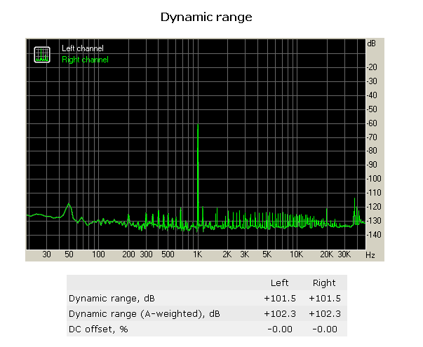

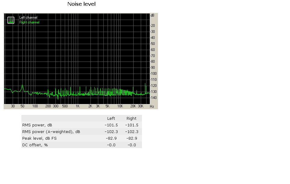

Here the measurements after 18R/5W removing.
The final test tomorrow.
How this play?
Fantastic!!!!!!!!!!!!As expected🙂
No one must lose this simple but no small amplifier,just my opinion.:yes:
:up::up:
That's some killer tinning!!!
I haven't better way copper protection....this is a diy pcb.
BTW The first PeeCeeBee absolutely hum free! The separate inp GND connection do the job well.
I want to thank member <<coolwater>>,many of the parts on this the board is from his own donation🙂
