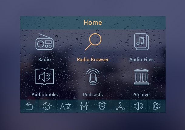

New version (Malevich Edition) of the Peppy Player was released.
The source code is available here:
https://github.com/project-owner/Peppy
The disk images with the new release are available here:
https://github.com/project-owner/PeppyPlayers.doc/wiki/Disk-Images
The upgrade to the new versions of the OS (Bookworm) and other software (e.g. Python 3.11, Pygame 2) caused many changes in the player's code. As a result of these changes the following functionality is not available in the player anymore:
Here are the main features of the new release:
- Implemented Radio Browser mode which allows to browse through 40K+ online radio stations.
https://github.com/project-owner/Peppy.doc/wiki/Radio-Browser
- Added toppings to the Spectrum screensaver:

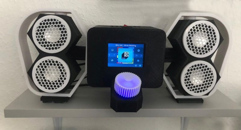

Here is a new entry in the Gallery - Modern Futuristic Radio by HappyFly:
https://github.com/project-owner/Pe...y#modern-futuristic-radio-by-happyfly-germany
