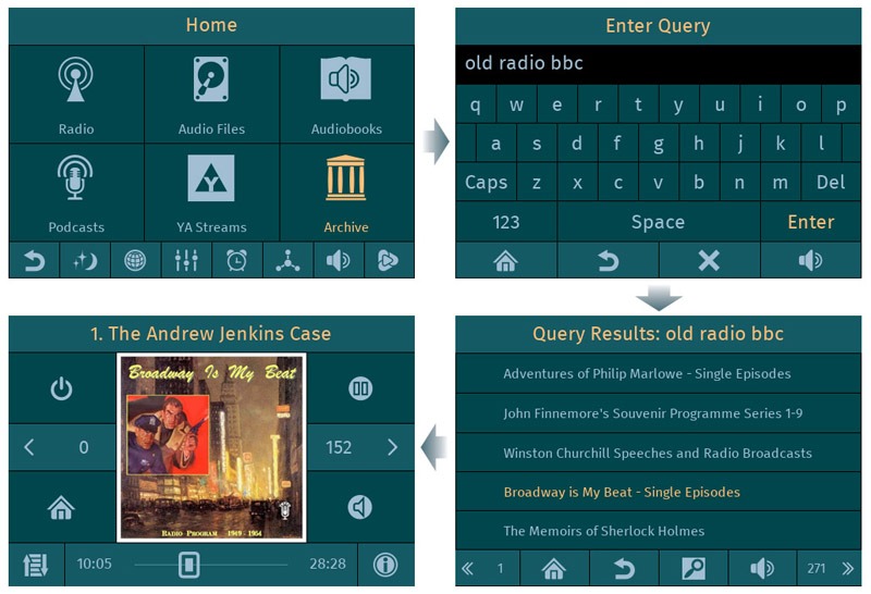

- Added new mode - Archive. It allows to search and play audio files from the Internet Archive web site.
https://github.com/project-owner/Peppy.doc/wiki/Archive

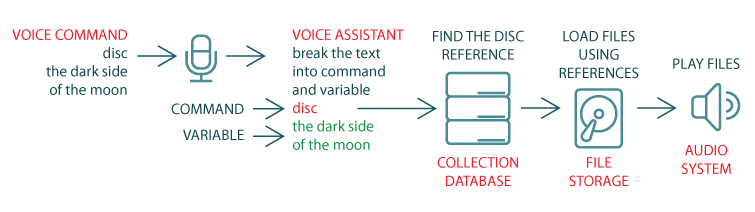

- Refactored the Voise Assistant. Now it can work offline. By default two language models have been provided for English and German. The models for the other supported languages can be downloaded from the Internet using the Configuration Web UI.
Using the voice commands it's possible to search and play files from a file system and collection.
https://github.com/project-owner/Peppy.doc/wiki/Voice-Assistant

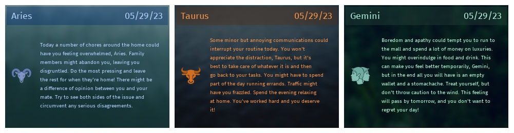

- Fixed the Horoscope screensaver:
https://github.com/project-owner/Peppy.doc/wiki/Horoscope

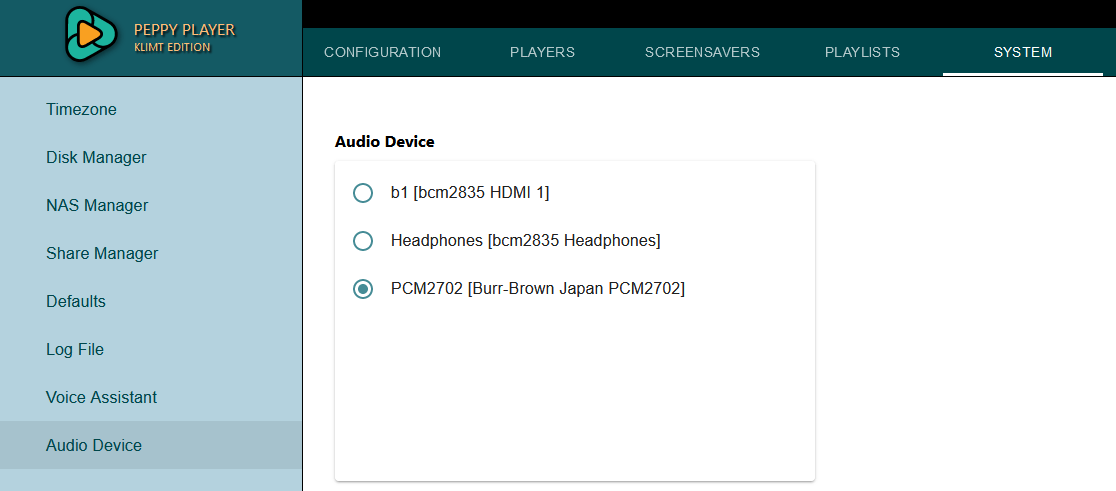

- Implemented default ALSA device selection.
https://github.com/project-owner/Peppy.doc/wiki/Audio-Device
