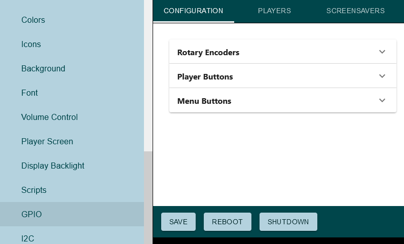

- Added a Jukebox functionality. The Jukebox mode can be used either for players with displays without touch functionality (with hardware buttons for menu selection) or players without display at all (e.g. radio with fixed stations)
- Refactored configuration of the GPIO buttons. Implemented GPIO Menu buttons.

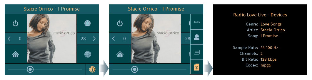

- Implemented the Radio Info screen.
