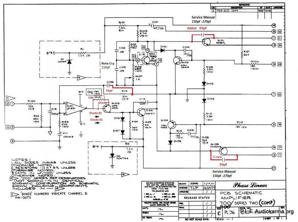

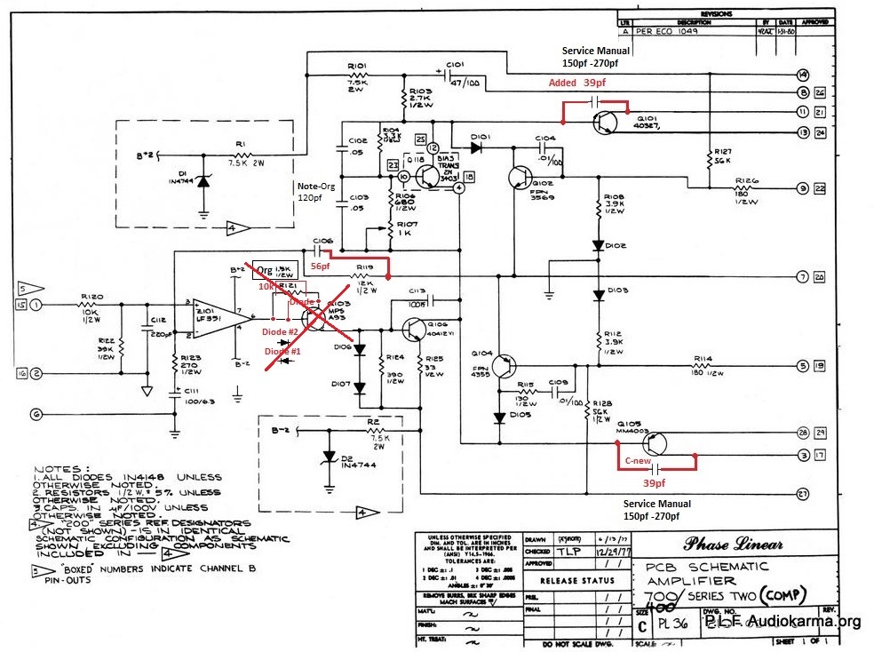

The 700II in the drawing resistor installed R105/R204 , 220k installed from RCA input to ground? both my 700 II don't have it installed. Should it be installed?

"Ed said this
700 series II fully comp amp PL-36 pc boards. This involves removing the 120pF cap (C106/C206) that is in series with the 12K ohm resistor (R128/R129) next to Q106/Q206 and installing a 56pF cap in parallel with the 12K ohm resistor. This will greatly reduce the classic crossover notch and THD levels (particularly at lower volume levels) that you see with many Phase Linear amps (at 1kHz, 1 watt, 8 ohms). In which case the bias should be adjusted to approximately 385mV (which also works better when the 10 ohm resistors are nearer the nominal value of 10 ohms)."

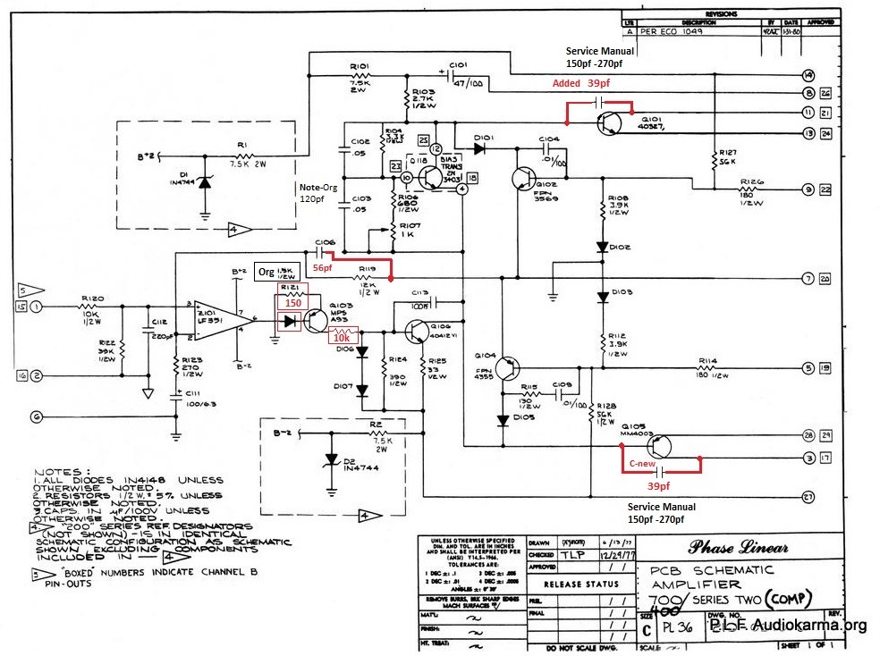

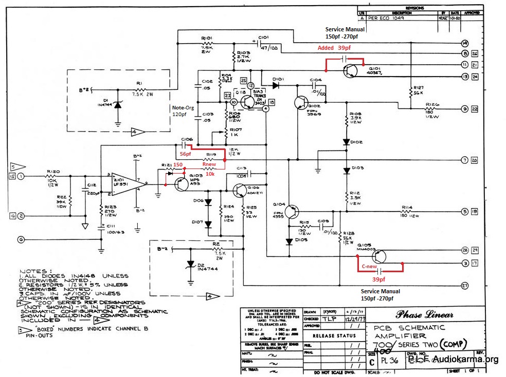

After reading this I edit the drawing and Don't know what he meant do you think this correct?????

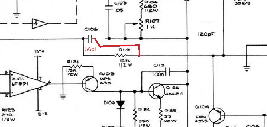

That’s what he meant. But the correct value for the cap is really 27 pF. 120 is WAAAAAAY too much. I still prefer to run that cap off the VAS instead of the output (ie, in the original position) and use a full comp output which lets you use ANY bias setting without oscillation, so you can decide for yourself how hot you want to run it. And putting a 10k from the output, and 150 ohms to ground on the emitter of that MPSA93 goes a loooooong way toward making it stable. Gets rid of the excessive open loop gain, and the local feedback does some of the distortion correction so overall distortion is no worse. And put a reverse protection diode on the base emitter of that tranny, too.After reading this I edit the drawing and Don't know what he meant do you think this correct?????

ThanksThat’s what he meant. But the correct value for the cap is really 27 pF. 120 is WAAAAAAY too much. I still prefer to run that cap off the VAS instead of the output (ie, in the original position) and use a full comp output which lets you use ANY bias setting without oscillation, so you can decide for yourself how hot you want to run it. And putting a 10k from the output, and 150 ohms to ground on the emitter of that MPSA93 goes a loooooong way toward making it stable. Gets rid of the excessive open loop gain, and the local feedback does some of the distortion correction so overall distortion is no worse. And put a reverse protection diode on the base emitter of that tranny, too.
1. Ed said 56pf for c106 so what's the different between 56pf versus 27pf? and org 120pf?
2. also pleases check the drawing and the Op-amp that you suggested, is this correct?
will I do this this? I don't know its a big change, So what will this improve overall?
(I was during some testing w a SQ wave I'm getting some over shooting, more on the leading edge, would this change help remove this?
Note- w no output connected including the RC output network to Ground it has a Perfect SQ wave but when the Relay kicks in than I get the overshooting, Testing before and after the speaker protection board turns on )
3. (later when I'm done,,,, I'm going to add a thread w pics on how to convert from quad to Full, since I'm doing more than one , I want to make updated drawing and have good Pictures and than have a step by step temp plate, w less thinking on the next one But a lot having double checking)
4. what about adding just a blocking resistor?
Thanks Steve
I run 27 pF for C106, but leave it in its original position. 56 pF may be the correct value in the new position. Almost anything smaller is an improvement over that 120 pF.

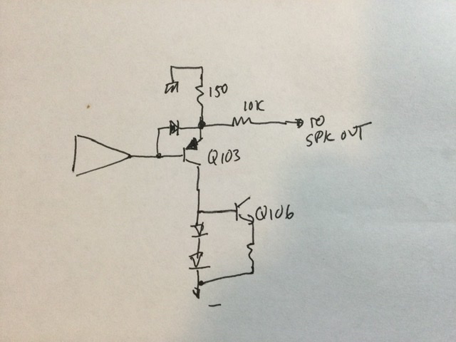

You have the added 10k resistor in the wrong place. It goes from the emitter of Q103 to the amplifier output. The idea is to provide local feedback around two gain stages inside the overall feedback. This is the way it’s done in the Crown and Peavey amps which use the same basic circuit - and why they are more stable. Also, the diode does not go in series with the base of Q103, it goes in inverse-parallel with the base-emitter. And you have it backwards which wont work at all.
ThanksI run 27 pF for C106, but leave it in its original position. 56 pF may be the correct value in the new position. Almost anything smaller is an improvement over that 120 pF.
Diode makes know sense to me? and its in Parallel w resistor?

Any cap used for frequency compensation in any position needs to be a class 1 ceramic, or better. These days, you may have problems finding C0G types in >100 volt. Even 15-20 years ago it was getting tough, so when I was stocking my lab and found 500 volt micas for a quarter, I loaded up on the values I use. Now I don’t have to resort to using 1 kV Z5U’s for Miller caps anymore. Since they drop capacitance rapidly with increasing voltage, they need to be run way the hell above rating to keep them linear. They are ok as bypass caps and snubbers. Leave them there on the vbe multiplier and on the protection circuit - they don’t hurt anything, the voltage on them is low and doesn’t change much with respect to the signal. Polystyrene caps are good (better than mica by a long ways - much lower loss) but they are even harder to find, expensive, and very fragile. I’m not sure I’d trust my “anti-oscillation caps” in an amp running off 200+ volts driving expensive speakers to them. One mechanical failure can be catastrophic. And I’ve seen the leads break off of the stupid things.
