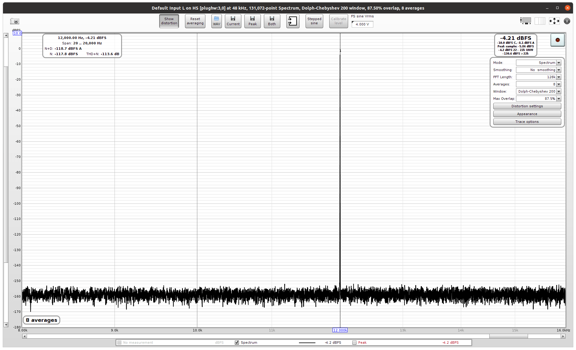

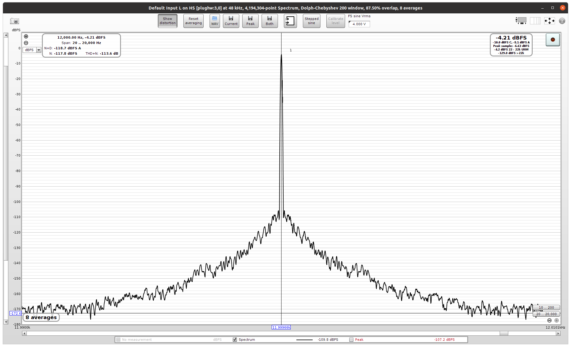

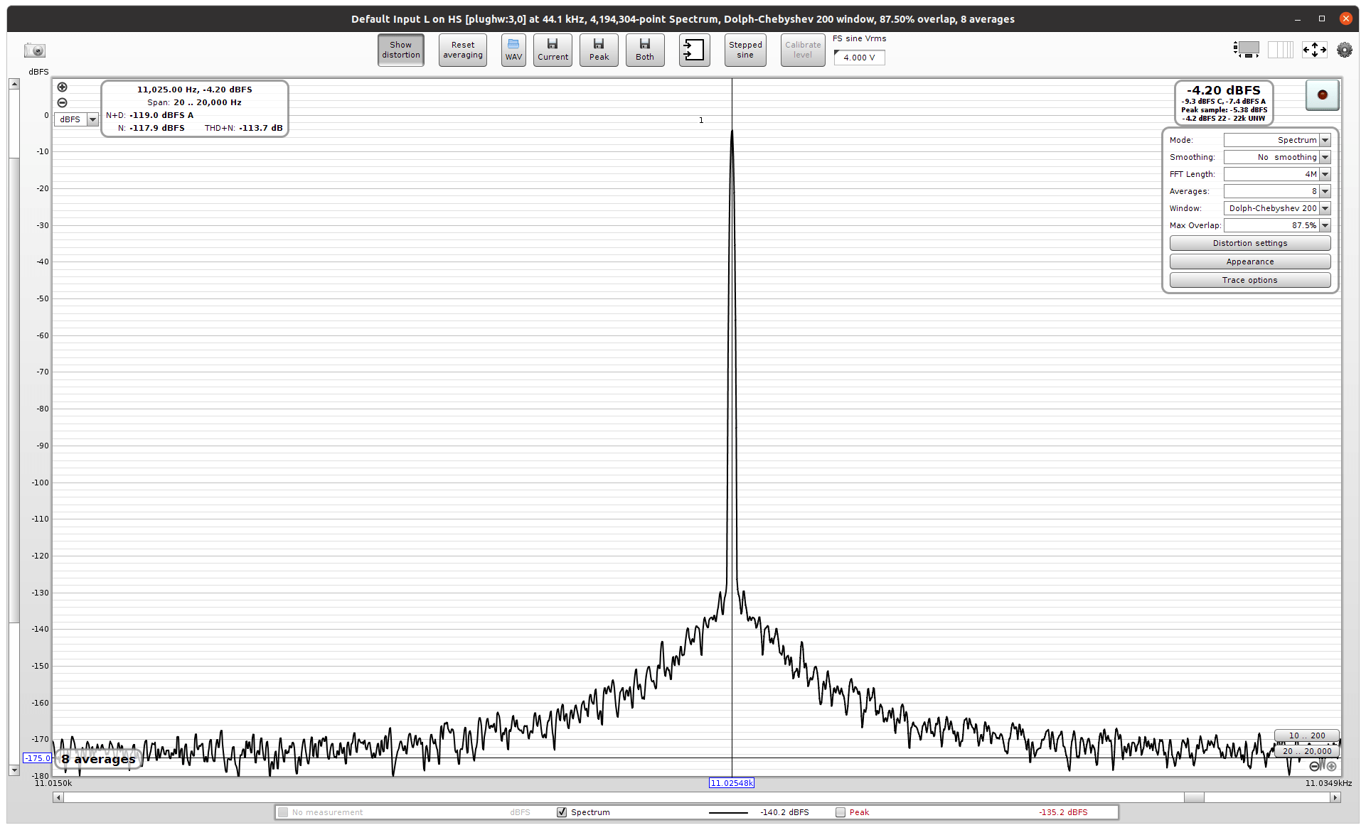

I used my own boards for the measurement:
First 11.025k sine of -1.5dBFS at 44k1. This uses 22.5792MHz ECS-2520MVLC clock having phase noise in datasheet as -89dBc/Hz @10hz (https://www.mouser.fi/datasheet/2/122/ECS_2520MVLC-1903379.pdf).
Note the horizontal scale (+/-10Hz). Not bad for a $1 clock.
Next up 12k sine of -1.5dBFS @48k. This uses a 24.576MHz NZ2520SDA clock with presumably lower close-in phase noise.
Clearly better but whether or not audibly better is another story.
Besides clock there are other factors that affect phase noise. One is Vref. In my AK4490 DAC Vref is fed by LT3042 regulator (separate L/R).
Here is the same measurement as above but with slightly altered Vref implementation.
Clearly much worse and a much bigger impact than clocks.
The only difference between graphs 2 and 3 was that Cset capacitor of LT3042 was changed from 22uF/15V tantalum polymer to 22uF/25V X5R. The result is understandable as Cset affects the 1/f noise of LT3042. Input and output capacitors of LT3042 are not critical for Vref phase noise.

Is it? The X5R capacitor's capacitance will be somewhat reduced due to its non-linearity, but only slightly at 20 % of the rated voltage. Is it the microphony that makes one 22 uF capacitor so much worse than the other? If so, then it seems to contradict @gerhard's statements, he uses X5R capacitors in sensitive equipment that gets launched into space without running into microphony issues.The only difference between graphs 2 and 3 was that Cset capacitor of LT3042 was changed from 22uF/15V tantalum polymer to 22uF/25V X5R. The result is understandable as Cset affects the 1/f noise of LT3042. Input and output capacitors of LT3042 are not critical for Vref phase noise.
I was a bit surprised of this myself as just measuring the noise at LT3042 output did not reveal any difference.
And naturally the real-life progression was the opposite. First I had the X5R on Cset. Phase noise looked worse than in my ES9038Q2M dac. After some iterations I found that the cure is to use a tantalum polymer at Cset (which I already had on ES9038Q2M).
