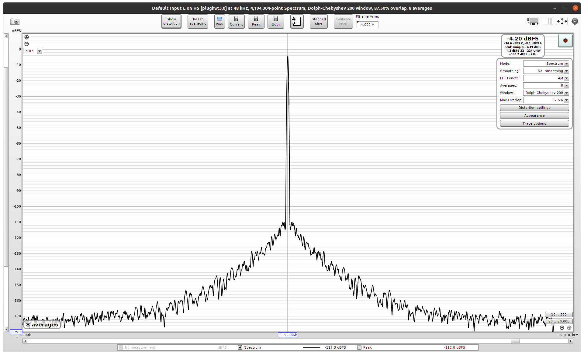

I made still some further tests. First I changed the Cset capacitor to 10uF/50V X7R. This has over 80% capacitance left at 5V.
Here is the same measurement as earlier. Not much improvement to X5R.

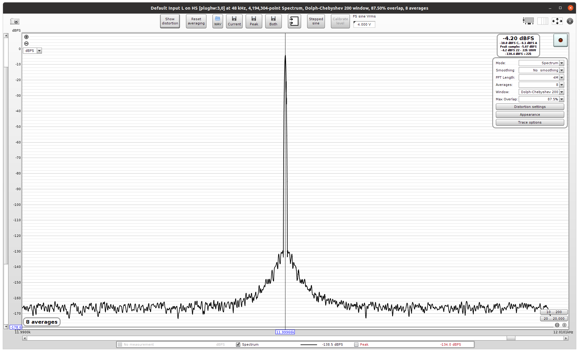

Then I wrapped the dac board with speaker polywool and placed it within a steel kettle.
Clear improvement. About as good as tantalum polymer.
So piezoelectric microphony is a very probable cause. And it seems that Class II capacitors can be used in LT3042 Cset provided that proper shock mounting or noise damping is implemented.
Anyhow IMO all this just proves that Vref implementation is very critical for DS dacs. Even small imperfections can easily overshadow the potential benefits from low close-in phase noise clocks.

You can always tap the board with a finger while looking at the regulator output with a scope...So it seems that the bias voltage dependent capacitance of X5R is not the issue. The cause may well be piezoelectric microphony. I still find that quite odd since my workplace does not have any significant LF (or RF) noise sources. Shock mounting the DAC board seems like an overkill.
Yes, that's exactly it. If VREF is microphonic, in a quiet lab you'll get noise skirts. If you play music next to it though, it'll pick it up and distort the signal.what regards LT3042 reference vibration sensitivity, we had discussed of that already:

That will also stop air drafts so it will remove temperature-dependent drifts (ceramic caps have pretty large tempco). If a cap connected to a high impedance node changes its capacitance value due to whatever cause, conservation of charge applies. So the cap still has the same charge, but a different capacitance value. Q=CV, so this results in a voltage on the node being decoupled. It should be small, because X7R's tempco is designed to null around 25°C, and it will be very low frequency, so probably not what's happening here. Piezo is the most likely explanation, but that can also come from thermal expansion of the whole board under the influence of random air drafts, that will stress and squeeze the cap too... Anyway, after observing the effect of tapping the board on output voltage, I'd recommend blowing some air on it. A while ago I measured a bunch of cheap clocks for jitter, and a makeup remover cotton disk stuck on it to neutralize air currents made a significant difference in frequency stability...Then I wrapped the dac board with speaker polywool and placed it within a steel kettle.

I don't believe that. On a low impedance node like a power supply, the regulator will absorb any microphonic current from the cap. I'd rather bet on the cap having different inductance, ESR and value, and shifting around the resonance peaks with the cap inside the crystek. Or maybe it changes how much HF noise gets in, or how much clock leaks out. You could scope the clock's 3V3 with a X10 probe, tiny ground clip, and check for ringing. A power supply should not ring. If it does, a small resistor in series with the decoupling cap could tame it, but it has to be mounted with very low inductance (is, replace a SMD 0805 cap with a 0603 cap and 0802 resistor in series)...

Not so sure that's exactly the case. The regulator can attenuate output voltage variations, but not completely. Also IIRC LT3042 datasheet says larger output caps can improve transient response at the expense of reduced regulator bandwidth. If a cap improves transient response, then not all it is doing is being instantly 'absorbed' by the regulator.

Piezo effect creates a current, so the resulting voltage is proportional to node impedance. Suppose 33mOhm output impedance for the reg, and 33k resistor on VSET pin, that's a factor of 1 million worse for the cap on the VSET pinNot so sure that's exactly the case. The regulator can attenuate output voltage variations, but not completely. Also IIRC LT3042 datasheet says larger output caps can improve transient response at the expense of reduced regulator bandwidth. If a cap improves transient response, then not all it is doing is being instantly 'absorbed' by the regulator.
The output impedance of the reg will increase at high frequency though, so if the board is vibrating at 1MHz, then perhaps.
