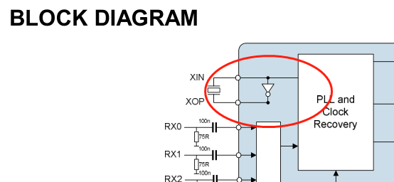

How did you decide to try an external clock source for WM8805? Did you just decide to give it try? Did you have some particular reason that made you think it would probably help?
In other words, what was your state of mind in trying an external clock to fix the jitter problem? Just tried it to be thorough, or maybe you tried it because someone told you it would help? Maybe you simmed it and that suggested an external clock should help? What prompted you to try it?

As a lurking dummy I can take a stab at that - there is an inverter inside the WM8805 which can be used as the foundation for a clock oscillator - see below.
As shown, the oscillator is composed of the crystal - external to the chip - and the inverter which is the downward pointing triangle with the circle at the bottom. The shown configuration is problematic presumably because the inverter is subject to interference from the rest of the IC.
The solution is delete the crystal and instead use a self-contained crystal oscillator module (aka canned xo) that has a logic level output signal, connecting its output to the XIN pin. With a full logic swing clock signal coming in, the relative levels of interference will be much lower.

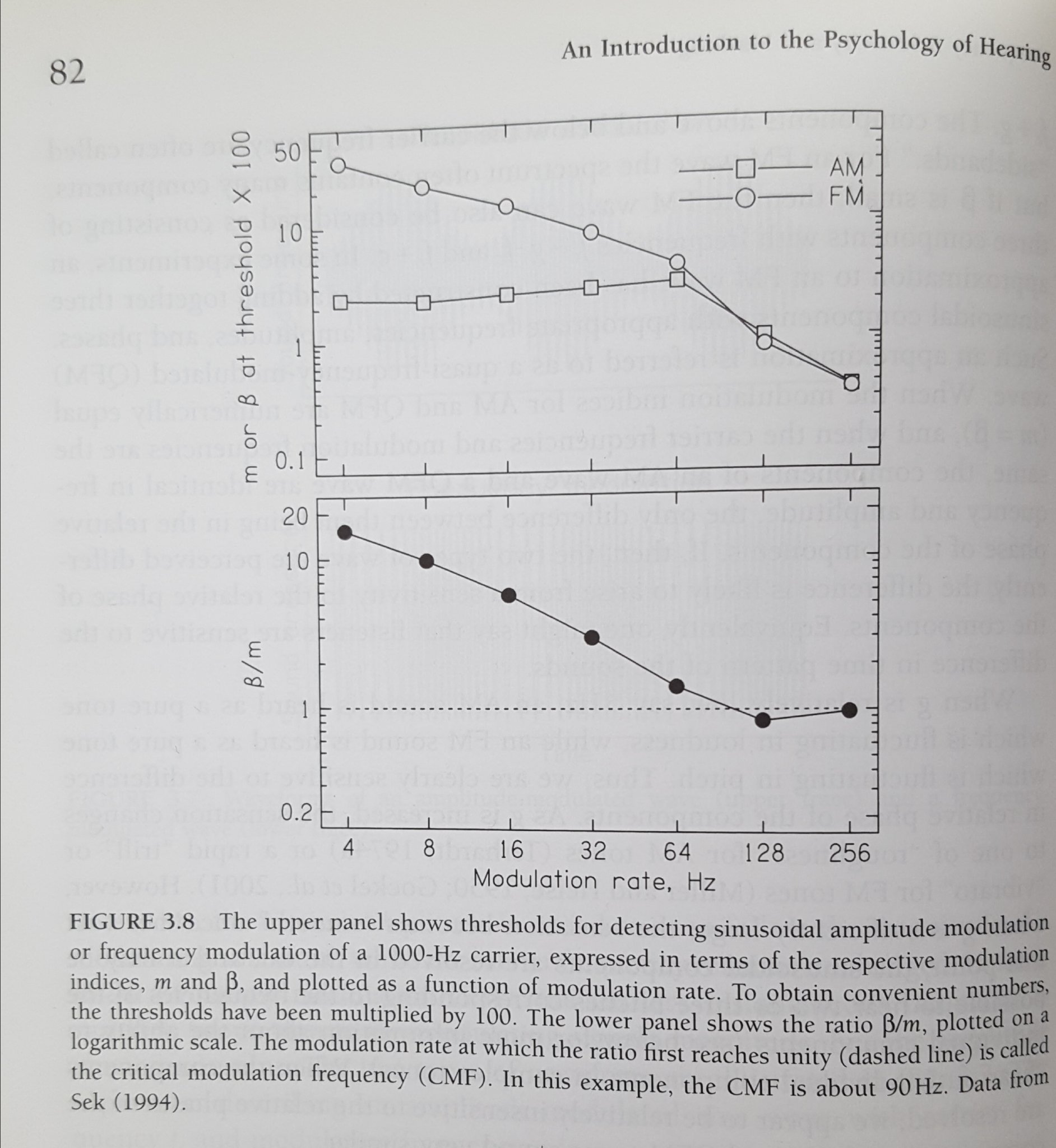

Even though this thread is mainly about measurements, I hope it is acceptable to write something about audibility.
I found this graph in Brian C. J. Moore, An introduction to the psychology of hearing, fifth edition, Elsevier, 2004, ISBN 0-12-505628-1. It shows that for modulated sine waves, close-in amplitude modulation is more audible than close-in phase modulation. This holds up to about 90 Hz frequency offset for a 1 kHz carrier.
The graph shows at what modulation index the modulation got audible. The phase modulated signal actually consisted only of the carrier and the first upper and lower sideband tones.
The article Moore got it from is A. Sek, "Modulation thresholds and critical modulation frequency based on random amplitude and frequency changes", Journal of the Acoustical Society of Japan (E), volume 15, pages 67...75, 1994.

I'm on the phone so pardon my french...How did you decide to try an external clock source for WM8805?
An oscillator is made with a crystal and an inverting amplifier.
This inverter has a logic gate symbol but it isn't, usually it is 74hcu04 which is used as an analog inverting amplifier. It can also be a transistor, for example colpitts, clapp oscillator.
The crystal in the feedback of this amplifier makes it oscillate at the desired frequency.
Signal on crystal is low amplitude sine wave, tens of mV tops, high impedance, very vulnerable to noise. For example the traces between the crystal and the chip can pickup noise from nearby traces. The crystal is in a metal can but it is not grounded so noise can couple into it too. It made different jitter with the crystal on top side or bottom side of the board.
Also modulating the power supply of the inverter will change the frequency. So it integrates its supply noise into phase noise.
It really is an analog circuit and the best place to put it is stand alone in a shielded can with the crystal (hence "canned XO" with XO meaning crystal oscillator).
The worst place to put it is in a big digital chip making lots of noise, with traces carrying I2S close to the sensitive amplifier input...
So to answer your question when I saw suspicious jitter, the chips internal crystal oscillator was the primary suspect.
Since I kinda expected this could happen I had designed the board to allow clocking WM8805 from the ES9023 XO. With a divide by 2 flop since WM can't run on 50MHz.
The output of a canned oscillator is high level low impedance 3V3 LVCMOS so it is much more robust that the millivolt signal on the crystal. Even better when buffered with a logic gate so noise can't couple into the oscillator through the output.
