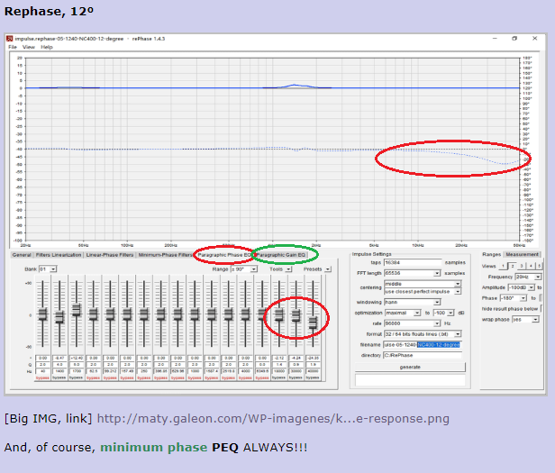

Rephase, 12º
[Big IMG, link] http://maty.galeon.com/WP-imagenes/...with-Hypex-NC400-12-degree-phase-response.png
And, of course, minimum phase PEQ ALWAYS!!!

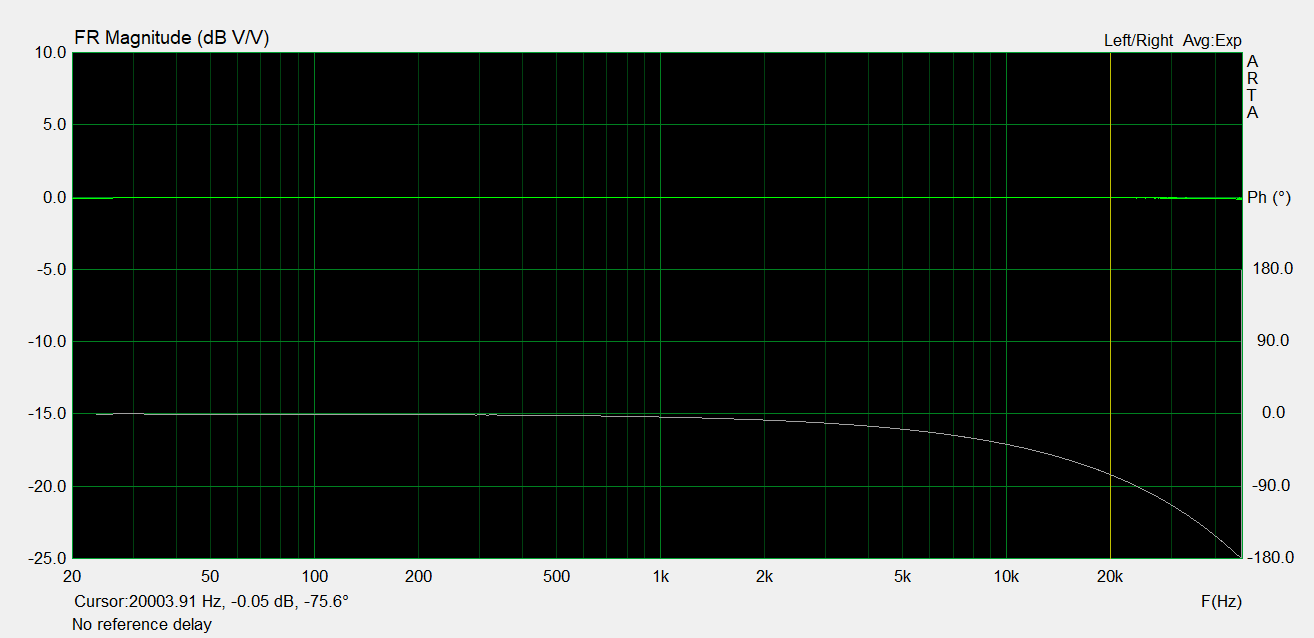

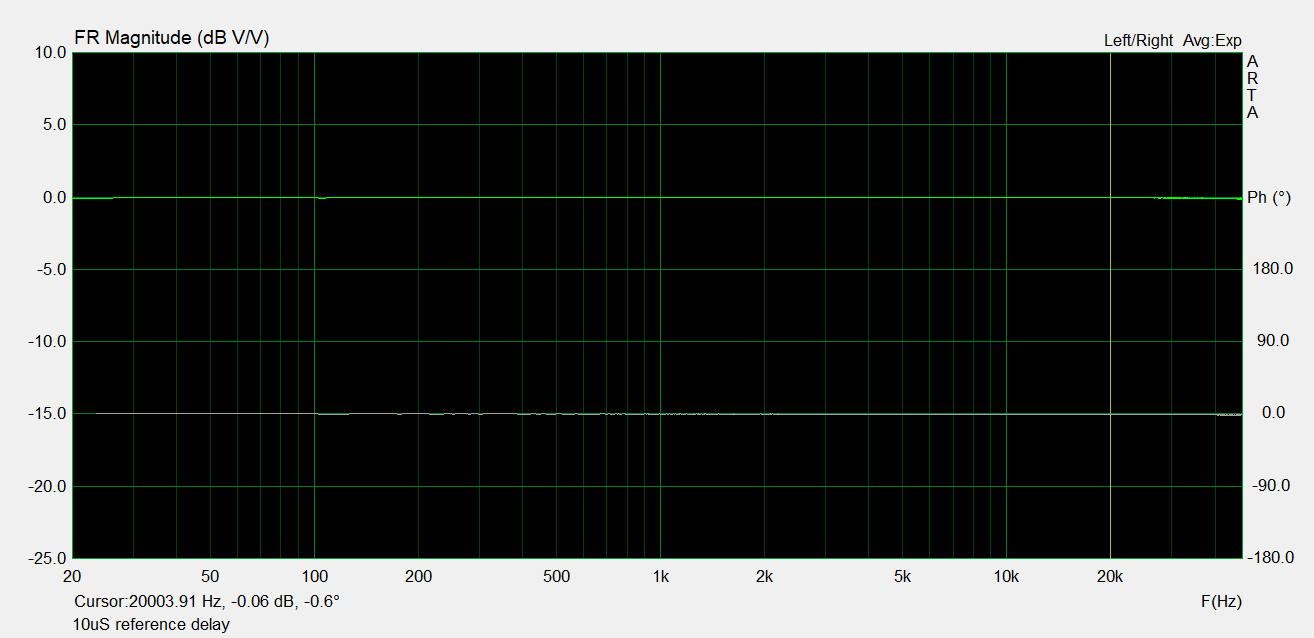

In addition to possible AES-17 filter usage, there is also DUT latency to consider. Frequency-independent effects can confuse folks evaluating phase response graphs where the test conditions were unknown. (A proper test setup is not as straightforward as it might seem.)
The NC400 has approximately 10uS input-to-output latency. This CAN NOT be ignored during objective measurements and MUST be taken into account in the test setup when performing differential measurements to evaluate phase response.
Two plots attached:
A plot of the phase response of my Hypex NC500 amplifier from input to output. (27db voltage gain removed for clarity.)
Note the 75 degree "phase shift" at 20khz. However, that is NOT the true phase response of the amplifier.
A plot with a 10uS pure delay added into the reference channel of the differential measurement to eliminate the latency of the amplifier from the measurement. This yields the TRUE phase response of the NC500 amplifier.
Dave.
Why write "And, of course, minimum phase PEQ ALWAYS" there maty, such argument qualify in nonsense big misunderstanding, marked with red markings is nothing but selective phase domain only manipulation, you have to use the other tab marked with green to get pure minimum phase correction.
attachment.php
Year that speaker minimum phase correction had been visible all the time in the graphs, still it don't hang together write 12º in headline over the graph and claim minimum phase below also because you have to use minimum phase or a hybrid to emulate NC400 graph because its amplitude actual roll off clear and visible in the graph but you continue emulate dial only on phase domain.
