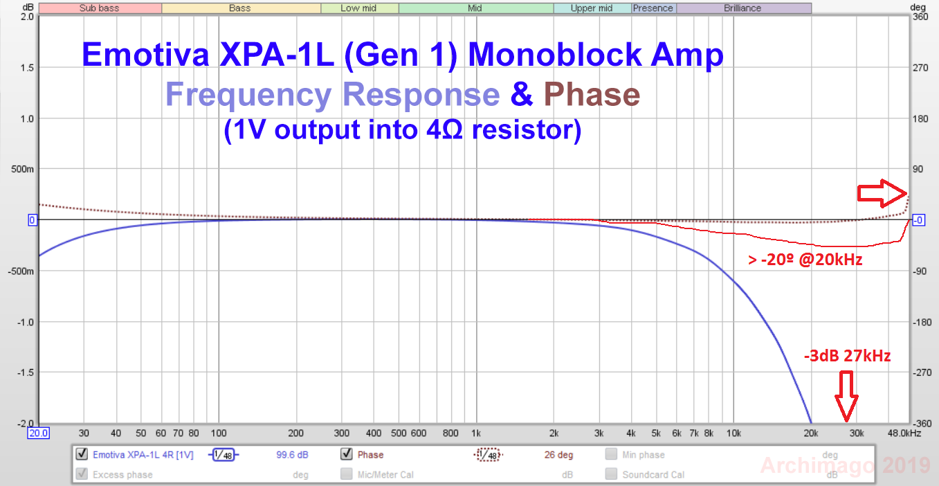

![Emotiva_XPA-1L_FR_and_Phase_%25282%2529.png](https://1.bp.blogspot.com/-u6Zuvhg1Cyw/XfU_FLJAsDI/AAAAAAAAVyg/eGu5znbubLcv8I9AdFw4qj6ZjZhAomG6wCLcBGAsYHQ/s1600/Emotiva_XPA-1L_FR_and_Phase_%25282%2529.png)
To me it is bad because > 6º at 20 kHz.Reasonable looking phase response I think from 20Hz to 48kHz. We're seeing about -20° at 20kHz corresponding with the frequency roll-off.
Thanks guys. Updated the phase FR graph.

...To me it is bad because > 6º at 20 kHz.
One of the advantages of amplifiers with high bandwidth, usually up to 350 kHz to avoid RF problems, is that in addition to flattening the frequency response < 20 kHz they also do the same with the phase -> better sound.
