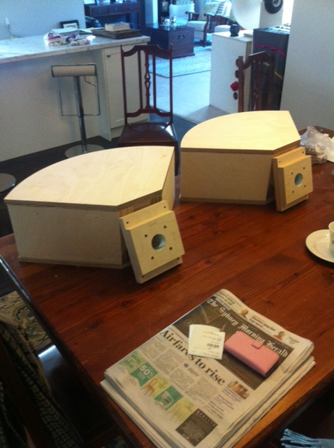

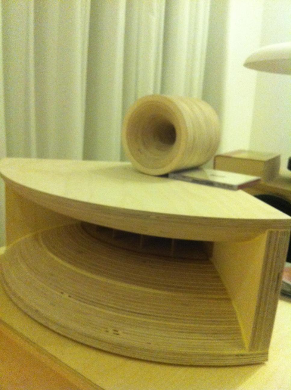

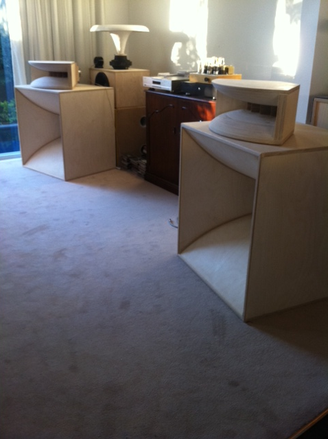

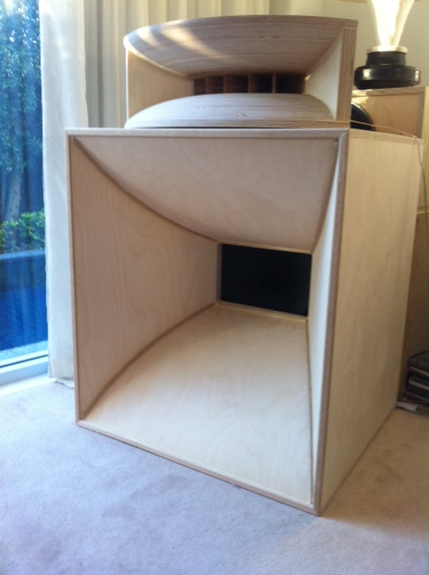

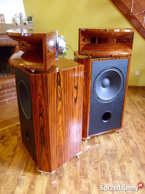

Just finished the Yuichi, with new Radian (Berylium) two-inch exits.

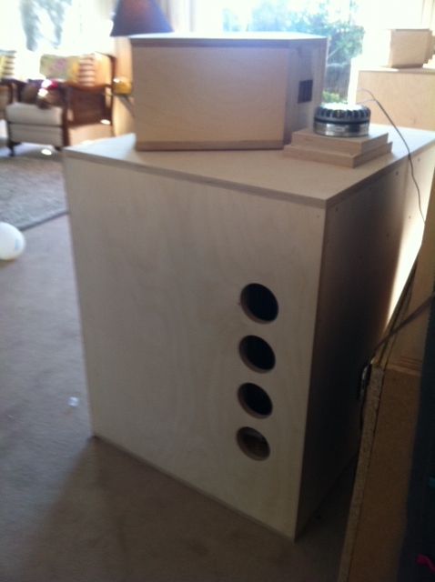

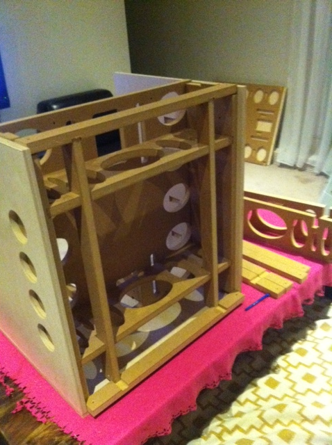

The bass is my own design using Altec 515 woofer. Porting to the side of the cabinet can be 'tuned.'
I'll build a passive 2nd order xover for the Yuichi, while the bass will run off MiniDSP.

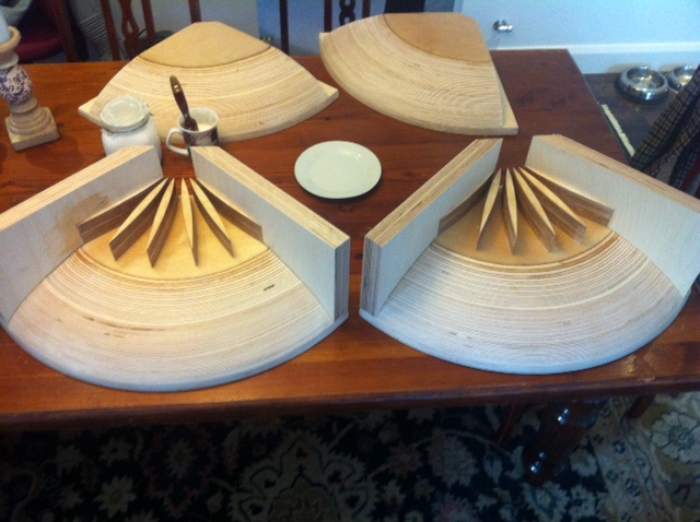

Lot's of CNC'ing here but still quite a few hours of hand wood working.
I quite like the look of the lighter Birch...and I've not yet added any stain/wax.
Initial sound is very good...plenty of scale and detail.

Would be interested in your opinino of the Yuichi vs the conical/LeCleach? horn youhave

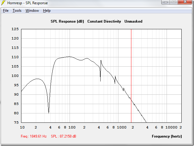

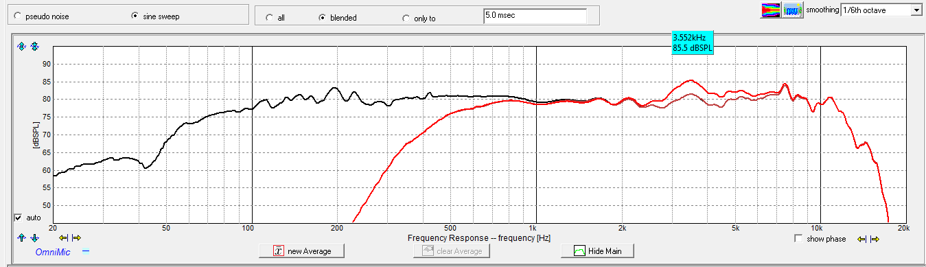

See attached sim, plus mic sweep.

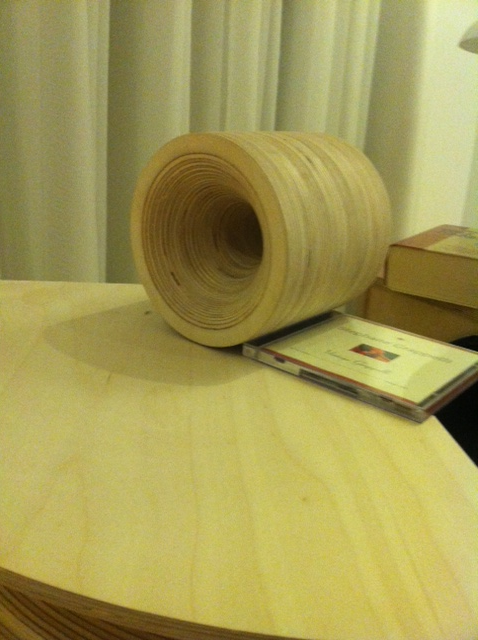

I'm also building small wteeter horns...and I collected one yesterday. I have new Selenium D220 drivers for the tweeters.
