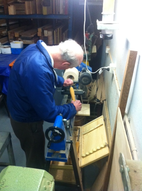

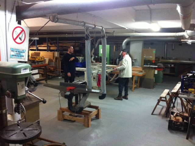

I just joined a local church Men's Shed which has been blessed with about 30 pieces of commercial wood working and metal working machines. They operate on Thursday and Saturday...and they're only five min from my home.

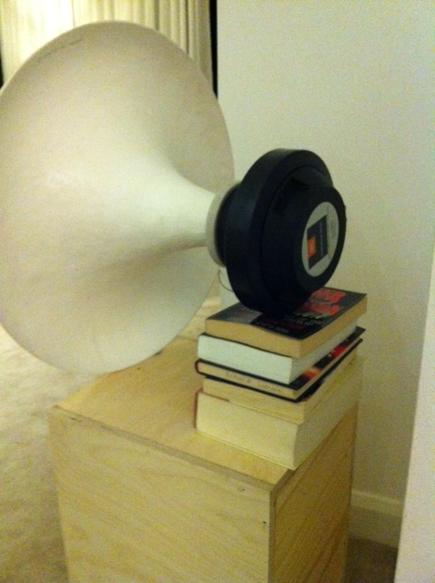

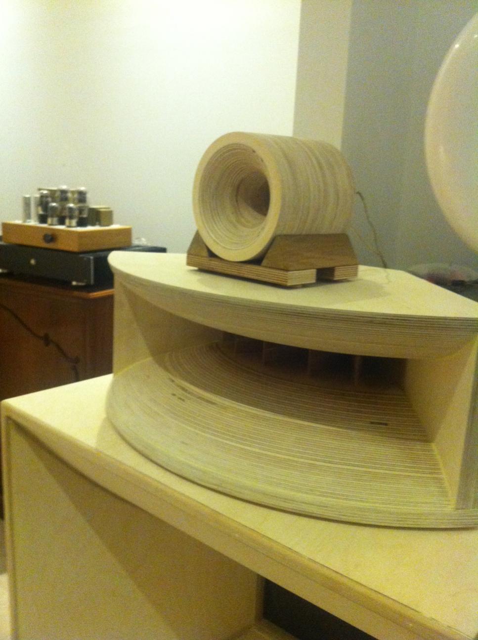

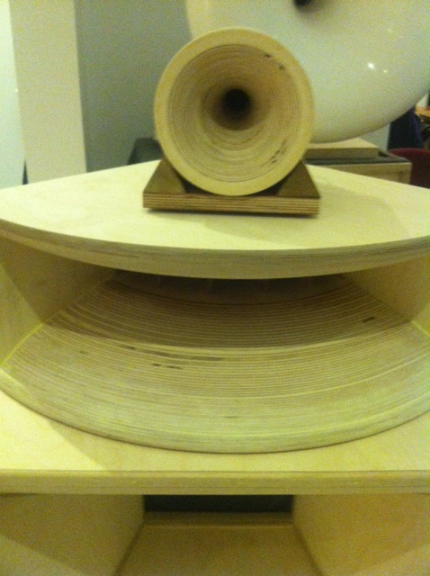

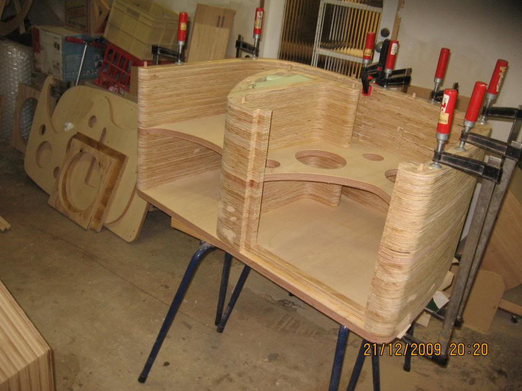

See attached pics, including one of the old timers working on my tweeter horn.
One of the wood lathes has a relocating chuck, so I can turn large shapes when the chuck is rotated 90 degrees.
If I build the larger 65cm horn (25 inches diameter), then I'd CNC the ply in a series of rings/donoughts like I did with the tweeter horn.

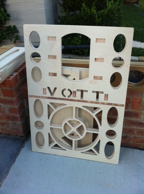

And on an earlier VOTT A7, I created some special CNC art on the baffle....
Not sure what your last sentence means. I built the full size VOTT A7.Jaleousssssssssssssssss, my precioussssssssssssss !

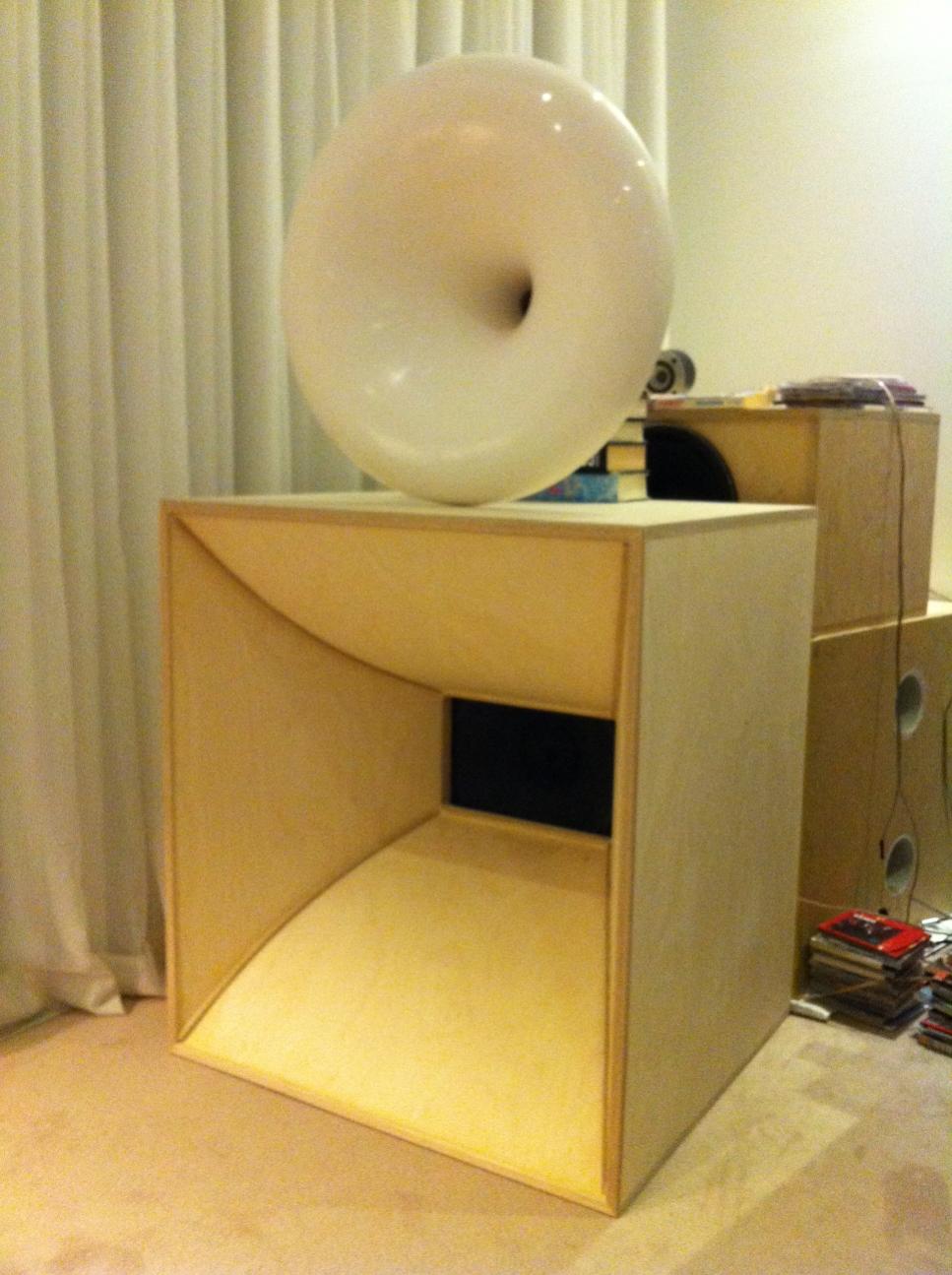

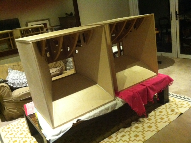

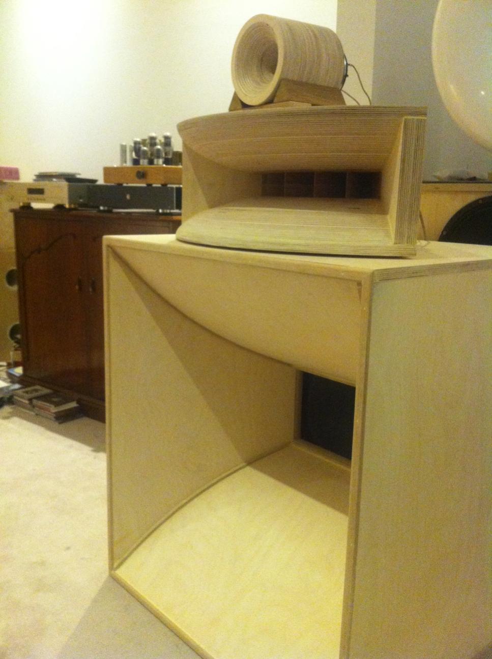

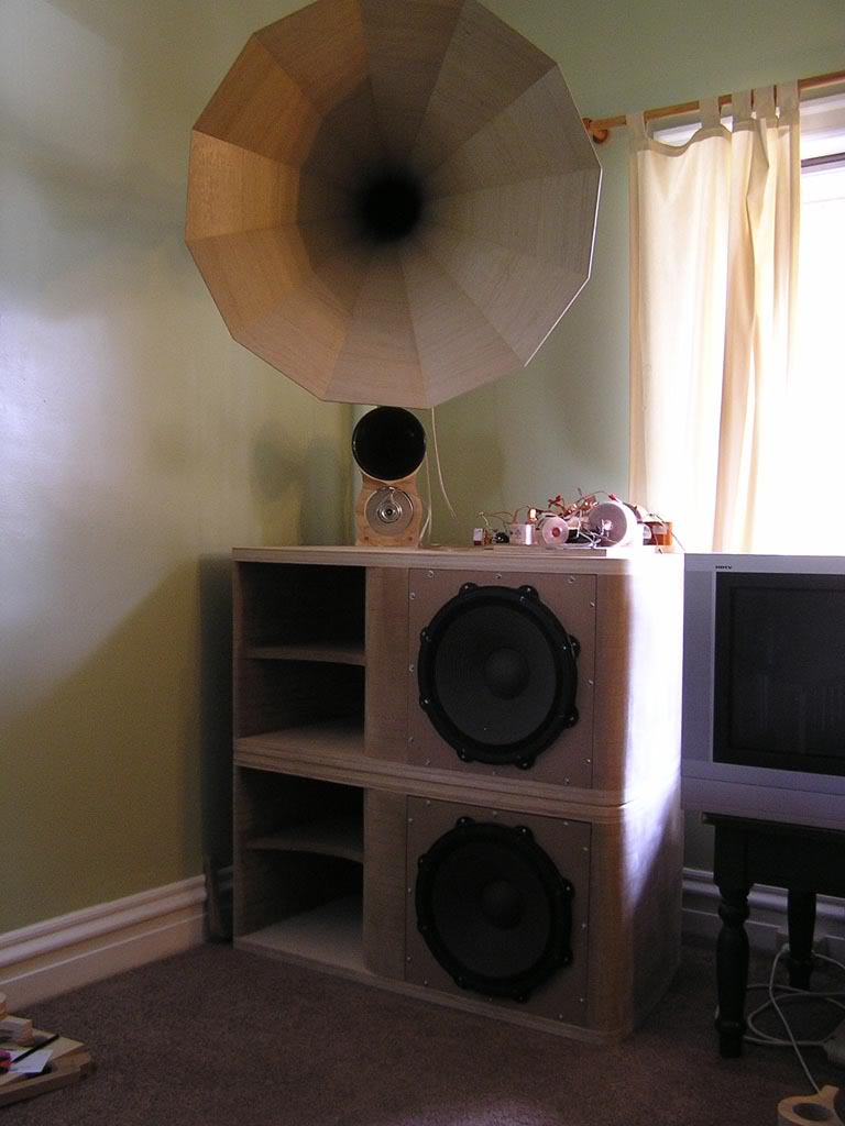

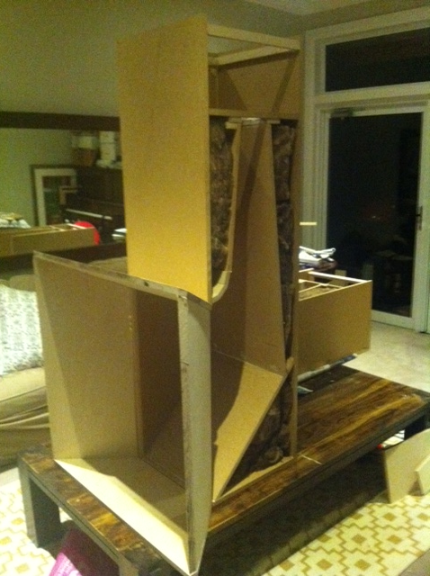

To clarify, the bass horn in this thread is not an Altec VOTT horn...it is a horn of my own design. It takes some cue from the A7, eg the throat size and flare of horn.
The large chamber is to assist bass depth below the horn cut-off.
With miniDSP I'm playing around with different EQ settings...and I've applied about 8dB gain around 50Hz. In-room response is good for domestic hi-fi use.
Even though this horn is slightly smaller (overall) than the VOTT A7, it is heavier due to the complex bracing structure. About 100Kgs each (220 pounds).
Terribly sad you think this has no WAF...!! The gent who's collecting these has a W who's quite keen on the look...!! I think the natural Birch wood looks quite nice...not heavy looking.
Tweeter horns now added, using Selenium D220Ti drivers.
Horn is 1500Hz, which xover points being trialled around 5,000Hz and 8,000Hz.
Certainly a musical tweeter, as opposed to the 'tiss tiss' sound of the small Realistic (Japan) super tweeter currently in place.
I previously used this driver on an Azura horn...and it tested very flat...which is great considering only US$50 each.

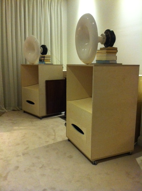

My current rig (not the Yuichi) is made up of:
Azura 340Hz horn with massive JBL 2445 CD
Mid bass is Eminence Kappalite 12 inch neo
Bass is EV 18 inch pro driver in 200 liter ported cab.
MiniDSP for all 3 channels, and six channel Holton Precision Audio amp. (Although I'm also testing 2A3 SET amp for the Azura horn at resent.)

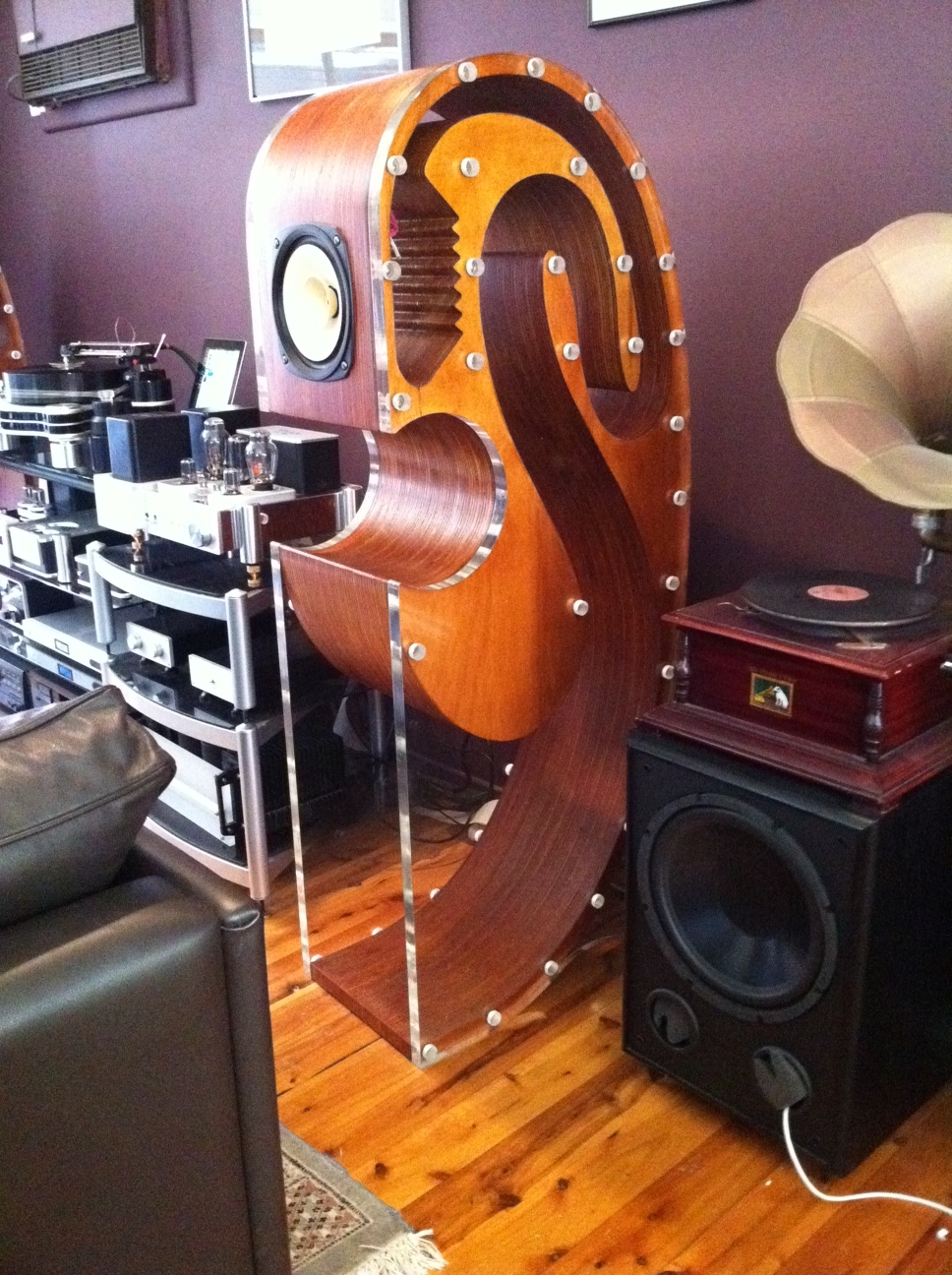

I'm very tempted to replace the Azura 340 with a ply wood horn, like the attached pic....I just love building stuff...plus I now have access to lathes.
I'm also tempted to try the large 160hz Azura (plus the 550Hz model) to have a full fibreglass trio system. I'd retain the EV 18's for bass duties...as these are very fast, and can go to 250Hz easily.

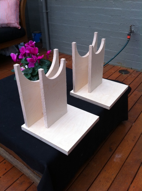

Yesterday, I took delivery of some American Walnut veneered panels for me to build an outer cabinet for my mid bass and EV bass modules....as these 4 boxes look crappy. The new outer cabinet will slide over the existing boxes...and will have a new 'vintage' grill cloth like this from Parts Express. The Azura will sit on top.

Are you building the outer boxes to slip-fit over the mid-bass boxes?
Or building in a gap, to fill with sand, or kitty litter or something?
I may do that with the tapped horns. They're built really well braced too, but you can still feel the walls vibrating when played loud. Too many projects...

With my intended outer cabinet for the bass and mid bass, I was not intending to create a filled cavity. The cabs for the EV and Kappalite are very heavily engineered. The bass, for example, has 12 cross supports, and is made of one inch consuction heavy chip board...ugly...but very very heavy and solid. The mid bass is euro birch ply, heavily braced.
