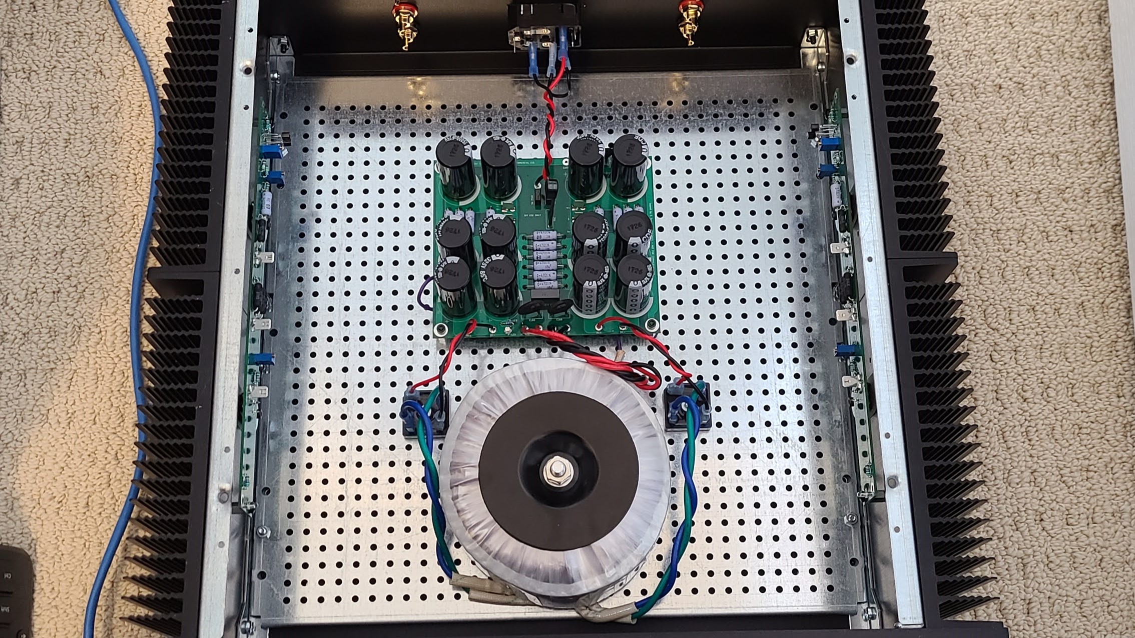

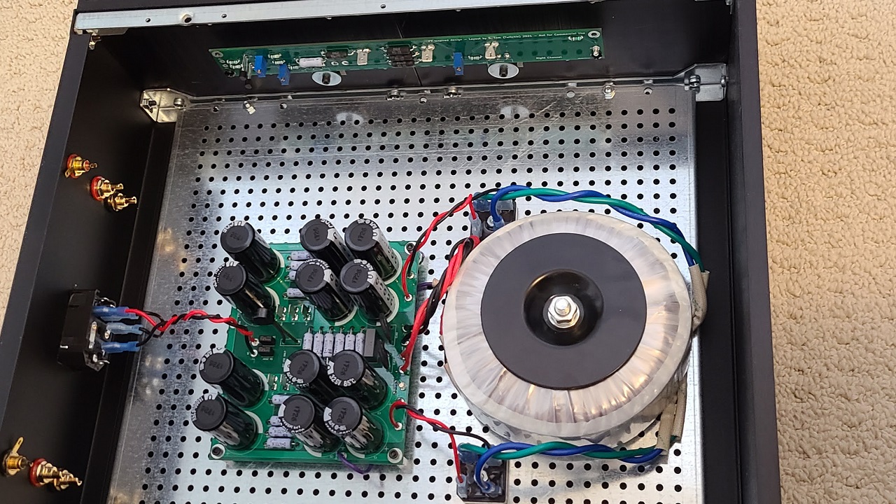

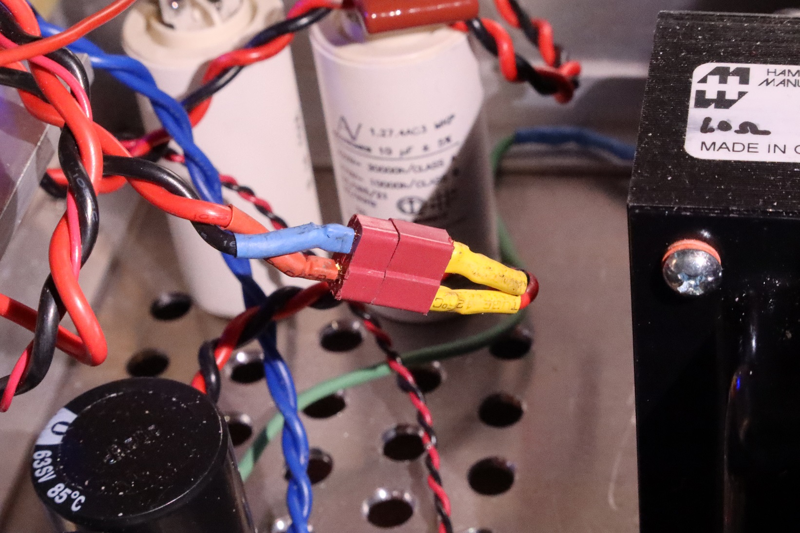

I installed the base plate lip down so I could slide the power transformer forward almost touching the face plate. During testing I found a problem and needed to remove the amp boards. I simply removed the 6 screws that held the heatsink . Board removal and reinstallation was easy. Had the spacers not been there I would have not been able to remove the bottom 3 screws from the heatsink. Unless there is a structural problem I will most likely leave it as built.
Mighty Zen Mod doesn't approve of the fast-on blade connectors so I am being well behaved Greedy Boy and not putting wires on them ![whazzat :whazzat: :whazzat:](https://files.diyaudio.com/forums/images/smilies/whazzat.gif)

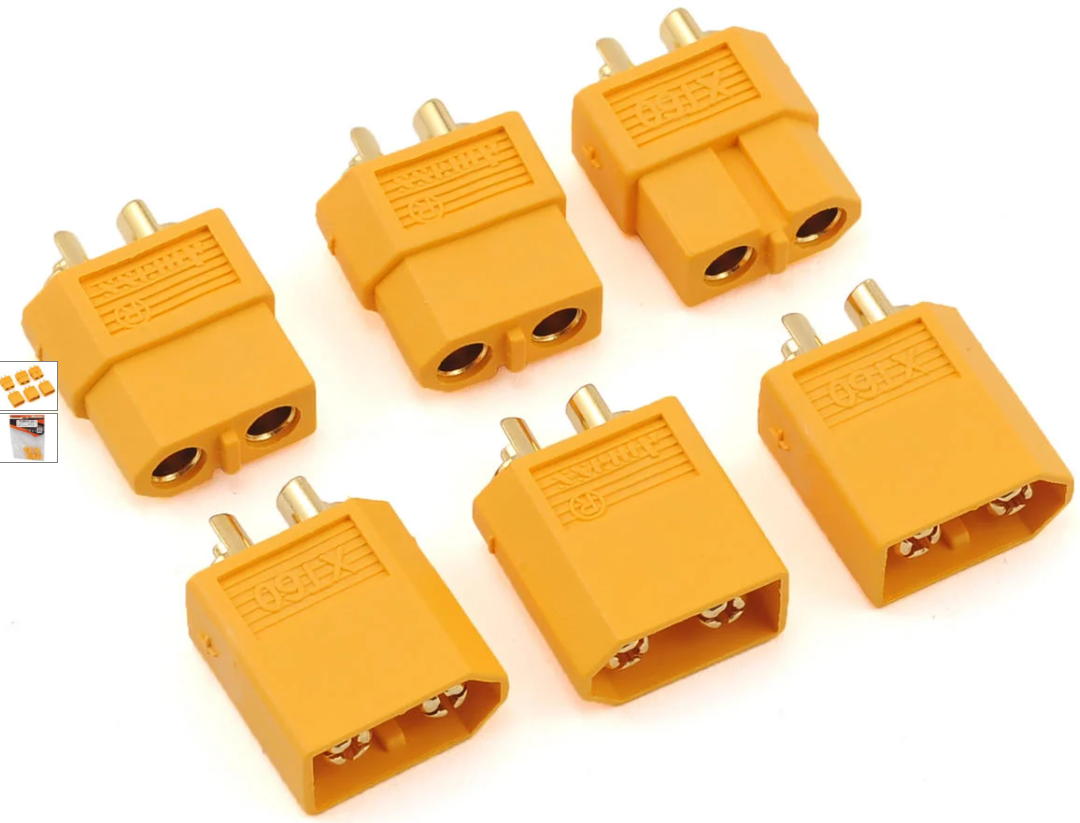

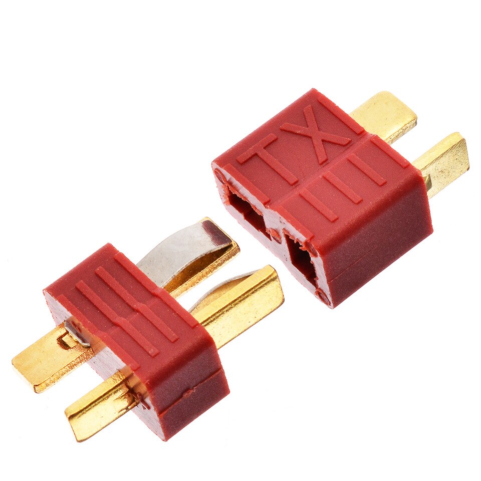

I like using Deans connectors for power connections. Deans connectors are used in radio controlled airplanes, helicopters, etc for lithium polymer battery connections and can take many Amperes of current. They have large contact area with tight fit.
Fugly!
