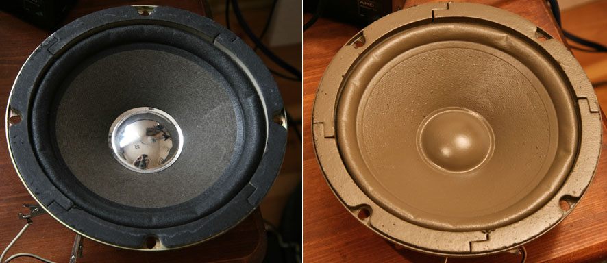

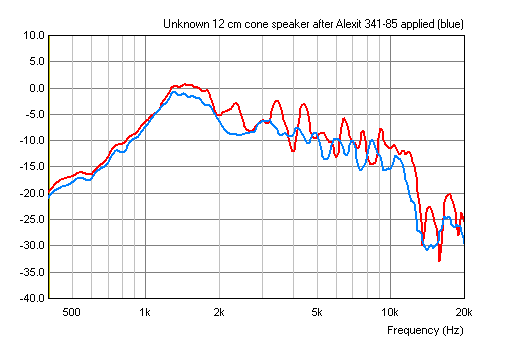

Alexit lacquer on 12cm cone speaker. Damping is clearly visible.
Good result indeed ...
