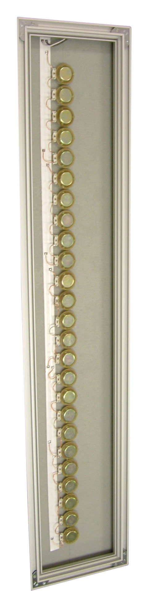

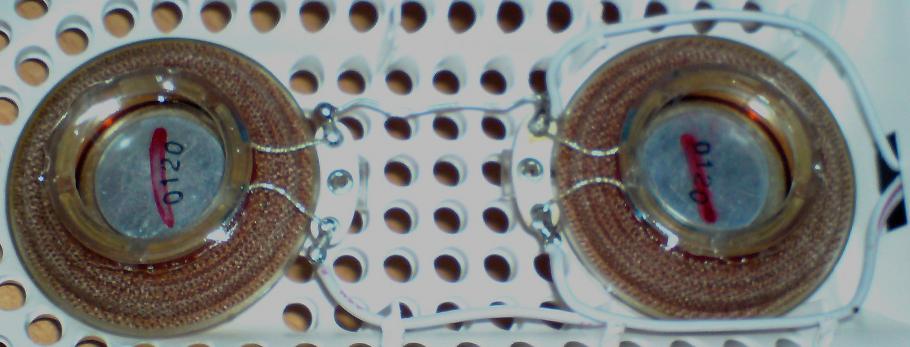

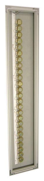

Amina had such a design a few years ago (it's currently not on their homepage anymore).
![AminaALA102E.jpg AminaALA102E.jpg](https://www.diyaudio.com/community/data/attachments/142/142874-da0ee234099152e1c9126658b5cee63c.jpg)
![Amina-ALA102E-back.jpg Amina-ALA102E-back.jpg](https://www.diyaudio.com/community/data/attachments/142/142885-1ab4249ec9be6c2bddbc0f74b2e2a568.jpg)
It's data:
100cm x 20cm x 3,5cm
closed back
180° x 25° HxV dispersion
92dB efficiency
125W (80Hz HP required)
200Hz-20kHz +/-5dB

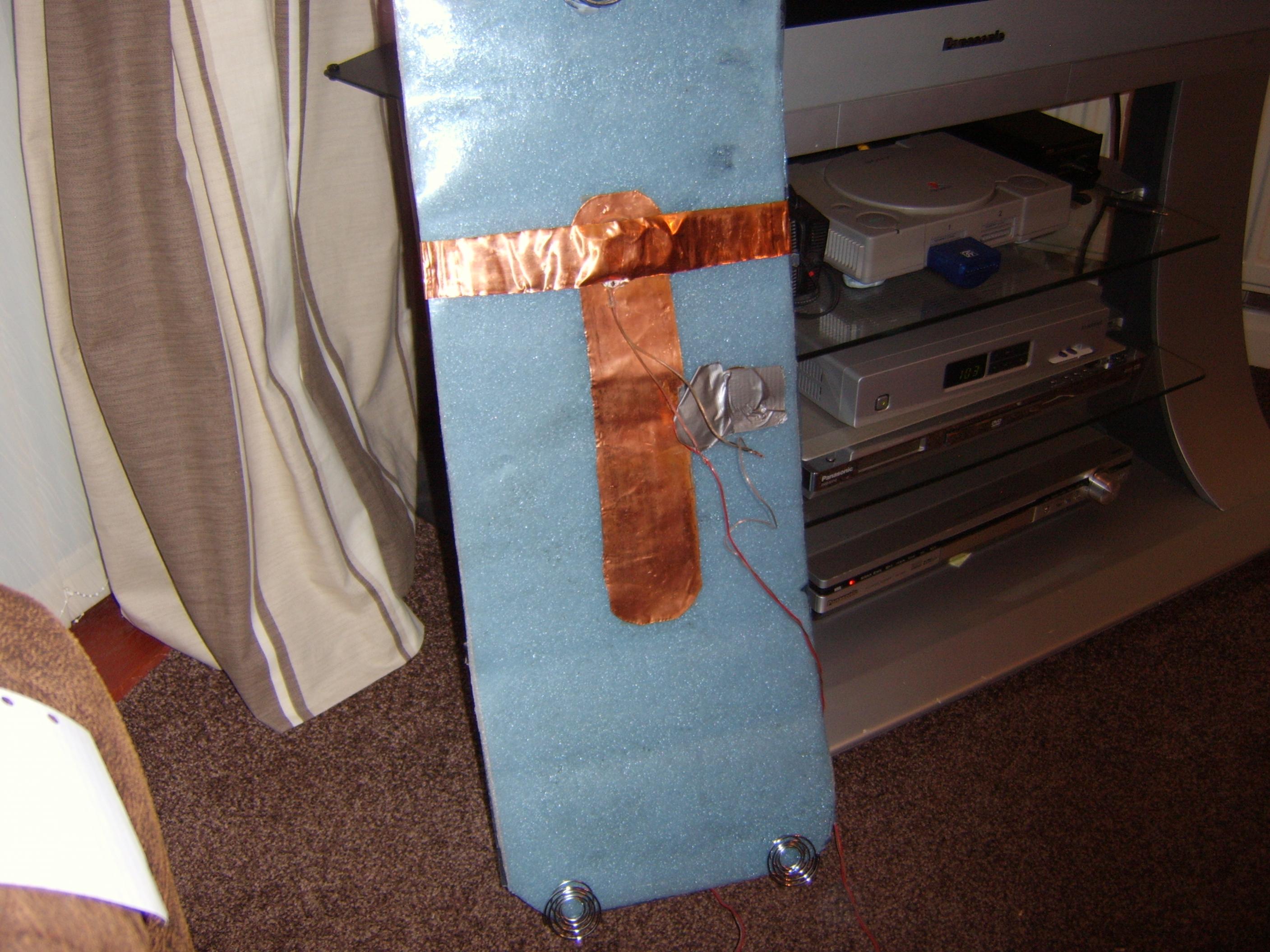

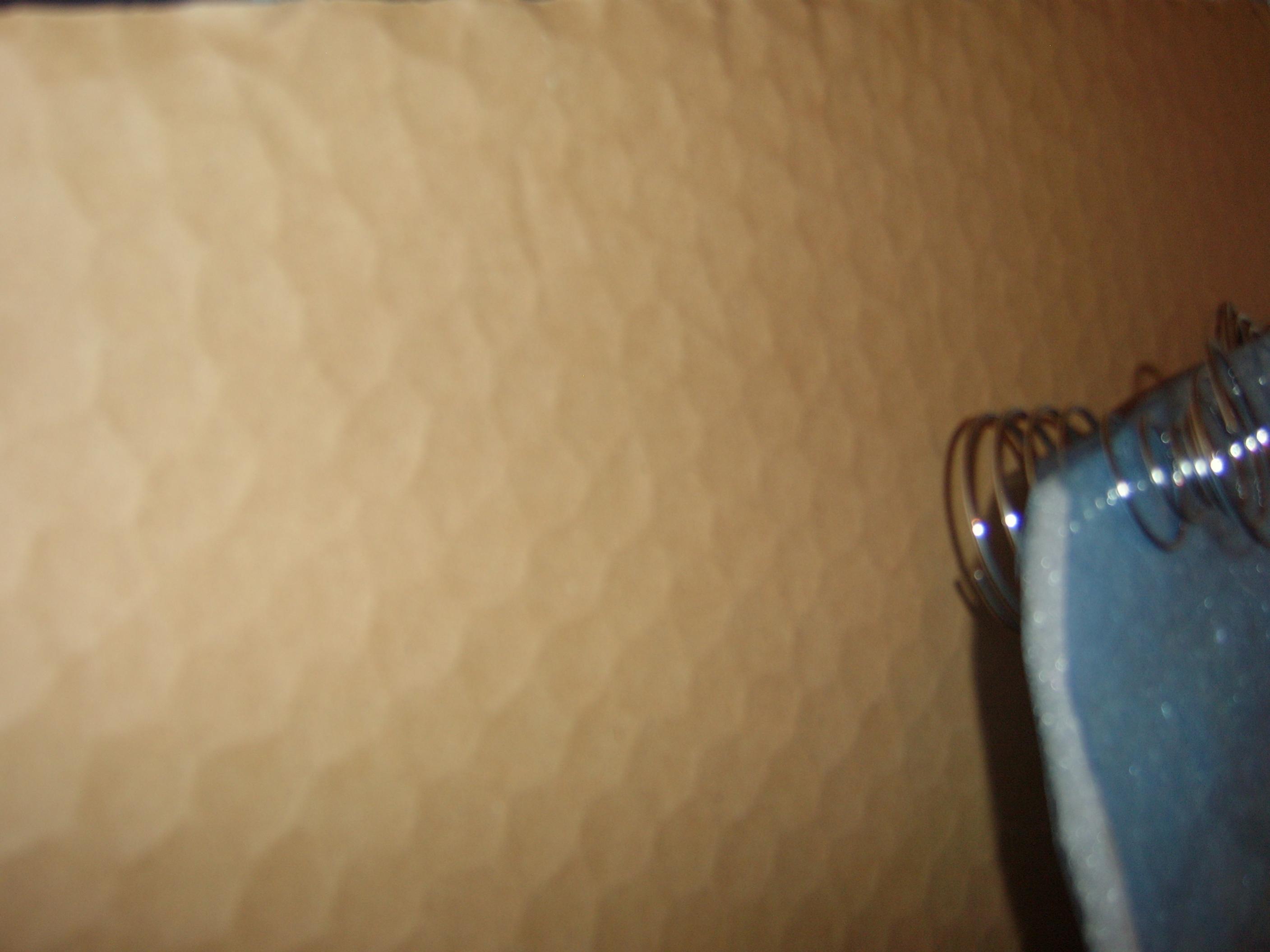

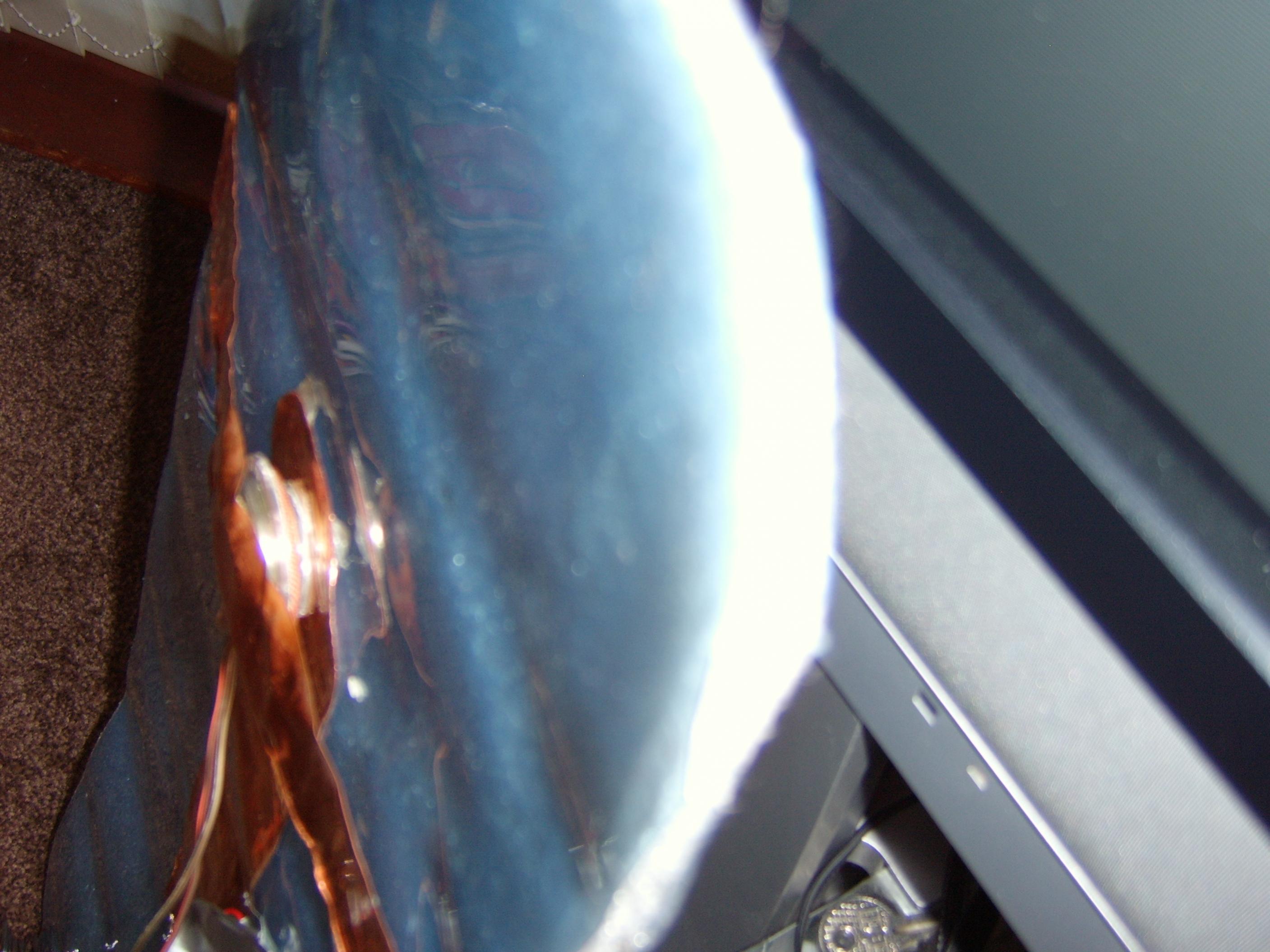

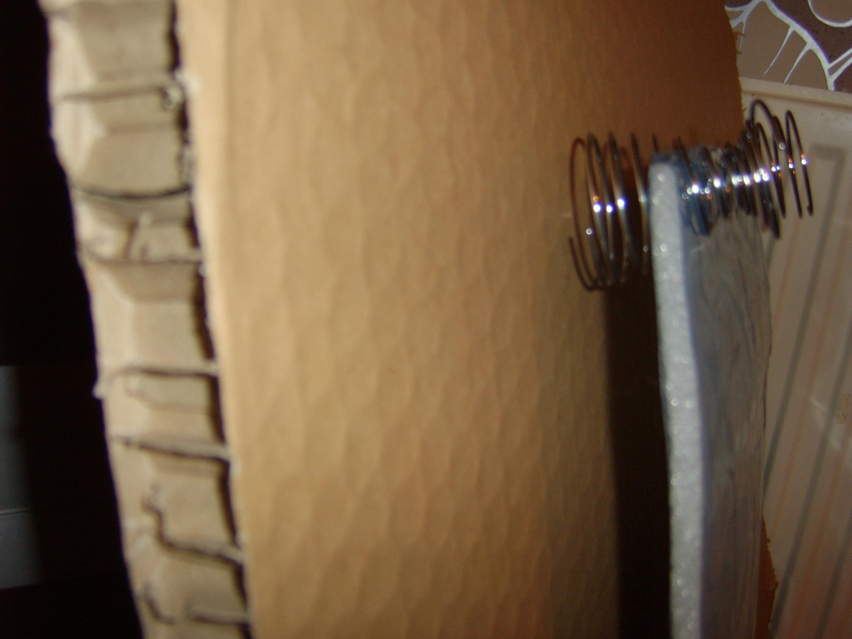

Hello All
I dont normally post on forums and this is a first for me.. I have been experimenting with exciters since buying 4 nxt soundpads which I used to take on holidays with my t amp and stick to everything from pringles cartons to drawers..
I have just finished a new set , they are made from packing foam polysterene sheet about 6 mm which I lminated with a cut up emergency car windscreen .. kind of mylar material I used spray glue to laminate end resut being very light and stiff.rounded the edges
I used coppr sheet to hold the eciters in place and one large piece of copper sheet as a stifener and as an experiment to increase to surface ara of the exciter
Although new to forums I have owned a wide range of hifi including altec dual 15s and KT 66 valve amps .. more recently I am using a panasonic sr45 chip reciever with a modified PSP1 1001 as te cd player
The sound is excellent to the extent I replaced my canon mushroom speakers with my diy efforts.I have a couple of Gallo 12"subs for the bass ..
previously I tried squirting foam filler into corragated PVC ceiling panels , messy business I dont recommend..
Next I an going to try the following - mixing zeolite corn starch to make a kind of natural foam filling I nicked the idea from a patent I read ..then use it inbetween some kind of honeycomb perhaps bee keeping panels..
I will post some pics of my handywork they are about 6cm by 3 cm
next step is to use some spring steel or similar to bend them slightly after another idea I pinched hope someone likes the use of copper sheet it seems to hold them in place and add something to the sound I feel ..
Load some pics tomorrow if anyone is interested ,, enjoy the forum and all the input into diy panels
Best Jim
Best Jim
