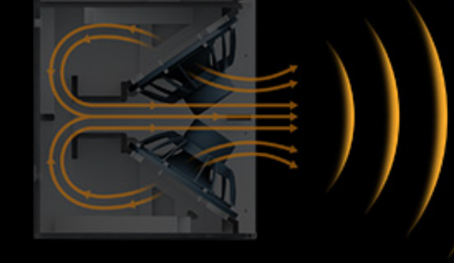

The picture in the first post is no TH, it´s a ported Box...
I see something similar to Cubo series which they call hybrid horn what ever it is. Even tho cubo has longer horn path, I have measured some cubos and only two impedance peaks appeared = reflex, Tapped horn has 3 peaks clearly visible. Cubo is indeed loud above 50Hz, louder than same driver in standard reflex enclosure. Cannot tell why, maybe it has something to do with larger radiating area / mouth, better coupling to air? However, horn path itself is just too short to make any real "horn effect".
Longer vent gives 1/4 wave low end boost effect. Depend of course of mass-size of driver, volume of enclosure...Etc. And longer path give you again more, but need more powerful speaker more. And you have to deal with port resonnance.
Not always need to do the usual increasing segments TH to have this effect.
I play too much with hornresp ^^
OK, Thanx
Originally Posted by Sublimacon
We sort of started chatting about them in the "NIMBY" thread, bottom of post #18.
Thanx, i'll take look
Good point
