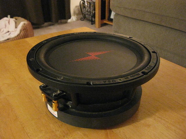

YES,IT DOES BOTHER ONE WHEN THEY USE A $30 TWEETER,$80 MID N A CAR AUDIO SUB.PPI PRO 10
Not sure who makes them now
i am going to try a MB-2 clone,bryston makes a modified x-over for them,now the mid and high is a modified volt mid i think i was told,and the tweeter????????i like the ib1 but need more(just a little)so a mb2 would be perfect,if anyone has any info or could help would be appreciated....
i can try a atc andss9700 as fill ins????

PMC used to use the Precision Power PPI10 in the IB1/2.
Afaik they now manufacture the flat piston woofers and mid domes themselves (maybe they bought the production tools for these chassis?).
Yes, or so they say.
I wouldn't be surprised if they have a deal with the same manufacturer or some other to get them to make a model with the PMC stamp on it, something exclusive that the manufacturer cannot sell as an OEM speaker...thus making it difficult to clone this seemingly overpriced speakers (as all speakers).
