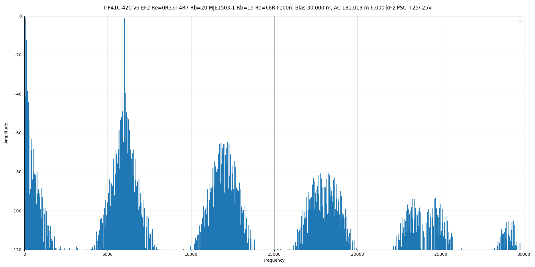

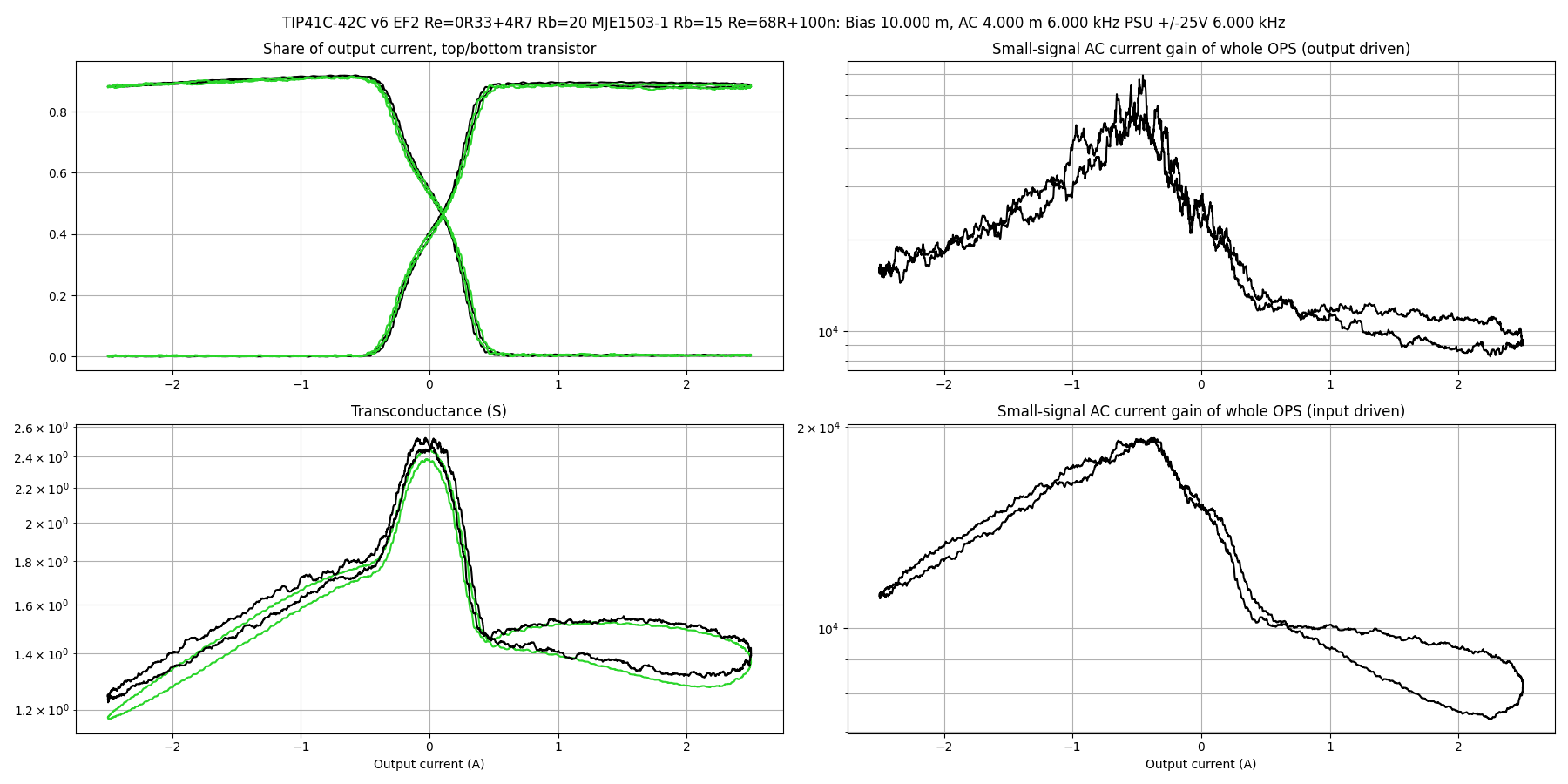

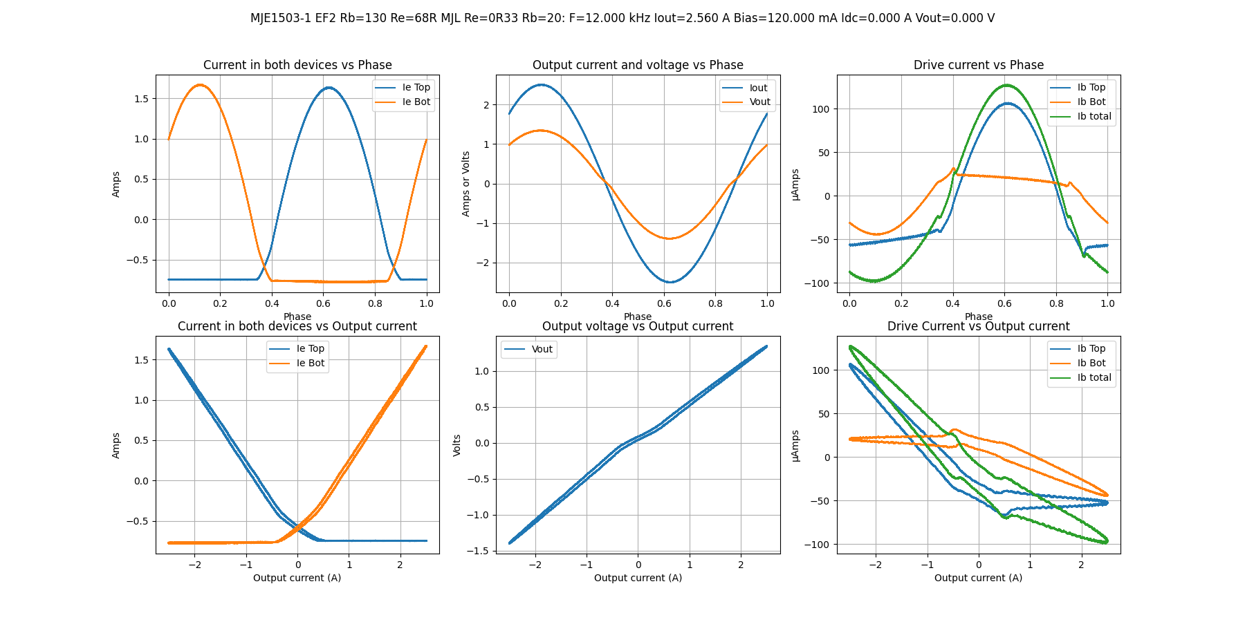

Switching distortion like this is due to turn-off, where the stored charge has to clear the device - with the EF output topology a speed-up cap is usually enough to tame this.Thank you for all the effort.
I am in the verge of ditching BJT output design, and using FETs instead.
BJT design just looks complicated even with 2EF. Too complicated to do it right.
With CFP topology there's no realistic way to speed-up switch-off and OS distortion tends to rise at HF from 5kHz or 10kHz or so - this means paying more attention to global feedback at higher frequencies to get good performance (ie advanced compensation schemes).
But the main thing to avoid is using slow transistors in the OS in the first place - 30MHz devices are often selected specifically because they have faster switch-off, not because that bandwidth is actually needed.
In the old days when 2N3055 and 2N2955's were the bees' knees CFP (or quasi-complementary) was a poor choice due to sluggish switch-off of these slow devices.
Having said all that its perfectly possible to get decent performance from CFP topology and it has the great advantage of running cool (low bias current) which extends equipment life and reliability.
My bias to FETs is solely to laterals which make thermal compensation unnecessary and greatly reduces the risk of secondary breakdown or thermal runaway due to bias drift over time.

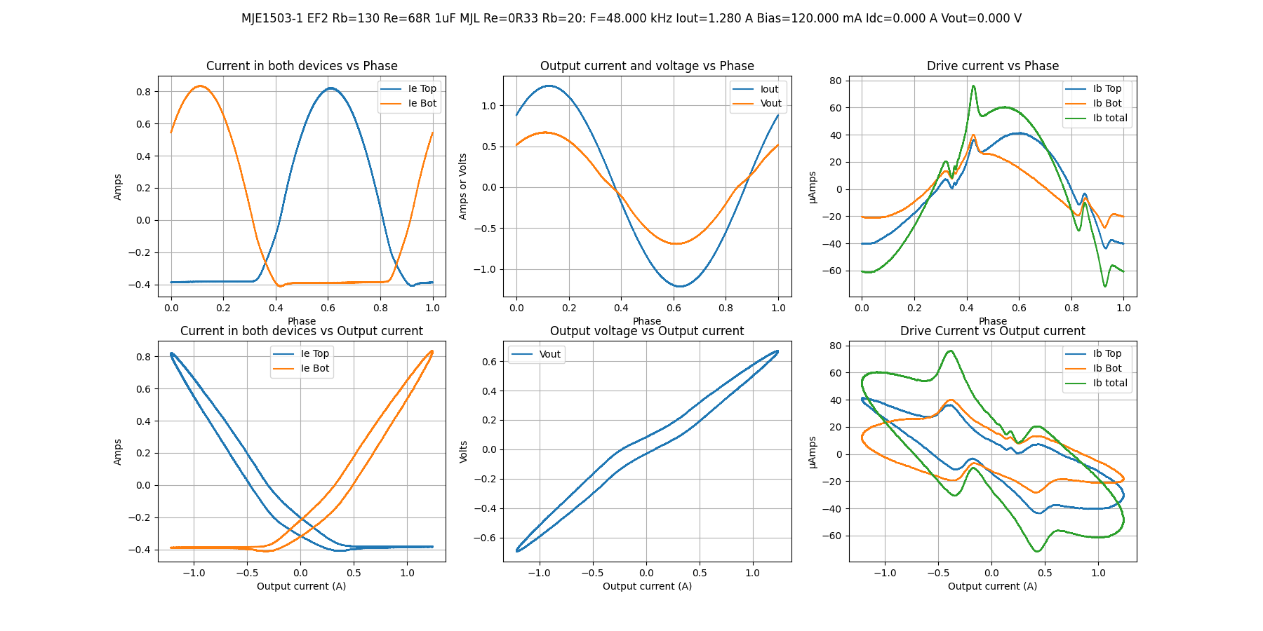

Look at the base current in the top right corner... There are 4 spikes per period: each turn-on and turn-off generates one. But these only appear on signals that are not realistic audio, like 1A at 48kHz, or several amps at 20kHz. At 12kHz, even with quite large current of 2.4A, no spikes. These come from di/dt, so to get rid of them, gotta parallel devices to reduce di/dt per device. These are strictly BJT and I think they're due to transit time.
These are different from the crossover spike you see in the THD residual of a complete amp that's operating properly (ie, not like in the previous case). These come from gm being different in the crossover zone, so there is only one per crossover instead of two here. And in fact, they don't really exist. Basically, at low current there is less gm, so the output signal is a bit "compressed", it has a bit less slope than it should... You can see it in the second graph, top row, middle plot, orange trace "Vout": near zero, it's like it's taking a break and lingering there. Or if it's gm-doubling, the slope increases and it looks like it accelerates through the crossover.
The THD residual removes the main sine wave, and the result shows a spike, but it isn't really one. It's just the way THD residual dusplays things.
CFP is different, it makes such a mess at turn-off that these appear tiny in comparison...

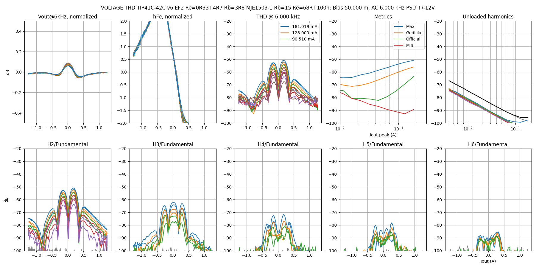

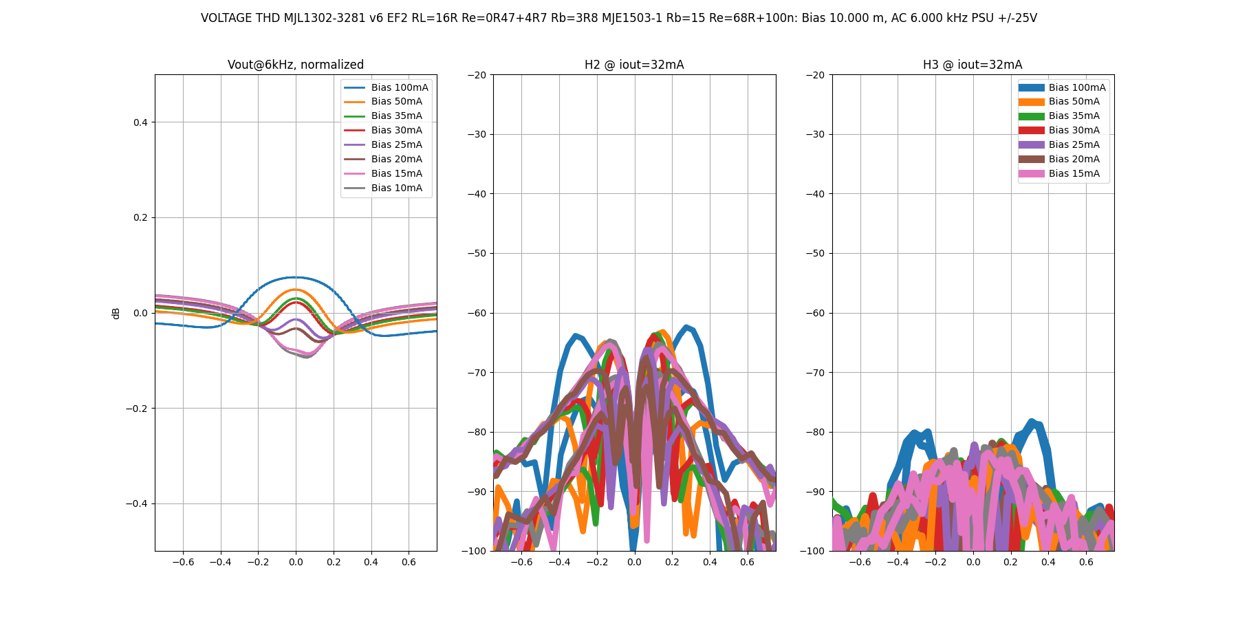

Now I'm going to compare MJL1302/3281 with several values of emitter resistors. They're all Ohmite TWW5.
Conditions:
The 4R7 SMD resistors that dampen the inductive wirewounds are still there.
Base resistors 3R8
Drivers MJE15030/15031 with 15R base resistors, 68R emitter resistor (~17mA idle)
100nF cap

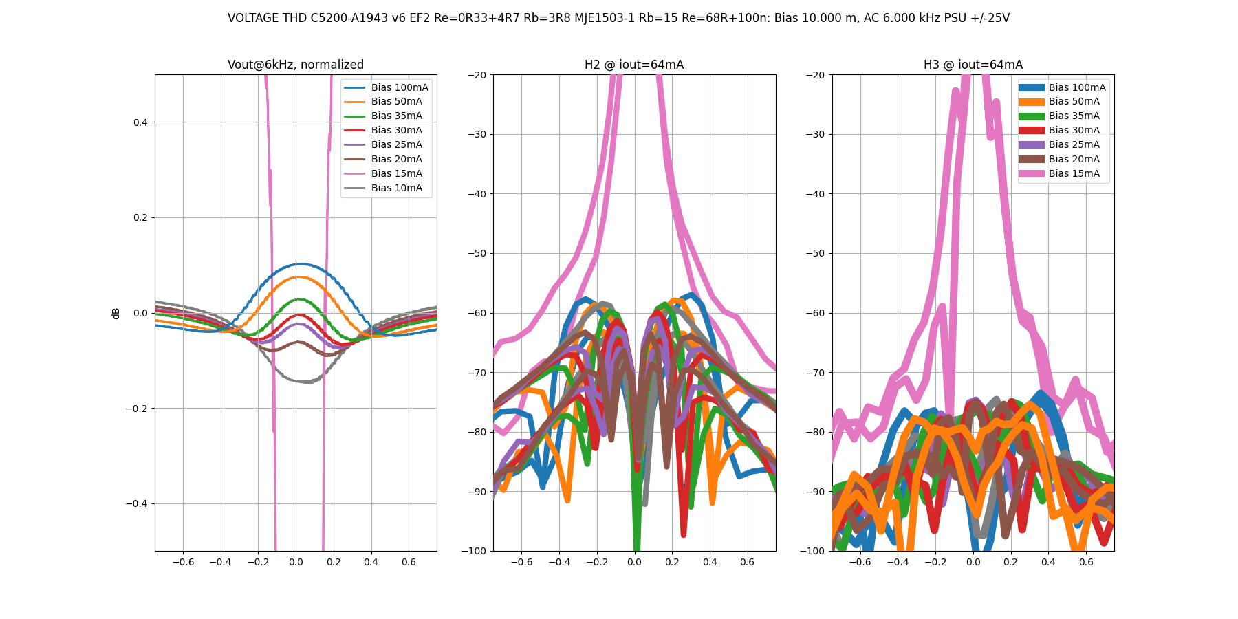

Bias stability:
Values in the plot titles are what the bias was at the beginning of the test... With 0.15R emitter resistors, I noticed bias getting a bit wild. So, I halved the power supply voltage to sort of get the same amount of bias drift between 0R15 and 0R33. Anyway, accurate bias current to the mA is not that important, what matters is knowing whether it's optimally biased, underbiased, or overbiased/gm-doubling, and that's very visible in the measurements.

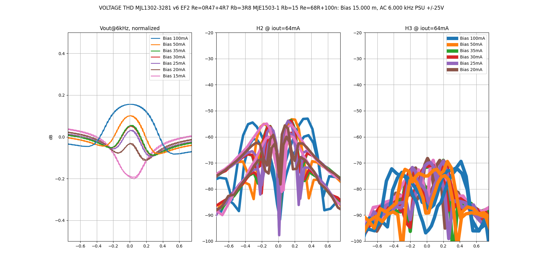

This stuff is well known, but let's recap:
Unlike MOSFETs, with BJT it does not pay to throw more bias current at it over the optimum level. Distortion at low current levels will change if the measurement is centered on zero, but my setup shows the distortion bumps just move around to a different value of output current, it's like playing whackamole. If you optimize THD on a low level signal, that will change the depth of the valley between the two peaks, but THD will not tell about the size of the peaks because it isn't going there...
In real music, low level signals very often ride on top of a higher amplitude signal like bass or another instrument playing, and that will sweep through the crossover so the low level signal of interest will be affected by the increase in distortion on either side. I believe this could be a source of "graininess" or that kind of stuff.
Anyway, emitter resistors.

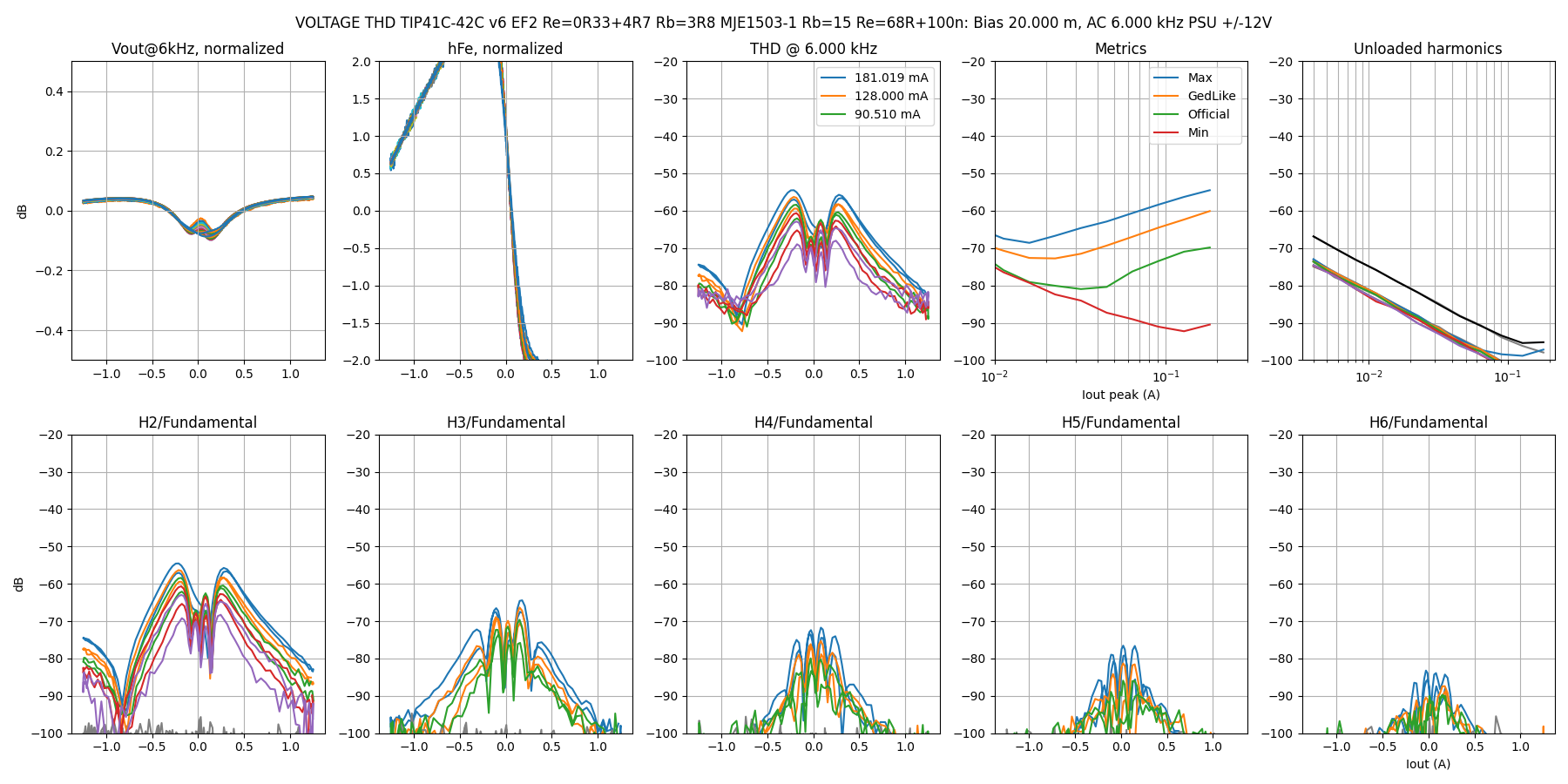

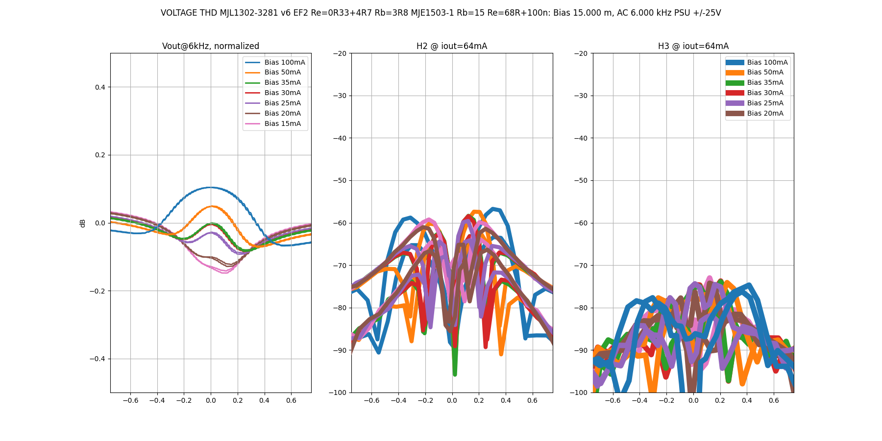

Just open the pictures in tabs and flip through them : on the left is "basically gm", and the size of the mess is proportional to the emitter resistor.
X axis is "DC" output current.
The two other plots are harmonic H2 and H3. I left the others out because all the evens and all the odds look the same, only lower. I left the THD out because H3 hides H2 in the total, and their shape is different, so it's interesting to see both.
I've put all the bias values on the same picture, because otherwise that made too many plots to upload. It's a bit of a mess, so try squinting a bit.
Result: Emitter resistors are evil. They increase distortion dramatically.
However, they are also necessary for stability: if you look at the gm plots with 0R15 resistors, 10-15-20mA are identical. That's because no matter what the setting was, it didn't care, and it self-heated to 20mA. That's with 12.5V Vce. Maybe my Vbe multiplier is at fault, but well.
So, basically, what this says is: use the lowest emitter resistor that gives a stable bias. This is true no matter what the bias is. "A higher emitter resistor is better for a lower bias setting" turns out to be a urban legend.

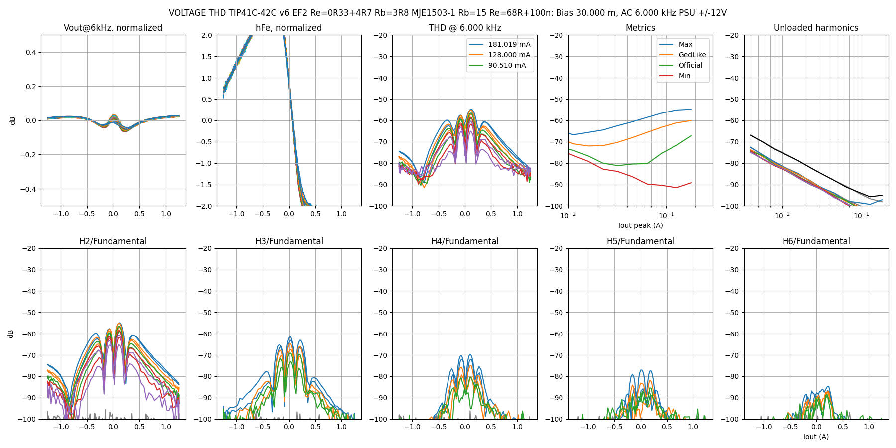

The point of a cascode output stage is to use lower emitter resistors by lowering Vce so it doesn't go into thermal runaway.
A cascode output stage therefore becomes an interesting option...
There's probably a FOM (figure of merit) for output stage power BJTs which would be something like fT divided by RthJH thermal resistance junction to heat sink. The former is about speed, RthJH is about lowering emitter resistor value without thermal runaway.
With 0R47 all biases have about equal peaks, but with 0R15 there is an optimum value, between the red and green curves, or 30-50 mA. That gives minimum distortion. Above that, gm-doubling occurs and it rises again, at different output currents.

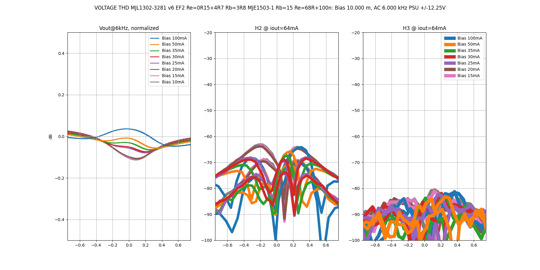

gthd-6k--MJL1302-3281 v6 EF2 Re=0R47+4R7 Rb=3R8 MJE1503-1 Rb=15 Re=68R+100nB=10.0m,HA=4.0m,LA=25.png230.9 KB · Views: 247
gthd-6k--MJL1302-3281 v6 EF2 Re=0R33+4R7 Rb=3R8 MJE1503-1 Rb=15 Re=68R+100nB=10.0m,HA=4.0m,LA=25.png218.5 KB · Views: 247
gthd-6k--MJL1302-3281 v6 EF2 Re=0R15+4R7 Rb=3R8 MJE1503-1 Rb=15 Re=68R+100nB=10.0m,HA=4.0m,LA=25.png210 KB · Views: 244

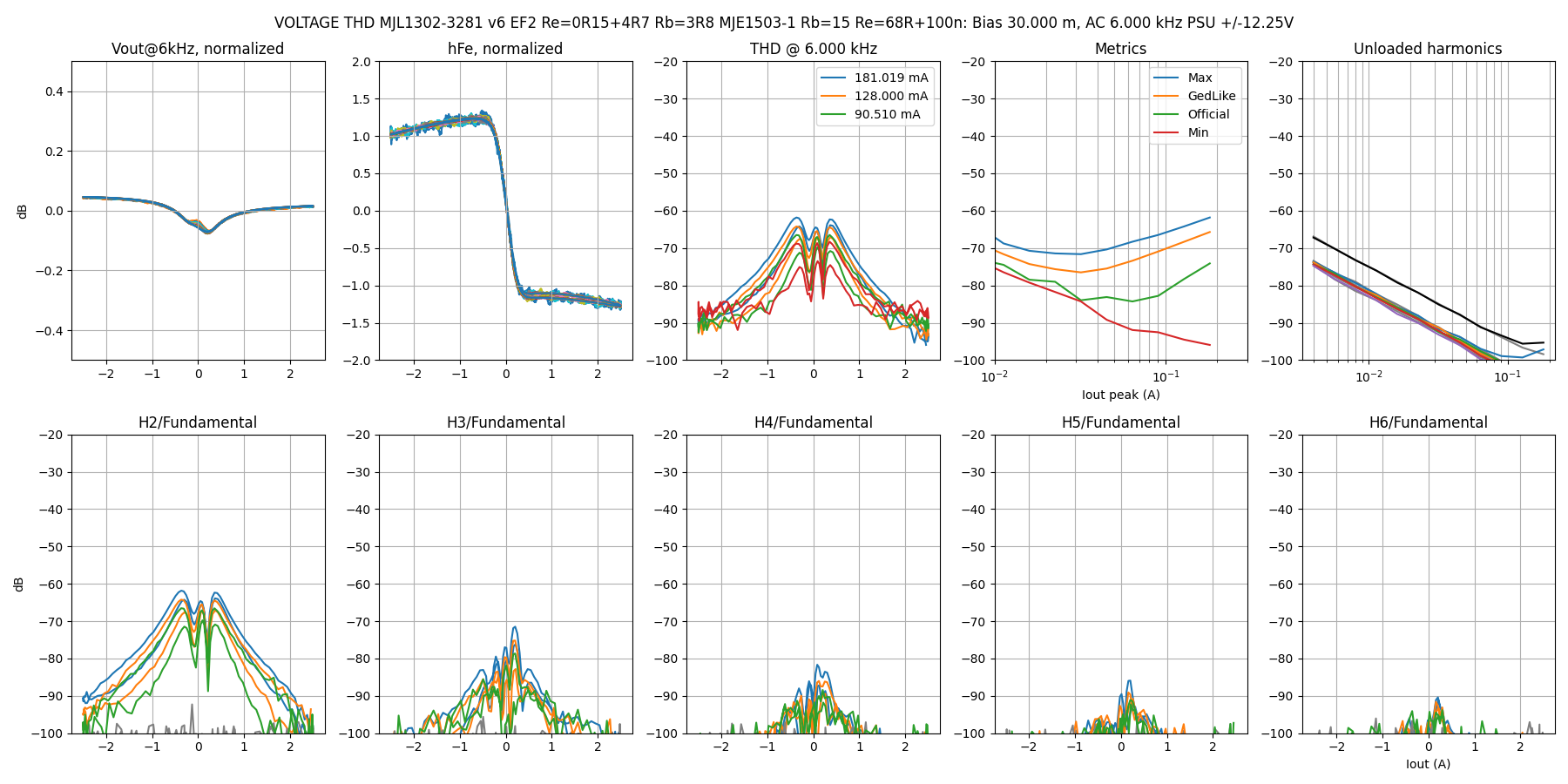

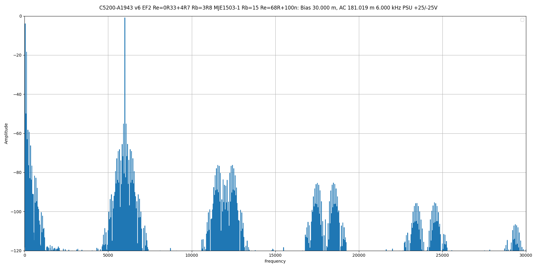

Full plots of the best (0R15,30mA) and worst (0R47,20mA) case:
High order harmonics fall off much quicker with the lower emitter resistor value. I'm not posting all the other plots, but the same happens at all bias values. Lower emitter resistors gives lower THD, faster high order harmonics fall off, at all biases.

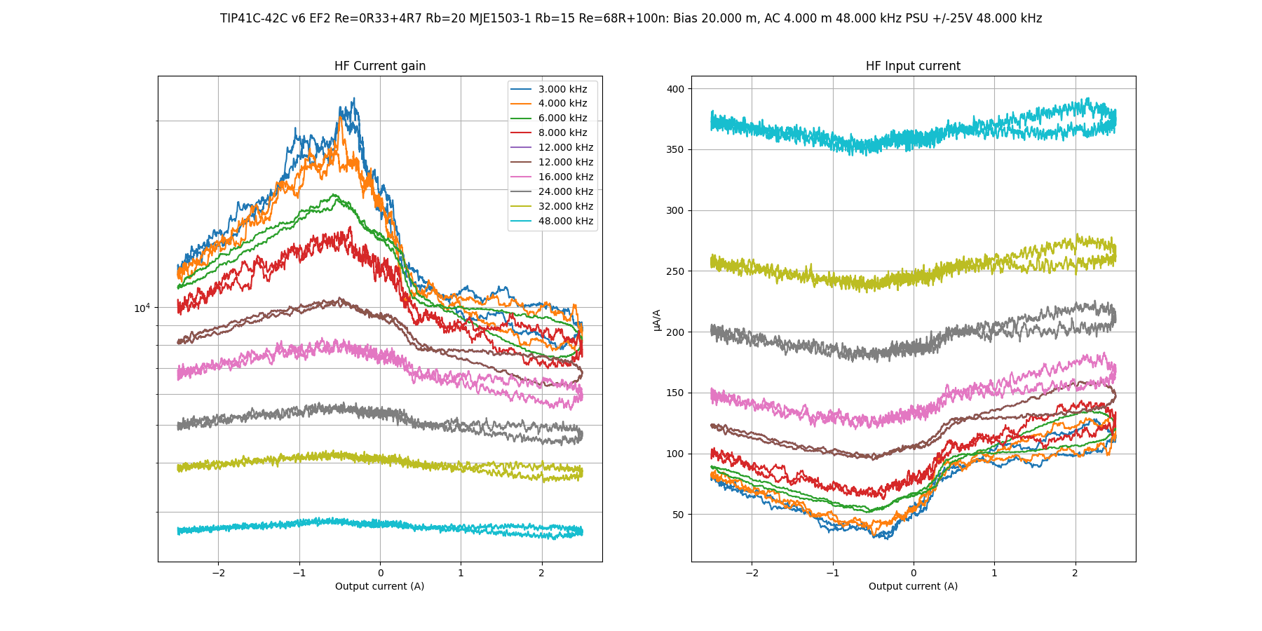

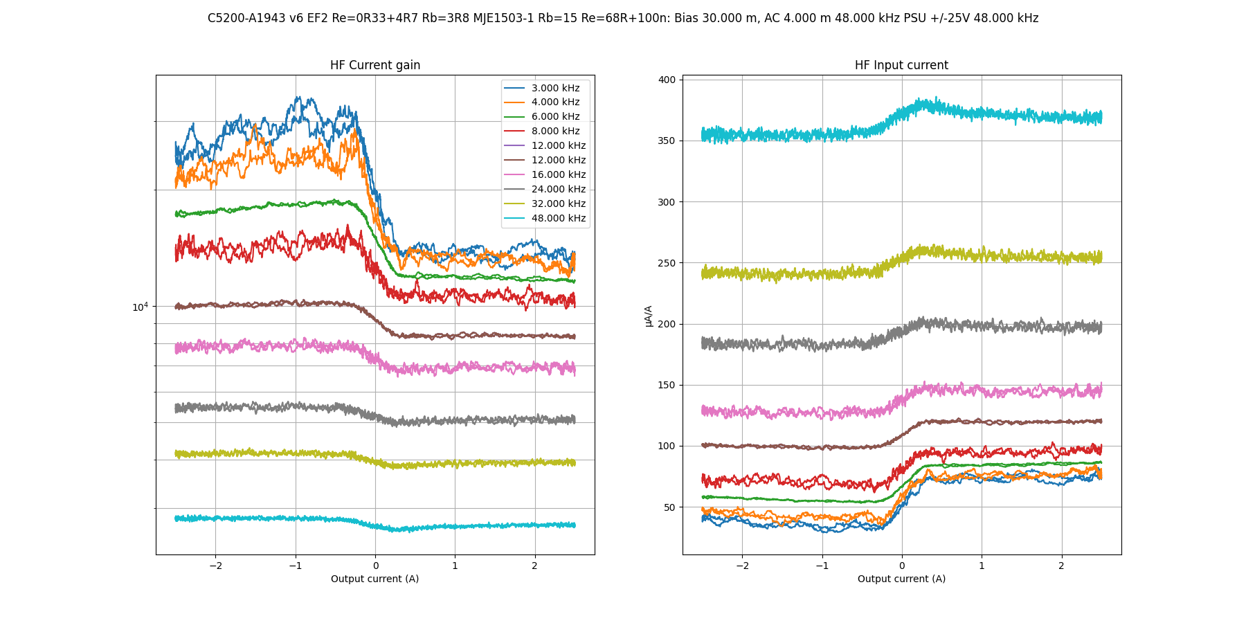

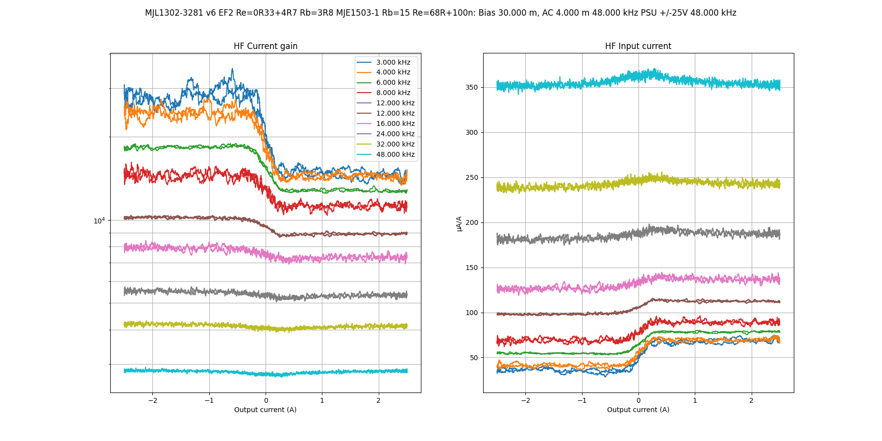

Input current, MJL versus C5200/A1943...
hfe mismatch is a bit worse for the Sankens, they most likely gave the PNP higher gain to compensate for beta droop at high current, which the MJLs do not exhibit.
I don't need huge power or SOA, so the reason I consider it is purely to get away with lower value emitter resistors. Another biasing scheme could also work, there is no shortage of those... Do they work, that's another question...

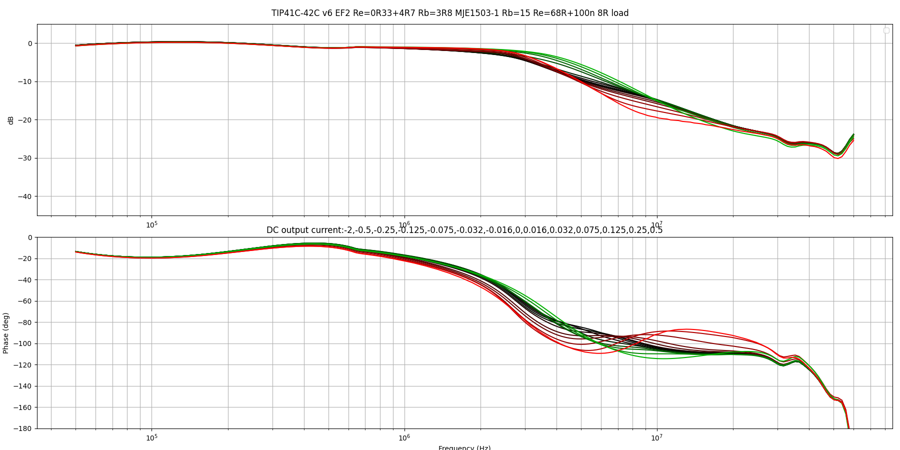

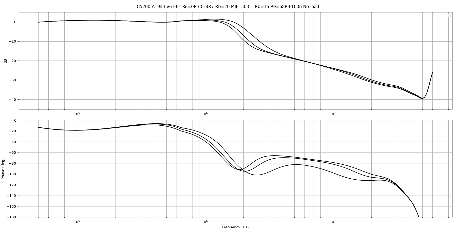

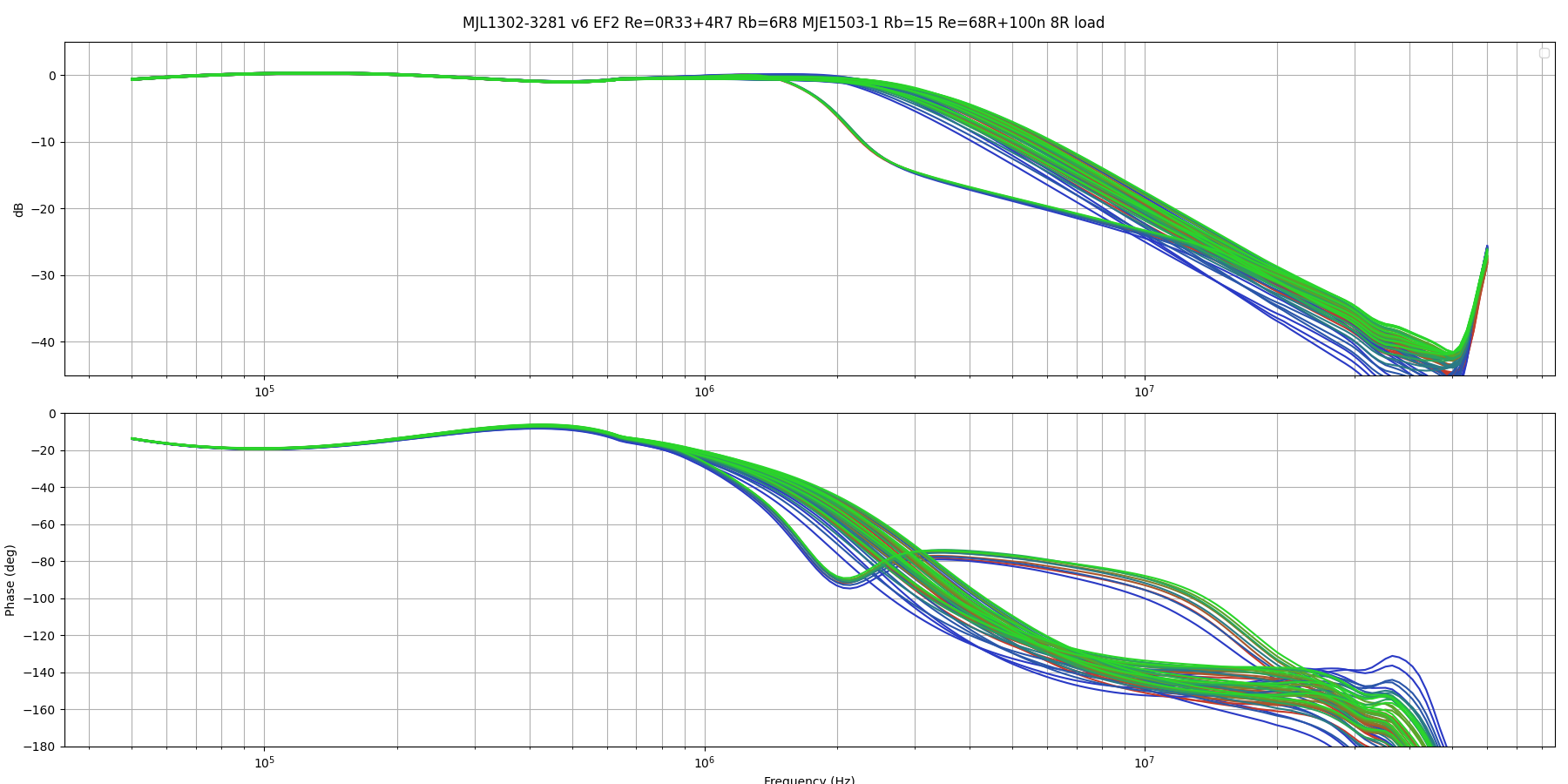

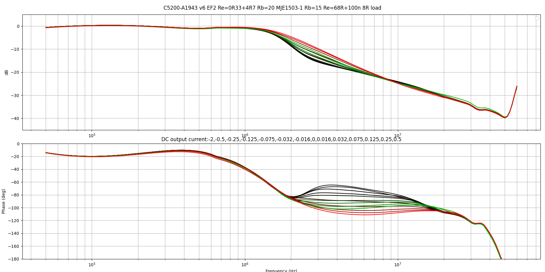

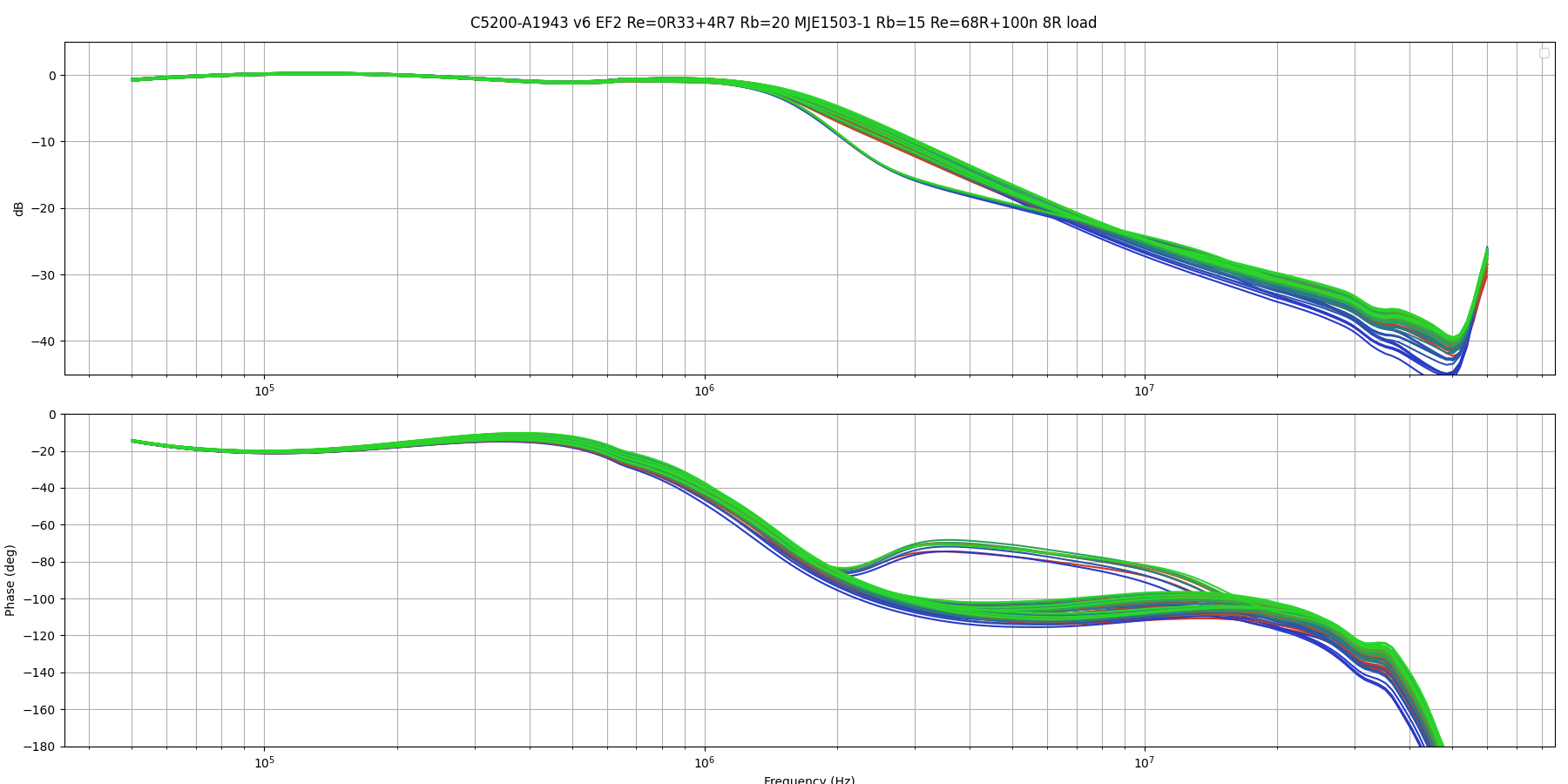

They don't like low base resistor values, 20R is the minimum, below that there is a bump at 1MHz. So some optimization is needed. For now, 15R base resistors for the drivers, 20R for A5200/C1943, plus a ferrite bead, which may be unnecessary.
I had to measure the MJLs again to make sure, but yeah, it's true:
A5200/C1943 are much faster... They are faster than both lateral and vertical MOSFETs too.
First graph shows Vce from 5V to 25V and various DC output current: remarkably consistent, which should make compensation easy, because there is no worst case.
Second graph shows a sweep of DC output current at 25V Vce, same thing.
Third graph shows several values of bias: same thing.

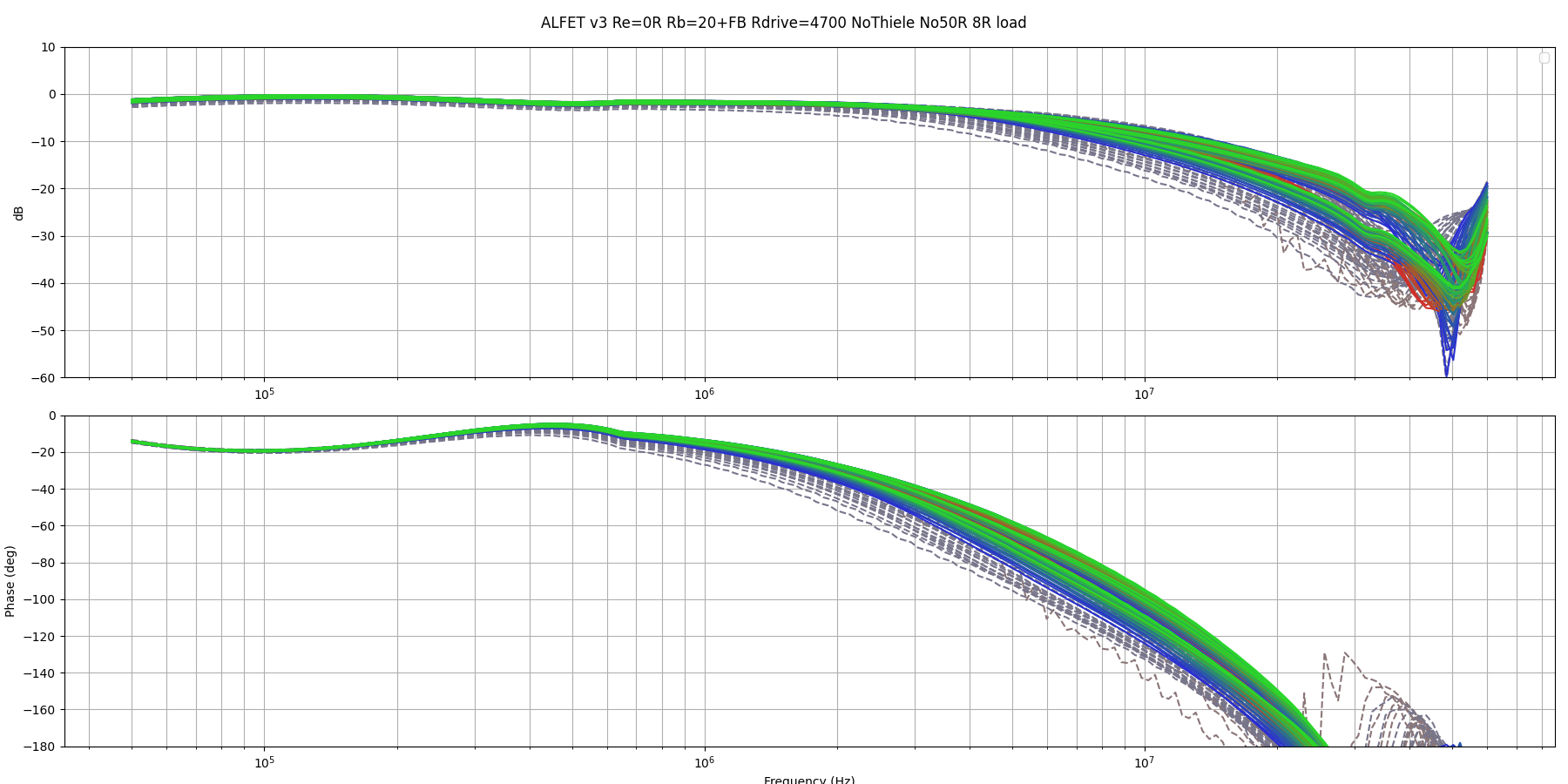

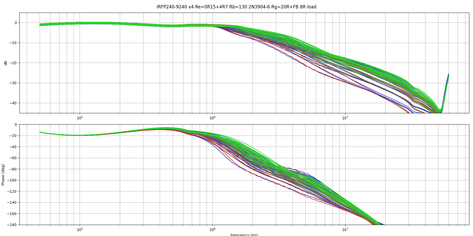

Lath three graphs are MJL, ALFET Laferal FETs, and IRFP240/9240.
The most amazing thing is the phase at 10MHz and above. Where is that second pole?
I need faster drivers.

C5200-A1943 v6 EF2 Re=0R33+4R7 Rb=20 MJE1503-1 Rb=15 Re=68R+100n load.png223.7 KB · Views: 315
C5200-A1943 v6 EF2 Re=0R33+4R7 Rb=20 MJE1503-1 Rb=15 Re=68R+100n 25V load.png171.6 KB · Views: 90
C5200-A1943 v6 EF2 Re=0R33+4R7 Rb=20 MJE1503-1 Rb=15 Re=68R+100n 25V no_load.png122.9 KB · Views: 84

MJL1302-3281 v6 EF2 Re=0R33+4R7 Rb=6R8 MJE1503-1 Rb=15 Re=68R+100n load.png357.4 KB · Views: 81

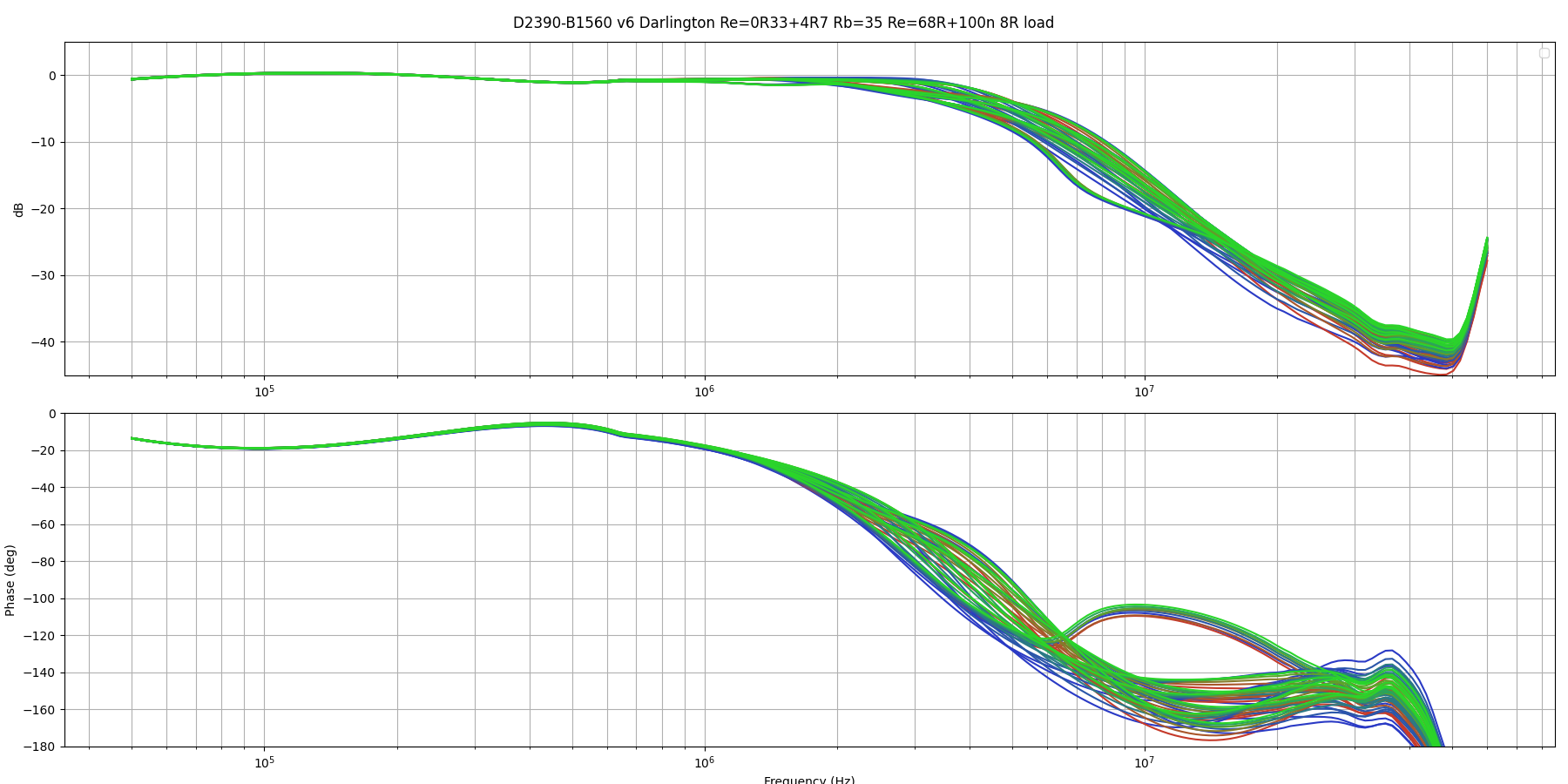

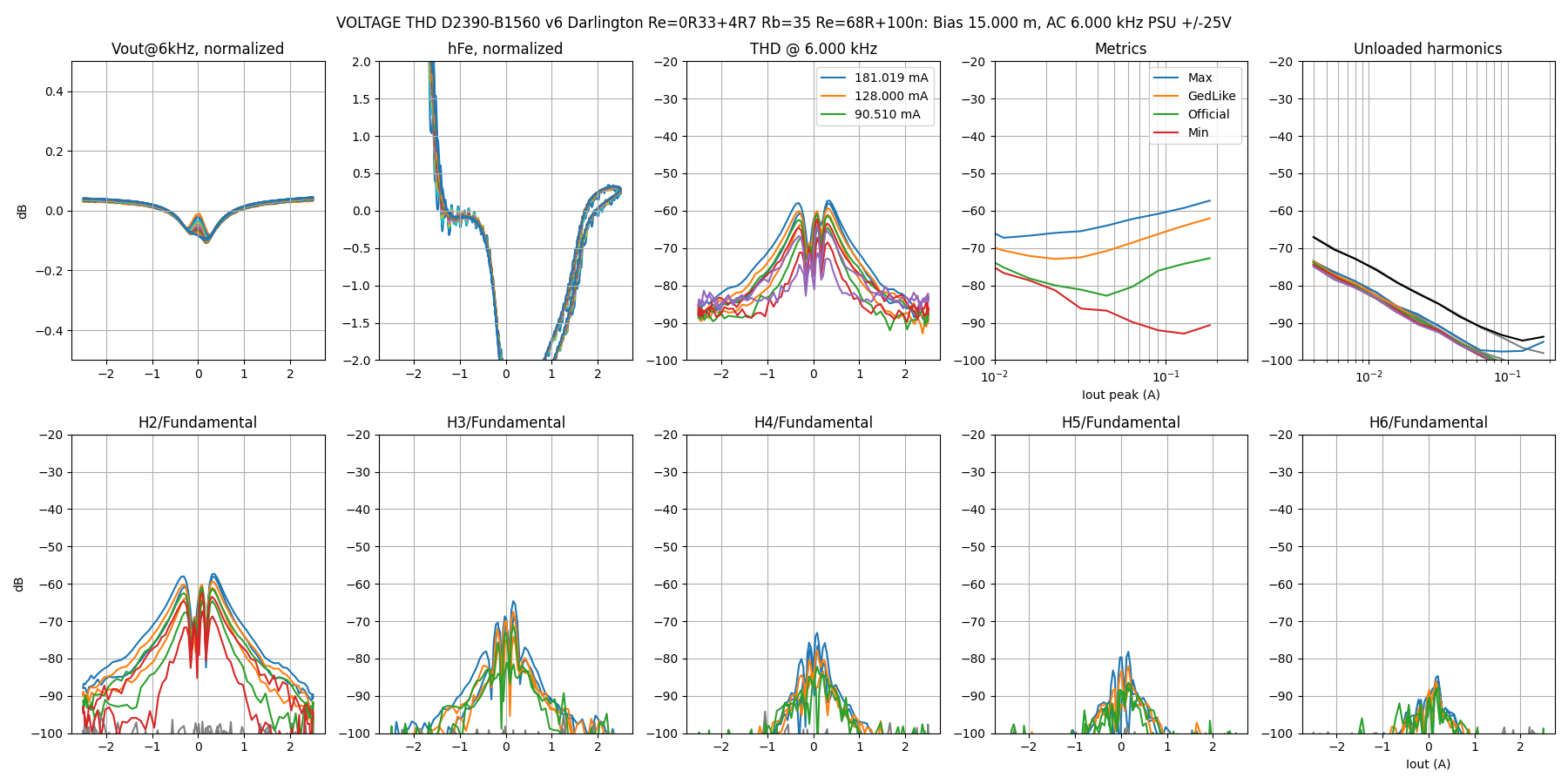

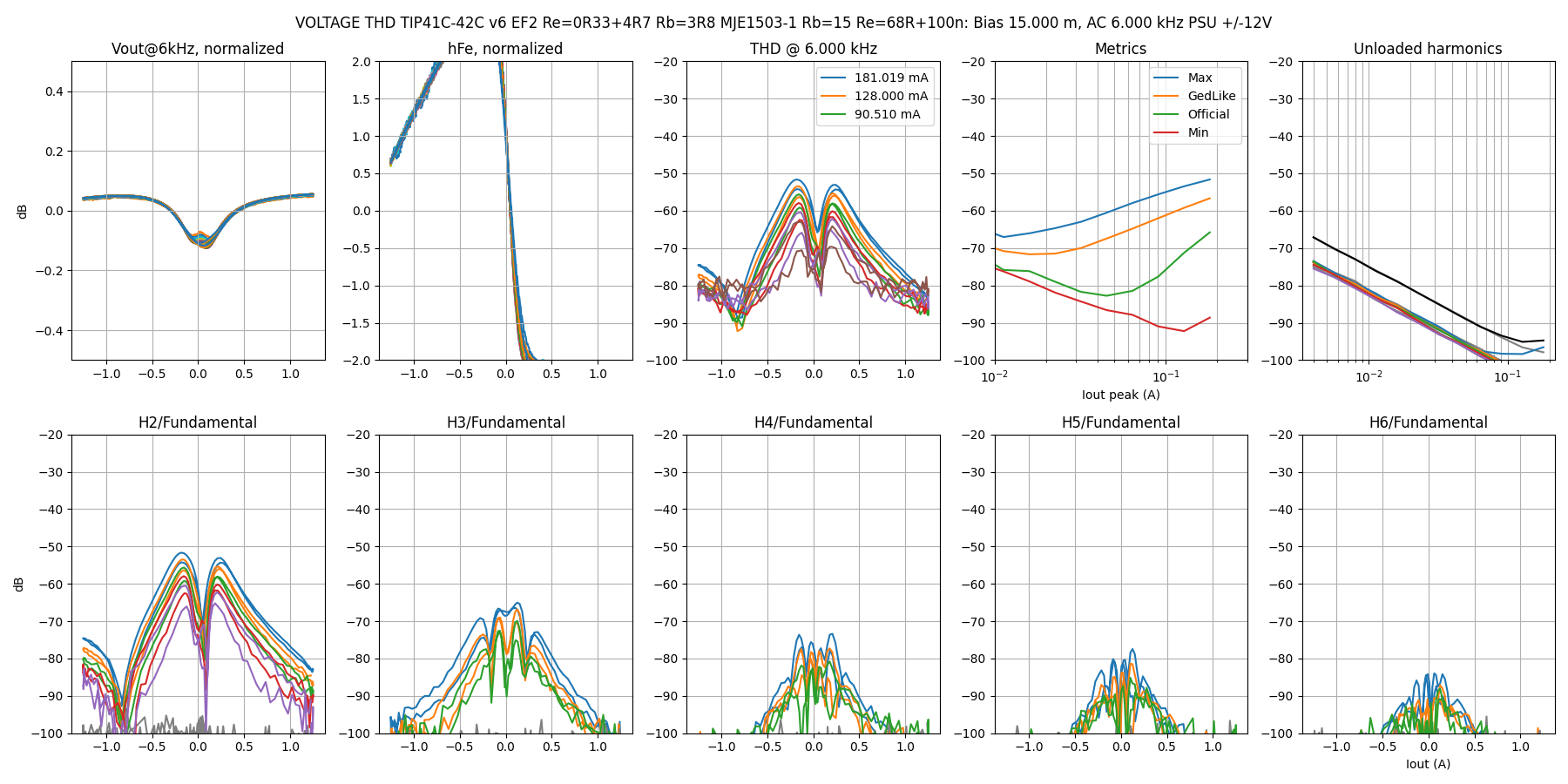

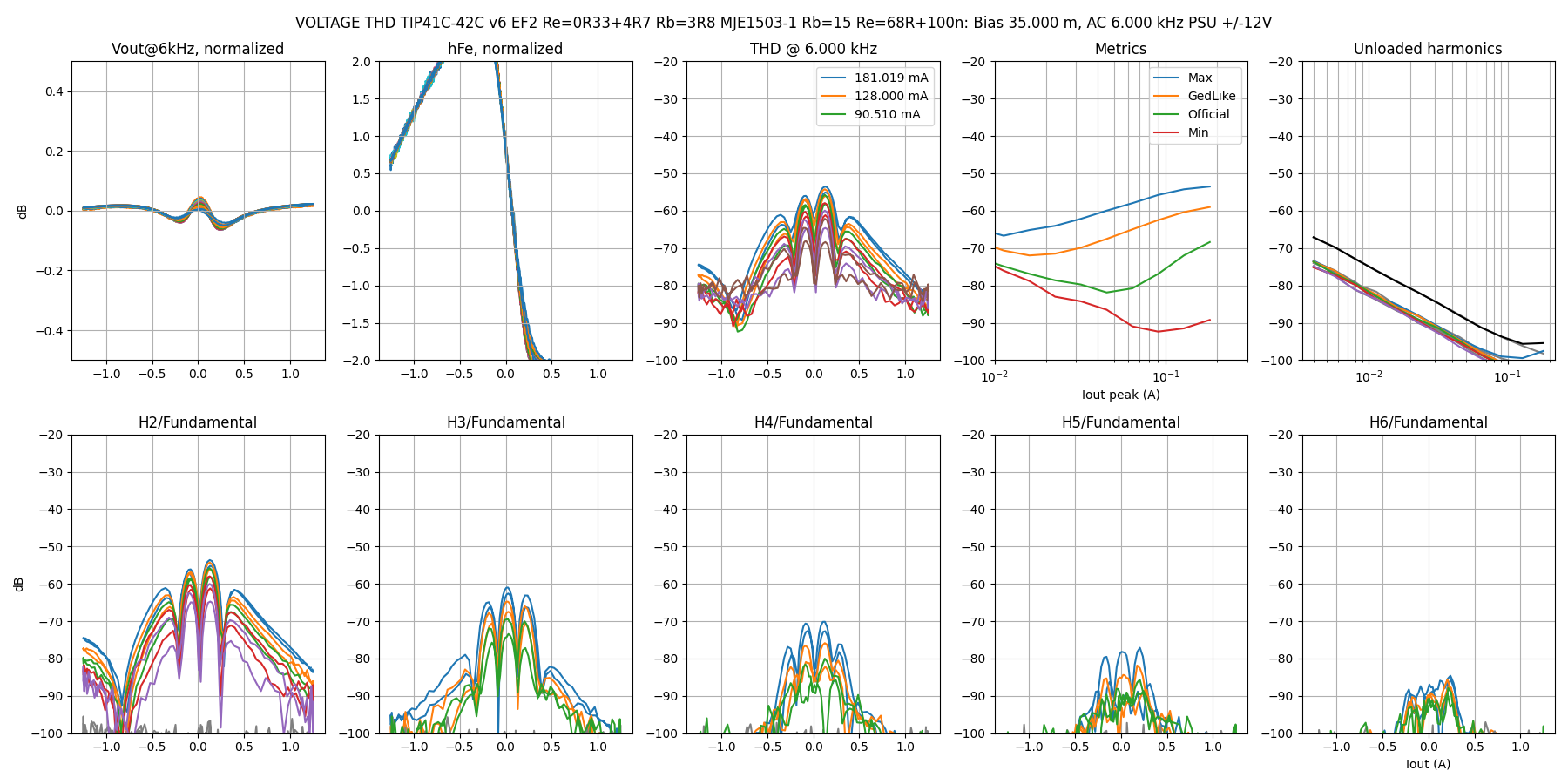

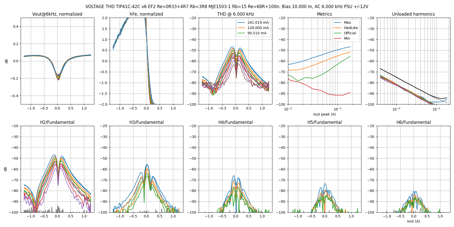

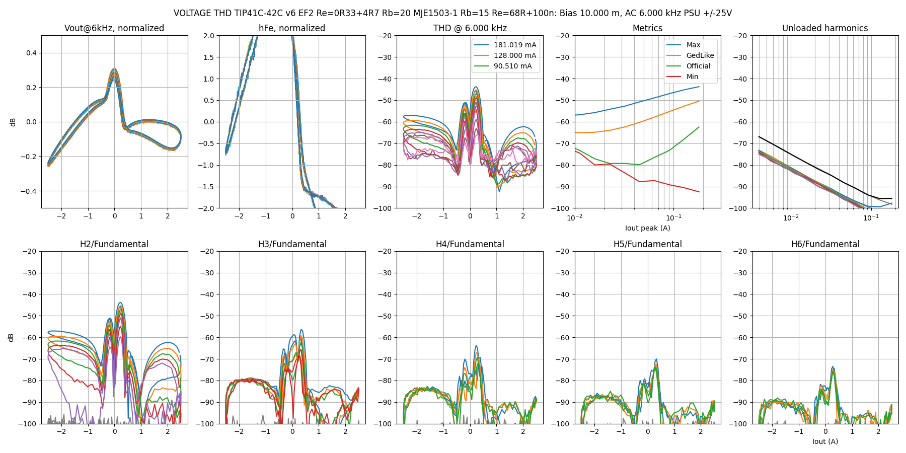

I will go through the backlog of devices I wanted to test...
2SD2390-2SB1560, darlingtons from Sanken.

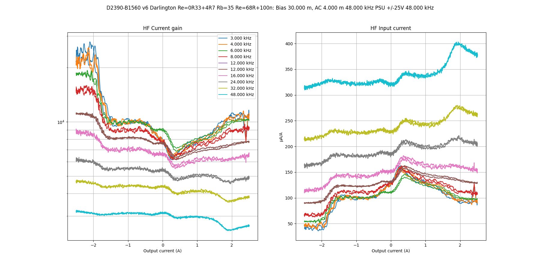

Frequency response is nothing to write home about, and phase shift is quite large. This leads to the usual ULGF in the MHz range. Not for a high bandwidth amp.
Current gain and input current do weird things, the P and N are not well matched.
Distortion is pretty much the same as a DIY darlington with a pair of BJTs.
This is an industrial cost saving measure, to save the labor of affixing drivers to the heatsink. EF2 wins.
