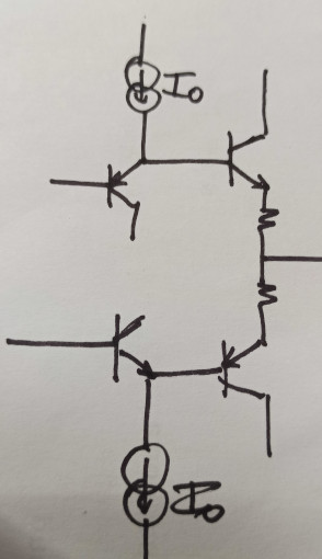

OK let's make sure there are no misunderstandings...
If that's what you mean, then these will need Io = max(Iout)/hFe so if the devices have hFe of 100 to get 5 amps output that needs 50mA CCS, which I think would be better spent in increasing the bias... Unless you meant diamond predrivers, which need a lot less idle current.

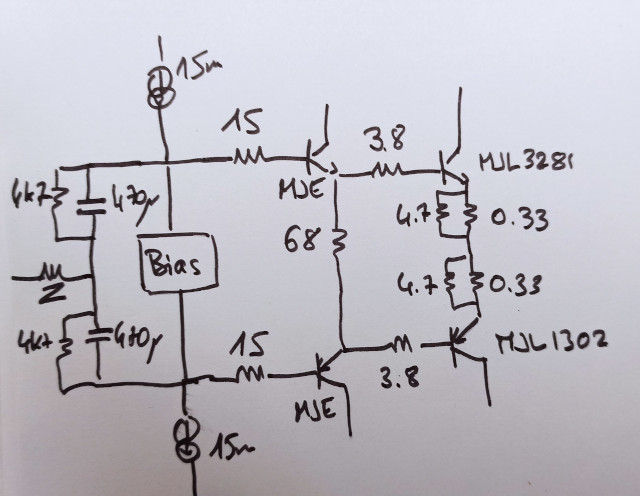

Hi peufeu,
Just set the diamond buffer up as you normally would. I normally see around 50 mA output bias in practice (in the ballpark). But no harm in making the output bias the same as your other output arrangements to compare apples to apples.
![1626885033059.jpg 1626885033059.jpg](https://www.diyaudio.com/community/data/attachments/886/886013-532bc23e8ff3ade9199fd1f234622af3.jpg)
Thanks for the kind comments! Yes, I agree about the art of compromise...
Hi peufeu,
Yes, that is what I meant. Thank you.
However, I am unfamiliar with the diamond buffer type drivers, so can you show me or is it too complicated a circuit to test? I don't want to create a ton of work for you unless there is actual merit in doing something.
Emitters are 0R15 like everything else? (Good!)
It's not a complicated circuit, but what bothers me is the fact the drivers are burning a lot of current idling. Since they're upside down, they can only substract current from what the current source provides to feed base current to the power devices, so the current source needs to be sized for "maximum base current of all time"...
0R33 for the bipolars, keeps the bias more stable.

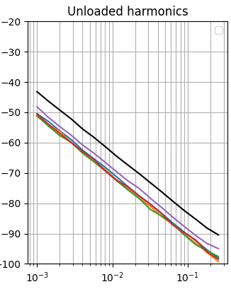

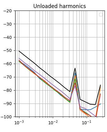

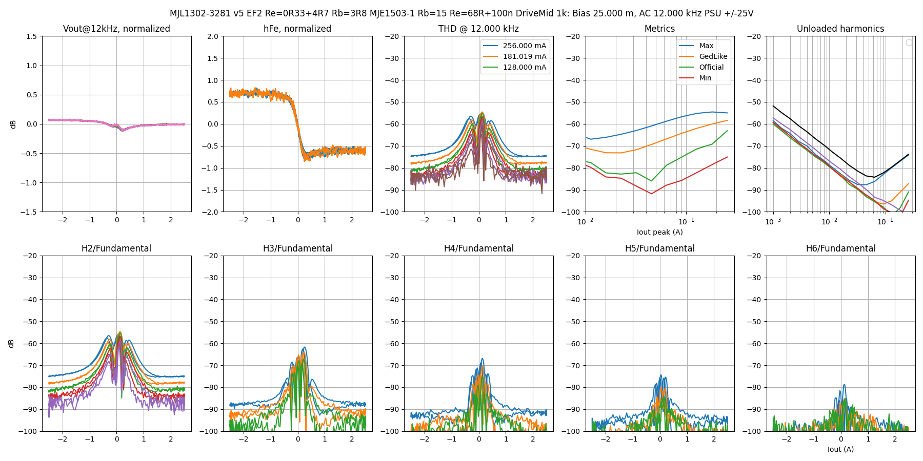

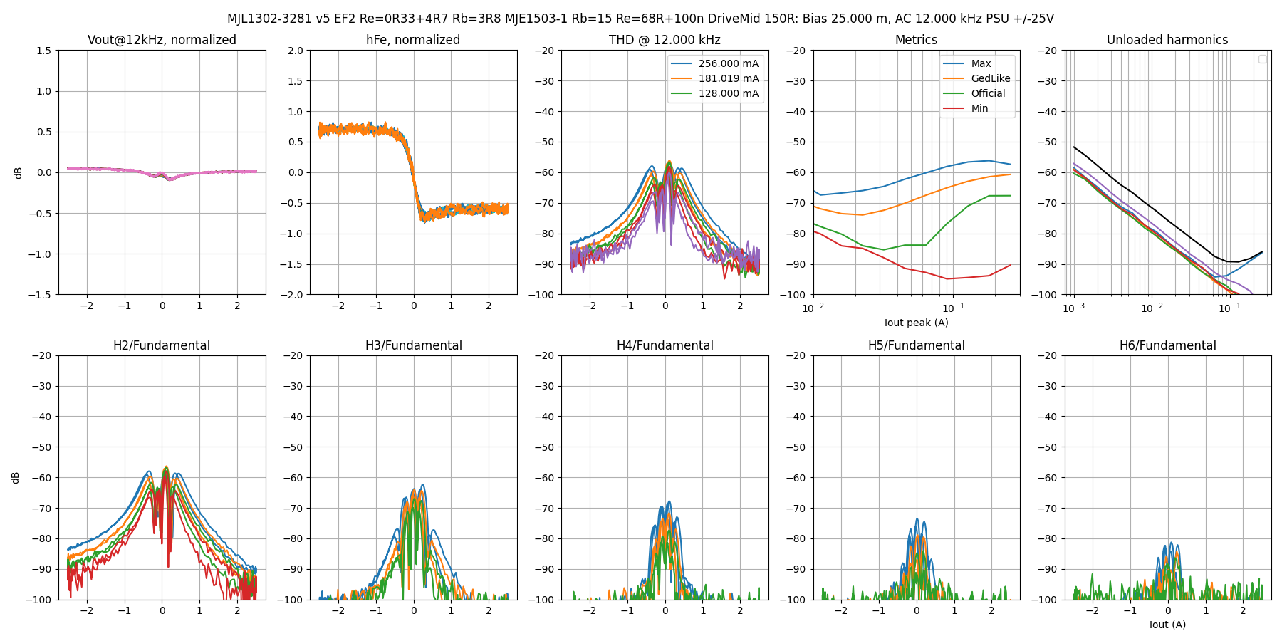

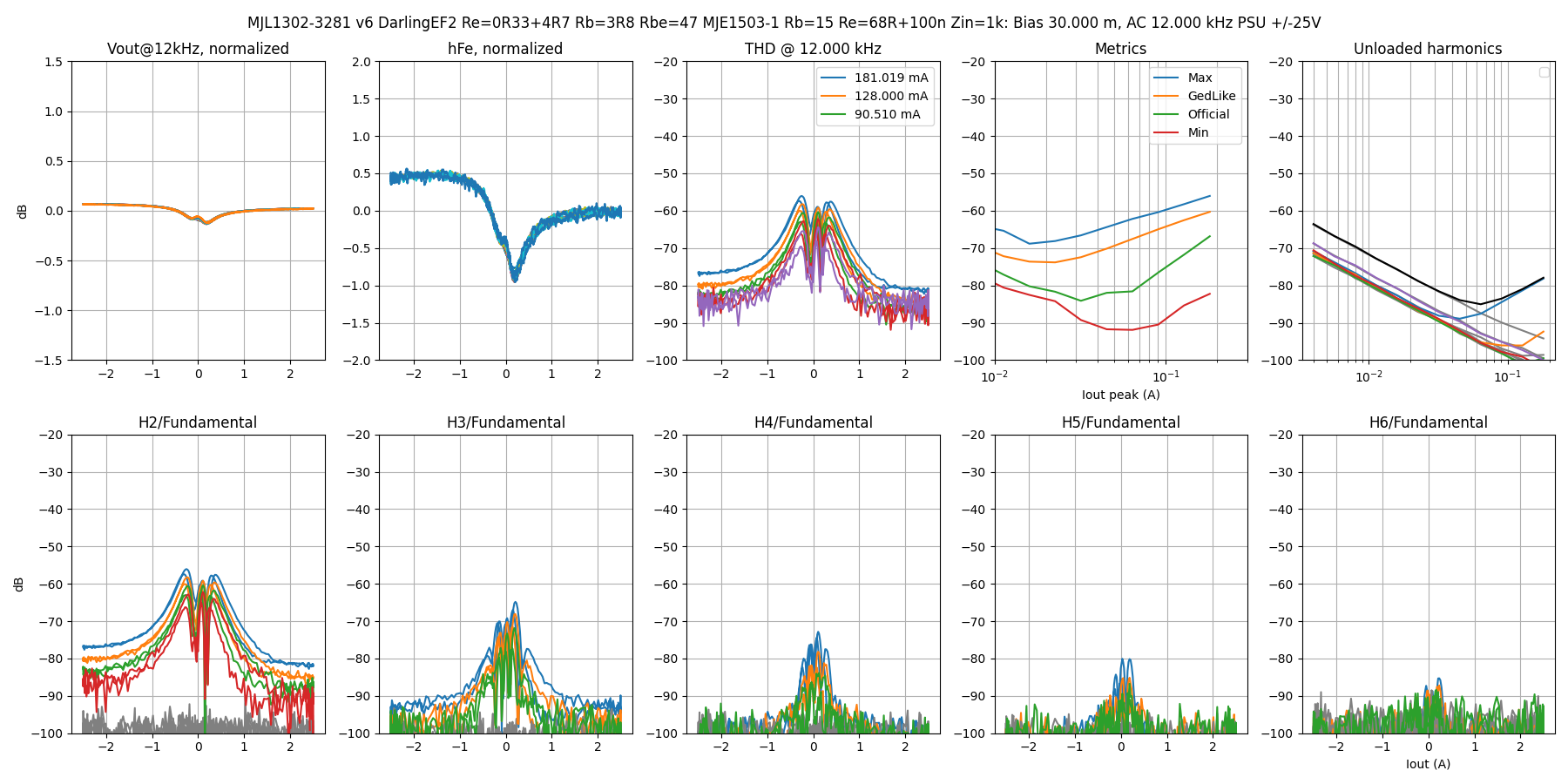

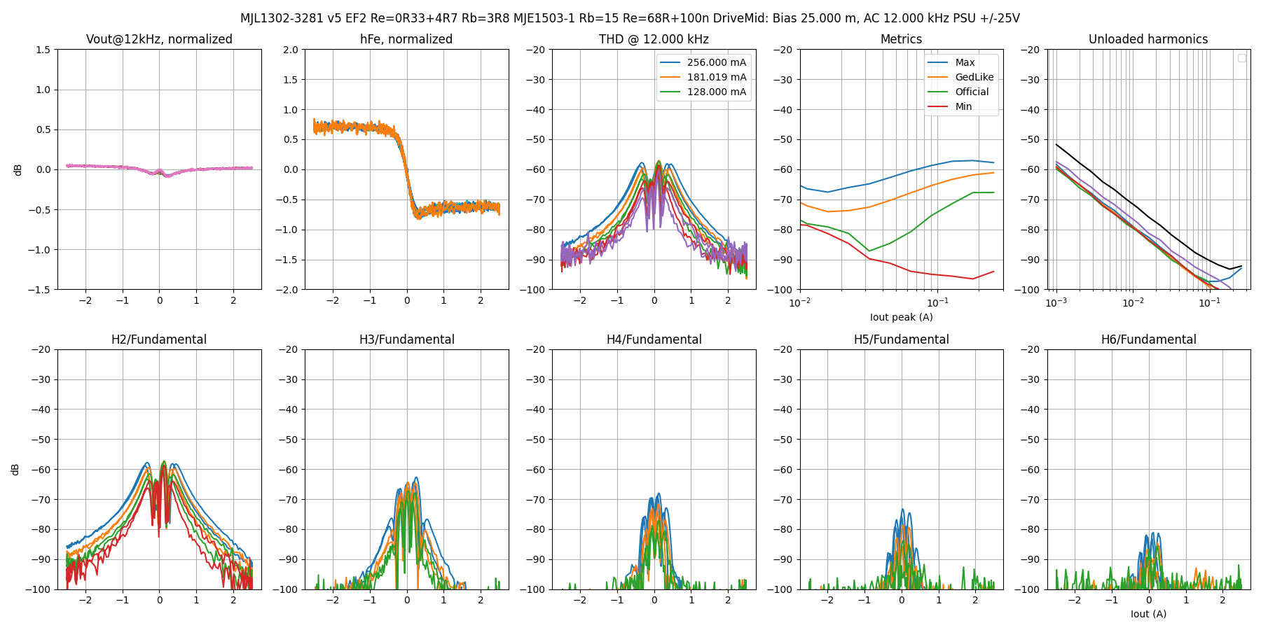

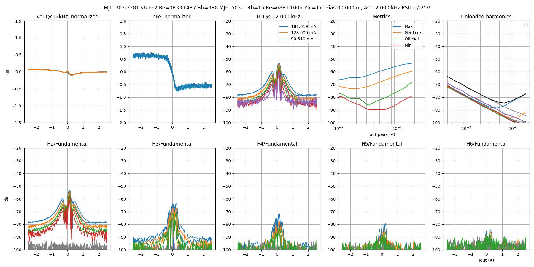

Alright, we're back in business.
Here is what is being tested:
Since we had a debate about the VAS output impedance... Well I can't tell how big yours is, but I can put in different resistor values in the place labeled "Z" on the left of the schematic, which is in series with the TPA6120 composite amp driving this thing, and that will tell us what happens when the VAS (or predriver) output impedance varies between 10R, 150R, 1k. The value is in the title of the plots before the word "Bias".
In this test the DUT is driven from the input with 12kHz sine of varying amplitude.
- Load is 8R
- The large DC operating point current of the output stage (from -2.5A to +2.5A) is on the X axis of all the graphs except the top right two
- Upper left plot is the output amplitude at 12kHz, that varies because the output impedance of the DUT (=1/gm) forms a divider with the 8R load, so it is basically gm plotted in dB. It is normalized to 0dB to make it easy to compare between different circuits while switching between pictures. No surprises: since current gain depends on polarity of output current, increasing the driving impedance tilts the high current sides of this plot up and down.
- "hFe" plot is the current gain of the output stage, again normalized and in dB for easier comparison.
- "THD" is the sum of the harmonic plots below which each represent one harmonic of the 12kHz signal ; all distortion plots are in dB relative to fundamental
- "Metrics" is various ways of turning this THD into an easily digestible number. X axis is the amplitude of 12kHz current, and the plots are the max and min THD at all output currents, the THD close to zero output current which would be the "official" measurement, and a "GedLike" weighted average.
- "Unloaded harmonics" is the harmoncis (in color) and THD (in black) of the 12kHz tone through the output stage without 8R load on the output.
Results:
150R driving impedance gives a slight increase in distortion vs 0R
1k driving impedance gives a substantial increase in distortion at high output current, therefore far from the crossover region: this is most likely due to nonlinear input capacitance and Early effect. But in the crossover, the hFe variation between both devices only increases distortion a bit. At 150R gm dominates distortion, and I'd say at 1k both gm and hFe variations contribute equally.

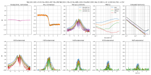

![1626936973688.jpg 1626936973688.jpg](https://www.diyaudio.com/community/data/attachments/887/887532-33e9c66625f9976756ebbe4aeb5c7647.jpg)
- Load is 8R
Results:
thd-MJL1302-3281 v5 EF2 Re=0R33+4R7 Rb=3R8 MJE1503-1 Rb=15 Re=68R+100n DriveMid-B=25.0m,HA=4.0m,.png261.8 KB · Views: 341
thd-MJL1302-3281 v5 EF2 Re=0R33+4R7 Rb=3R8 MJE1503-1 Rb=15 Re=68R+100n DriveMid 150R-B=25.0m,HA=.png263.8 KB · Views: 325
thd-MJL1302-3281 v5 EF2 Re=0R33+4R7 Rb=3R8 MJE1503-1 Rb=15 Re=68R+100n DriveMid 1k-B=25.0m,HA=4..png308.5 KB · Views: 341

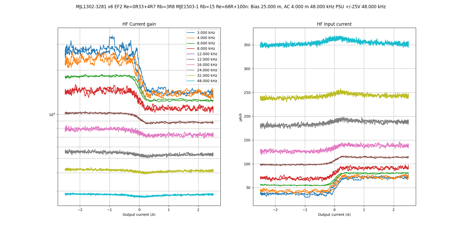

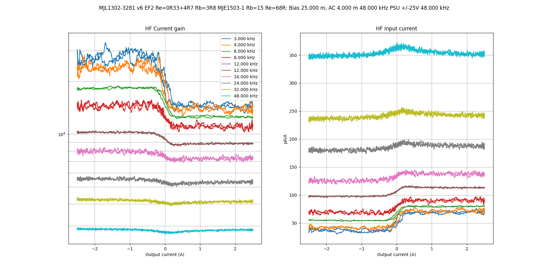

Does the 100nF cap between the driver emitters help with the hFe mismatch?
Answer: no, it is there only to help turn-off. No difference in the input current with and without the cap.
Note hFe mismatch of both halves of this output stage depends on frequency. At high frequency they match, at low frequency they have quite large mismatch. I'm not sure of the cause, but well, at low frequency the mismatch is only due to hFe, and at higher frequency the various capacitances and transition frequencies come into play, and there is no reason for both hFe and capacitance to have the same matching (or mismatch).
So, feedback increases at low frequency, but this error also increases accordingly, which means it's a draw.
Also this frequency dependent behavior adds difficulty to trying to correct it...

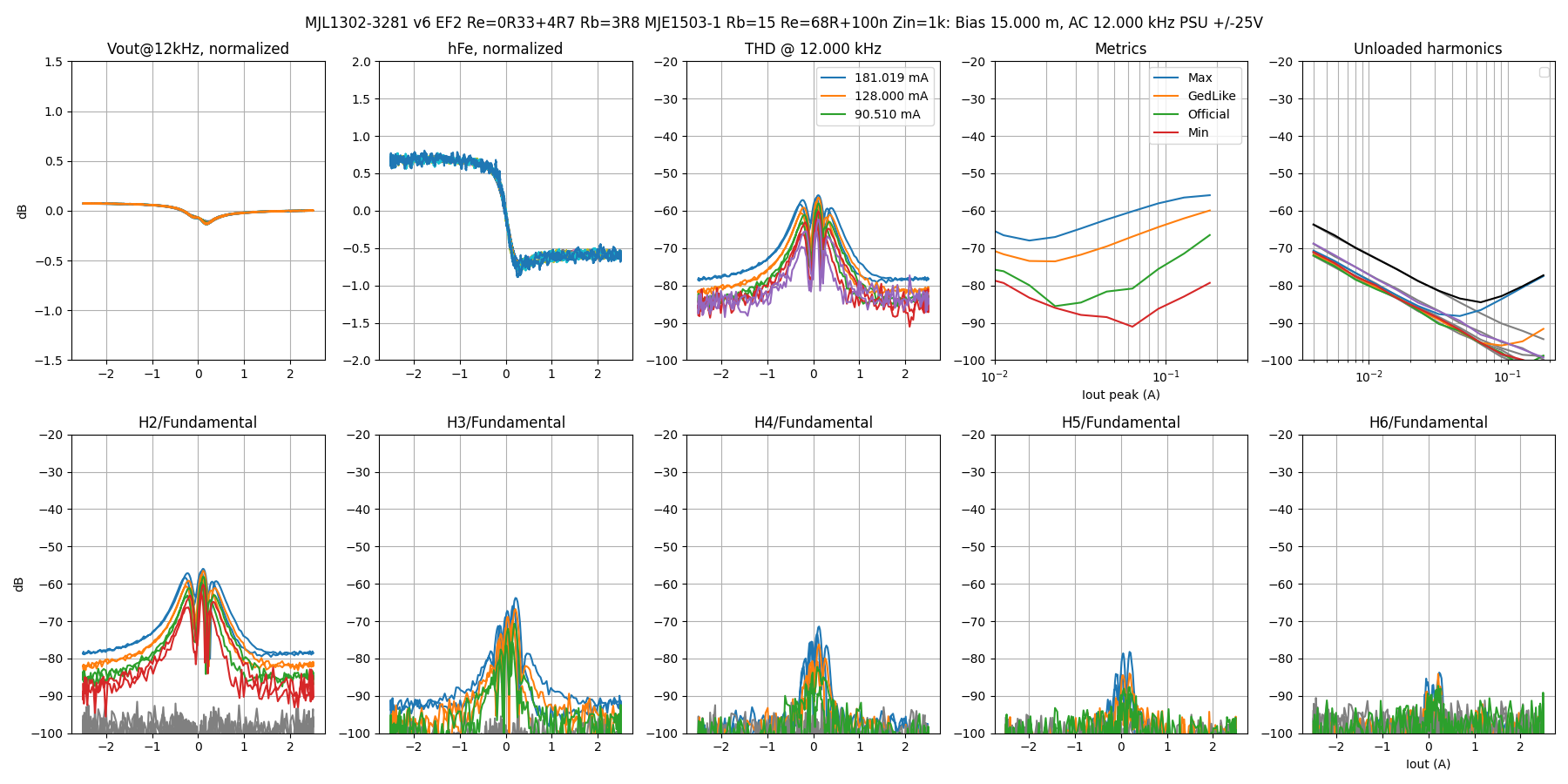

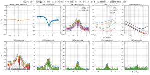

Alright. After comparing the influence of VAS output impedance on the EF2, I'll also do it on the "DarlingEF".
Since the pure Darlington sucked too much at turning the transistors off in the dynamic test, I made a "DarlingEF" by starting with the EF2 in the previous post, and adding two 47R resistors across the B-E of the power devices. I left the 100nF cap and the 68R resistor in. This gives the same gm and current gain as the darlington, but the drivers don't turn off and it has better dynamic behavior.
Due to the resistors across the B-E of the power devices, some of the driver bias current now counts as total bias, and there is a temptation to just leave the drivers on at idle, turning off the main transistors.
This is a bad idea.
Since it's real cheap to save a couple milliamps, I also tested with a cheap 1K VAS output impedance, versus EF2 at the same bias and same conditions.
It is not even necessary to enlarge the thumbnails to see which one has highest distortion...
This is a bad idea.

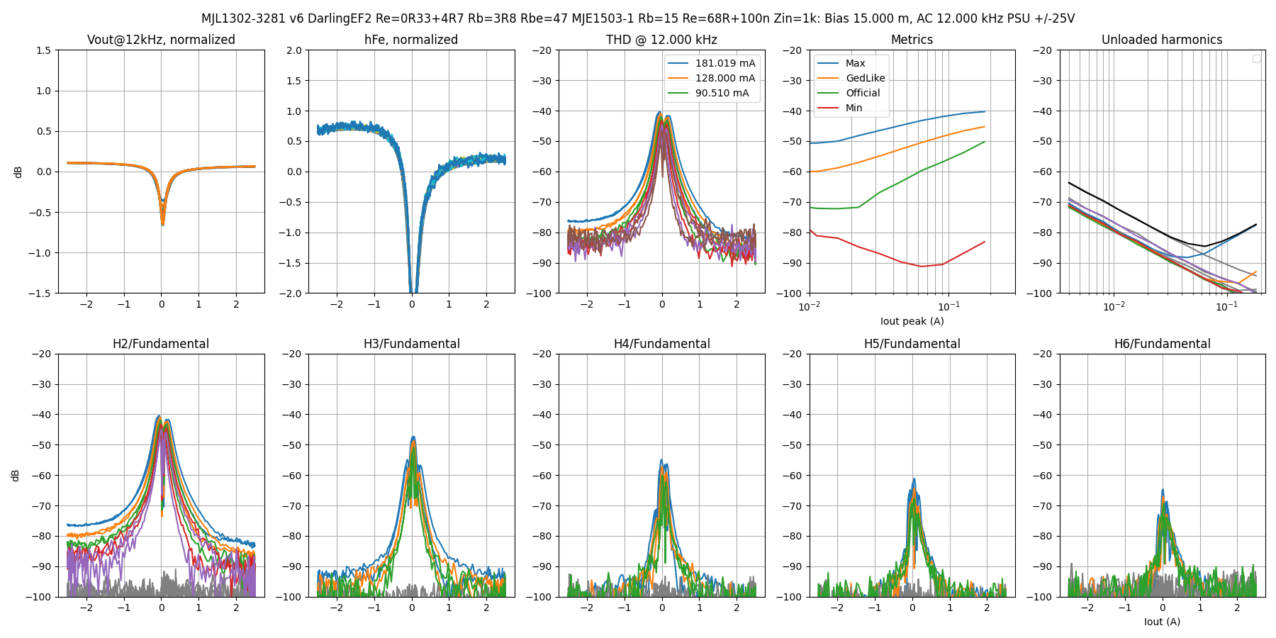

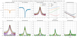

One interesting feature of the Darlington (and DarlingEF) is that its current gain is flatter than that of the EF2.
So, I stepped the bias until the high order harmonics no longer went further down, which gives close to optimal bias, in this case 30mA, and I compared it to EF2, again with 1k VAS impedance...
In addition, both have 18mA driver bias due to the 68R resistor between driver emitters. The plot titles only mention bias current through the power emitter resistors, which is what the ADC measures.
Result:
At 30mA bias, DarlingEF gives more distortion than EF2.
At 15mA bias, DarlingEF collapses (previous post) but EF2's performance is not significantly worse than at 30mA.
Conclusion: EF2 gives the same performance at half the bias, which is a win.
I think this is due to the fact the drivers are less loaded in the EF2, so they distort less (ie, gm is flatter).
Result:
thd-F=12k-MJL1302-3281 v6 DarlingEF2 Re=0R33+4R7 Rb=3R8 Rbe=47 MJE1503-1 Rb=15 Re=68R+100n Zin=1.png287.5 KB · Views: 101
thd-F=12k-MJL1302-3281 v6 EF2 Re=0R33+4R7 Rb=3R8 MJE1503-1 Rb=15 Re=68R+100n Zin=1kB=30.0m,HA=4..png279.6 KB · Views: 66
thd-F=12k-MJL1302-3281 v6 EF2 Re=0R33+4R7 Rb=3R8 MJE1503-1 Rb=15 Re=68R+100n Zin=1kB=15.0m,HA=4..png281.1 KB · Views: 68
- Power amp OUTPUT STAGE measurements shootout
