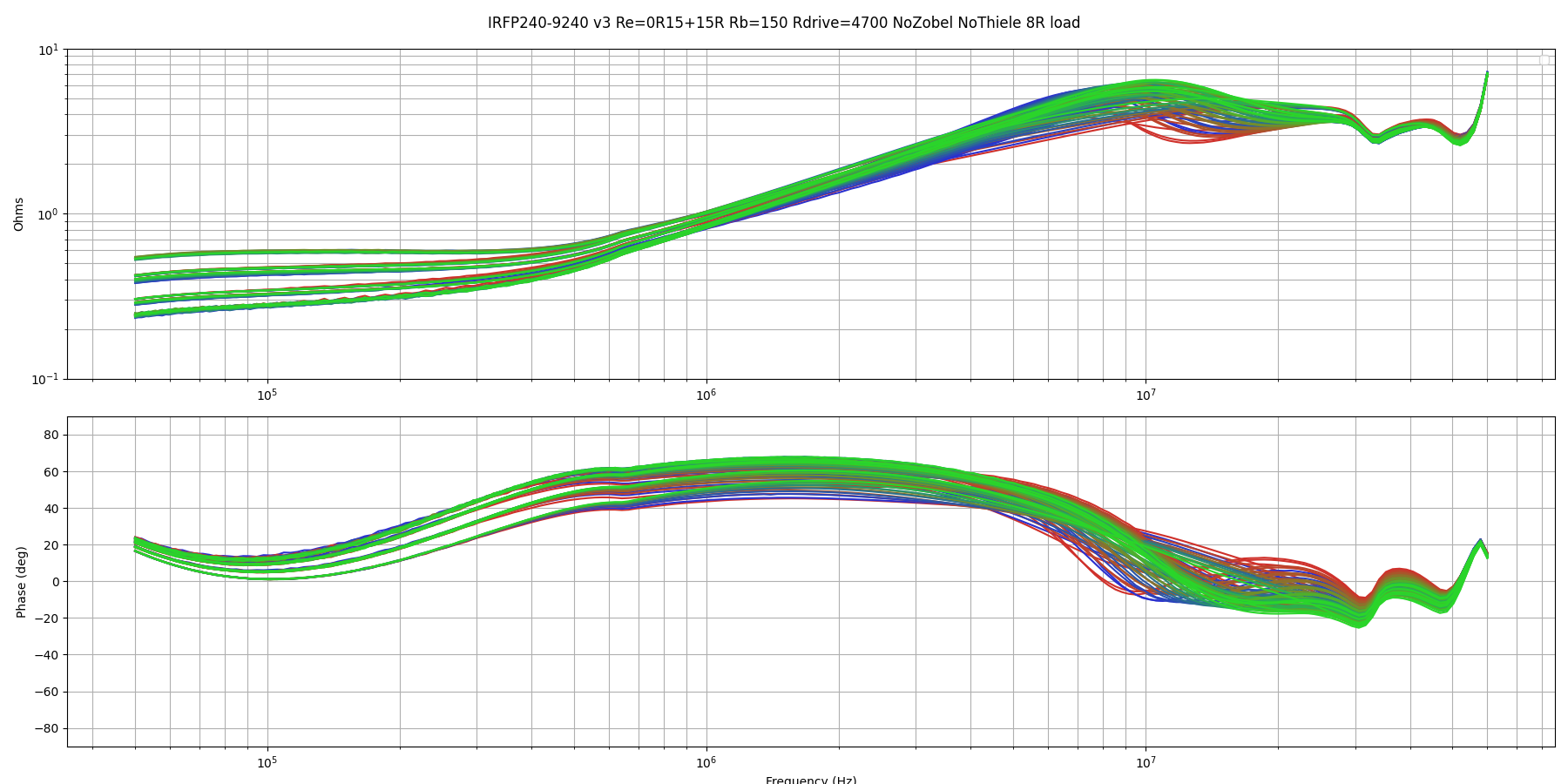

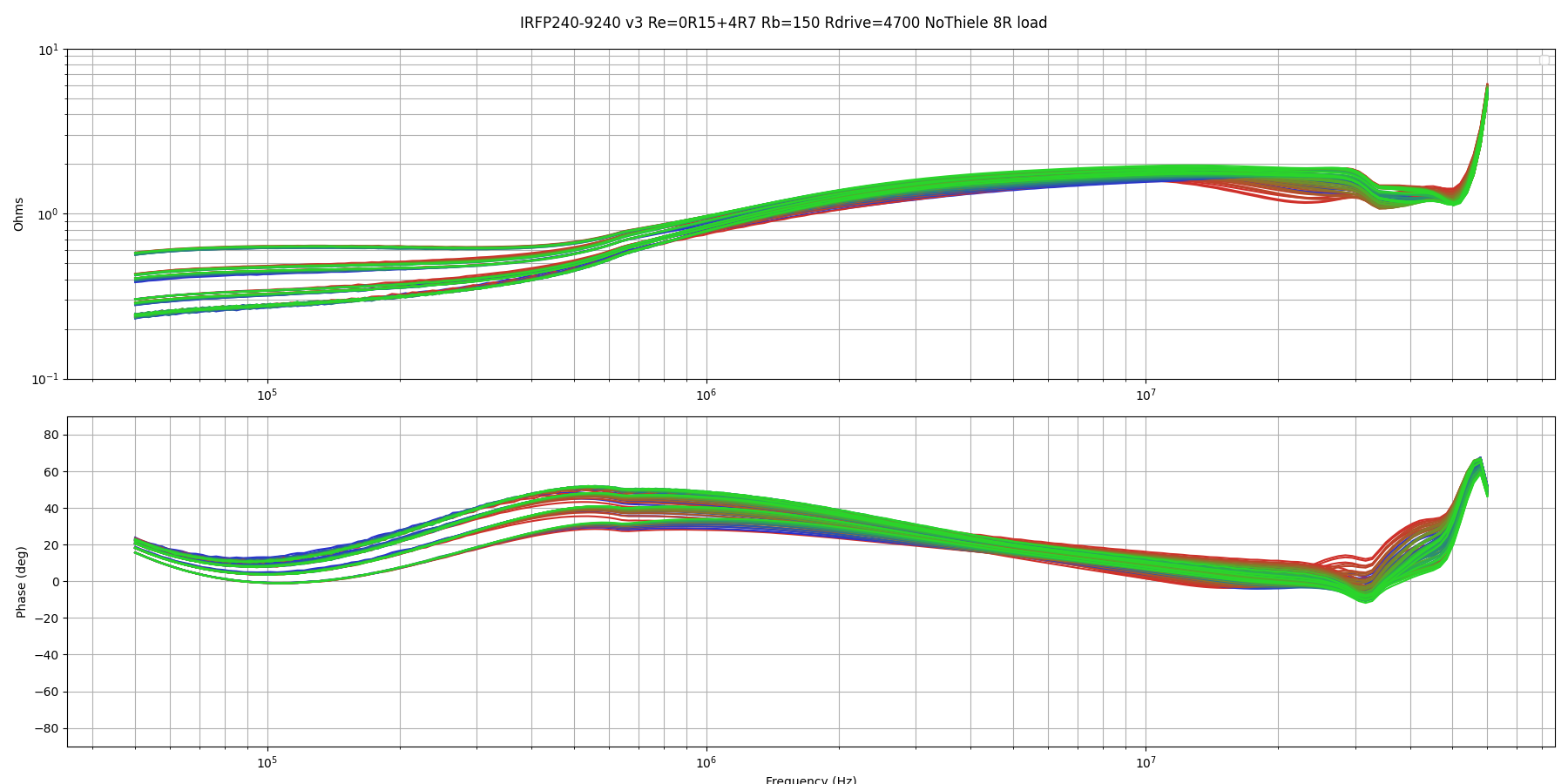

I will try to increase the value of the SMD resistor I put in parallel with the big inductive ones.
aaand... with 4R7 in parallel, the magic disappears and the peaks come back. Not enough damping. So with this particular circuit, layout, and resistor inductance it has to be 1 ohm...
I think the best value depends on the inductance of the wirewound resistors which is not specified in the resistors datasheet, so it would be a shot in the dark to attempt that as a tweak.
But I agree with anatech that non inductive resistors solve the problem, either the expensive flat ones, or you can DIY a non inductive resistor by cutting a small piece of blank copper clad pcb, cutting the copper in two halves, and soldering enough SMD resistors on it...

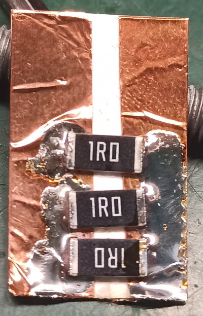

I was curious, so I made one with a bit of cardboard and some copper tape.
It's a 0R15 resistor with an inductance of about 2nH. Mounted vertically it could even dissipate a few watts ; the copper tape makes a nice heat sink, it burned my fingers while I held it by the edge soldering it. Could make tiny PCBs like that from a cheap fab like jlcpcb...
![1626727684320.jpg 1626727684320.jpg](https://www.diyaudio.com/community/data/attachments/881/881832-8d2f9a8564a3fa2cd8ba0a993c16e923.jpg)
CORRECTION
I wanted to put in the lateral FETs this morning, and then I saw one of the 4R7 resistors was not properly soldered. This means the previous HF test with 4R7 is absolutely wrong. Since the SMD resistor did not make contact, it is not surprising that it gave the same result as the test without the SMD resistor! Well this mistake still gives information: with only the inductive emitter resistors, the peak also manifests in the output impedance, not just in the input/output transfer function, which is logical.
So I fixed the solder joint and re-ran the test : it gave a very smooth spectrum.

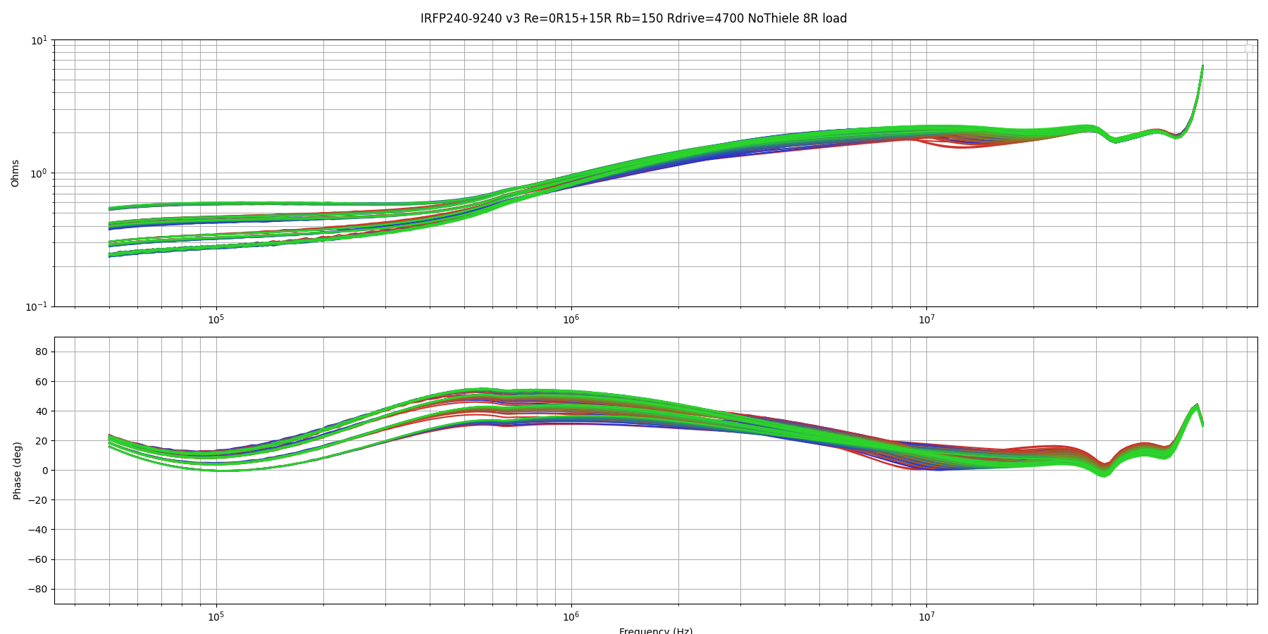

I ran it again with 15R resistors in parallel with the inductive 0R15 resistors : again, no problem at all.
Attached is output impedance with 4R7 and 15R resistors. There is a small soft peak in the region of interest, which hints that values above 15R would not provide enough damping.
Also a test without the output Zobel network (100n+4R7). This shows no gremlins, so messing with the emitter resistors could perhaps allow to get rid of the Zobel network.
So there seems to be quite a lot of flexibility in the choice of the resistor value.

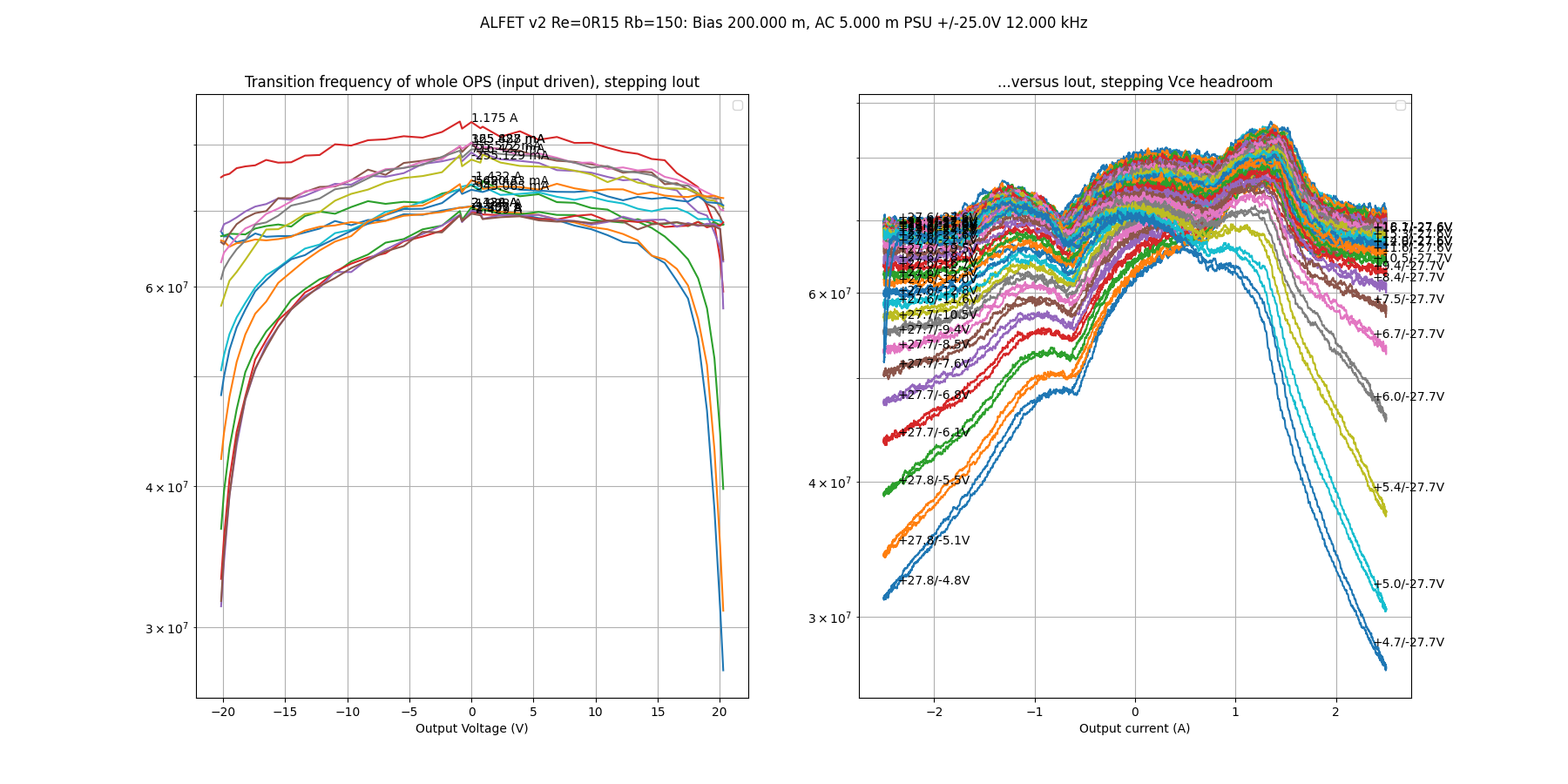

Time for laterals.

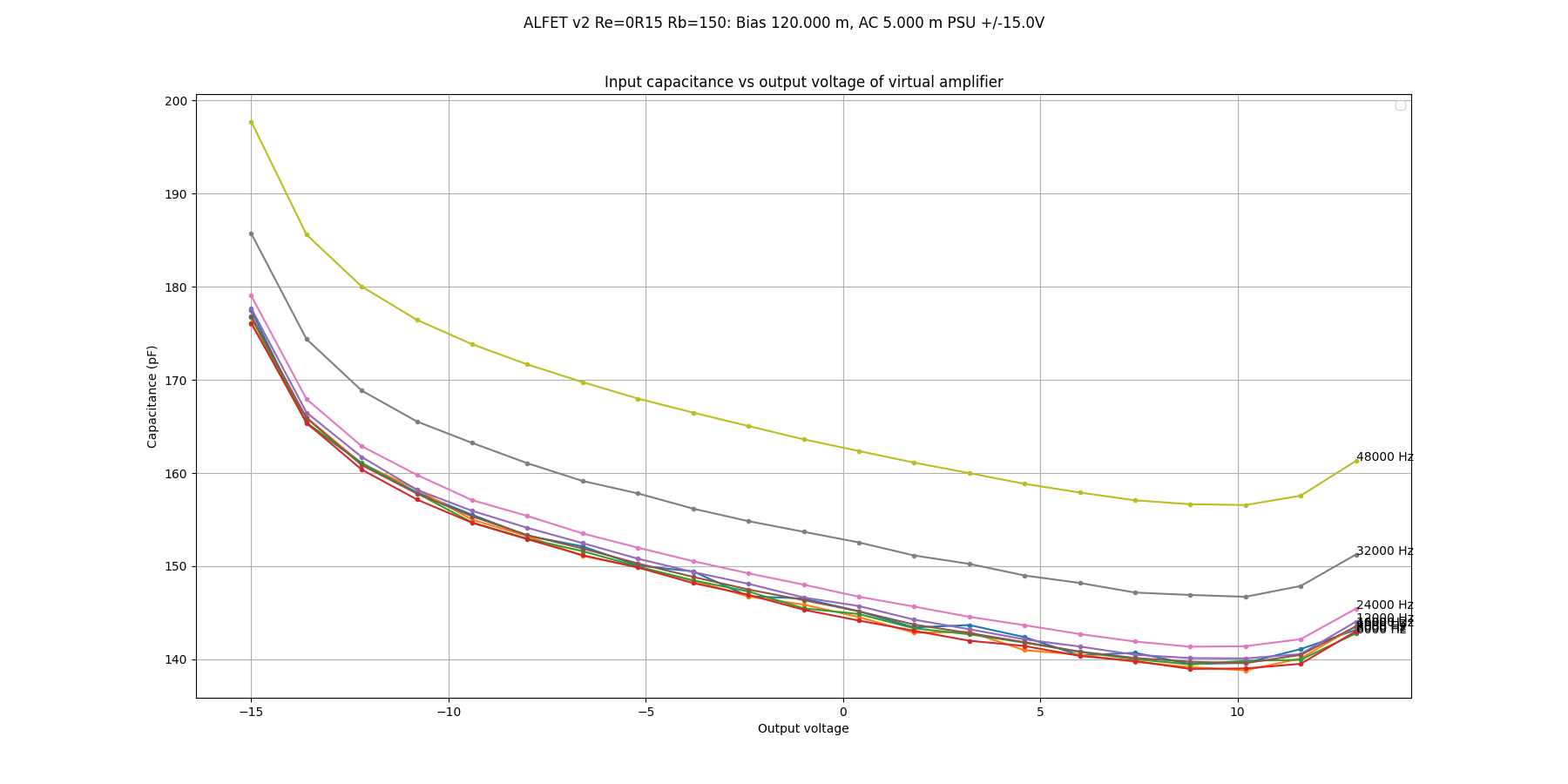

While the input capacitance of the N and P channel IRFP FETs was well matched, this is not the case for the laterals. The P-ch capacitances increases much more as it loses headroom.
Since it doesn't have higher gm to compensate, this is visible on the fT plot on the left too.

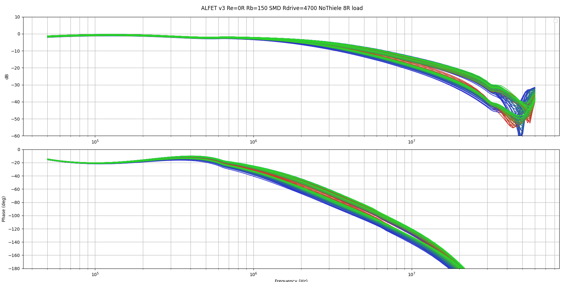

So, the network analyzer gives two series of distinct curves. Green color shows when both FETs have ample voltage headroom, and there are two distinct sets of green curves, depending on which FET is ON (which one is on depends on polarity of output current, not output voltage).
Previously I had put a ferrite bead on the source, without these FETs would oscillate. In this case I have lifted the pin of the FET off the PCB and soldered a 130R SMD gate resistor right there. It seems to be as effective as the ferrite bead at preventing oscillation.
I will do another run with the ferrite bead then compare the laterals and IRFPs.
![input cap-ALFET v2 Re=0R15 Rb=150-B=120.0m,HA=5.0m,LA=2500.0m.png input cap-ALFET v2 Re=0R15 Rb=150-B=120.0m,HA=5.0m,LA=2500.0m.png](https://www.diyaudio.com/community/data/attachments/882/882723-90d45f5d52a177669a0ec64c1797ac1f.jpg)
![ft-ALFET v2 Re=0R15 Rb=150-B=200.0m,HA=5.0m,LA=2500.0m-F=12k.png ft-ALFET v2 Re=0R15 Rb=150-B=200.0m,HA=5.0m,LA=2500.0m-F=12k.png](https://www.diyaudio.com/community/data/attachments/882/882730-4ea7fd8471f3366033ceca0ce9978743.jpg)

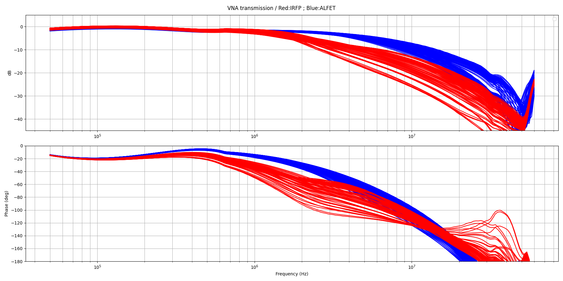

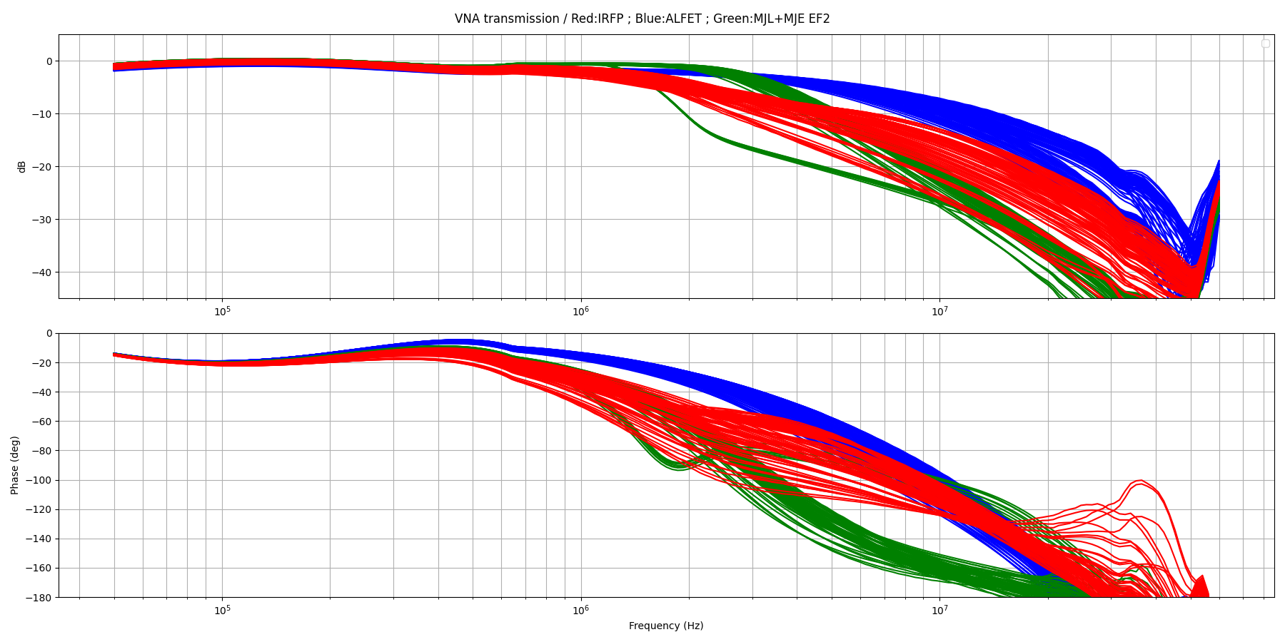

Here is the HF plot for IRFP versus ALFET, both driven from "as low as it would go" impedance, that's 50R from the network analyzer, 20R gate resistor, and ferrite bead.
While the ALFETs definitely have lower capacitance and it shows, the second pole is quite similar for both, which means the extra speed of the ALFETs may not actually be usable, as both would want ULGF below 10MHz. So the verticals are still winning based on lower high order harmonics.

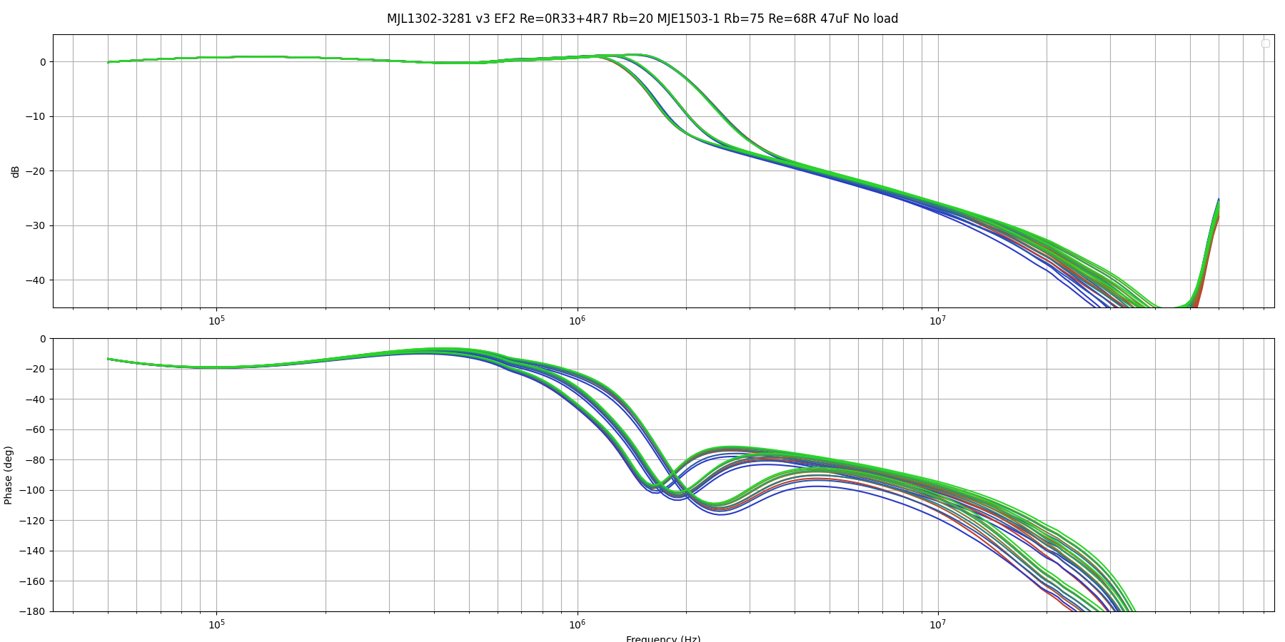

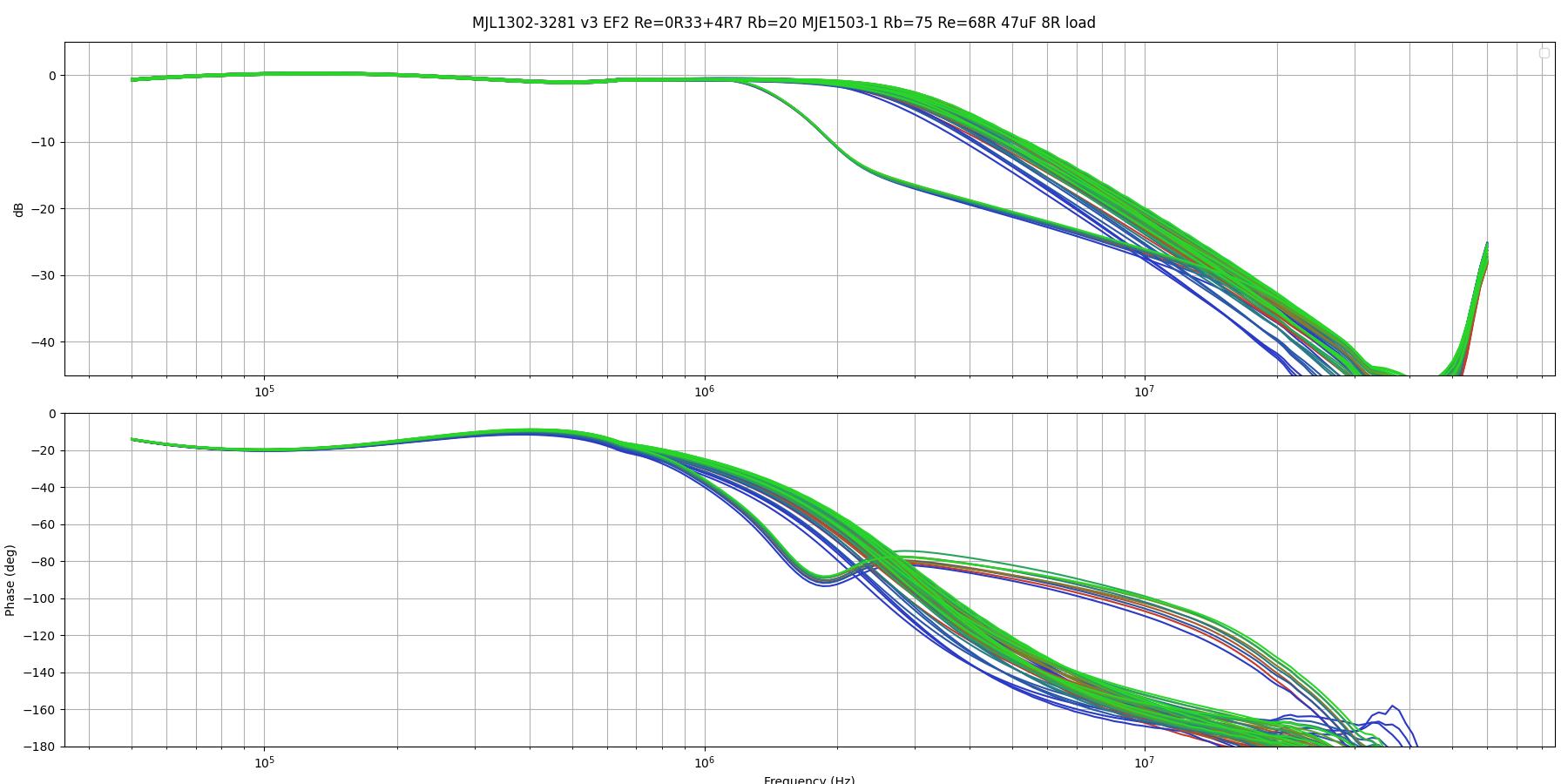

The bipolars are back.
MJL1302/3281, with 20R base resistors and a ferrite bead each, driven by MJE15030-15031 with 75R base resistors, and a 68R resistor between the emitters to set driver idle current.
Supply voltage is stepped so the transistors have from 5V to 25V headroom.
Without a load on the output:
As the datasheet says, transition frequency of bipolars does depend on current. When current is low, fT is low. Three different bias currents are shown, 50mA 100mA 200mA, and the high frequency performance of the output transistors follows the bias current.

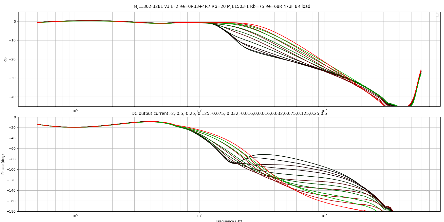

Next plot has output load current applied: (-2, -1, -0.5, 0, .5, 1, 2) Amps. All the curves where the devices have enough current to increase their fT are well grouped and show a clean 2-pole lowpass characteristic. The one with zero output current stands out.
Compared with the FETs, it is clear that bipolars have much more phase shift.
The comparison isn't entirely fair because the EF2 with two transistors having similar fT is a 2-pole system, whereas I didn't put drivers on the FETs, which makes them single-pole. But the FETs have more current gain than the EF2 up to a few kHz, and they can be driven by lower current, much higher fT transistors, than good old MJE15030.
FETs win this round again.
BJTs do degrade less at low Vce, though.
![MJL1302-3281 v3 EF2 Re=0R33+4R7 Rb=20 MJE1503-1 Rb=75 Re=68R 47uF no_load.png MJL1302-3281 v3 EF2 Re=0R33+4R7 Rb=20 MJE1503-1 Rb=75 Re=68R 47uF no_load.png](https://www.diyaudio.com/community/data/attachments/883/883265-7d29052f6fb8b8d2d03070025e6f3220.jpg)
![MJL1302-3281 v3 EF2 Re=0R33+4R7 Rb=20 MJE1503-1 Rb=75 Re=68R 47uF load.png MJL1302-3281 v3 EF2 Re=0R33+4R7 Rb=20 MJE1503-1 Rb=75 Re=68R 47uF load.png](https://www.diyaudio.com/community/data/attachments/883/883275-0ff32de7c8fc2d6308fc21897dd7b618.jpg)
![IRFP vs ALFET vs MJL-MJE.png IRFP vs ALFET vs MJL-MJE.png](https://www.diyaudio.com/community/data/attachments/883/883260-790b093271188beea8559bfa3d8e4a43.jpg)

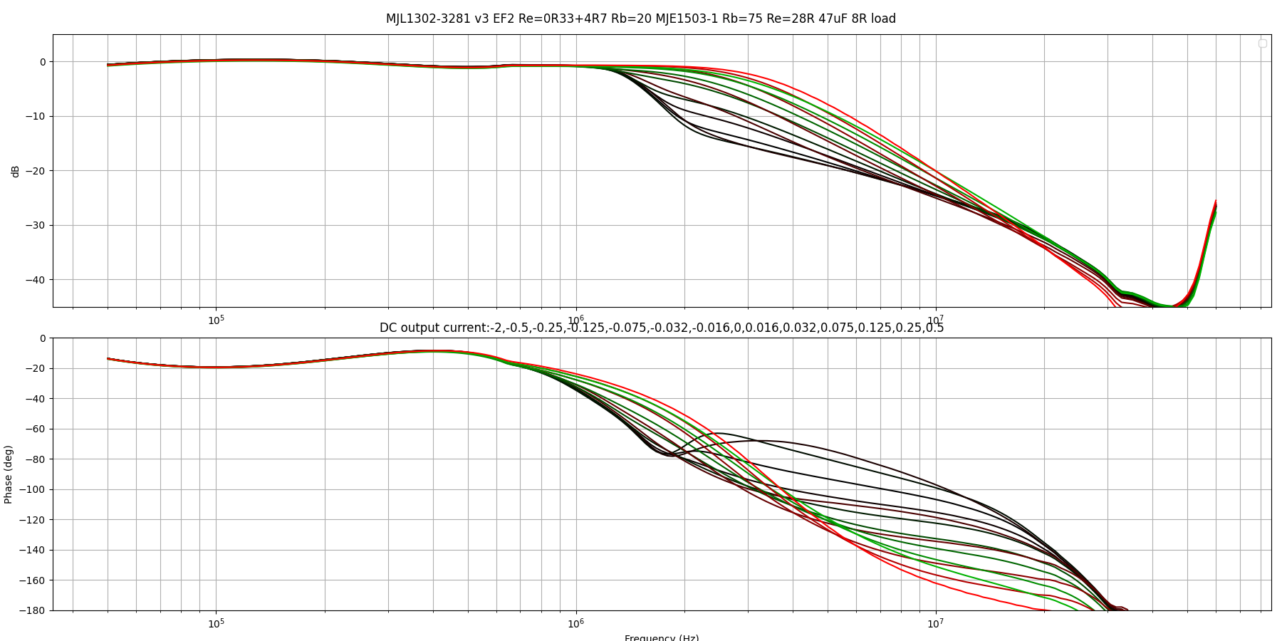

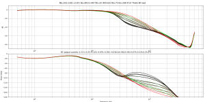

This time I left the supply voltages at +/-25V and stepped the output current. As expected, fT of the output devices follows. Bias is 50mA, and color means higher DC output current.
Removing the 47µF 25V EEUFM capacitor between driver bases: no change.
Increasing drivers idle current from 17mA to 43mA confirms this is about the fT of the power transistors, not the drivers. Although it does raise HF response a little bit.

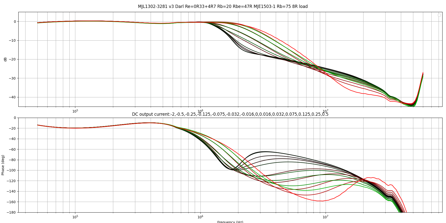

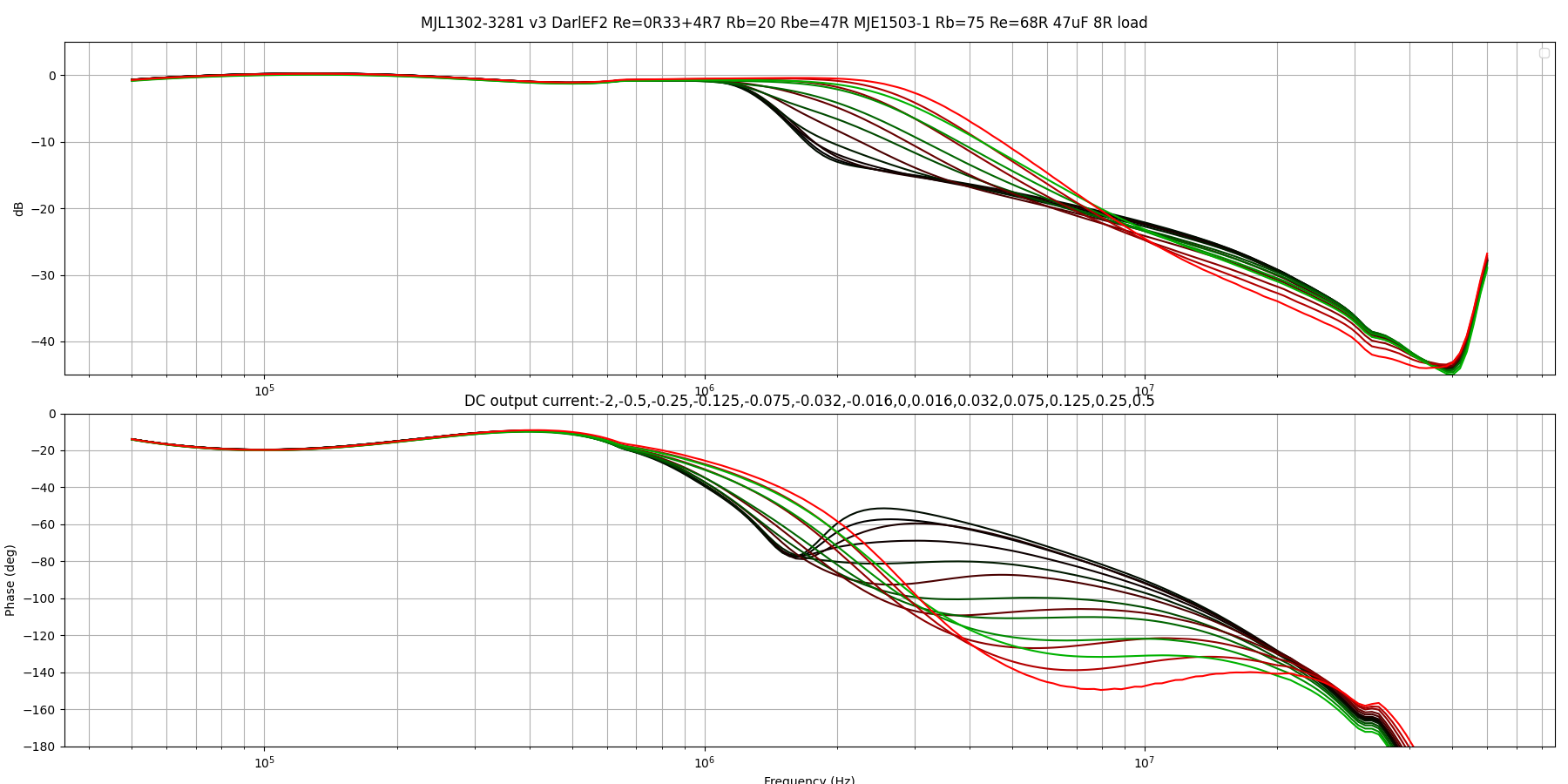

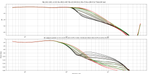

DarlingtonEF2 configuration:
Pure Darlington configuration:

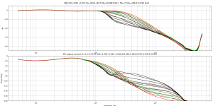

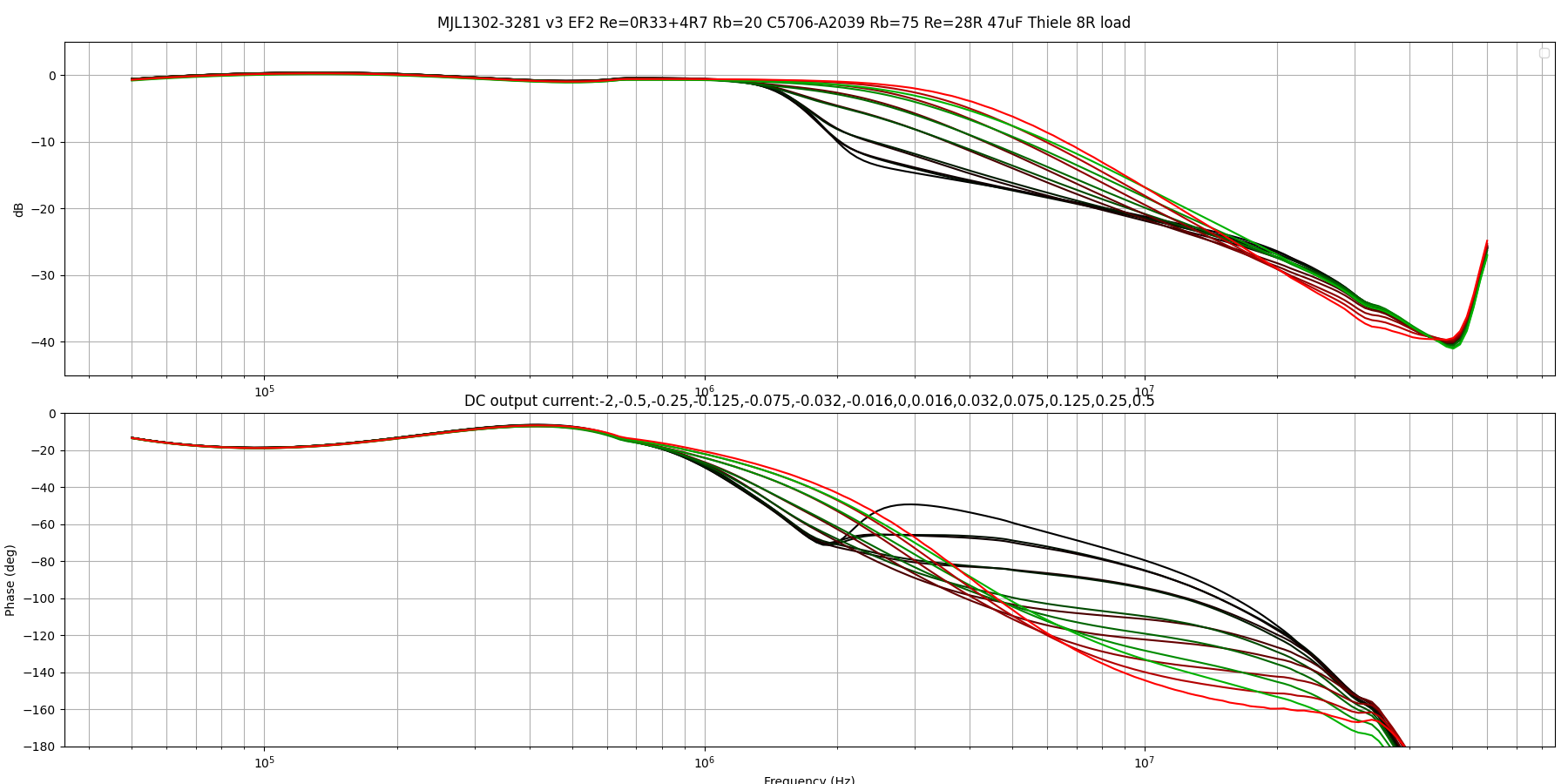

Back to original EF2, with Thiele network at the output: improves phae margin a bit at 2-3MHz.
MOSFETs win on bandwidth.
![MJL1302-3281 v3 EF2 Re=0R33+4R7 Rb=20 MJE1503-1 Rb=75 Re=68R 47uF 25V load.png MJL1302-3281 v3 EF2 Re=0R33+4R7 Rb=20 MJE1503-1 Rb=75 Re=68R 47uF 25V load.png](https://www.diyaudio.com/community/data/attachments/883/883628-5308e44837bfa3f77ddb35e6b2443b19.jpg)
![MJL1302-3281 v3 EF2 Re=0R33+4R7 Rb=20 MJE1503-1 Rb=75 Re=28R 47uF 25V load.png MJL1302-3281 v3 EF2 Re=0R33+4R7 Rb=20 MJE1503-1 Rb=75 Re=28R 47uF 25V load.png](https://www.diyaudio.com/community/data/attachments/883/883661-eee9ca6e6d5b4a854c607d95537582ac.jpg)
![MJL1302-3281 v3 DarlEF2 Re=0R33+4R7 Rb=20 Rbe=47R MJE1503-1 Rb=75 Re=68R 47uF 25V load.png MJL1302-3281 v3 DarlEF2 Re=0R33+4R7 Rb=20 Rbe=47R MJE1503-1 Rb=75 Re=68R 47uF 25V load.png](https://www.diyaudio.com/community/data/attachments/883/883669-0fc4dec9f125f969cd1a1b74d949a508.jpg)
![MJL1302-3281 v3 Darl Re=0R33+4R7 Rb=20 Rbe=47R MJE1503-1 Rb=75 25V load.png MJL1302-3281 v3 Darl Re=0R33+4R7 Rb=20 Rbe=47R MJE1503-1 Rb=75 25V load.png](https://www.diyaudio.com/community/data/attachments/883/883681-b30db9313224cb51875c67eab1b6ef74.jpg)

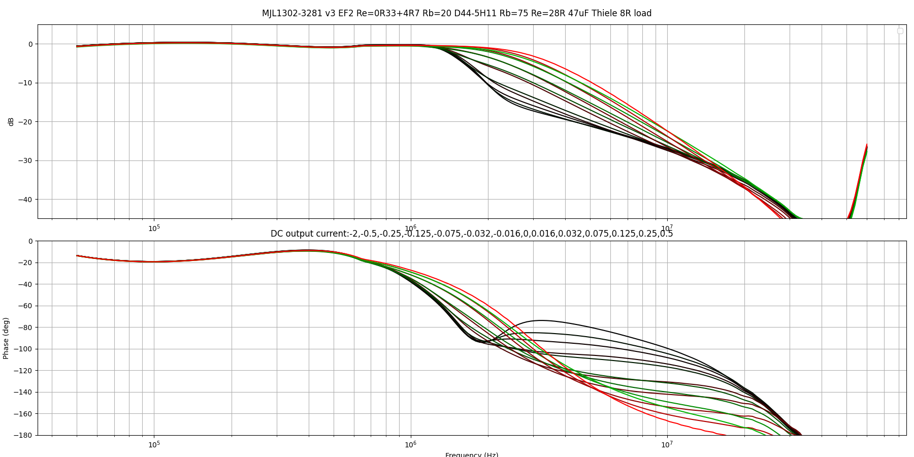

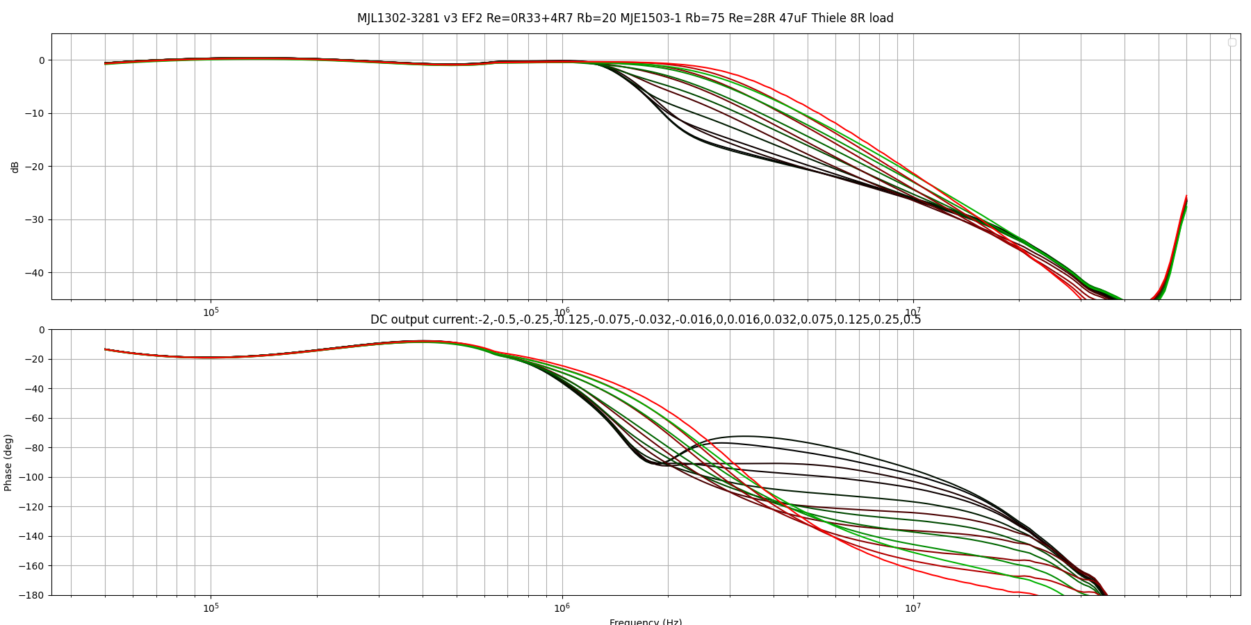

![MJL1302-3281 v3 EF2 Re=0R33+4R7 Rb=20 MJE1503-1 Rb=75 Re=28R 47uF Thiele 25V load.png MJL1302-3281 v3 EF2 Re=0R33+4R7 Rb=20 MJE1503-1 Rb=75 Re=28R 47uF Thiele 25V load.png](https://www.diyaudio.com/community/data/attachments/883/883689-e407e6be3c3db492694c6e7f138b4910.jpg)

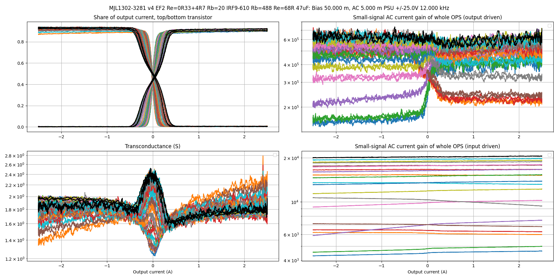

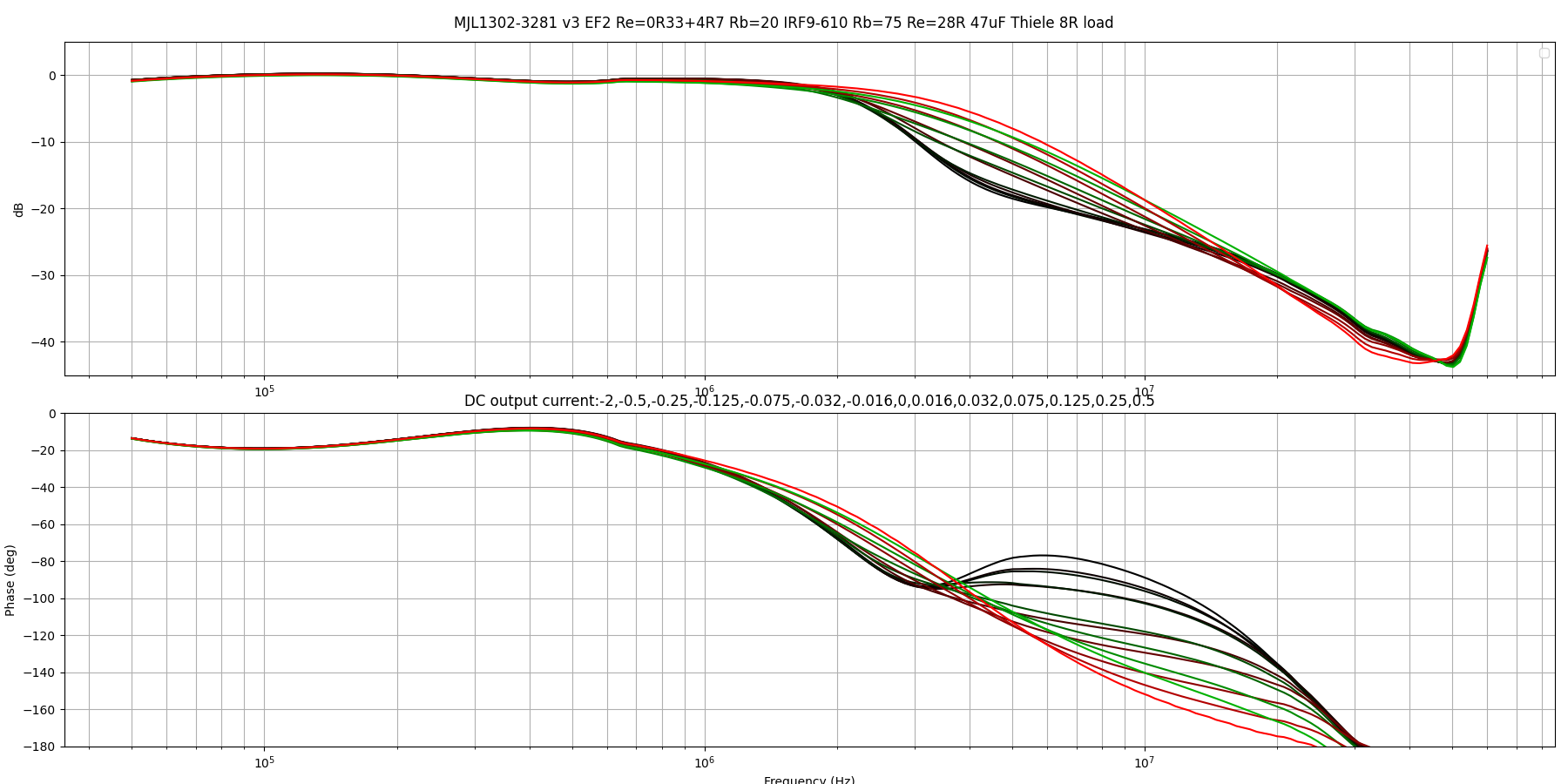

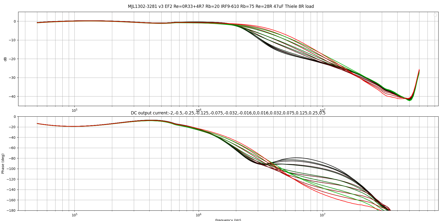

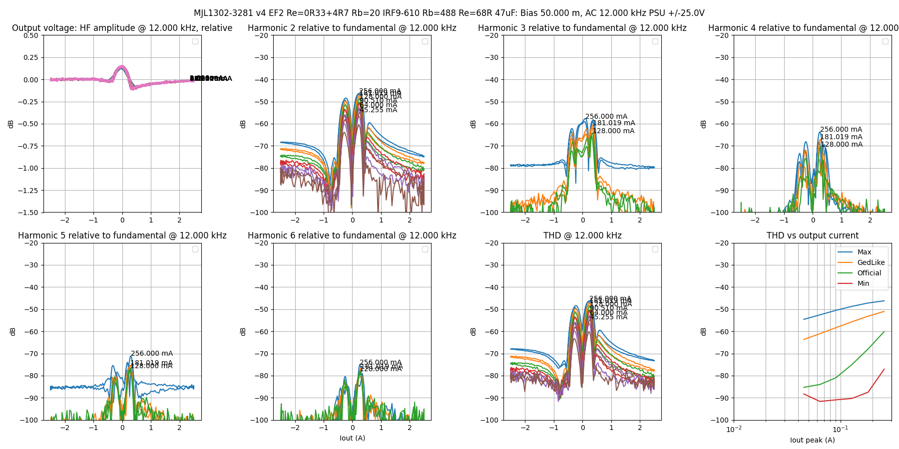

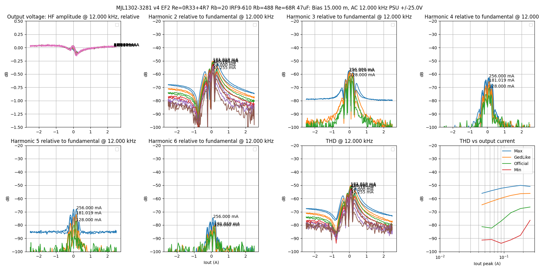

I will now run the automated distortion test on all of these. Since this is bipolar day, the constant will be MJL1302/3281, 0R33 emitter resistors, and 20R base resistors. And the variable will be drivers.
First in line is IRFP9/610 as drivers.

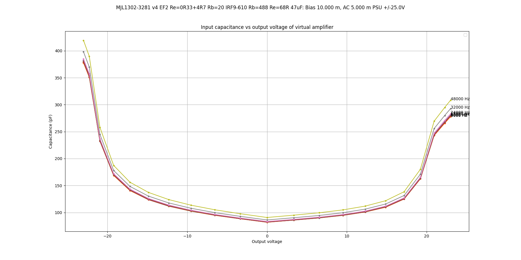

Input capacitance is typical of FETs, ie highly variable with headroom. The two are well matched.
Below is the same plot as before, each trace is a value of output voltage, and the horizontal axis is output current. I removed the illegible text labels and instead simply used Black for zero output voltage.
Bias current varies quite a lot with output voltage. I don't know if this is due to Early effect (or the equivalent for FETs) in the drivers, or Vce-dependent hFe variation in the power devices. I think it's the former.
1) On the bottom left wingspan plot, the black curve is thus the gm wingspan at zero output voltage, and the others over the range of output voltages. Since FET Vgs varies, bias also varies depending on output voltage. This may be a problem if the load is evil enough to make the current switch signs at voltages far from 0V. In this case a two-transistor biasing circuit that keeps the voltage between power transistor bases constant could be a better choice.
2) Likewise, FET current gain depends a bit on Vds. So on the right plots showing current gain, it varies quite a bit depending on output voltage. But one of these lines is perfectly flat, and the different current gains of both FETs compensates exactly the difference in hFe between the power transistors.
3) FETs like headroom, and these want a bootstrap supply.
This offers an interesting possibility: if the FETs are bootstrapped, then their Vds becomes constant, which eliminates problem 1) above. And it is possible to choose a bootstrap supply voltage for each FET that will tweak its gain just right, to make the current gain of the whole stage constant over the whole current range. I think this is the simplest way to achieve this with BJTs. As the HF measurements showed, FETs also offer higher speed and better phase margin than the usual 30MHz fT BJT drivers. Quite interesting.

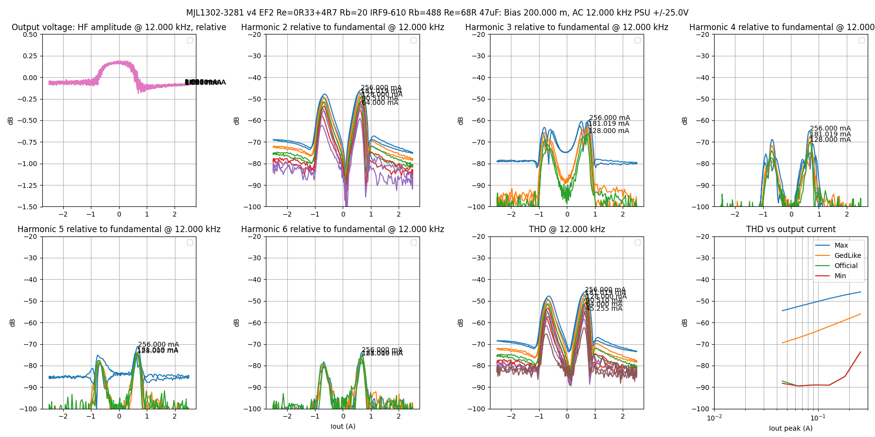

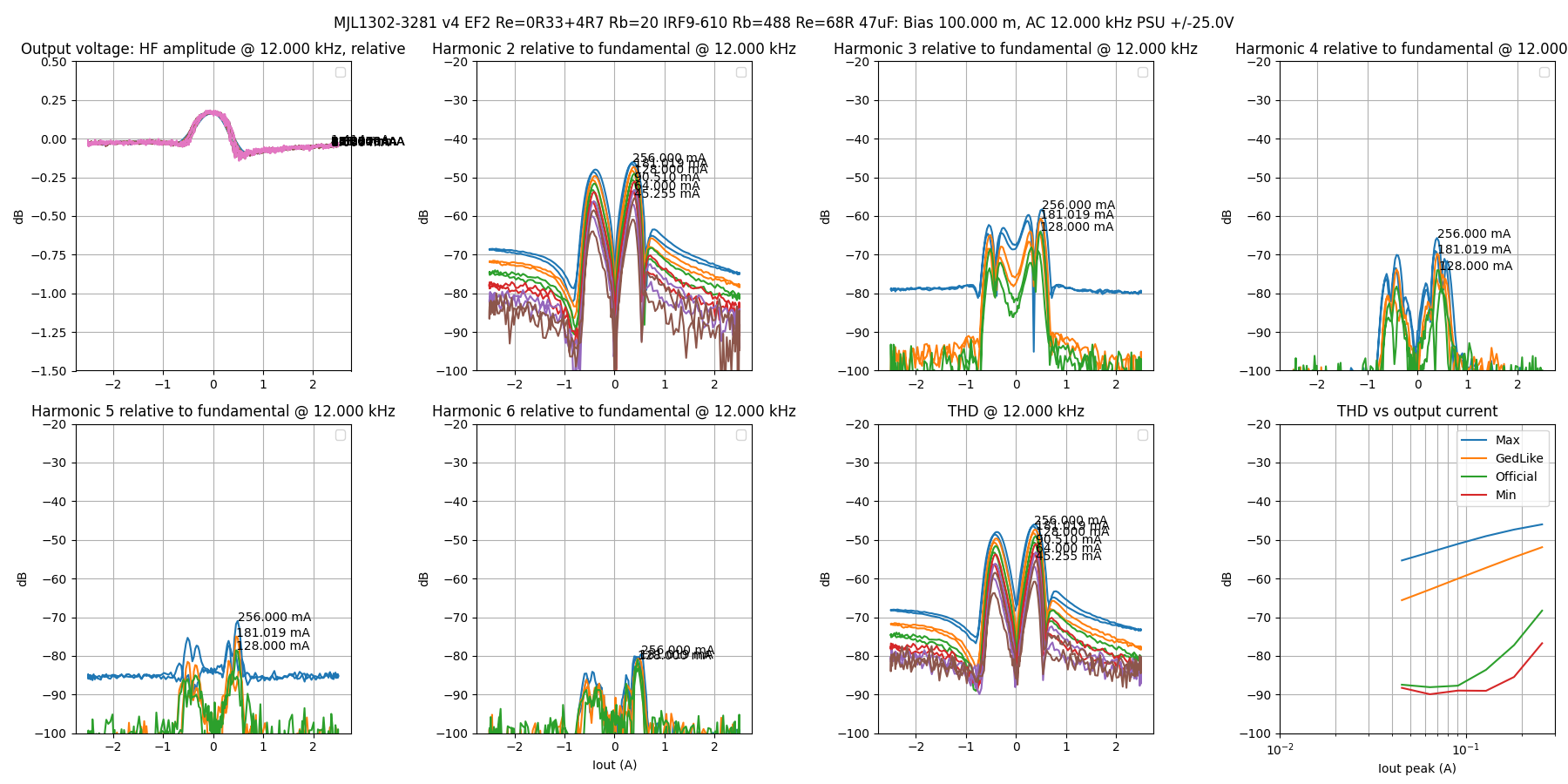

Now, distortion vs DC output current operating point, output voltage, and amplitude of 12kHz AC output signal. One bias point per plot: 15mA, 50mA, 100mA, 200mA. The FET graphs are here for comparison.
What we're looking for is the amplitude of harmonics going down fast with increasing harmonic order. Each harmonic has its own little plot.
The current holder of the title is IRFP240/9240, which gives identical results for either two pairs at 100mA or one pair at 200mA bias... and it is still winning.
![input cap-MJL1302-3281 v4 EF2 Re=0R33+4R7 Rb=20 IRF9-610 Rb=488 Re=68R 47uF-B=10.0m,HA=5.0m,LA=2.png input cap-MJL1302-3281 v4 EF2 Re=0R33+4R7 Rb=20 IRF9-610 Rb=488 Re=68R 47uF-B=10.0m,HA=5.0m,LA=2.png](https://www.diyaudio.com/community/data/attachments/884/884149-df8b81286143468baf58e9fe200c3e33.jpg)
![gm-MJL1302-3281 v4 EF2 Re=0R33+4R7 Rb=20 IRF9-610 Rb=488 Re=68R 47uF-B=50.0m,HA=5.0m,LA=2500.0m-.png gm-MJL1302-3281 v4 EF2 Re=0R33+4R7 Rb=20 IRF9-610 Rb=488 Re=68R 47uF-B=50.0m,HA=5.0m,LA=2500.0m-.png](https://www.diyaudio.com/community/data/attachments/884/884192-761b096581880313beaae2c06841b3cc.jpg)

Hi Peufeu,
This is great work! I really appreciate you (and others) who do some real research and puts it out here for everyone to read and participate in the discussion.
That said, I agree with anatech that 20R base resistor on the BJT output transistors is too high. It will modulate the idle current of the output stage with the signal. It will also make the output stage more dependent on beta matching between P and N transistors. Cordell mentions this in his book.
Like anatech said, you wouldn't build a real output stage with base resistors that large so it causes us to question if your results are valid for a normal output stage where those resistors are removed.
The AD8421 can be configured for a large gain (at the cost of BW) so why not use base resistors <1ohm and increase the gain of AD8421? Any potential decrease in SNR on the measured base current might not matter much?
