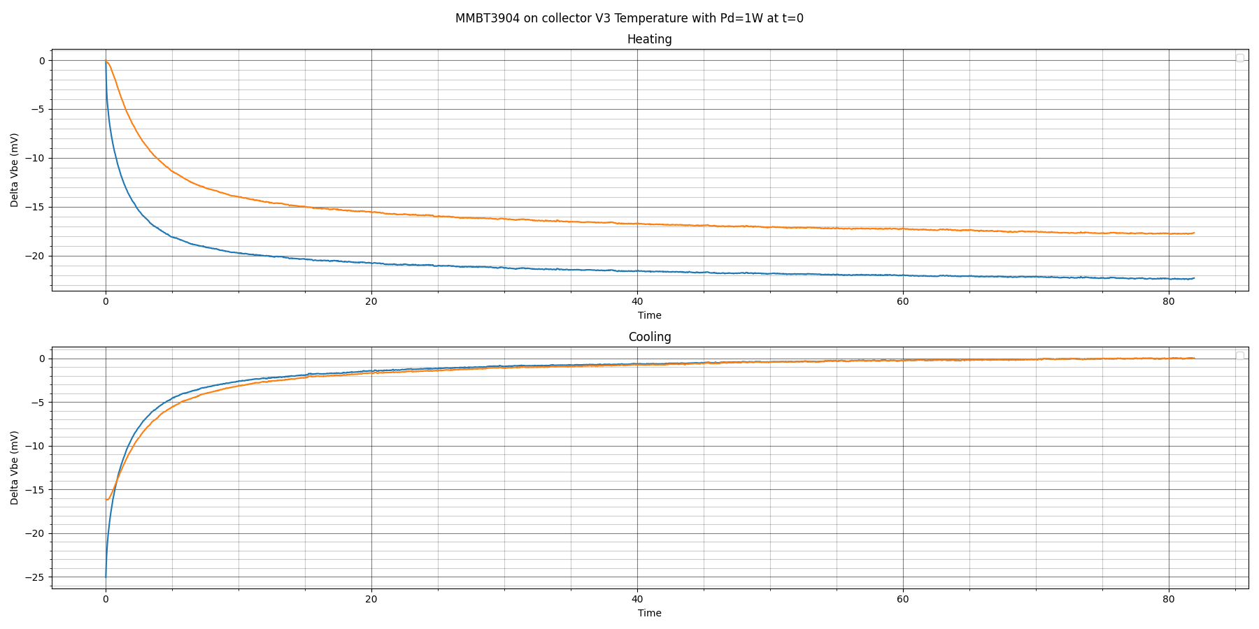

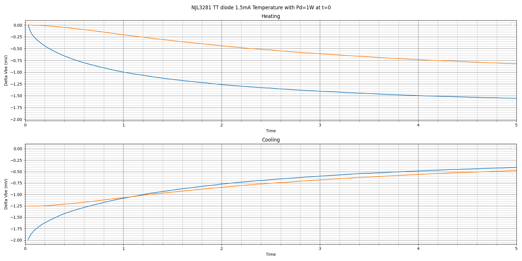

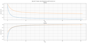

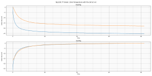

Let's test the ThermalTrak diode temperature sensor.
The transistor is heated by 1.2A at Vce=10V, ie 12W. The diode is biased at 1.5mA. Plots are scaled to a power of 1W, to get a result in millivolts of Vbe (or diode) per dissipated watt.
First plot for comparison is a configuration tested previously: MJL3281 with a MMBT3904 soldered on the collector lead as close as possible to the package.
Second plot is the NJL3281 with ThermalTrak diode.
MJL3281 (without diode) and NJL3281 (with diode) have almost identical thermal impedance, which was expected.
But... the diode reacts about as fast as the DIY option with the MMBT3904, not faster! Kinda disappointing. Well, at least it's isolated, there's always that.
The diode measures the temperature of the leadframe and not the chip. When it dissipates power, the chip gets hotter than the leadframe, and the sensor does not measure this. However, on cooling, the chip quickly returns to the leadframe temperature. At this point, when heating power is no longer applied, both the transistor and the diode act as thermal sensors on the same leadframe, so they track quite well.
So, an error is introduced in the temperature measurement: dissipated power multiplied by thermal resistance junction to leadframe.
Suppose the device is dissipating power P ; it has thermal resistance junction to leadframe R1 and thermal resistance leadframe to heatsink R2. Then, the chip is P*(R1+R2) °C hotter than the heatsink. But the thermal sensor, which is on the leadframe, is only P*R2 °C hotter than the heatsink... or P*R1 cooler than the transistor.
It looks like the diode tempco matches the transistor, perhaps a bit on the low side (in absolute value). That depends on current through the diode though. Anyway, if they both have the same tempco, It looks like R2 is 72% of the total thermal resistance, and R1 is the rest. With a worse quality silpad, it would be different. So, the sensor allows to compensate up to 72% of the transistor's heating, with a delay of a few seconds. That's not bad, still much better than a Vbe multiplier on the heat sink.
Some gain could be applied to get a better compensation, that would work when the transistor dissipates constant power. But when it cools down, it would overcompensate and underbias.
Perhaps the complaints about the diode tempco not matching the transistor's are actually due to a design choice by ON to avoid underbias on cooldown.
The irony of the situation is the MMBT3904 bodge behaves a bit like this: it has slightly more gain (perhaps more tempco than the diode) so it tracks a bit better when heating, and a bit worse when cooling... and it had excellent bias regulation without underbias.
That shows it is possible to get away with some gain, because after a high dissipation passage, the BJTs will not go back to zero power, but to the preset bias current. So they will always be hotter than the diode.
Anyway. I hoped it would be faster, but it is about as good as the MMBT3904 bodge. That one worked wonderfully with a Vce of 10V and no emitter resistors, at quite high bias currents, but at higher Vce it was less stable of course.
So, I'll either need a cascode, or some circuit that computes instantaneous junction temperature

What current do you recommend?
https://www.ti.com/lit/pdf/sboa277
In your case, use less current for the thermal diode will make the curve of the diode more deep.

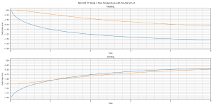

A pure delay will create a phase shift without change the amplitude throughout the frequency. I don't think it is the case here.
Here is more like 1 pole system with big time constant (because of the thermal mass). Just as your mentioned, you can add some gain to get more accurate control and it should remain stable. Just don't put too much gain.
I had forgotten to divide by dissipated power, so the plots in the previous post show Vbe drift for a power of about 13.5W (10V/7.5R load resistor). This is fixed, next plots will be scaled to mV Vbe per W.
If you look at the beginning of the waveform, it is easier to see the "delay". You can call it "high order lowpass filter" if you want, that would be more accurate. Vbe reacts very quickly ; the diode has a strong lowpass effect which is normal because of the thermal mass of the leadframe... I guess the thick leadframe is a factor that helps a lot for the huge SOA of this transistor so it's nice to have it.
It should be possible to make it quicker with some gain and a filter.

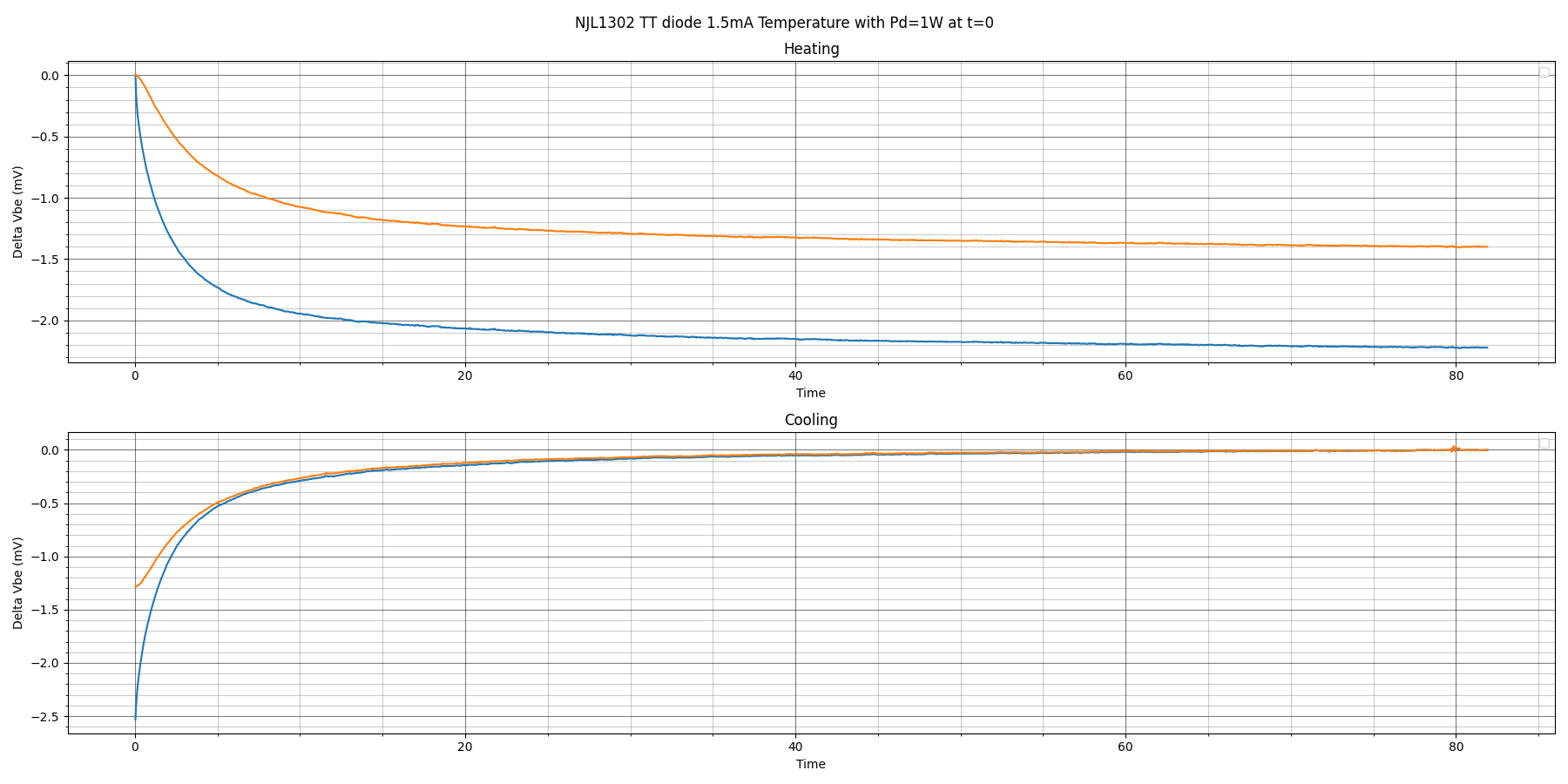

I measured NJL1302 on the same setup.
I guess the PNP chip is larger than the NPN: it has more thermal mass, which is good. And the diode captures less of the chip heating, which is bad. I guess more of the heat goes "vertical" into the heatsink and less goes "lateral" to heat the leadframe the diode sits on.
But besides that, pretty much the same. So.. no problem, at 10V Vce, it will work just as well as the bias stabilization circuit that used MMBT3904s on the collector leads, and that worked very nicely.

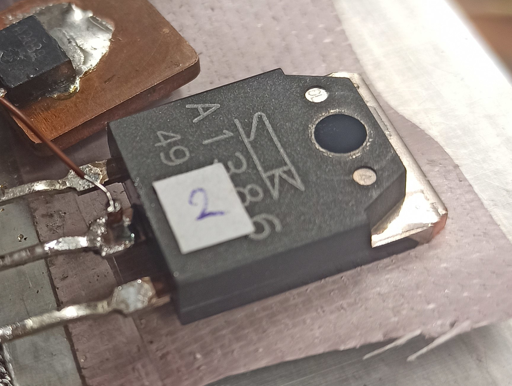

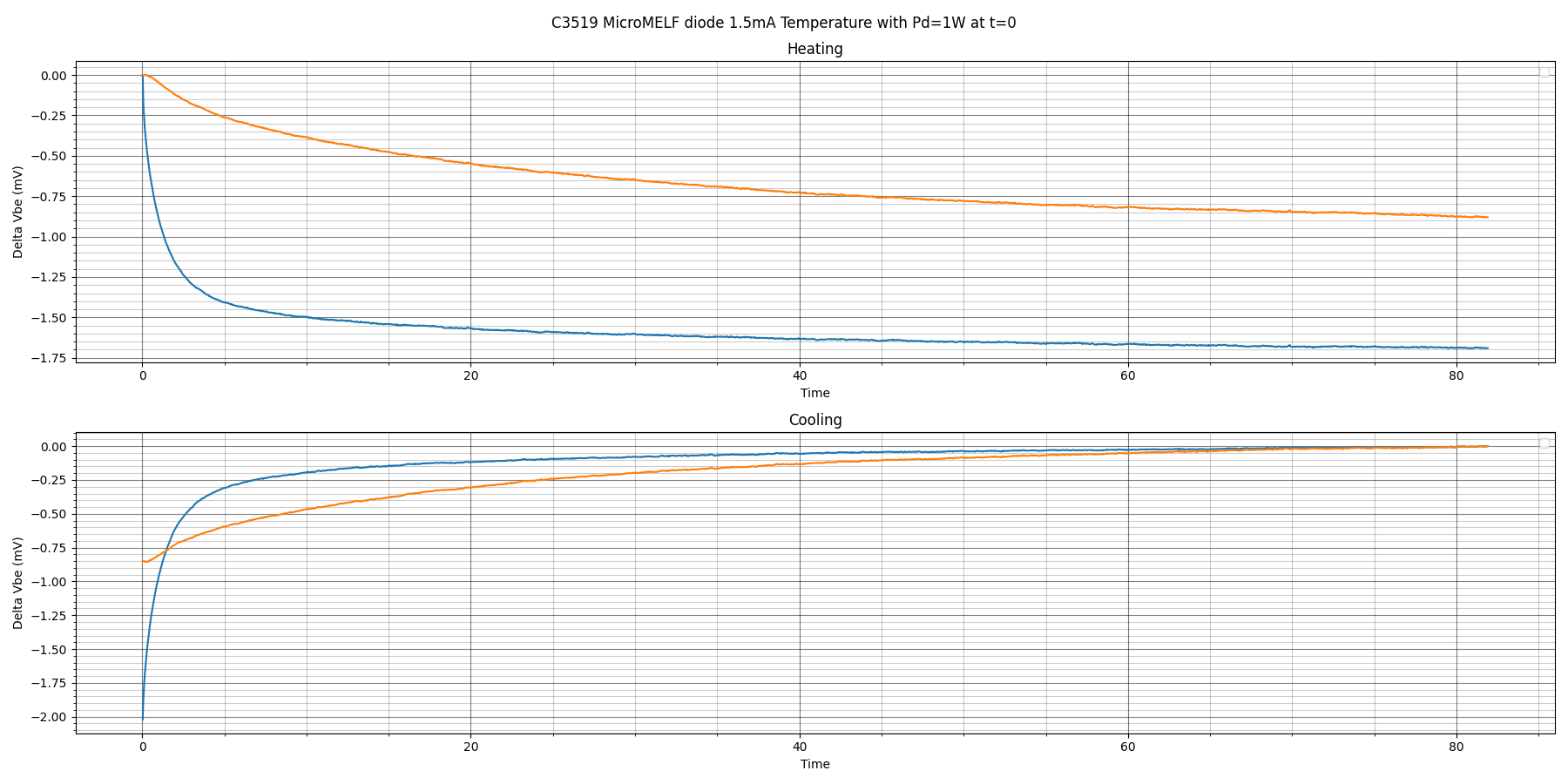

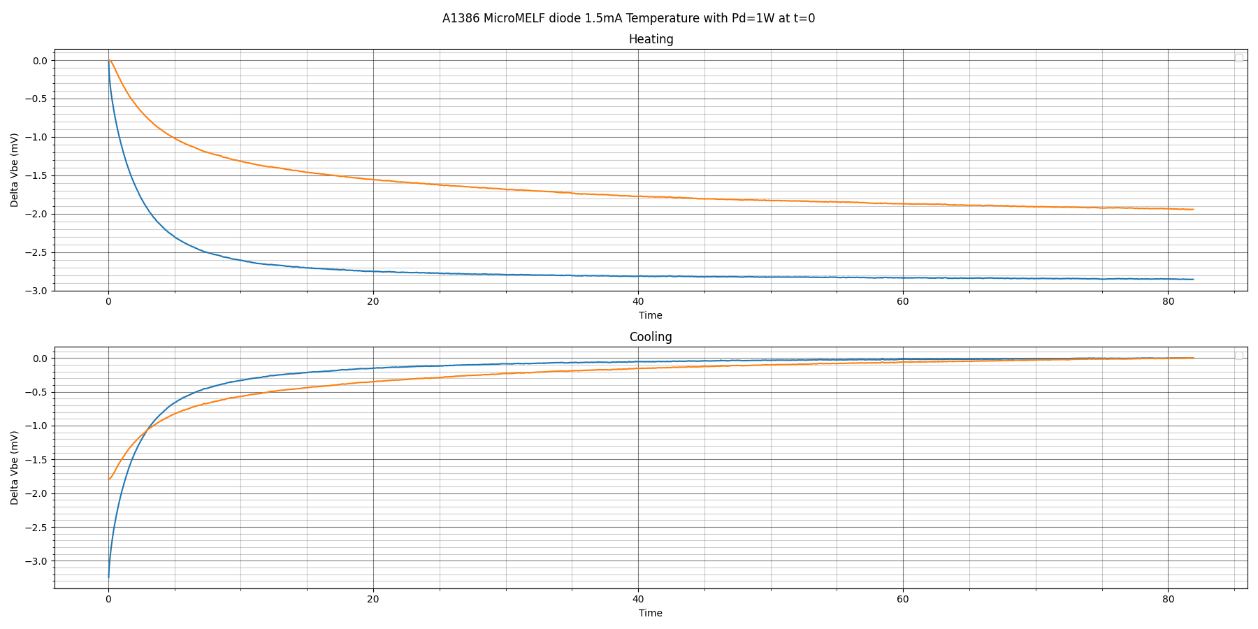

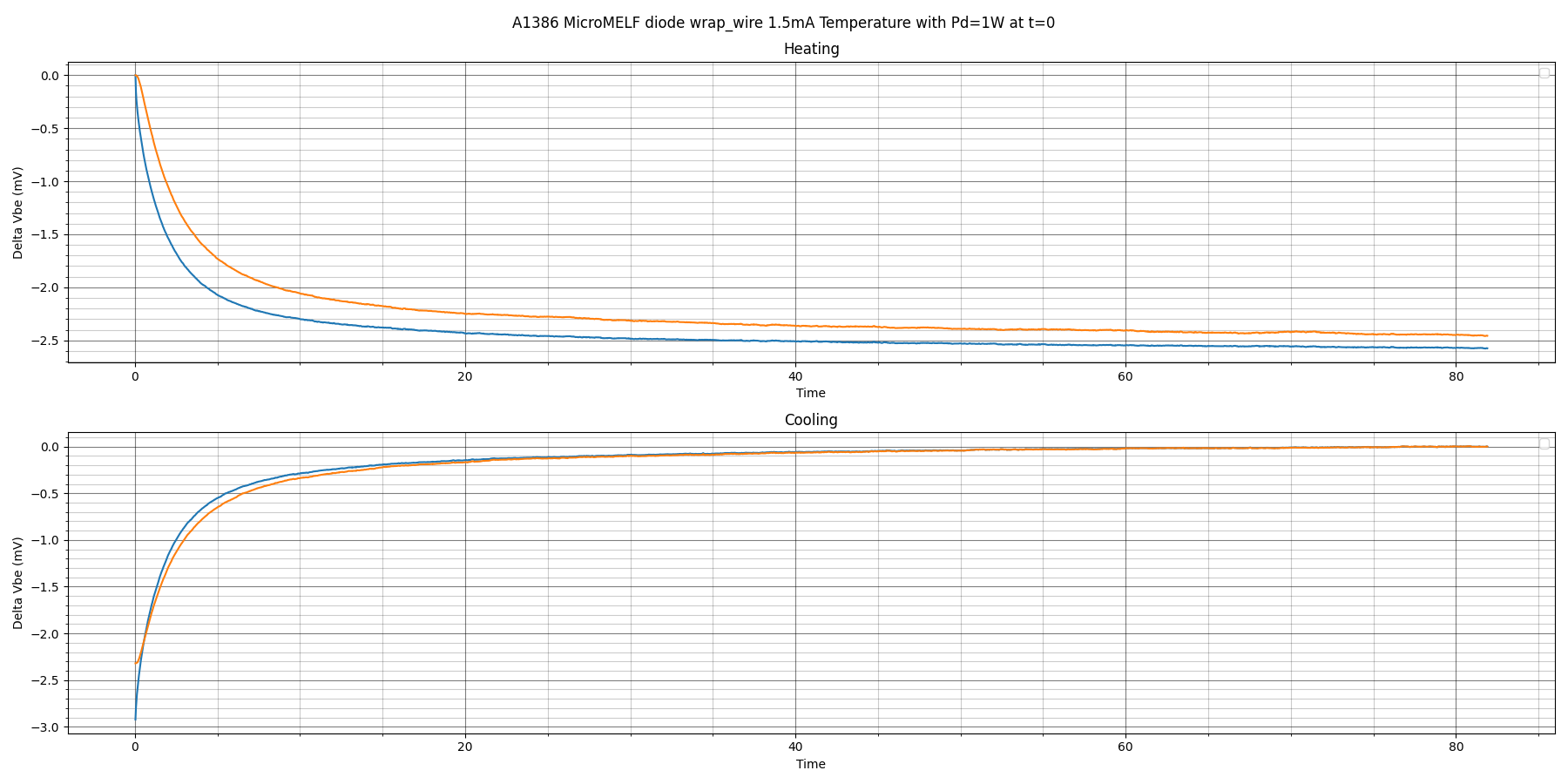

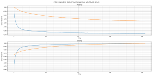

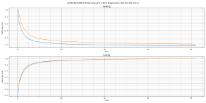

This is SanKen C3519/A1386. Thermal sensor is a MicroMELF diode soldered to the collector lead. This is much easier to do than soldering a MMBT3904 (fiddly) or a SMD LED (breaks all the time).
It still works much better than the Vbe multiplier transistor on the heatsink, but compared to ThermalTrak, it is slower and captures less of the junction temperature.
But... I just realized I soldered a 0.1" header on top of the diode, which is quite large compared to it. So I will try again with some very thin wrapping wire.
Note the thermal resistance of the Sankens is very good, 0.7°C/W junction to heat sink for the PNP and 1.16°C/W for the NPN ; difference could be due to chip size or one screw being tighter than the other.

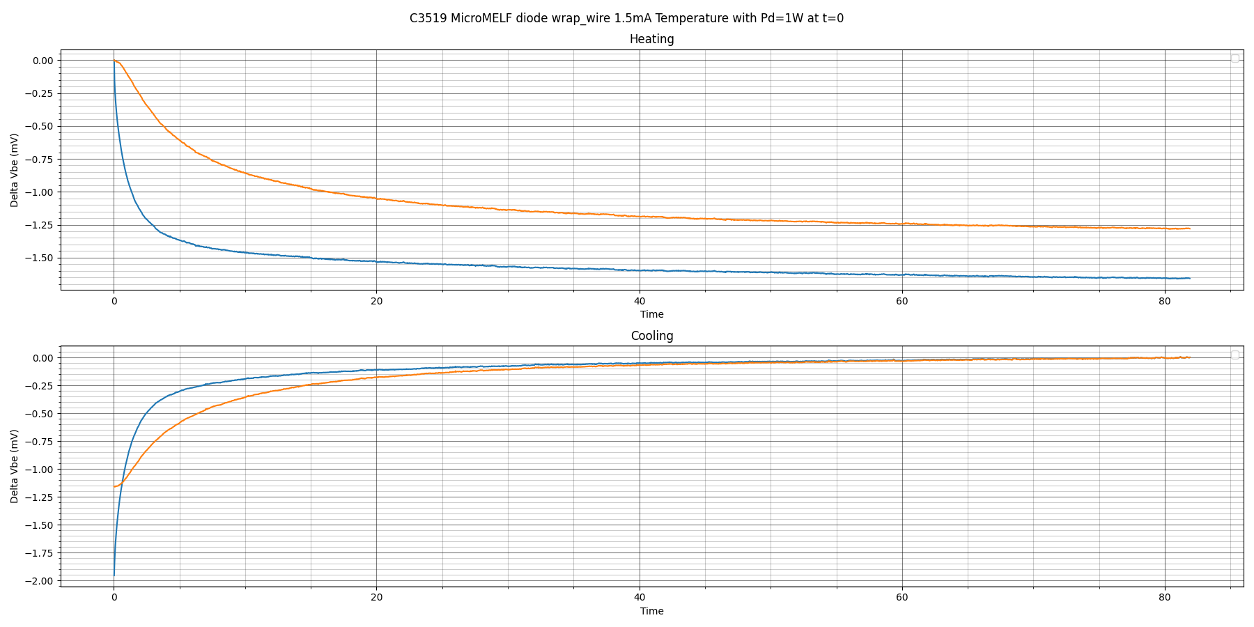

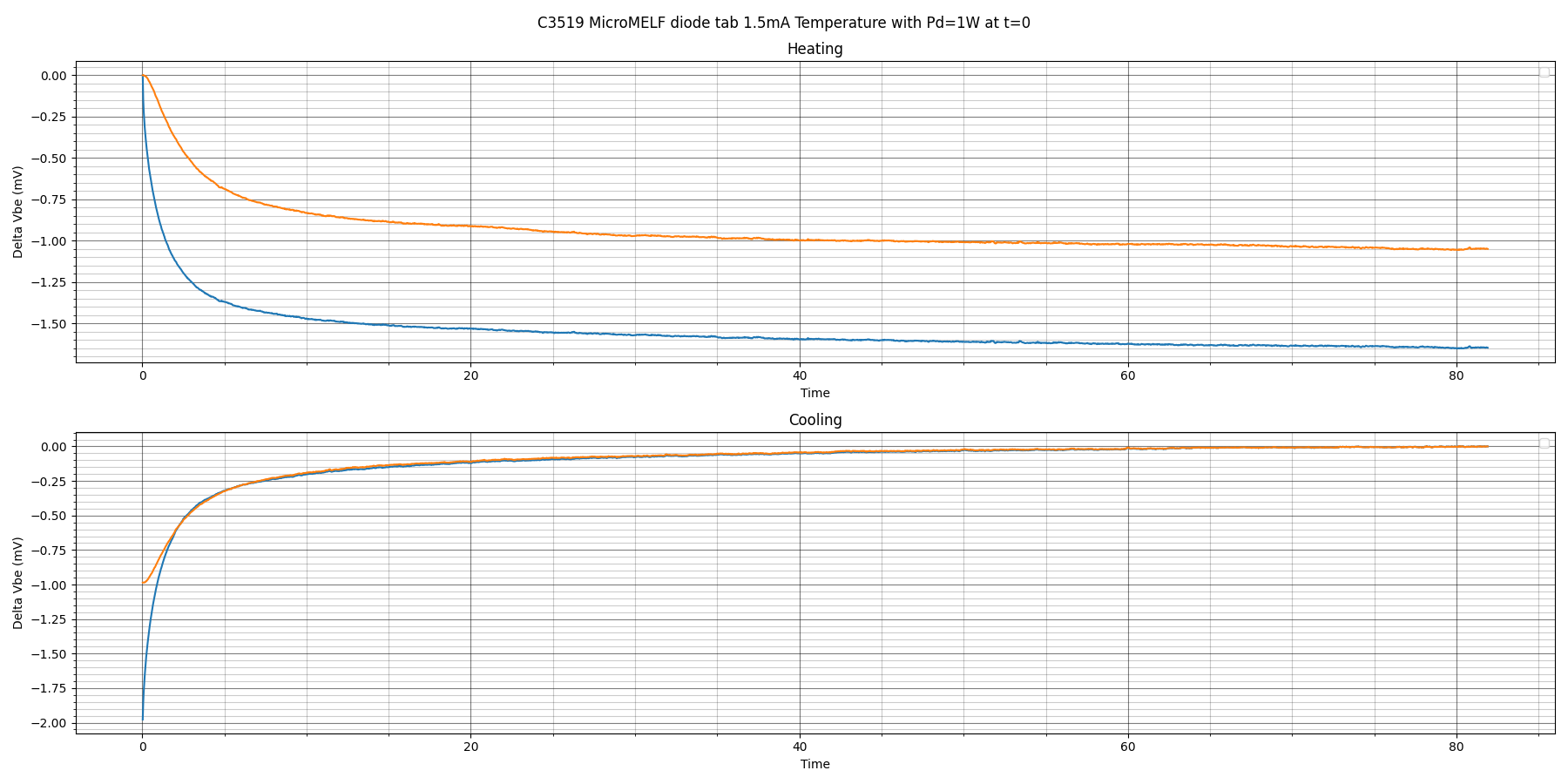

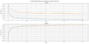

The 0.1" header that was on top of the diode has been replaced with thin wrapping wire. This steals less heat from the diode, and it tracks the temperature of the collector lead much better!
For the PNP, it is almost perfect. Even better than the ThermalTrak! For the NPN, it is comparable to ThermalTrak, but a bit slower (without electrical isolation however).
This difference is probably due to the larger PNP chip having its edge closer to the collector lead, so it transfers heat better to the sensor.

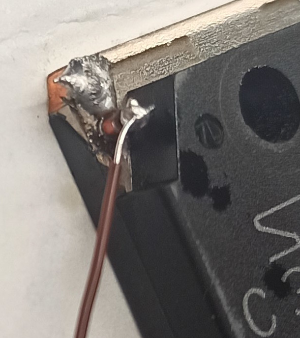

Here are pics of where the sensor diode is soldered.
I tried on the corner of the TO3P tab, and for the NPN, it worked a lot better than on the collector lead! It still doesn't capture the full temperature when heating, but when cooling, it works much better than on the collector lead. There is no lag on cooling, which means there is no risk of underbias... and a bit of gain could be applied to capture more of the heating.
So that exposed copper tab is a nice feature of the TO3P package.

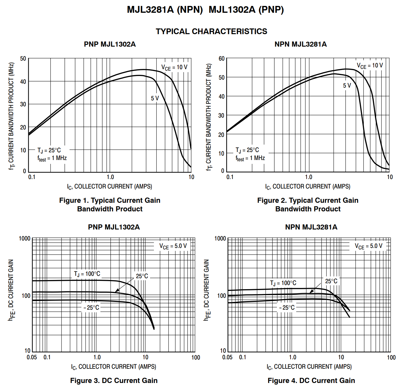

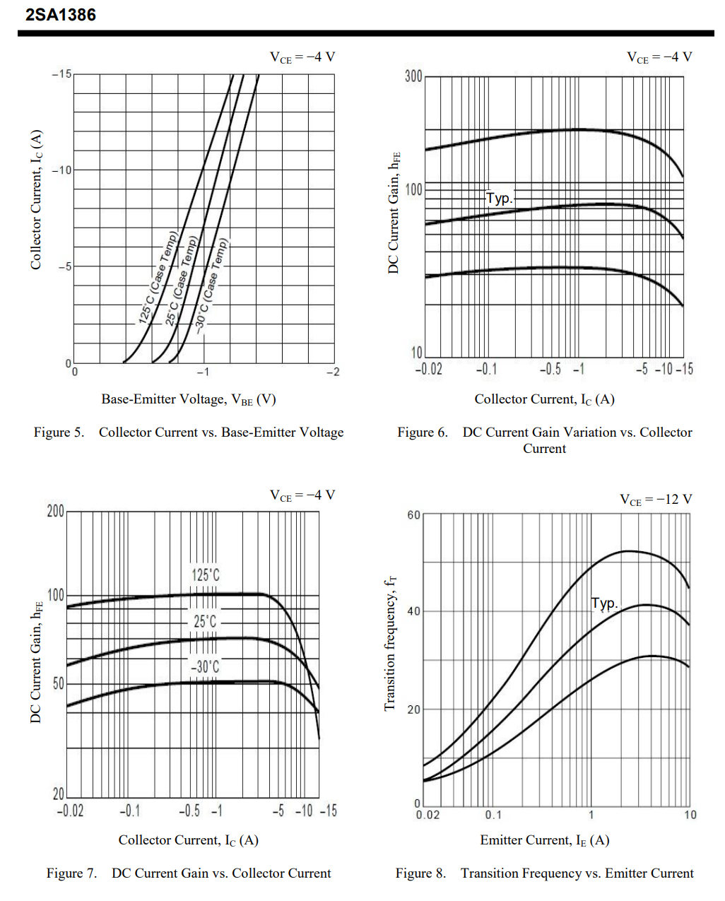

Regarding SOA, both MJLs and SanKen A1386-C3519 can do 10V Vce - 10A Ic . Datasheets specify good hFe up to 10A too. This means for realistic living room power levels, one pair will be enough.
This is my preferred option because it has the lowest capacitance, and while many pairs in parallel reduce THD when using emitter resistors, previous measurements showed that without resistors, at constant total bias, one pair was either the same or slightly better than two. That's basically the opposite of what happens with emitter resistors, quite remarkable...
So, without resistors, there is no benefit to several pairs besides power handling (at the cost of increased capacitance and matching headaches) ; and cascodes solve the power handling problem while allowing to get rid of the resistors.

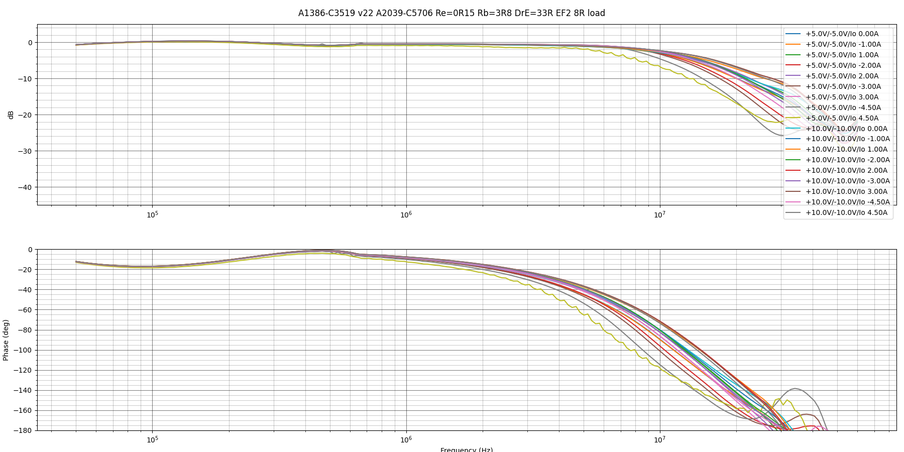

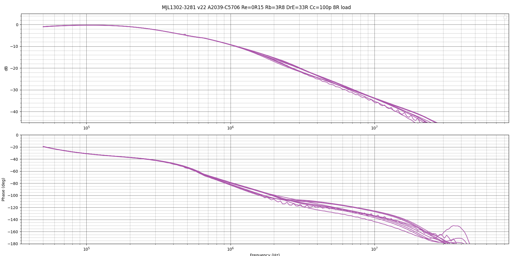

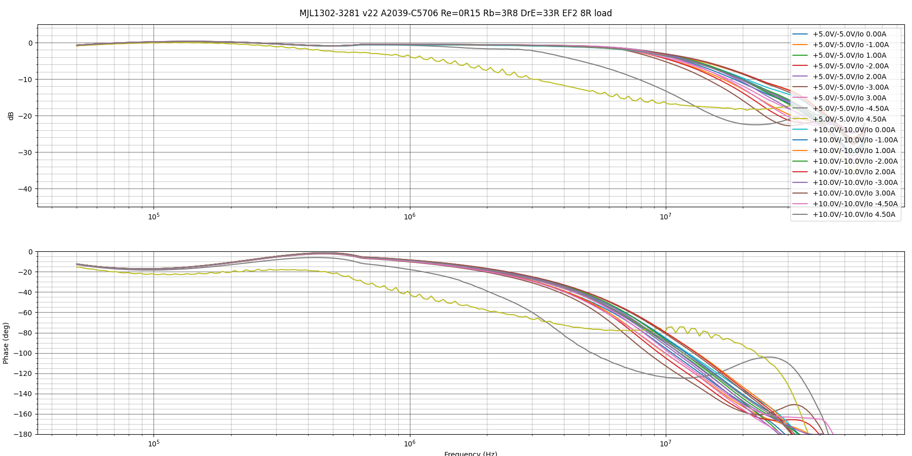

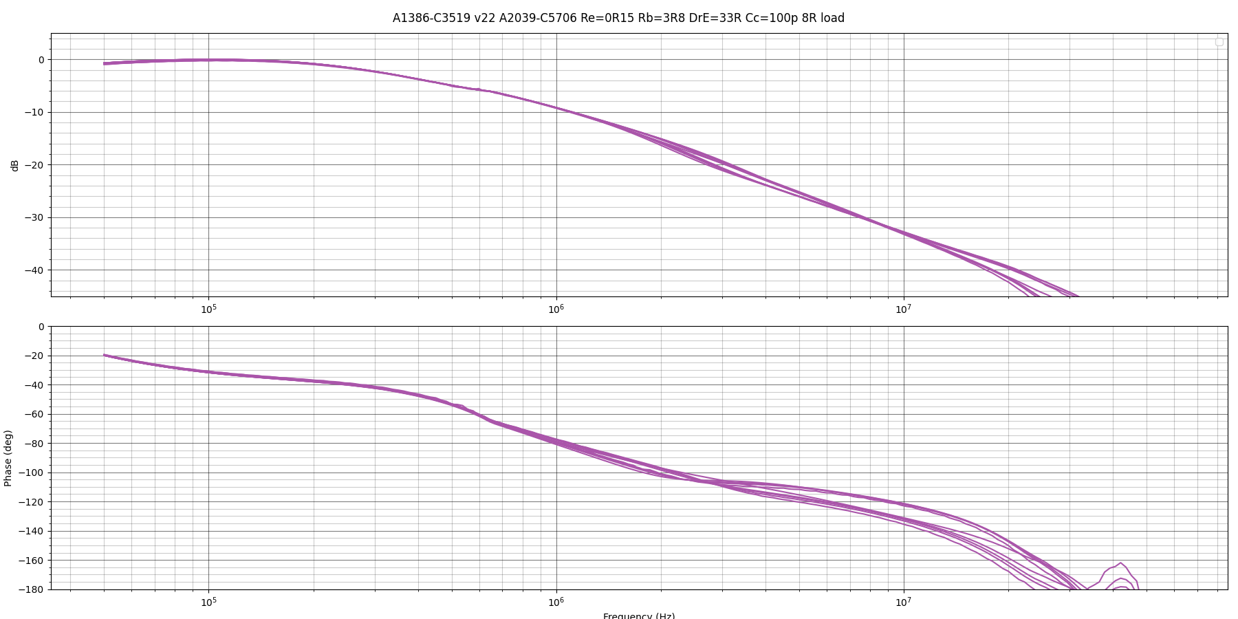

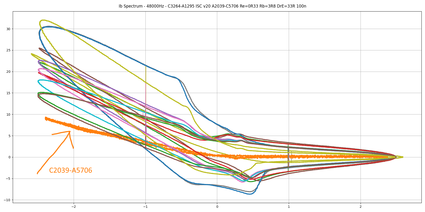

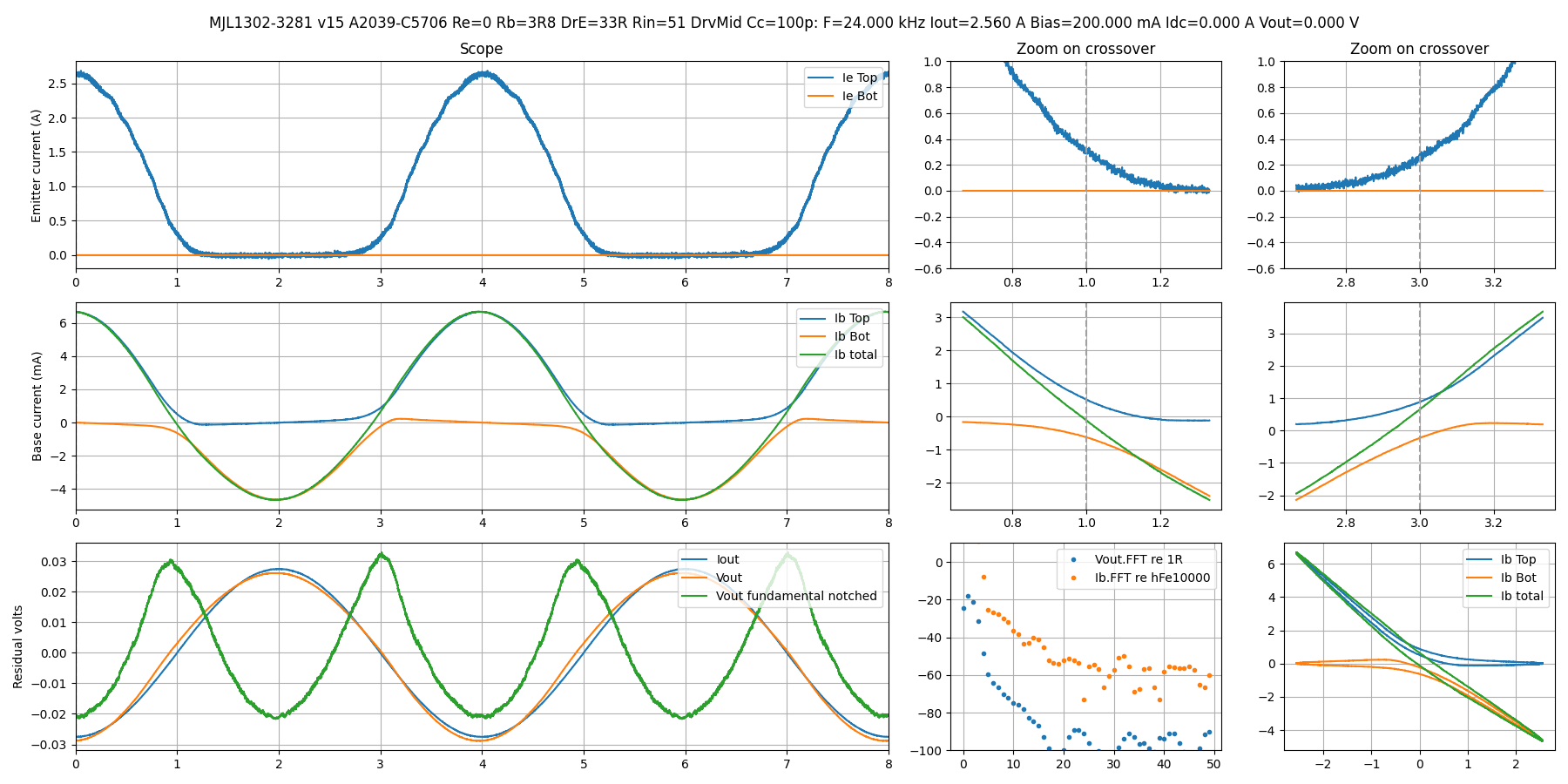

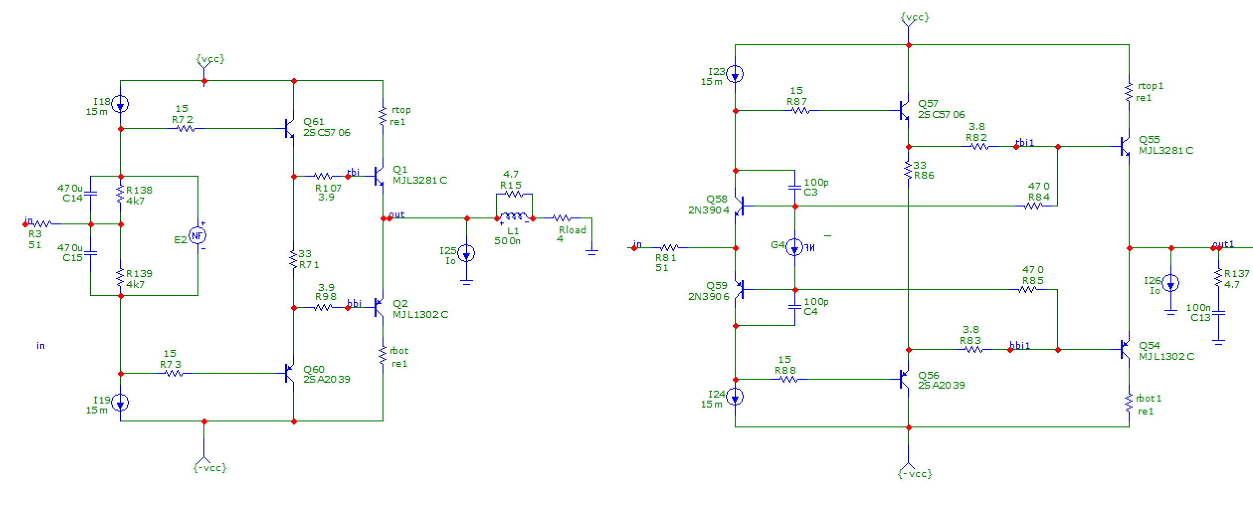

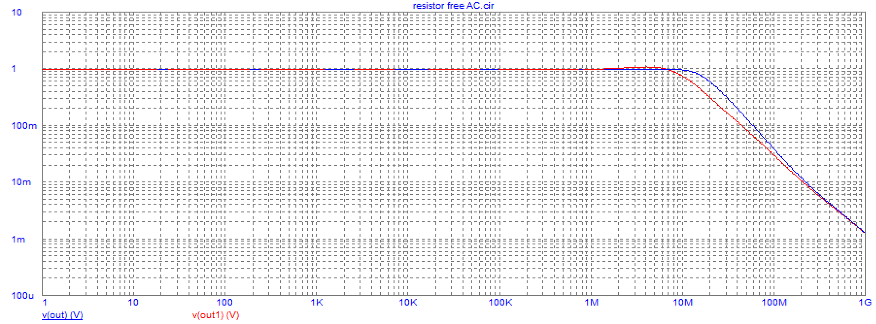

Now that I have decided on cascode + 1 pair without emitter resistors, let's check the frequency response at low Vce and high current.
On the left is a standard EF2 ; the Vbe multiplier is on the board but not in the sim. On the right is the topology I used earlier, which cancels driver Vbe drift. Let's call it "CVB" or Constant Voltage between Bases of the power devices. It yielded better distortion performance, similar to CFP drivers, but without the tendency to misbehave.
Spice predicts very similar frequency response for both.
However, the CVB topology with MJL transistors and SanKen's isn't looking so good with real components...
...but EF2 is absolutely fine and delivers the expected frequency response.
I have no idea what happened here. It could simply be that the CBV bias controller, which is air-wired, broke yet again. I will postpone that to when I make a real PCB for it, and focus only on the EF2 measurement.
A more interesting data point is that at low Vce (5V) and high current (4.5A) the SanKens hold their high frequency performance much better than the MJLs. fT information from the datasheets confirms this:
So, the SanKens would offer increased phase margin and higher ULGF. That's nice.
![no resistors cvb vs ef2.PNG no resistors cvb vs ef2.PNG](https://www.diyaudio.com/community/data/attachments/902/902771-09cefeb78eaa2395a59a887a9fbac56a.jpg)
![no resistors cvb vs ef2 ac.PNG no resistors cvb vs ef2 ac.PNG](https://www.diyaudio.com/community/data/attachments/902/902800-659a5aa08c04c1fa8d5a7f91ed5c4952.jpg)
![MJL1302-3281 v22 A2039-C5706 Re=0R15 Rb=3R8 DrE=33R Cc=100p load.png MJL1302-3281 v22 A2039-C5706 Re=0R15 Rb=3R8 DrE=33R Cc=100p load.png](https://www.diyaudio.com/community/data/attachments/902/902832-801f47e9f50ca081cbf889f520fdad08.jpg)
![A1386-C3519 v22 A2039-C5706 Re=0R15 Rb=3R8 DrE=33R Cc=100p load.png A1386-C3519 v22 A2039-C5706 Re=0R15 Rb=3R8 DrE=33R Cc=100p load.png](https://www.diyaudio.com/community/data/attachments/902/902843-46ac326b08267f5af4f374ce05ea2878.jpg)
![MJL1302-3281 v22 A2039-C5706 Re=0R15 Rb=3R8 DrE=33R EF2 load.png MJL1302-3281 v22 A2039-C5706 Re=0R15 Rb=3R8 DrE=33R EF2 load.png](https://www.diyaudio.com/community/data/attachments/902/902858-c1a06c0077d7d5e8eda581c35fb0be57.jpg)
![A1386-C3519 v22 A2039-C5706 Re=0R15 Rb=3R8 DrE=33R EF2 load.png A1386-C3519 v22 A2039-C5706 Re=0R15 Rb=3R8 DrE=33R EF2 load.png](https://www.diyaudio.com/community/data/attachments/902/902869-9d4bea4a3d677562c48c5db01c396993.jpg)
![MJL.PNG MJL.PNG](https://www.diyaudio.com/community/data/attachments/902/902885-7c892cfdb148d6eaa99d144f0acc39dd.jpg)
![A1386.PNG A1386.PNG](https://www.diyaudio.com/community/data/attachments/902/902902-8584dc4d8a890981d6a936a1b1957bcd.jpg)
