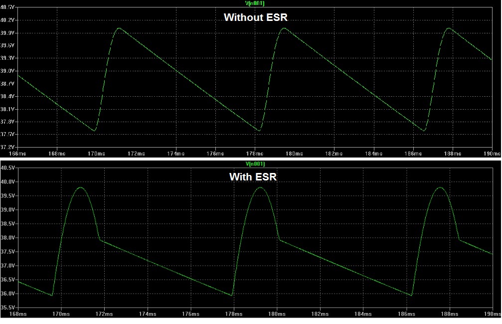

Just did a quick LTSpice simulation of a 40V linear power supply with a 14000 uF reservoir cap and an 8 Ohm load, with no ESR and with 0.1 Ohm ESR. The attached ripple voltage plot shows the effect. It's due to ESR.

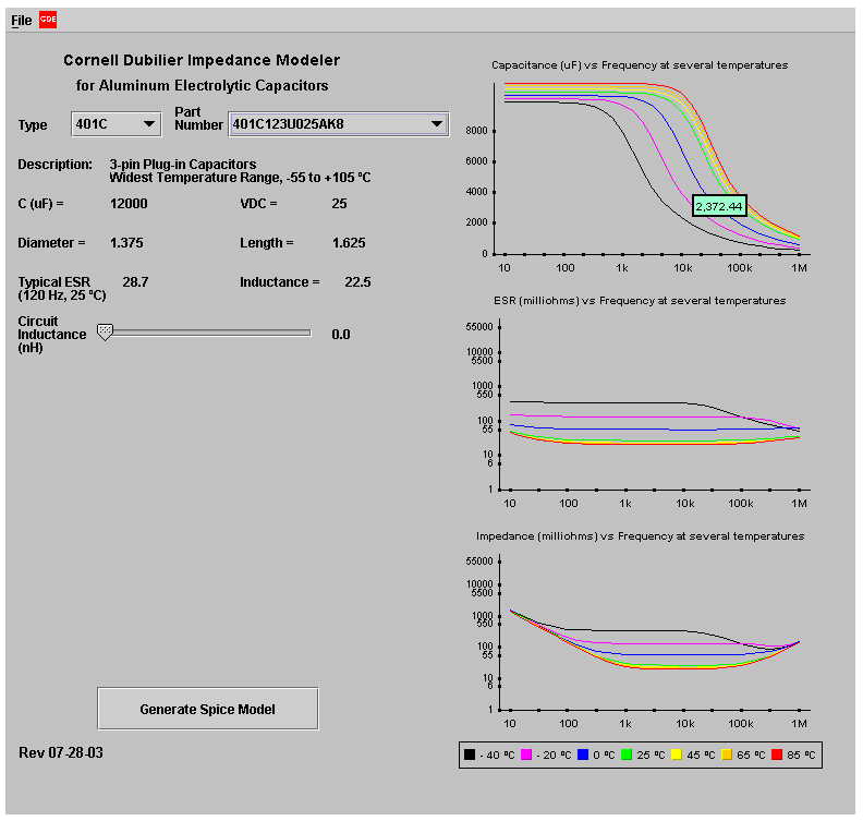

One big problem is that the ESR of electrolytic capacitors changes dramatically with frequency, which is difficult to model with LTSpice. There are equations on my psu model's scheamtic for changing the ESR for different frequencies, but it's a pain, and there's still no way to accurately model ESR for signals with wide spectral content, like fast edges. However, Cornell Dubilier does have a Java applet that automatically creates downloadable spice models for (their) electrolytic capacitors, that include the frequency and temperature dependence of the ESR! It also just plots these characteristics for you, if you're not into spice. The link is at

I was going to respectfully disagree, and was going to say the following:
ESR varies directly with frequency. (It is part of the impedance, too).
DF = TAN(DELTA)@f = 2Pi*f*C*ESR(f)
The tan(delta), or DF (dissipation factor), varies by only about 100%, usually. So we can use that to estimate ESR versus frequency, with
ESR(f) = tan(delta)/(2 Pi f C)
But then I looked at:
Cornell Dubilier Electronics
which gives something like this:
http://www.diyaudio.com/forums/atta...eling-film-caps-electrolytic-caps-cdejava.jpg
And so another long-held misconception bites the dust.
Thank you. I just wish I had noticed that, years ago, before it cost me so much extra effort when doing spice modeling and simulation. (But the capacitor spice models from that CDE java applet are coool.)
Thanks for this finding. It's worth more investigation.
Is it not a good way to determine the optimal value of the reservoir cap such as the peak in the waveform with ESR does not show up ?
I don't think that it's a good way to determine the optimal value.
If the waveform show significant distortion due to Capacitor ESR it's time to buy a new capacitor.
It's either not a very good capacitor to start with or it has been abused and it's getting near the end of it's life.
In my experience all the reputable manufacturers' capacitors won't show that effect in a typical circuit. I have only seen that sort of waveform with poor quality electrolytic capacitors.
