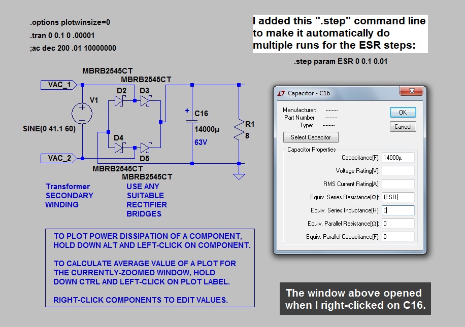

Going back to your original question: It would be trivial to parameterize (i.e. make a variable for) the ESR (and other parasitics if desired) in the capacitor in my LTSpice schematic, and then tell spice to step the parameter, either according to step size and start/end steps, or, according to a list of step values that I provided. Then when I click the "run" button spice would automatically perform multiple simulations and churn through all of the steps without stopping and would then display all of the waveforms on one plot on the screen. I could have actually done it in about the same time as it took to type this paragraph. (I'll do it and be right back, just so you can see the waveforms, and imagine the myriad possibilities!)
I attached the plot, and also attached the schematic from the LT-Spice software (with some text I added in Paint), that made the plot. I'm sorry about the colors and the brightness in the images. They are much dimmer than they are on my computer, on the original LT-Spice software's screens.

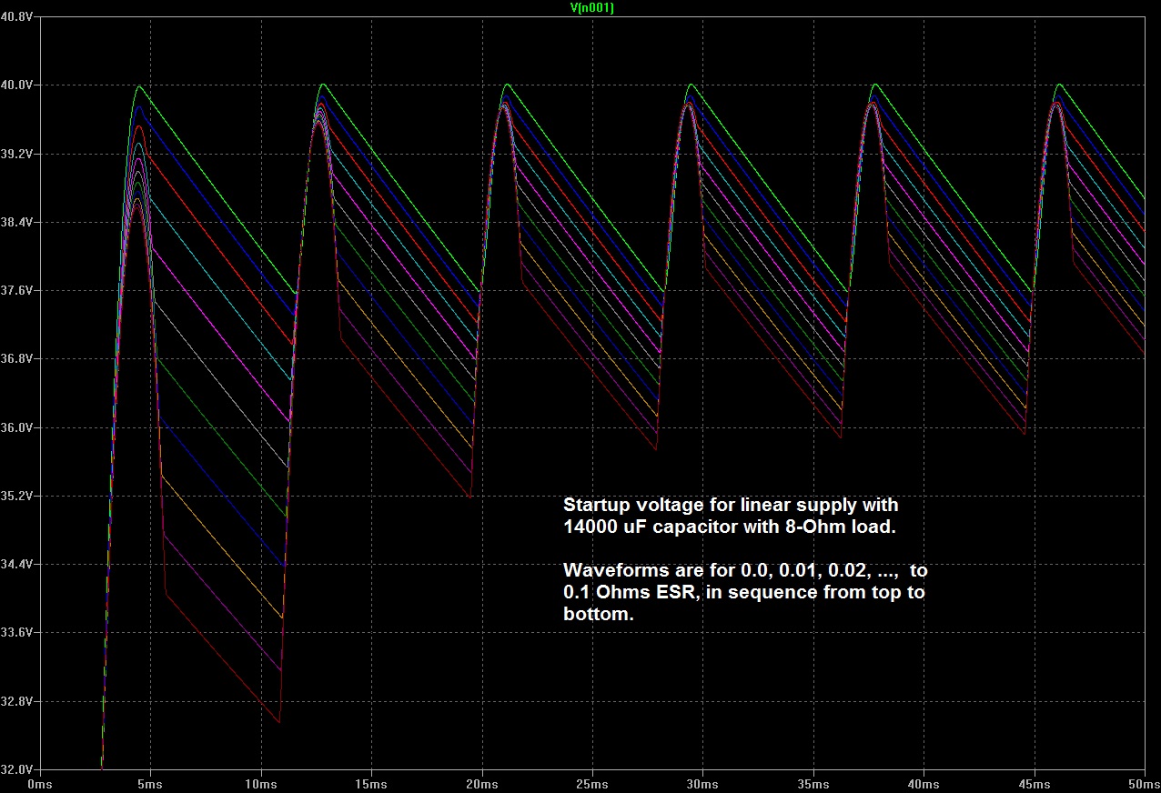

Just did a quick LTSpice simulation of a 40V linear power supply with a 14000 uF reservoir cap and an 8 Ohm load, with no ESR and with 0.1 Ohm ESR. The attached ripple voltage plot shows the effect. It's due to ESR.
LT-Spice is really great. You can just draw a schematic and then click the RUN button, to simulate it.

On your schematic (and I am aware it is simple for demonstration purposes of parametrisation) check the values of diode currents...
You are, hopefully, aware that real world sources like transformers have many parasitic components (resistance, stray inductance, stray capacitance, saturation current etc...). Capacitor ESR is often a relatively minor variable compared to winding resistance and sometimes even diode resistance, and to make matters more interesting, it can be non-linear (highly so as ripple current approaches upper limits for your chosen caps). Capacitor ESL also likes to play tricks making resonant circuits on one, and stray capacitances/inductances of a transformer on the other side of commutating diodes, with diode recovery adding a nice interdependency to it all...
Yes, the fantasy that a power supply just produces an easily understood ripple voltage does no-one any favours; it seems that nobody else has ever listened, as in using their ears, to the glorious song that the supposed DC voltage rails are giving voice to when they're being driven hard by real audio signals.You are, hopefully, aware that real world sources like transformers have many parasitic components (resistance, stray inductance, stray capacitance, saturation current etc...). Capacitor ESR is often a relatively minor variable compared to winding resistance and sometimes even diode resistance, and to make matters more interesting, it can be non-linear (highly so as ripple current approaches upper limits for your chosen caps). Capacitor ESL also likes to play tricks making resonant circuits on one, and stray capacitances/inductances of a transformer on the other side of commutating diodes, with diode recovery adding a nice interdependency to it all...
But, simulation will do the job, and give great insights, IF you include all the parasitic and non-linear behaviours. Simple model, almost meaningless results; complex, ever more accurate modelling -- there are no limits as to how sophisticated the model can be made -- will give you Ah-haa!! moments ...

Of course! I am glad to see that you appreciate the importance of parasitics and non-linearities. Ironically, I have usually been the one who has been reminding everyone else to consider them!
That schematic and simulation were meant to illustrate ONLY the ESR's simplest effect on the ripple voltage waveform. Read back a few pages to forr's posts. We were trying to help him identify and understand the cause of the shape of a ripple-voltage waveform that he had measured. I was merely showing that it was caused by the ESR of one of the caps that he was using, and responding to his question about the possibility of varying the ESR to see how that affected the waveform (and trying to convince him to start using LT-Spice).
