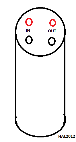

special caps under development
There are these special caps under development at the lab

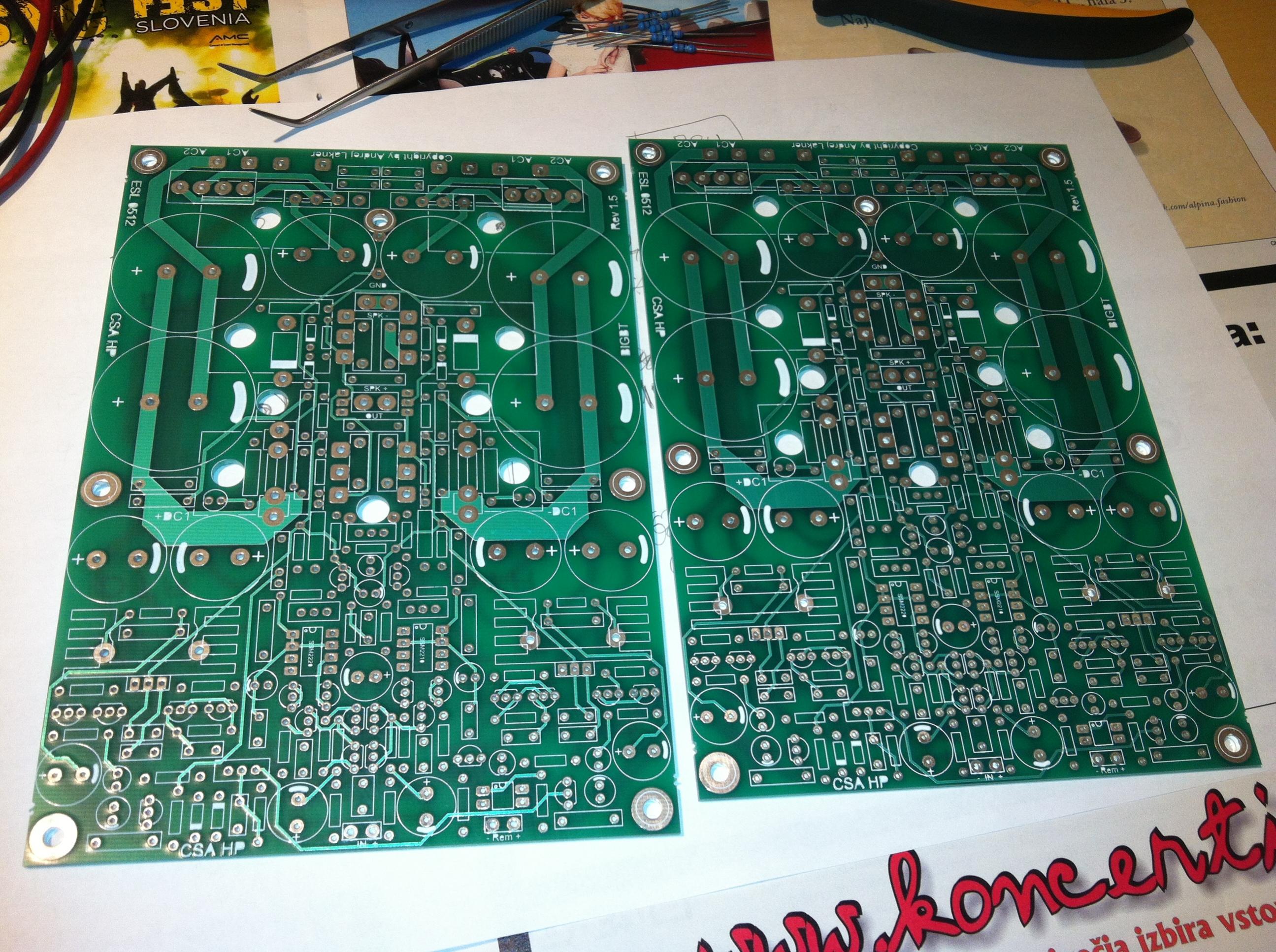

Hi to all DIY friends :wave:
Nico it's good that a discussion about amp PSU-s is opened from time to time, to share experiences and to enlighten certain practical guidelines for DIY-ers to make better amps.
From mine past amps I learned that separate PSU rails for a front-end/output stage is a way better solution, simply because relation between front-end and output stage is similar to Beauty and the Beast like. PSU's impedance/current capability demands for the two are so apart from each other that the best solution is to supply them separately and than allow them to dance together.
In short, my practical instructions for amp's linear PSU would be:
- 4 times VA to Wrms rating for the mains transformer, over current capability (low impedance, core magnetic reserve) to fast charge the caps
- fast/ultra fast on amp PCB rectifier pairs, separate for front-end and output (4 all together)
- 2000 uF/A capacitance bank in my SSA/CSA case it means 2200 uF/rail for front-end and 22000 uF/rail for output stage (100 Wrms/8 ohm), all caps on amp PCB mounted
- as short as possible PCB tracks to the outputs
- on PCB two star grounds (one front-end PSU GND, other output stage PSU GND) connected together with 5-10 mm track, prevents interference between high/low currents in each GND
- quality of the electrolytic caps is a must
- decoupling with 1 uF/0,1 uF, especially in splitting/ending points on PCB
Example is CSA PCB in attachment. Nothing new but just one more practical example from the real build. ;)
