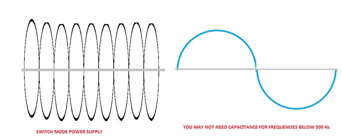

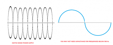

Could someone adapt the methodology in #66 for switchmode power supplies
I still don't understand the calculations in post #66.
