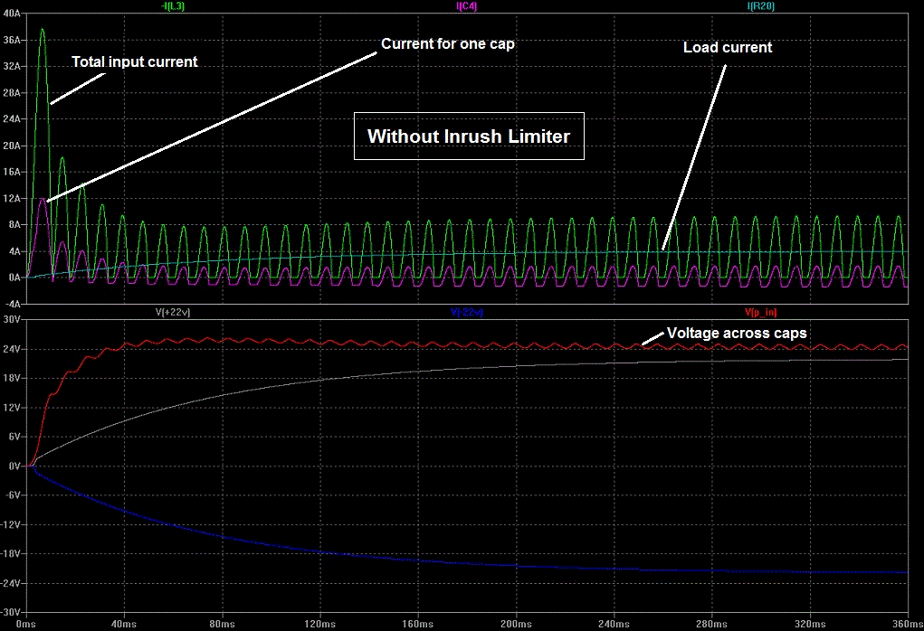

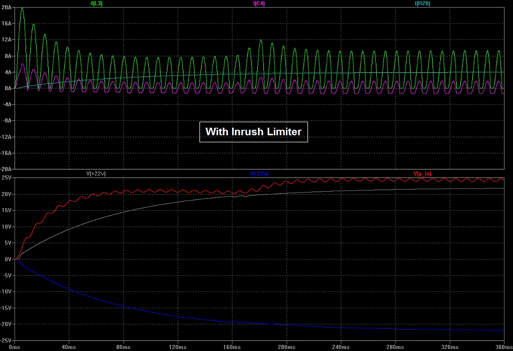

(I am still working on the psu design that Nico suggested. This is basically unrelated to that.)
You might find that the phase angle at the transformer, when the AC was last switched off, if it leaves the core magnetized in a particular way, can affect how bad the next startup transient can be. I've forgoten the rest of the details but it's on diyaudio somewhere.
In any case, although the capacitor currents will have very large peaks, they are only that large for a relatively short time. So certain types of components' limits that are exceeded will not necessarily result in automatic immediate destruction of anything, basically because the duty cycle is so low. But the bottom line here is that you should check the specs for the affected components (especially the rectifier bridge), to see how they are rated for such currents. Some types of components might fry at the very first pulse while others could operate fine with them, for decades.
I remember designing a small (22 Volts, 4 Amp) regulated power supply, once, where I had to use an inrush-current limiter for the caps, because otherwise the adjustable regulator couldn't have a large-enough cap to bypass its adjust pin, because that would make the regulator's input-output differential voltage possibly go beyond the maximum spec for the regulator, during startup. Anyway, for the first 170 ms or so, a one-Ohm resistor had to carry the full inrush current, which peaked at about 20 Amps (down from 38 Amps without the limiter). At the peaks, the resistor had to dissipate 400 Watts. After looking at resistor datasheets, it turned out that I could use a 5-Watt resistor (of a particular type) and still have so much safety margin that the resistor never got warm at all.
I attached a couple of screen shots from LTSpice simulations of the startup, with and without the inrush limiter. These might give people an idea of what happens at startup.
This is for a 22-Volt regulated supply, with 4 amps being drawn by the load after the output voltage stabilizes.
(Note that one potential advantage of using multiple parallel caps is illustrated: The total ripple current is divided among the caps, making each cap's ripple current requirement much lower.)
The power transformer was also modeled, with more than the usual amount of detail. It was a 120 VA Hammond toroidal type, with paralleled dual secondaries, which made the rating 25V@4.8A.
Upstream from the transformers, I even added a model for a portion of the AC Mains wiring, that someone had given to me. (But it looks a little wrong, now.)
The schematic is actually still on line, at
Spice Component and Circuit Modeling and Simulation .
The transformer modeling information (and downloadable spice model and transformer measurement instructions) is also there, at
(Note that nothing is for sale, on any of my webpages. Some of them still look like it but there should be something saying nothing is for sale, any more. I left most of them on line, at first, because people liked having them for references. It's been long-enough now that I could take some of them down but I haven't taken the time for that. Anyway, nothing is for sale there.)
- Tom
