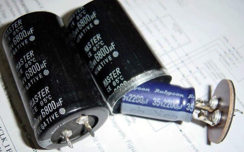

Katie&Dad here is a low budget cap.
NO that is a FAKE cap. If you are really that strapped for cash you will get no-where.
I've never heard of Krummer. Germany is generally renowned for good engineering so I can't see any reason why not to try them.
