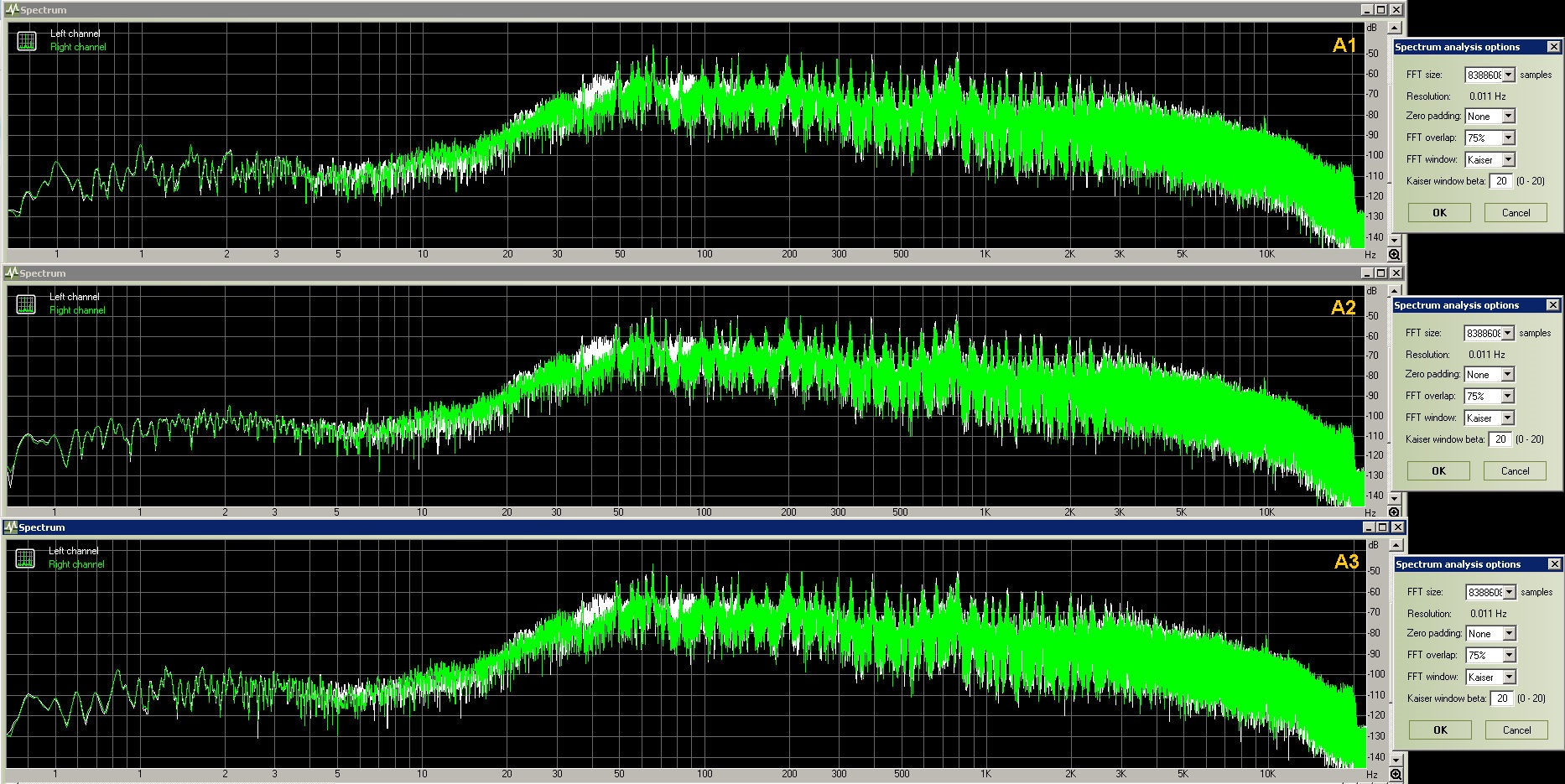

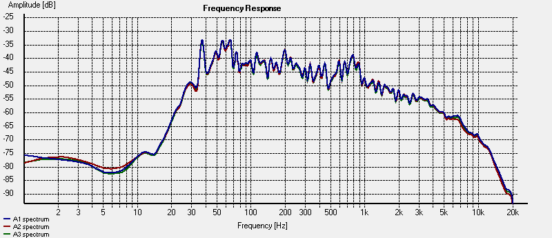

I'm just not finding that big a difference in A1, A2, A3.
Yes, A3 is about 0.5 dB below the other 2, but the spectrum is remarkable the same, as far as I can tell.
Below is a plot of all three spectrums with 12th octave smoothing. They look pretty much the same with no smoothing, just harder to see. No odd spikes or anything. I've boosted A3 by 0.5dB to line it up.

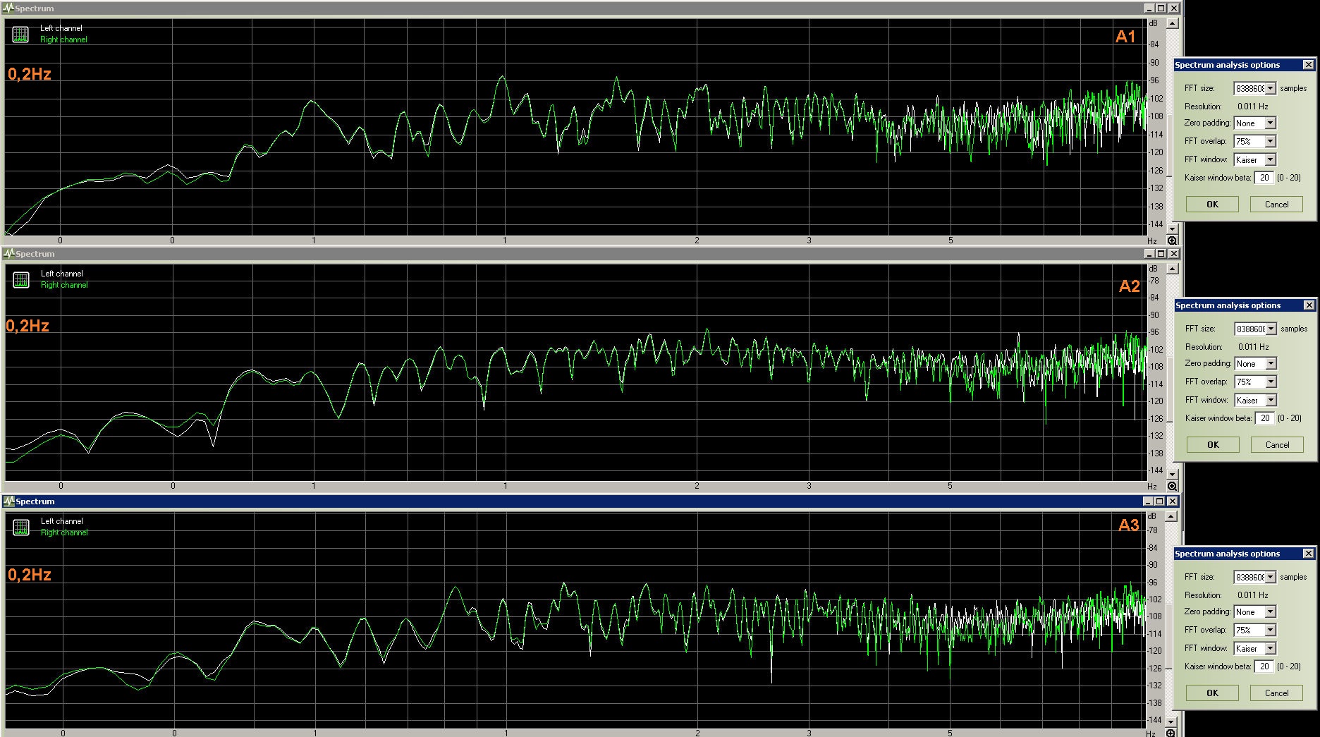

Is this wrong? The files look very similar to me. The only noticeable differences are in A2 and some small subsonic level differences on all 3. That's below 7Hz

Nope. Scott knows his tools and I suspect he looked at the results more than once to make certain. Besides, same tool was used on both cuts, so the FFT didn't decide to misbehave only on one selection.Yes, the lows being different doesn't make sense. I'm puzzled about that. Perhaps a limitation of the FT?

That was all I was answering, someone compared A1 and A3 and I found the .5dB difference there.
Is this averaged out measurement.
I just want to repeat, ignore A2/B2 - my bad. But if a difference @ 1KHz and flat response, then 0.5dB is unacceptable - we know which file will be favoured. But an average out up to 20KHz?
