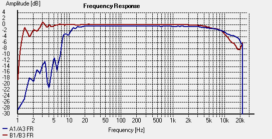

So, is there any way/plan to measure the harmonics?
I don't have a way to do this with the files provided. I'd need a swept sine, which means doing it all over again. 🙁
Posted below are the frequency responses of A3 vs A1 and B3 vs B3. We see the expected HF roll off that the modification should cause, but I don't know what's going on in the very low end.
I don't know. HOLMImpulse allows you do import 2 wav files and compare one to the other. The graph show the frequency response difference. I think it does the same thing with internal measurements, compares the generated test signal file to the recorded signal.
With a swept sine you can see THD and harmonics.
That's what I used.

Ah, thanks. I've been immersed in ARTA recently, and I really should play with HOLMImpulse more than I have so far.
You're welcome. The ability to compare to files like this is very handy when someone claims that sine waves are not a valid test. You can use noise, music, speech, sound effects, whatever. It does show only FR difference on non-sine signals, but that at least gives you a real idea with a signal you'd want to listen to. 🙂
FWIW, I have checked this function on several types of signals and it works just fine. Simply make a copy of a file, filter and alter the copy anyway you want and compare it to the original. The graph shows exactly what you did, and consistently.
