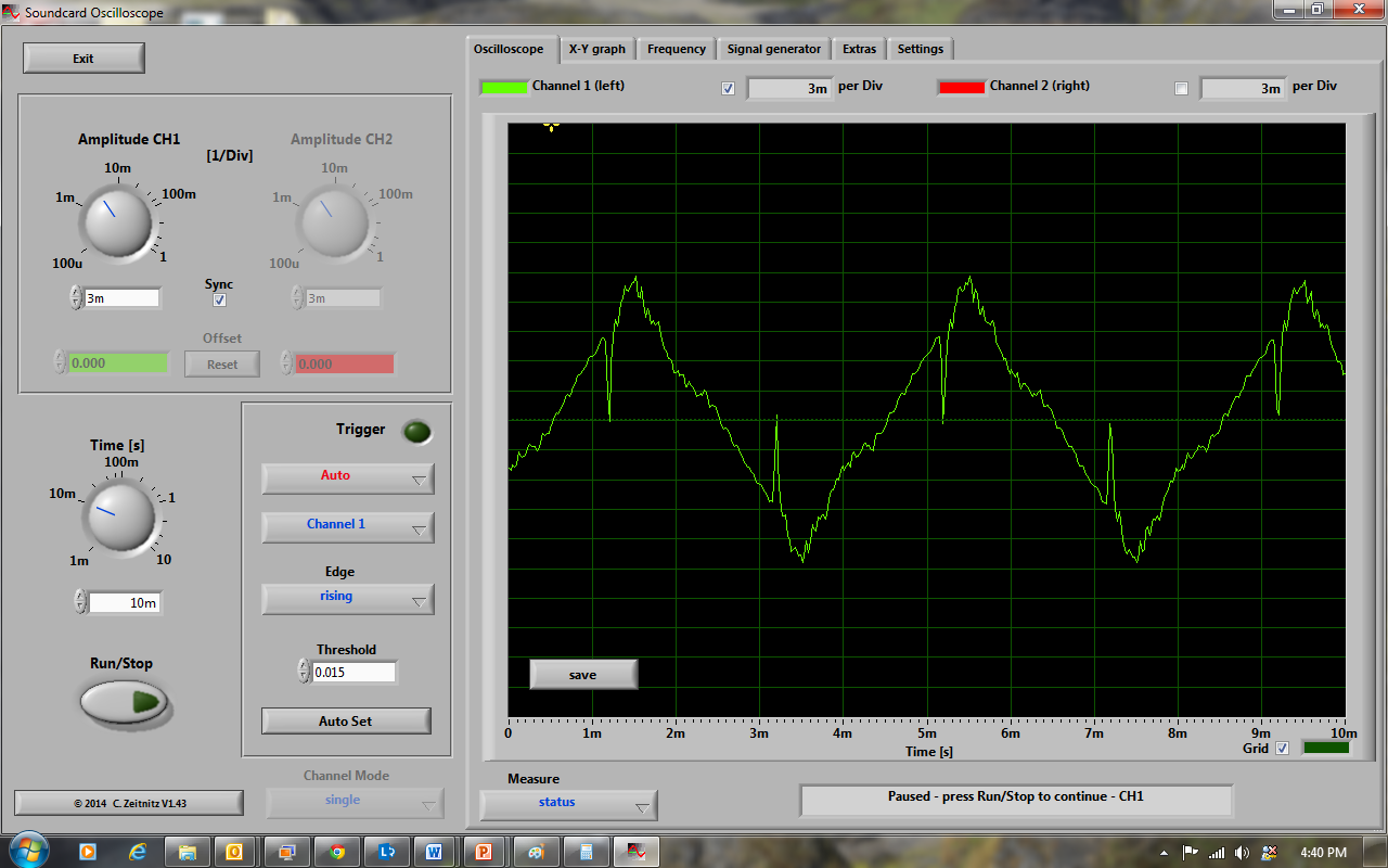

Hi X, there are many ways, but this is propably the most "reveraling" way is to video it (like bwaslo has also done). See if you can make some measurements like this, you only need the basic measurement tools: http://www.diyaudio.com/forums/subwoofers/258706-study-dipole-cardioid-bass-horn-37.html#post4058732

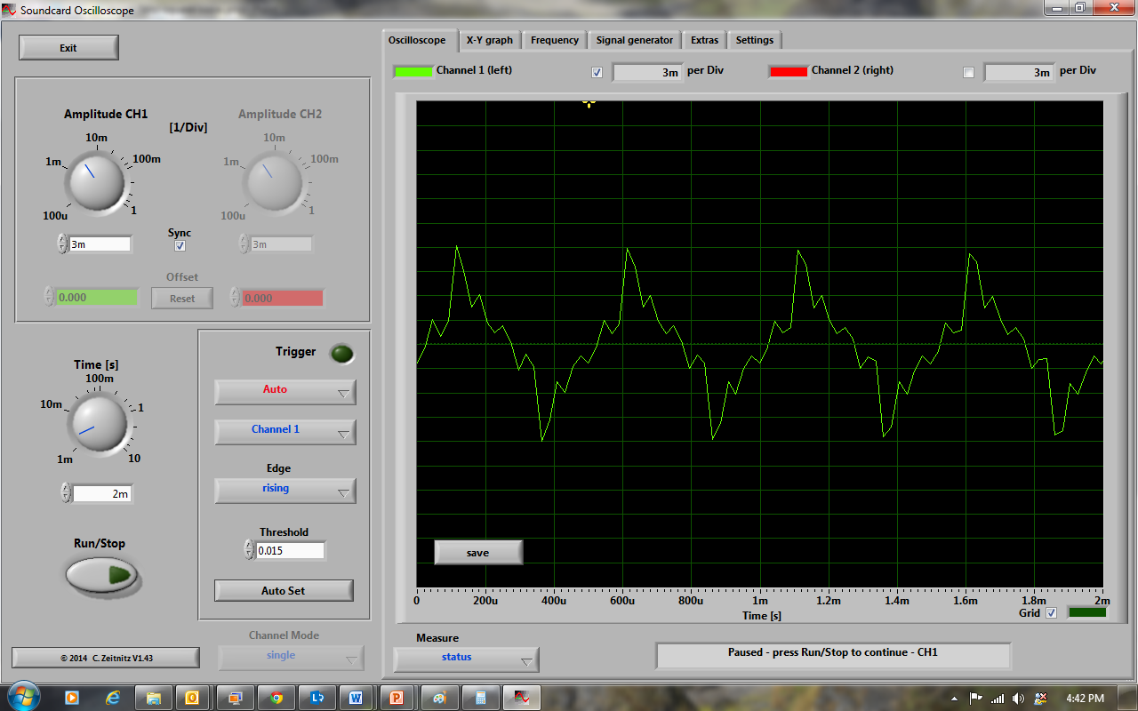

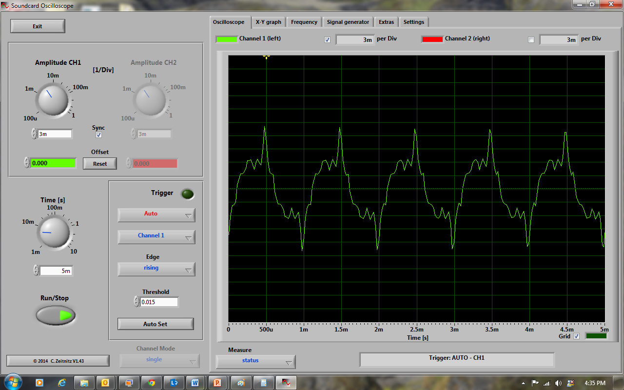

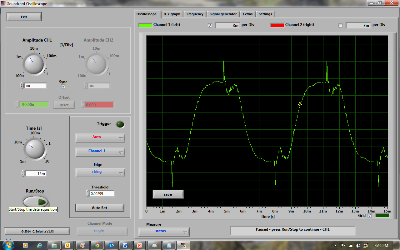

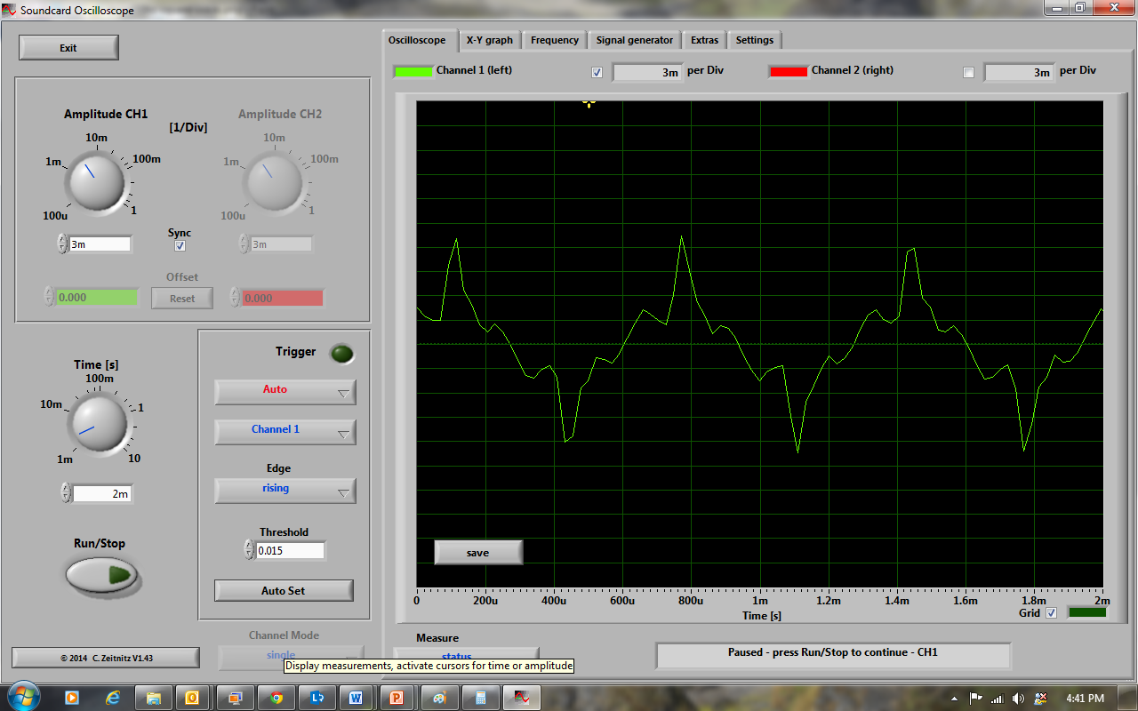

Square waves with the 3FE22 Trynergy

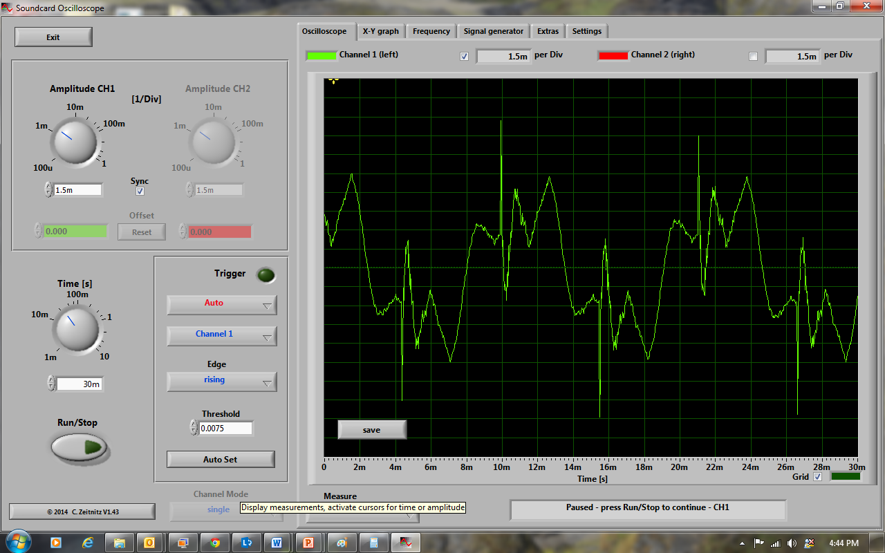

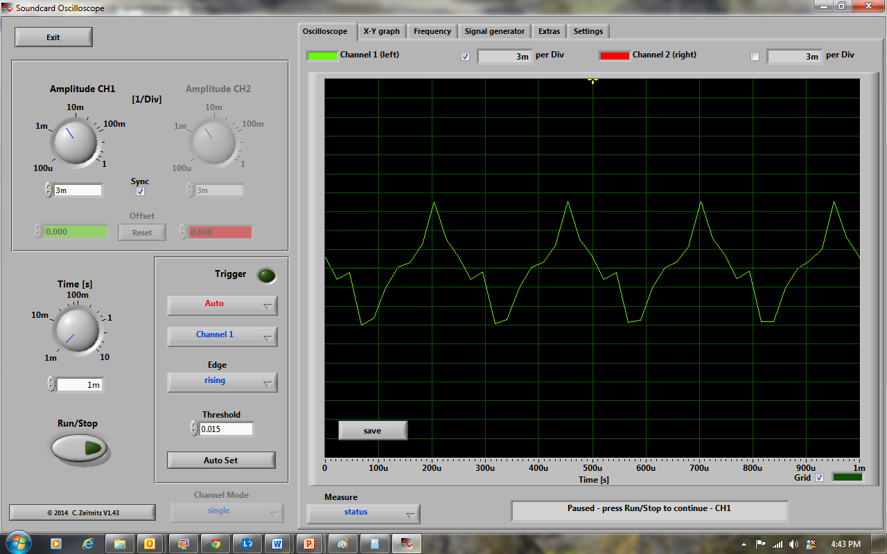

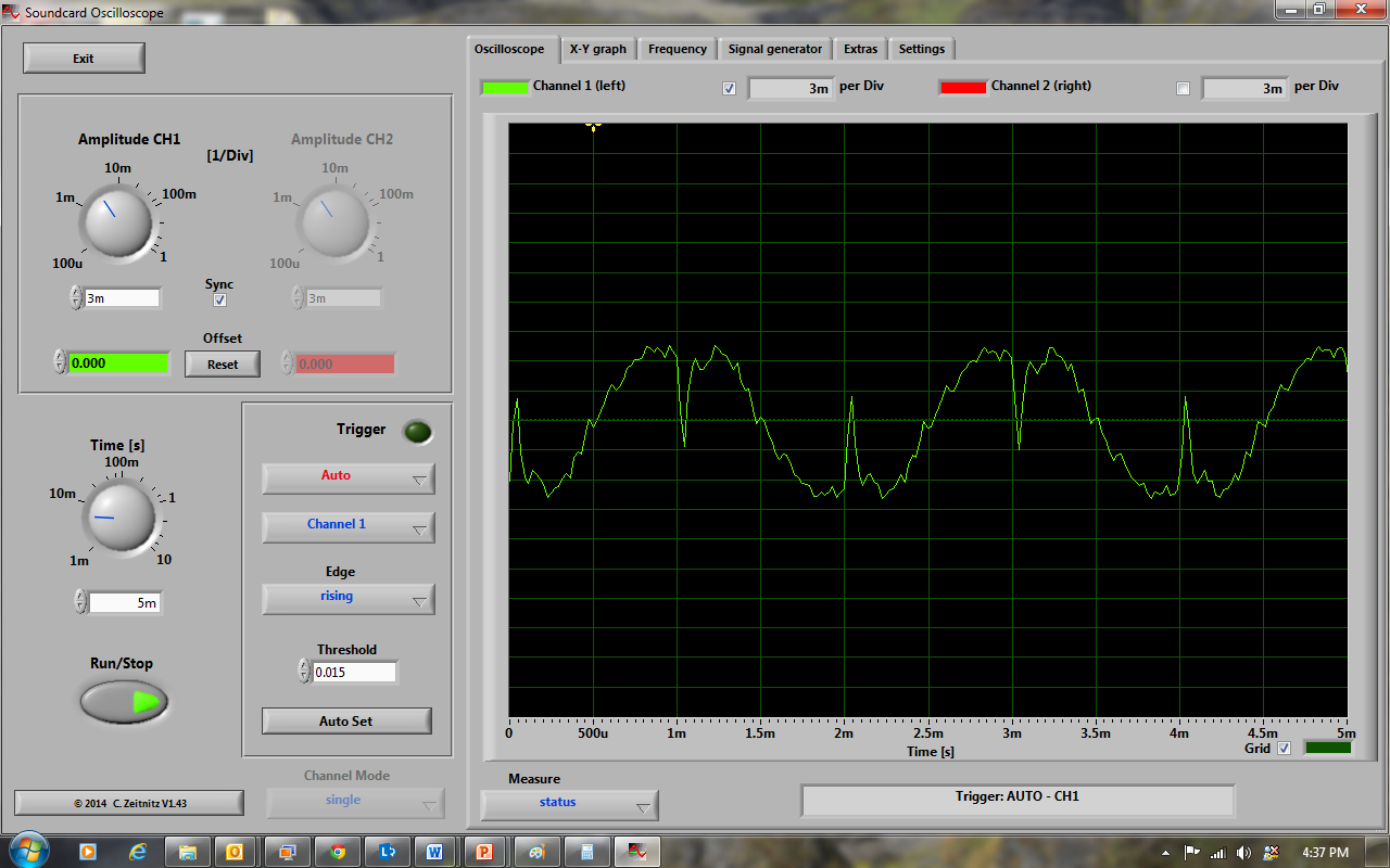

I used the O-scope program that Legis suggested and the built in sound generator in REW to make the square waves. (I compared them against square waves in Audacity and got the same result).
I did it at several frequencies and found some that made more "square" than others and in general they look more like spikey triangle waves. The square wave test is indeed difficult for a speaker to replicate. I am not sure how much of this is the amp or the speaker. Maybe a good test would be a bare driver in an OB at low amplitude to see if it can make a square wave to start with.
90 Hz
156 Hz
250 Hz
500 Hz
1kHz
1.5kHz
2kHz
4kHz
I do see the source of the sibillance though in the sharp spike that occurs - perhaps a remnant of class-D amplification?
Don't know...

X, if the xo point was around 300Hz (?), then those higher freq squares should be more square-like if only one driver is producing them and it operates in "minimum phase". That requires that the cone moves in straight causation related to the current in the voice coil, ie. in pistonic manner. The first cone break-up mode is a definite sign that the the pistonic motion/minimum phase radiation has been at least somewhat lost beyond that frequency. This is how I understand it.
You could try the driver in closed box and see what it's like then. Also maybe OB would do with completely absorbed rear wave. Perhaps horn loading can make the cone bend more since it has to drive the air inside the horn. Tractrix flare does not load the cone uniformly/frequency independently, maybe it can also make some difference to cone-bending behaviour compared to horn flare that loads uniformly/frequency independently.
You could also try removing the equalization from the driver and test if it does make any difference. I think eq'ing a "minimum phase region" can have a different effect on phase response/group delay than eq'ing a "non-minimum phase region" of the response.
It would take a pretty screwed up amplifier to screw up a square wave as much as a speaker!
Remember that to reproduce a recognizable square wave, the frequency response has to:
1) Have a reasonably flat dB response (maybe within 3dB or so) from the fundamental frequency to about the 5th harmonic (extra points for 7th and 9th harmonics).
2) Have a phase response that can be made flat horizontal (within maybe 20 degrees or better) over that frequency range by only adding or subtracting a constant delay. You might do that with OmniMic or XSim.
3) That flat phase has to be either zero degrees or 180 degrees. In other words, between about -20degrees to +20degrees or between 160 degrees and -160 degrees. Flat phase at other angles (such as 45 or 90 degrees) won't be waveform accurate.
All that can be pretty hard to do. And not particularly worth it, as far as I've been able to tell.

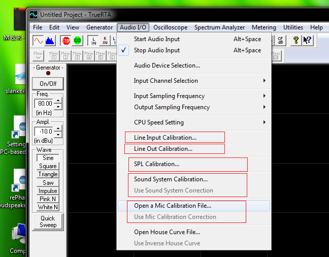

Great thanks, personal very interested this square wave info.

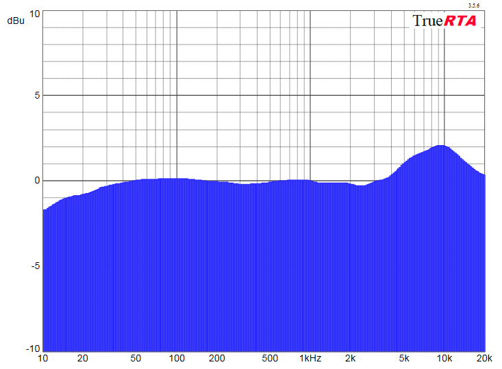

Regarding PC scope can i suggest program TrueRTA in level 1 (freeware) because it takes correction files verse Soundcard Oscilloscope, and it takes correction files for several devices in measurement chain as seen in picture-1 below marked with red squares. The programs license levels just affect the resolution in RTA function, not the signal generator and scope functions, just checked it myself running the freeware version on another PC.
A quick test here seems at a EQ'ed fullranger sealed running the correction file for UMM-6 verse not running correctionfile gives different relative square wave hit counts, when playing bwaslo file "squarewave sweep" or Legis files "A - 50-750 squarewave sweep mono 70sec / B - 750-4khz squarewave sweep mono 70sec".
Attached picture-2 visual RTA plot my personal UMM-6 correction file.
Link to freeware TrueRTA: True Audio: Audio Spectrum Analyzer and Loudspeaker Design Software

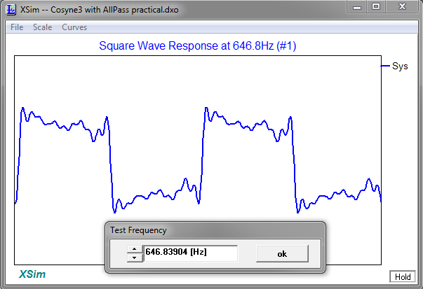

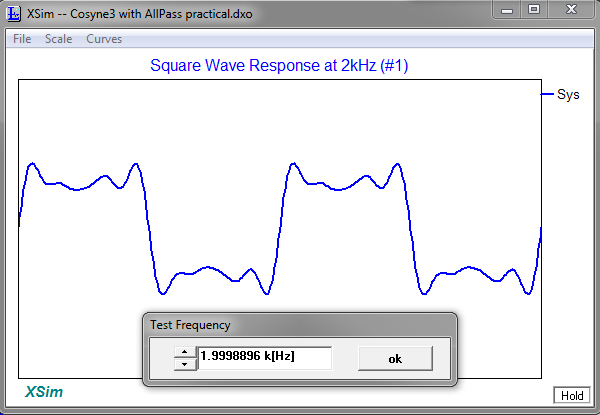

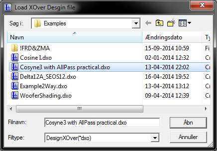

xrk971, bwaslo suggestion post 189 regarding XSim, couldn't it spare you some time by loading into XSim the measurements you already have.
Never used the program before, did install and 10 minutes after produced plots as in pictures.
Picture-1 the example file i opened.
Picture-2 frequency/phase that system.
Picture-3/4 did a sweep and from ~650-2000Hz capable those waves.

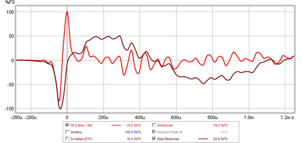

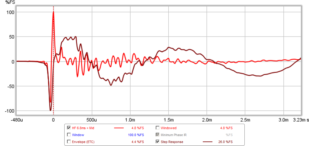

Did you look at the step response of your newest setup?
Here is the step response of the setup that I just used to record the 'square' waves. (none of which were really that square)

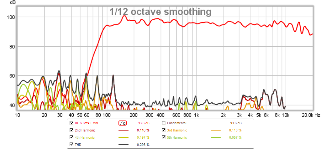

Here is the frequency response of the 3FE22 and four woofers:
![438709d1410833877-presenting-trynergy-full-range-tractrix-synergy-trynergy-step-response-fr-corresponding.png](https://www.diyaudio.com/forums/attachments/full-range/438709d1410833877-presenting-trynergy-full-range-tractrix-synergy-trynergy-step-response-fr-corresponding.png)
Here is the step response at the 1 ms timescale (also shown is the impulse response):
![438710d1410833877-presenting-trynergy-full-range-tractrix-synergy-trynergy-step-response-1ms.png](https://www.diyaudio.com/forums/attachments/full-range/438710d1410833877-presenting-trynergy-full-range-tractrix-synergy-trynergy-step-response-1ms.png)
Here is the same step response over a longer 3 ms timescale:
![438711d1410833877-presenting-trynergy-full-range-tractrix-synergy-trynergy-step-response-3ms.png](https://www.diyaudio.com/forums/attachments/full-range/438711d1410833877-presenting-trynergy-full-range-tractrix-synergy-trynergy-step-response-3ms.png)
