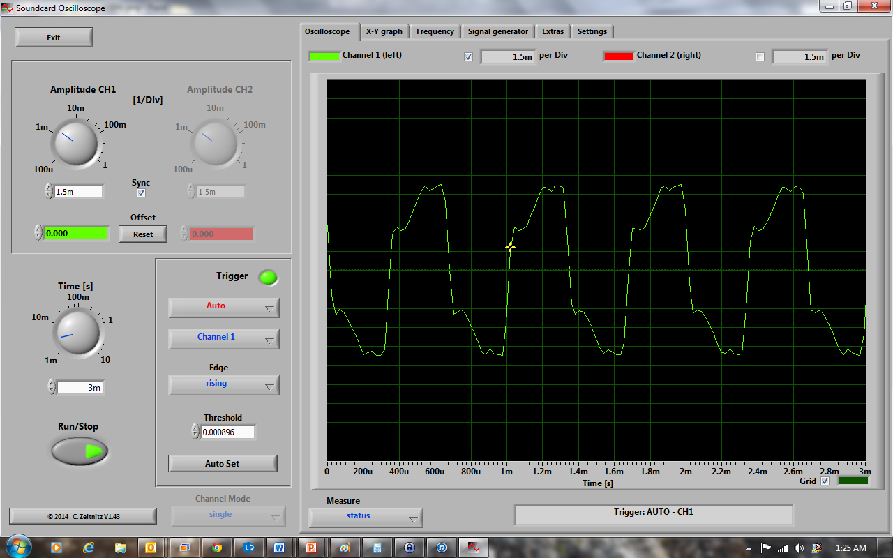

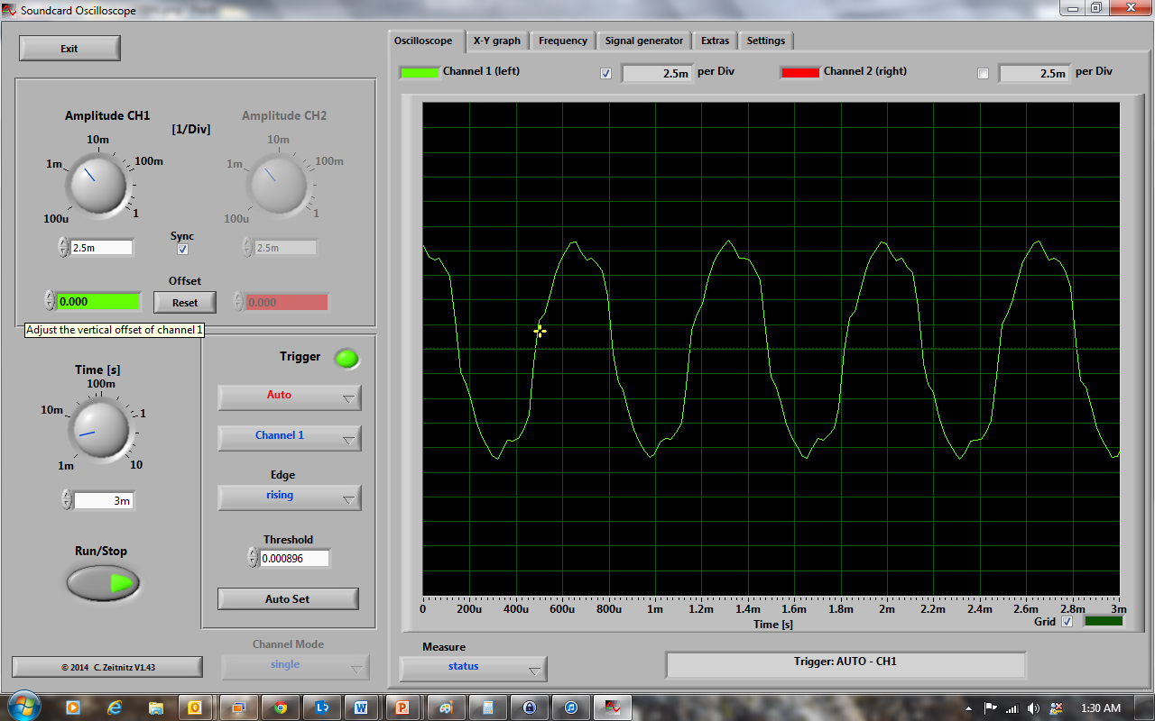

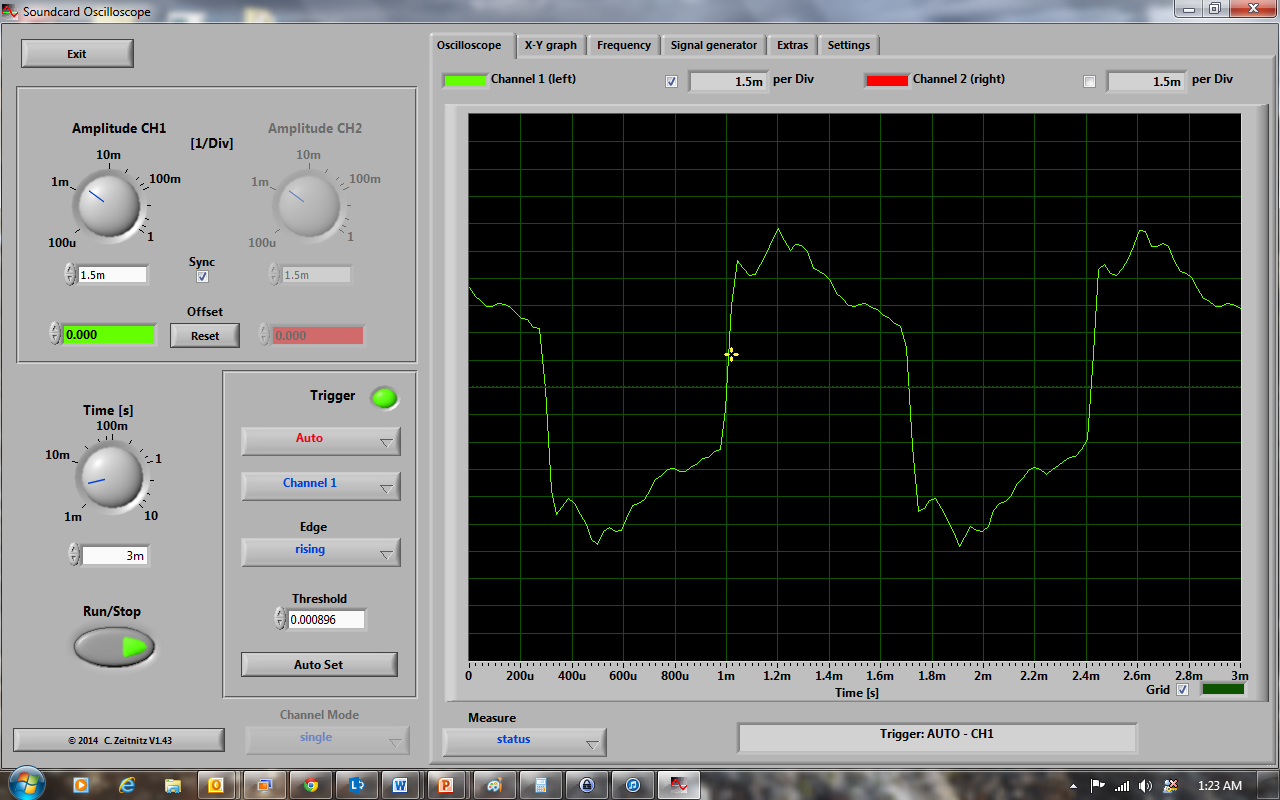

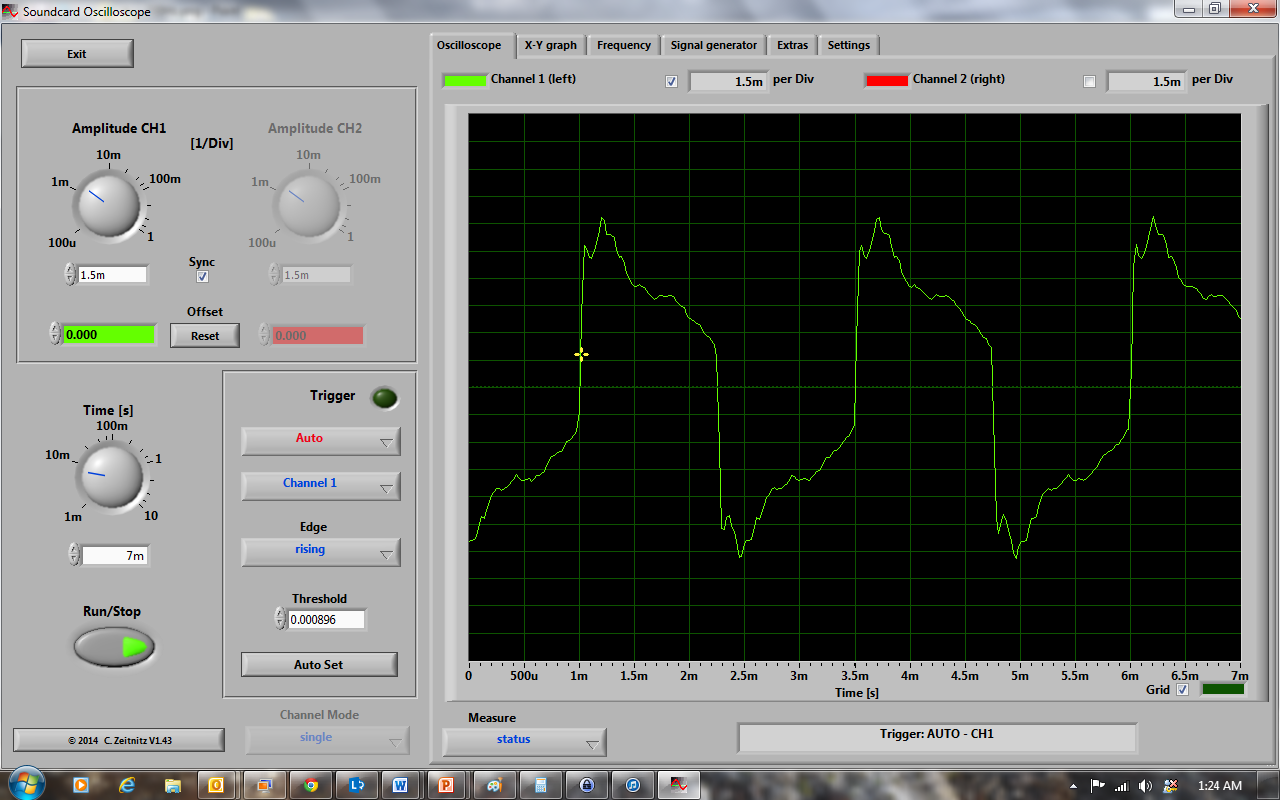

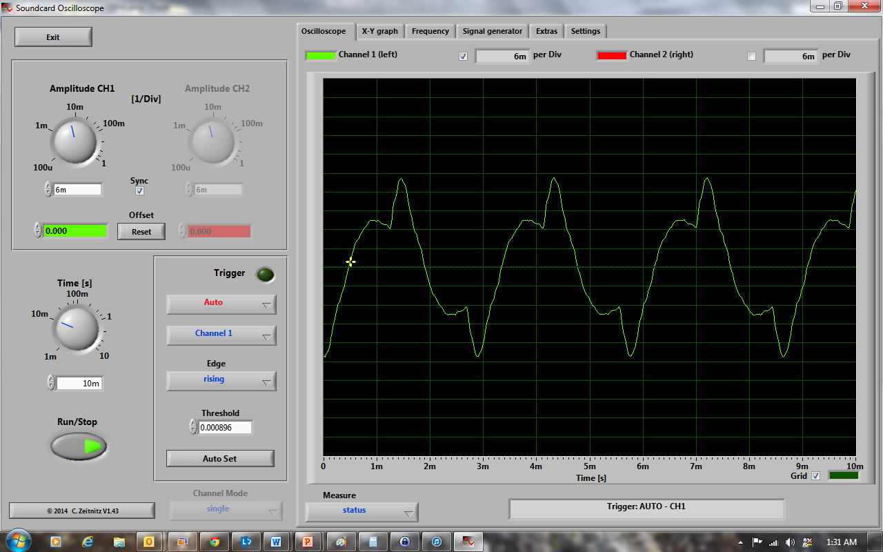

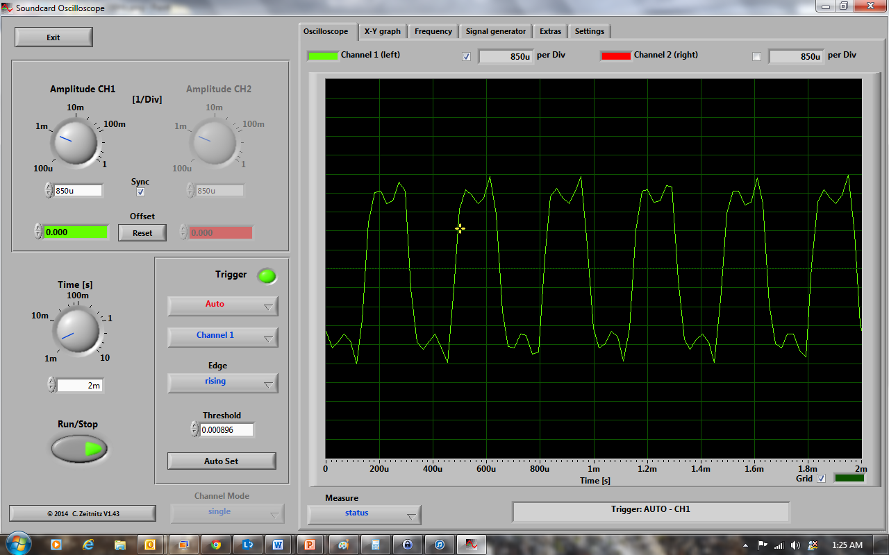

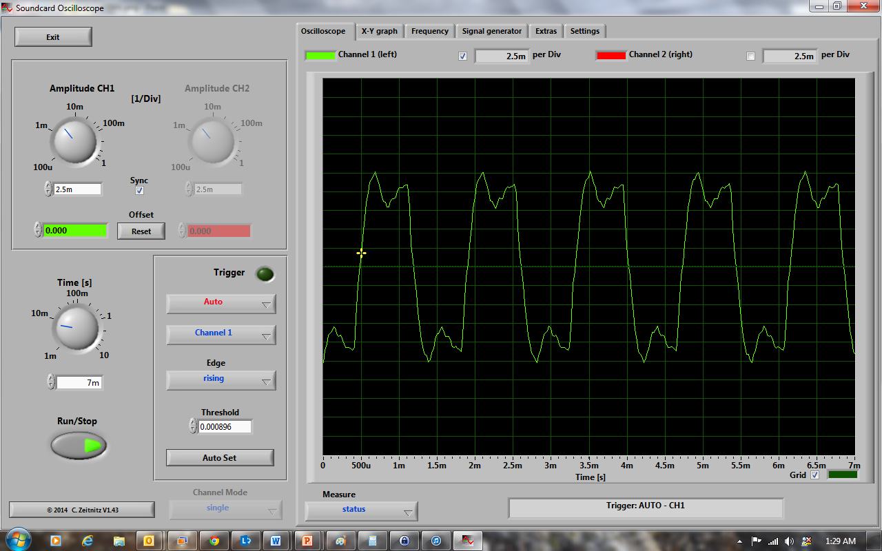

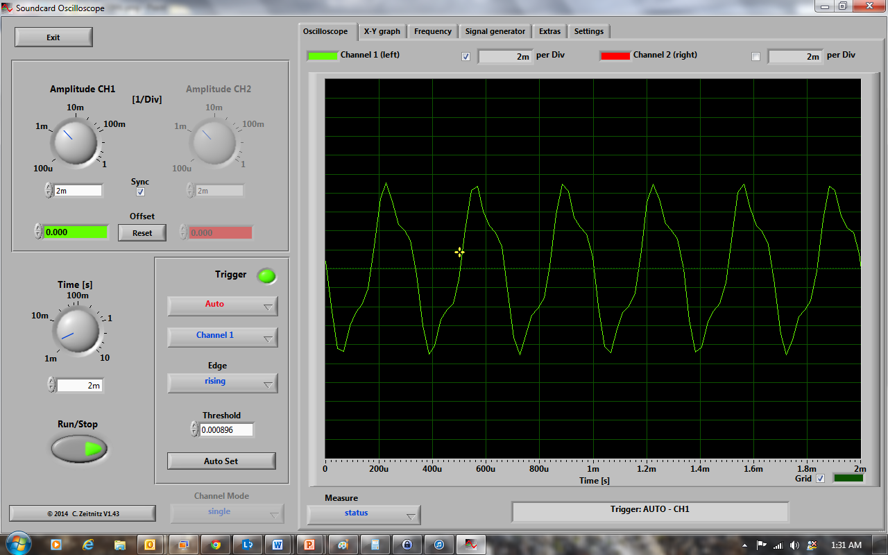

Trynergy Squarewaves with no miniDSP
Similarly, this is straight from soundcard to TPA3116D2 amp (mo miniDSP). I moved the mic to the plane of the mouth exit. It seems to be better. This is just the 3FE22.
350 Hz:
700 Hz:
1500 Hz:
3000 Hz:
350 Hz:
![438730d1410845886-presenting-trynergy-full-range-tractrix-synergy-350hz.png](https://www.diyaudio.com/forums/attachments/full-range/438730d1410845886-presenting-trynergy-full-range-tractrix-synergy-350hz.png)
700 Hz:
![438731d1410845886-presenting-trynergy-full-range-tractrix-synergy-700hz.png](https://www.diyaudio.com/forums/attachments/full-range/438731d1410845886-presenting-trynergy-full-range-tractrix-synergy-700hz.png)
1500 Hz:
![438732d1410845886-presenting-trynergy-full-range-tractrix-synergy-1500hz.png](https://www.diyaudio.com/forums/attachments/full-range/438732d1410845886-presenting-trynergy-full-range-tractrix-synergy-1500hz.png)
3000 Hz:
![438733d1410845886-presenting-trynergy-full-range-tractrix-synergy-3000hz.png](https://www.diyaudio.com/forums/attachments/full-range/438733d1410845886-presenting-trynergy-full-range-tractrix-synergy-3000hz.png)

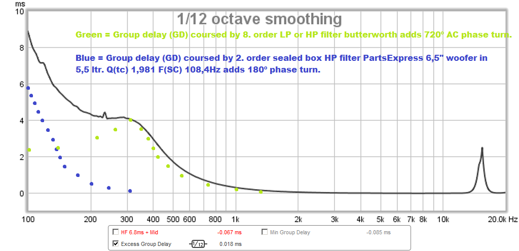

The excess group delay in REW is also a very revealing measurement.
I am learning REW at the moment but haven't figured out what EGD tells me or how to interpret it. Care to shine a little light on how to do that?
EGD down to 1kHz can be looked with 3-5ms time window, down to 100Hz with 10-20ms window and down to 20hz with 80-100ms window. I usually use those scales.

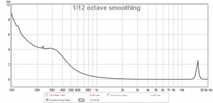

Here is the EGD corresponding to the earlier measurement showing the step response:

The steep XO slopes may be contributing to the rapid rise at 100Hz. I am running 48dB/oct slopes at present...

Excellent result for multiway is around 0,2ms @ 1khz and under 1,5ms @ 100hz. Something like 3-4ms @100Hz is propably still good for jazz and most classical music, but the most accurate/punchy bass on anything more complicated is gone. Over 8ms@100Hz is higher than I have ever seen, that would be excellent amount at 20Hz
Your steep slopes seem to contribute massive amount of EGD. I suggest you try 1st or 2nd order slopes, I have always thought they sound the best when corretly aligned. Why use 8th order slopes anyway, do you have trouble with power handling and/or extremely bad resonances right after the xo freq with the mids?
edit. The long warbling/waves in the step response could also have also been a "pre ringing" of the 8th order slope? The actual step of the mids might have been left out of the step response plot since it's time window was small. Just a possibility, I don't know the measurement specifics, or are these results correct. Alot can go wrong in measuring, time windowing and preventing the room from affecting the results.

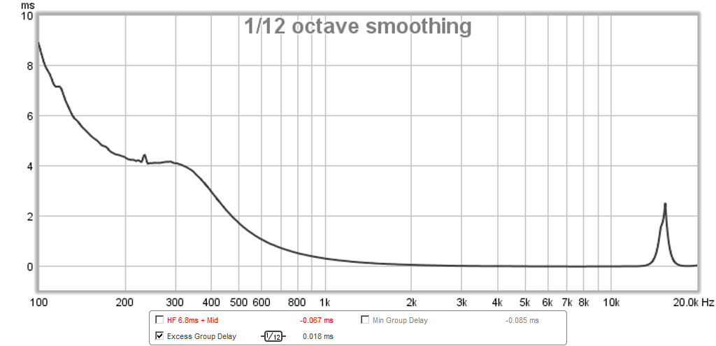

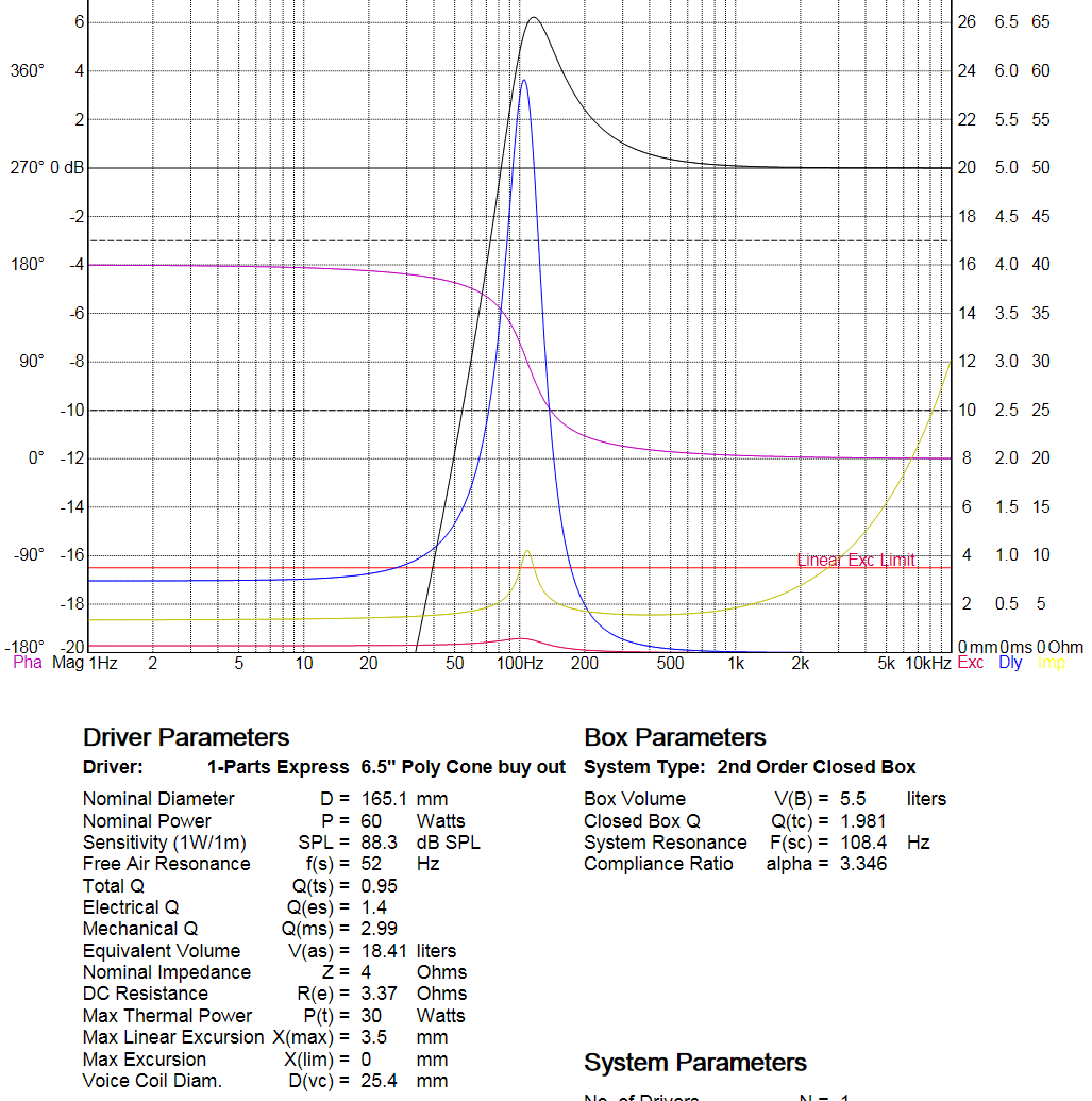

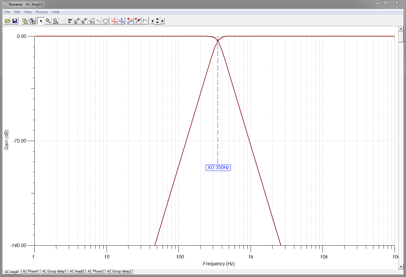

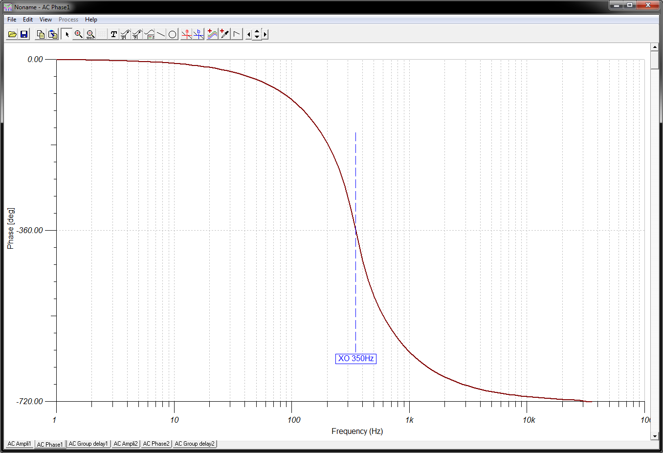

In picture 1/2/3 did electric simulation 8. orden BW XO 350Hz.
In picture 4 did simulation 2. order sealed for PartsExpress 6,5" woofer in 5,5 ltr. In reality 6,5" also frontloaded and injected into tractrix and therefor not same plot, but show the simple sealed anyway.
In picture 5 added those simulations (dots by hand) to the GD plot, seems some logic by the simulation if put the green and blue together, and the rest missing could be the added EQ by miniDSP.

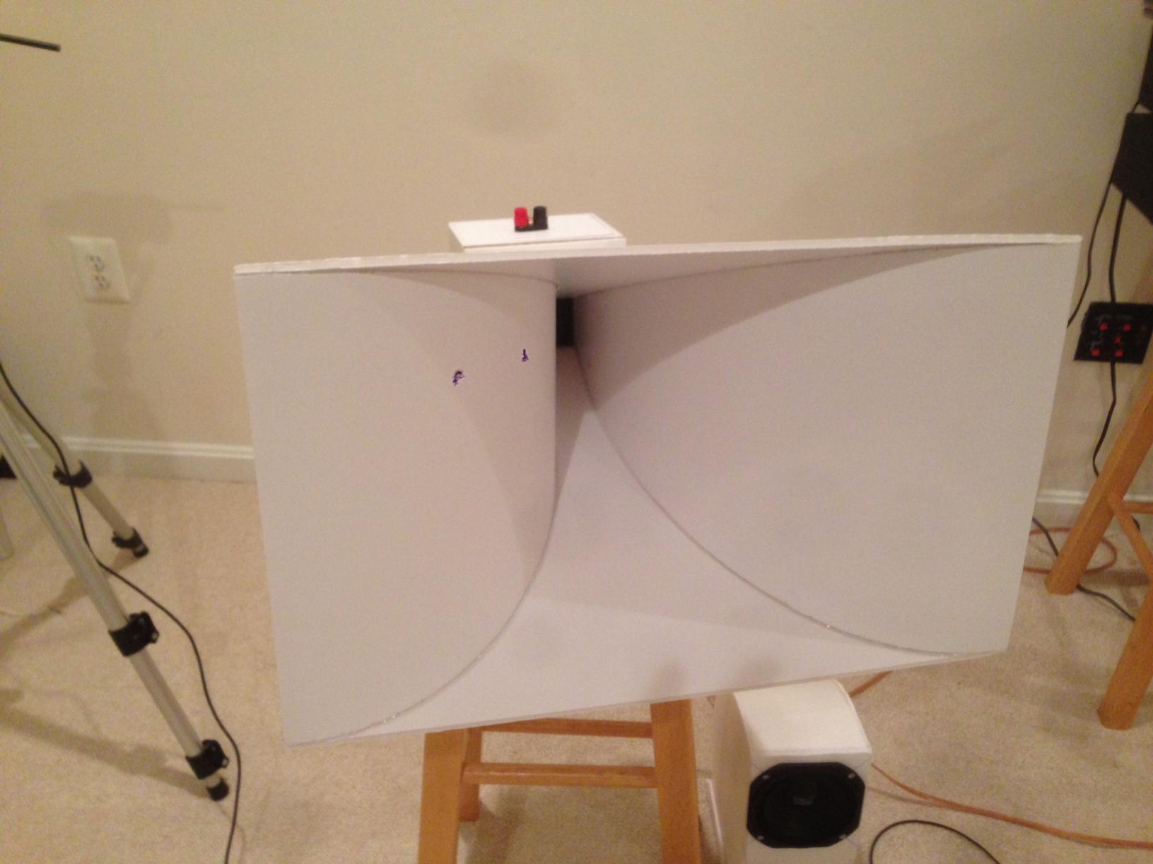

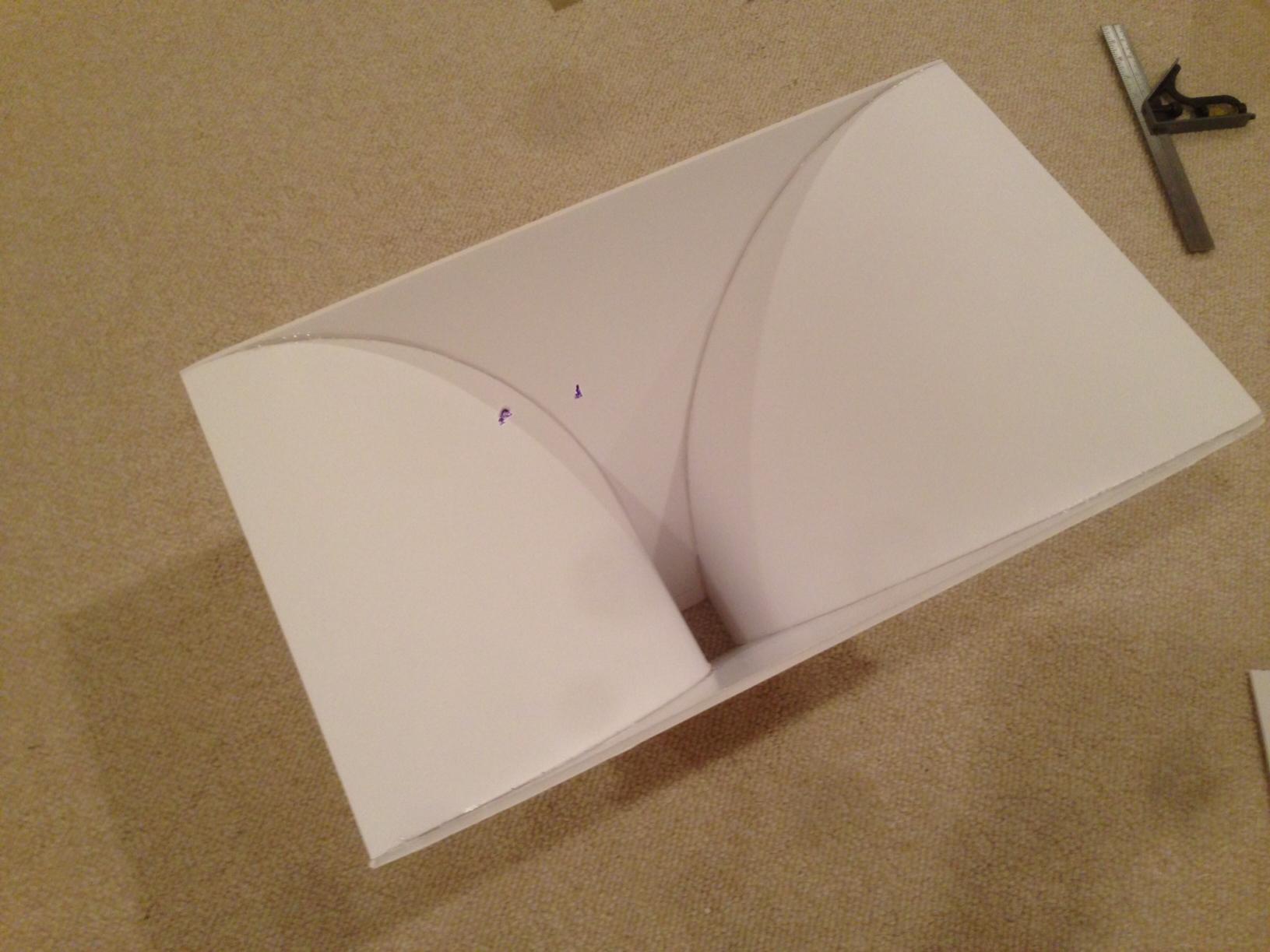

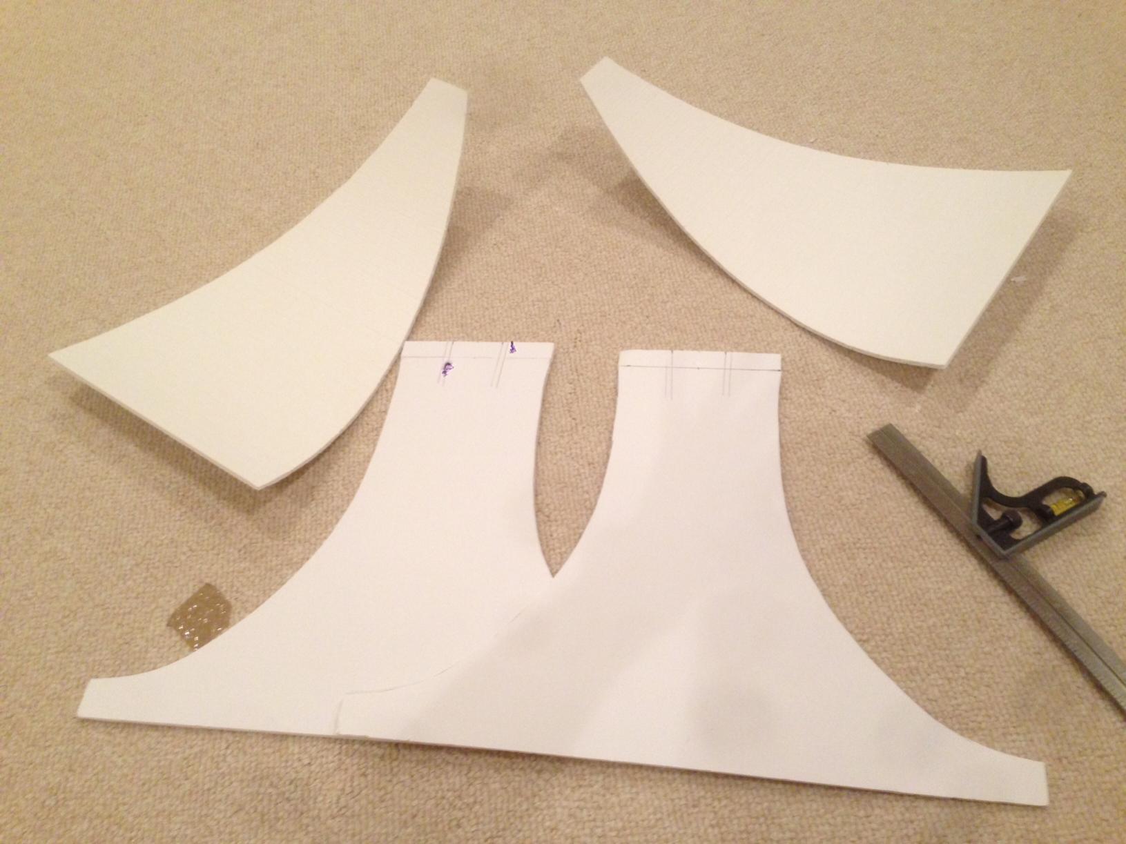

2nd 0.70x Tractrix Build Begins
I have started on the second Trynergy and so far have completed the basic tractrix horn and sealed rear chamber with driver. Still need to apply CLD, add woofers, and make rear chamber for woofers. I am using the higher quality Elmer's foam core board this time. It is a much more durable and stiffer material than the dollar store stuff. More difficult to cut though.
![438910d1410944632-presenting-trynergy-full-range-tractrix-synergy-tractrix-part-2a.jpg](https://www.diyaudio.com/forums/attachments/full-range/438910d1410944632-presenting-trynergy-full-range-tractrix-synergy-tractrix-part-2a.jpg)
![438911d1410944645-presenting-trynergy-full-range-tractrix-synergy-tractrix-part-2.jpg](https://www.diyaudio.com/forums/attachments/full-range/438911d1410944645-presenting-trynergy-full-range-tractrix-synergy-tractrix-part-2.jpg)
![438912d1410944655-presenting-trynergy-full-range-tractrix-synergy-tractrix-part-2b.jpg](https://www.diyaudio.com/forums/attachments/full-range/438912d1410944655-presenting-trynergy-full-range-tractrix-synergy-tractrix-part-2b.jpg)
..........The agreement you have compared to my data is very good.
![checked :checked: :checked:](https://files.diyaudio.com/forums/images/smilies/checked.gif)
Can i mention that the bigger delay at 100Hz probably coursed by the 6mSec. spike from 6,5" because of high Q(tc) box. Legis did mention at the other thread when you added the woofers that you could make them leaking, maybe that trick could bring them down 2-3mSec. area.
Byrtt,
How do you get Qtc of 2 for the woofers? Doesn't added foam damping and stuffing control Qtc? Also, the flex of the foam core enclosure also reduces the Qtc. I don't have a huge peak overshoot like the sim you show. The woofers don't use any EQ just the low pass and high pass.
Byrtt,
Did mention plot picture 4 not the reality what will happen when frontloaded and injected thru smaller openings here i'm blank.
In the plot used PE 6,5" in raw sealed 5,5 liter, neither did add filling or counted for driver displacement parameters. In my simulation program PE 6,5" in a 21 liter box per driver Qtc 1.302 still makes nearly +3dB spike. Grabbed TS parameters PE website, and just rechecked seems okay.
You don't have huge peak that's good, frontloading/injection, foam damping and stuffing, flex foam core that is doing it's job
![smile.gif](https://files.diyaudio.com/forums/images/smilies/smile.gif)
That said picture-4 sim for PE 6,5" and the 100Hz GD agree your GD plot, you did a jig for REW some time ago can it measure where real Qtc have landed.
