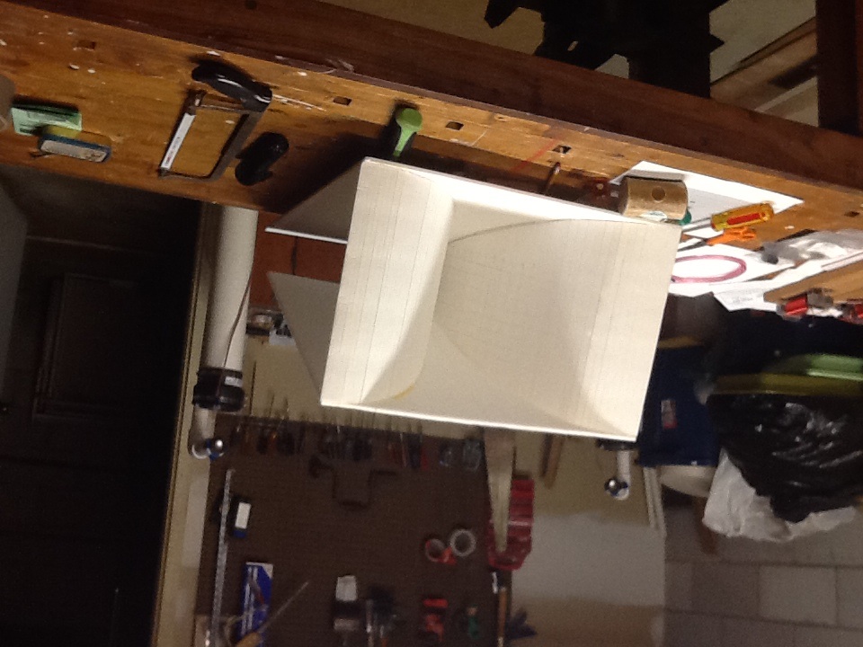

Ok, so here we are:
The one on the left is assembled from the 'front' panels I had left over from my Cornu spiral experiment, hence the holes that need to be filled (although the OSB behind it gives me a good base to glue to). Both have longer top and bottom panels than needed because I haven't cut them down yet.
That's about it!
![IMG_20141118_194918666.jpg](https://lh6.googleusercontent.com/-zwd2TNDPQ6I/VGwF72-0zeI/AAAAAAAAKW8/Bkd9O3o1X2A/w1118-h365-no/IMG_20141118_194918666.jpg)
That's about it!
Thanks for the photo unaHM. Why is one white and the other yellow-brown? Try to add a frame/bracing on the outer perimeter of the horn - really helps to give it a rectangular shape, although I think I am seeing severe pincushion or barrel distortion from your camera lens.
Unfortunately I only had enough left of my original sheet for the first one, which was white, so I had to go and buy another, which is supposed to be clear (with a fancy texture of course!).
Yes, bracing definitely needs to be done...they look a little like JBL 'butt-cheeks' at the moment...but it is a combination of that and the barrel distortion from the lens (it's a panoramic picture, so it's even worse).

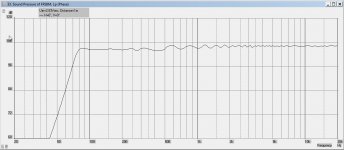

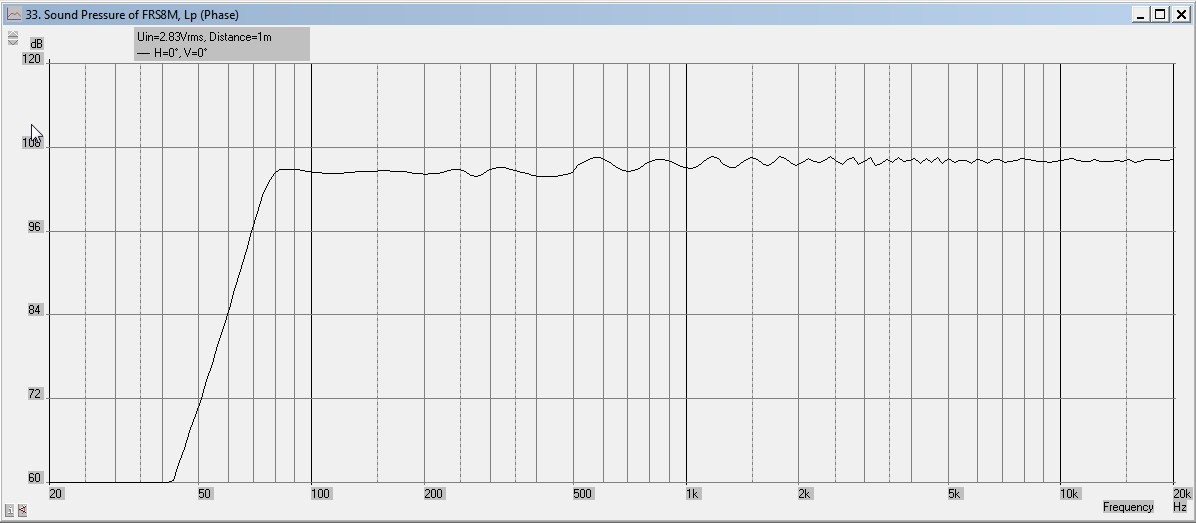

I am some quiet last time, busy with other thing but today i am start again to simulate this horn, with the visaton 8 inch w200s and the fr8m in it.
FRS 8 M - 8 Ohm
W 200 S - 8 Ohm
do quite well but less efficienty but for livingroom use it stil will go loud enough.
Use the script from here, some question do I have, how can I change the horn part the best way can I copy past things from volvotreters tractrix sheet. So I can do some tryouts, pity that hornresp can not do this versions.

Nice sim! You can apply a scaling factor to all dimensions of the horn in akabak and that works quite well. If you want a different profile, you will have to manually pull out values in Volvotrter's spreadsheet and enter by hand. I made the square throat to have corners fit at same equivalent diameter as Sd. So the square throat will be slightly smaller than round Sd. Doesn't seem to hurt bandwidth.
Thanks for comment, I have change the ports chamber and such to get here, also amplifier part is changed because speaker has different efficienty as always the case, You have made that nice piece of akabak work so I can play with it, thanks.
But first I need to let remove a strong 6.8 wifi mast from the roof of the nabure, this do radiate in the measurement equipment big time, I have soon a judge will look at it. als not healthy sleeping in strong field, it is some meters from my bed and I worry.

I extracted profile dimensions every 12 mm for first 30% of horn from throat and every 25mm thereafter.
That is because it is critical part in start? You have also put this that way in akabak? You did use a separate chamber for the bass units, is it not possible to use one chamber for both and two ports bassreflex so I can do
