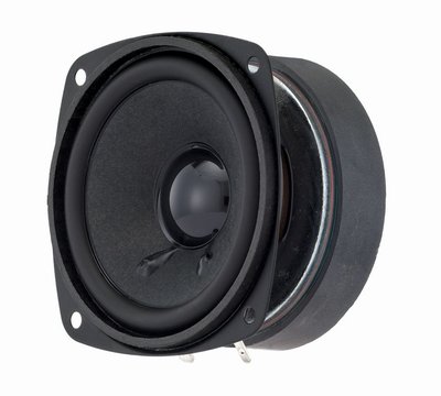

That sounds like a good size. What driver is that?
A visaton frs8m 3.3 inch full range 30 watts..

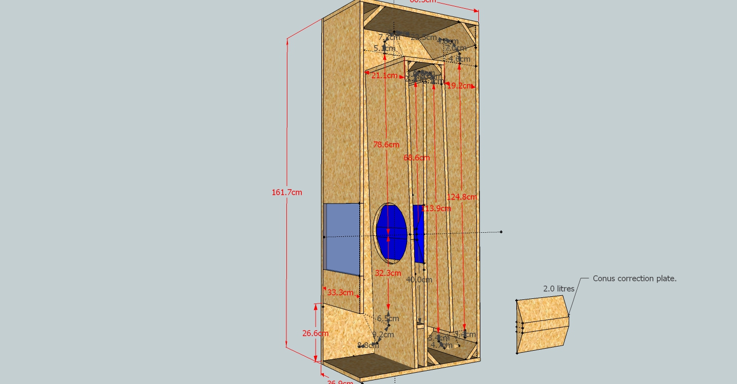

I can work well with 3D cad, like sketchup where I did fold the tapped horns like in early post is mention.

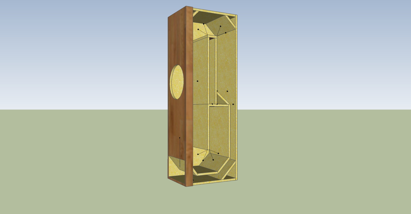

See some drawns I did make, 3D folding is not a problem for me. came from hornresp export and sims.

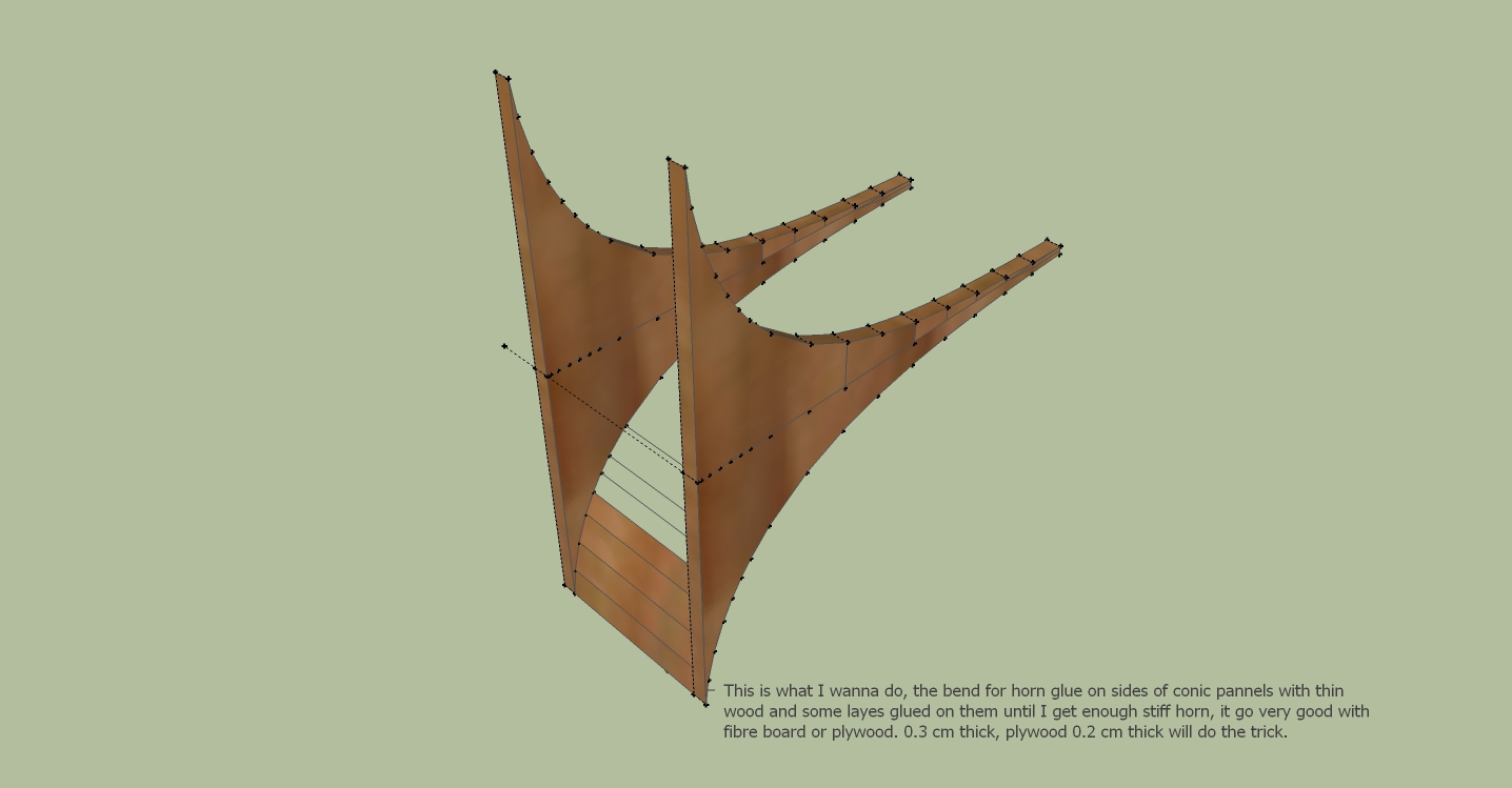

The wauy I go build it is different then yours, I use up and down conic panels with saw out the tractrix and press that in some layers on the sawing out liner of the panel, horn is not with foam but wood.
I do not now if this will work woth your pdf, it looks that it is possible.

This was my idea to do it with all wood.
I go get some this evening and try what happens.
I go to metric so I do calc again the horn with xls program, also I did see
the little smaller part after mouth is not there in your drawn when I did make in sketchup, (terrable program to make horns, makes no solids sometimes..
This drawn is example, I have not did make the wooden plates conic like it shut be but just give a idea what I want do, making a new calc is not a problem, just do the same as you by make bigger spaces when make the tractrix corners.
I hope I did explane oke, because technical english is not me best way to explane it I am dutch you now and never have english school, just learn by typing it on the internet.

I have use 225 Hz as horn cutoff is some lower so oke keeping wideband damped by horn, horn get then 40.8 cm long 34.81 high, and 52.21 wide, looks nice for a livingroom.
mouth earea is 18.3 cm2 0.71 x diagonal of speaker who is 6.1 cm. I make the back chamber of the speaker from plastic pipe, I can make it very small so more easy to get wideband respons, back chamber works like a low pass so make it small enough works best crossover get higher but bass unit go high enough to cope with that I hope, trying is best afcourse...
Because I go from scratch, just for the fun but also because I made a wooden one, I have so far I understand need to change the table of horn, the length and the waveguide have to be the same table count in akabak.
I go use more points to draw the horn because of it is from wood, saw this need more points.
I have use the 225Hz calculation, i go use that table, because there are more points I need change it also in akabak including the waveguides.
