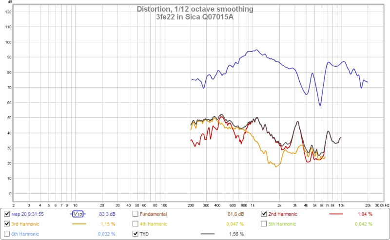

As expected nothing good in 1" Sica Q07015A horn. It is a mockery of 3" driver.

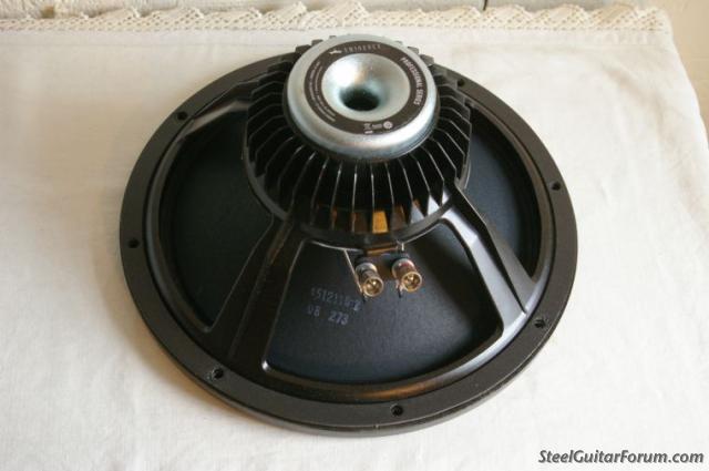

If you want to do it with any sort of predictability, you will need to measure the profile of the horn at least 7 or 10 points along the axial distance (internal width, height and distance from throat flange). Put that in an Akabak model and then play with where the bandpass injection should go. OTOH, the bass injection ports are relatively insensitive to location and can go approximately 75% of the way down the axial distance and should work well. As Kees noted, there is no bass gain so you will have to specify the driver and quantity of driver based on sensitivity and excursion to match the sensitivity of the 3FE22 - which is probably circa 105dB+ at 2.83v and 1m. You will need to fit at least two 99dB 8ohm pro audio woofers on top and bottom to get 105dB sensitivity at 2.83v.
A couple of Eminence Deltalite 12in drivers (100dB) should be able to handle your bass needs from 50Hz to 500Hz. The dia is 12.4in, smaller than the 17.4in width of the main horn so theoretically can all fit in a similar width enclosure. You can make it vented with four bass reflex vents re-entering into the corners near the mouth exit. This will be needed to get the 50Hz bass extension. It doesn't have to re-enter the horn - can just go out straight along front face in corners, just looks cooler the other way. 🙂

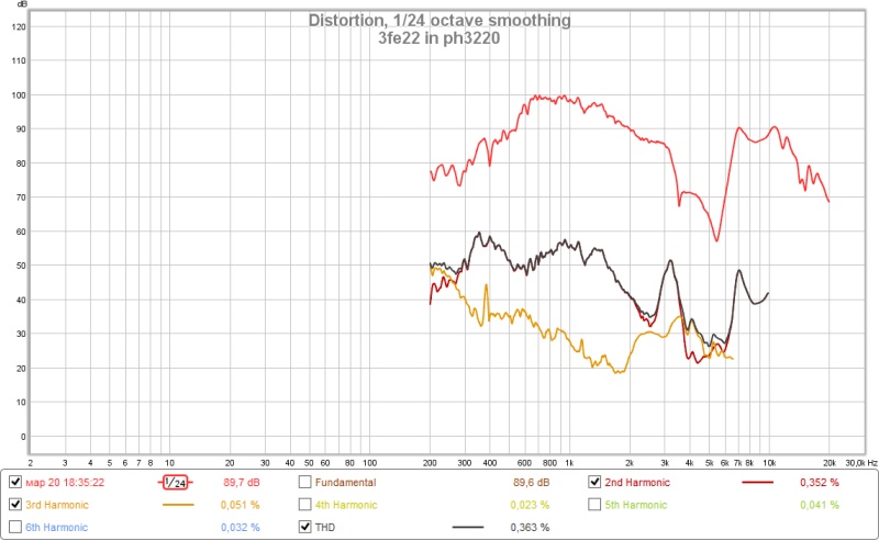

2.83 V at 0.5 m in another horn (only for sensitivity evaluation; even 1.4" throat is unsuitable and your 2*2 seems better than 2" round at 3-6k region).

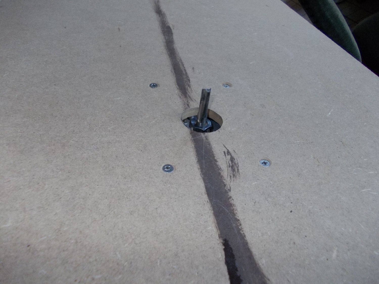

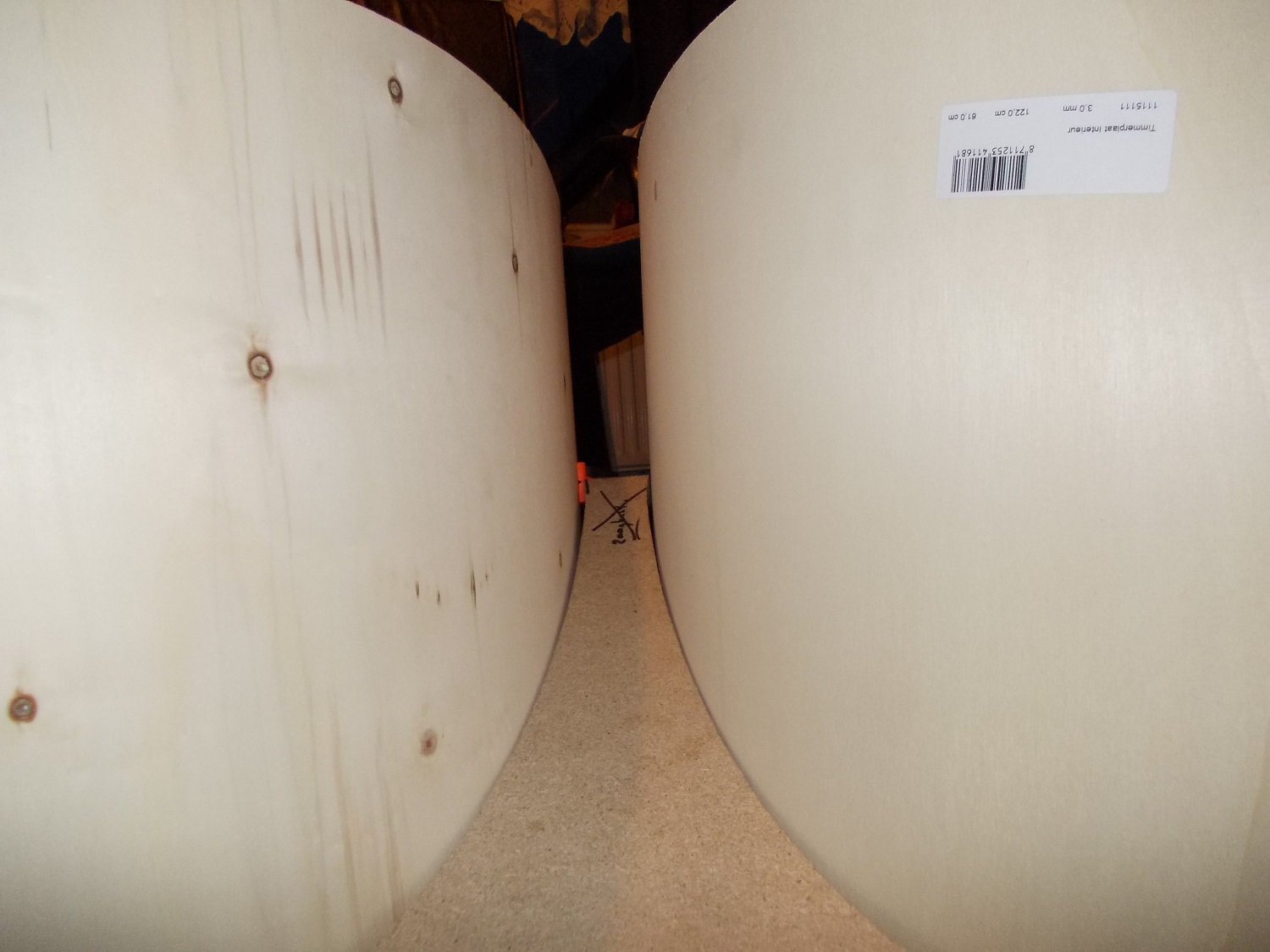

Nice Car!! i go busy with the Rover 2200TC from 1973 soon, but first the equipment for making the horn, I have made a router so I can make the flare more precise and easy, this works perfectly after make a model.

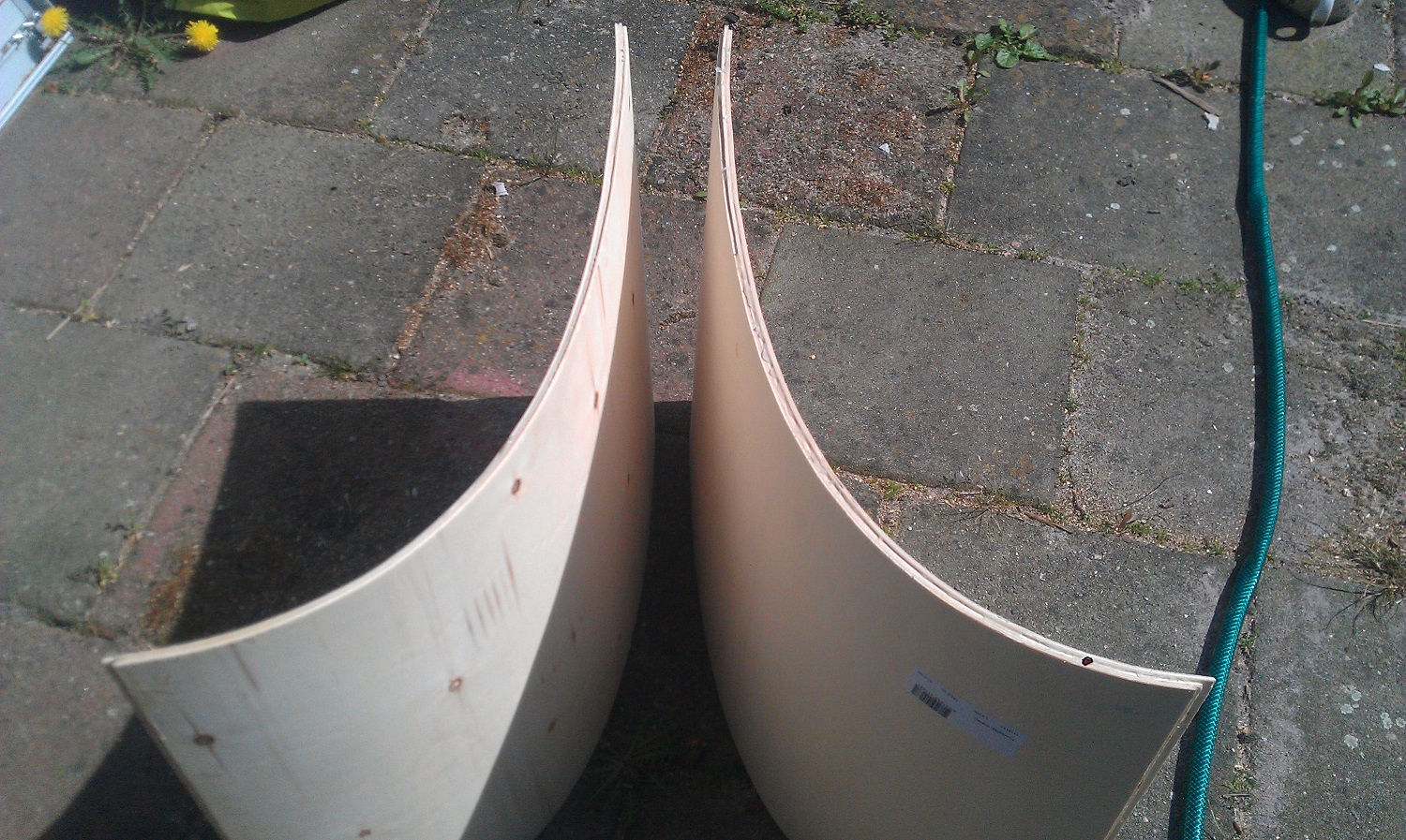

So quit here so I go post some things about how far I am now, I have so much other work in health care I have not much time, but soon I have it again.
I have make a mold for the flare, pressing it in to get a nice shape who is very stiff.
regards

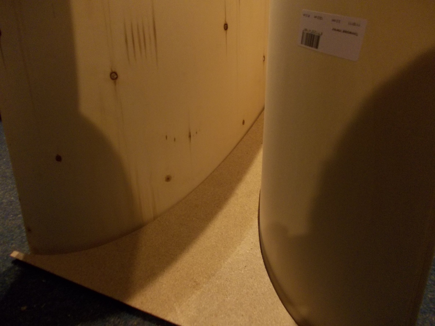

Another thing done, the horn flare is glued so it has a very stiff bent of itselfs.
I am almost ready now to put it together and test it on the hybrid amp in photo three.

Nice work Kees! You will have to explain in detail to us how you accomplished this as I am lost how you did it. You glued two thinner pieces together and while the glue was drying, you clamped and bent it to the proper shape?

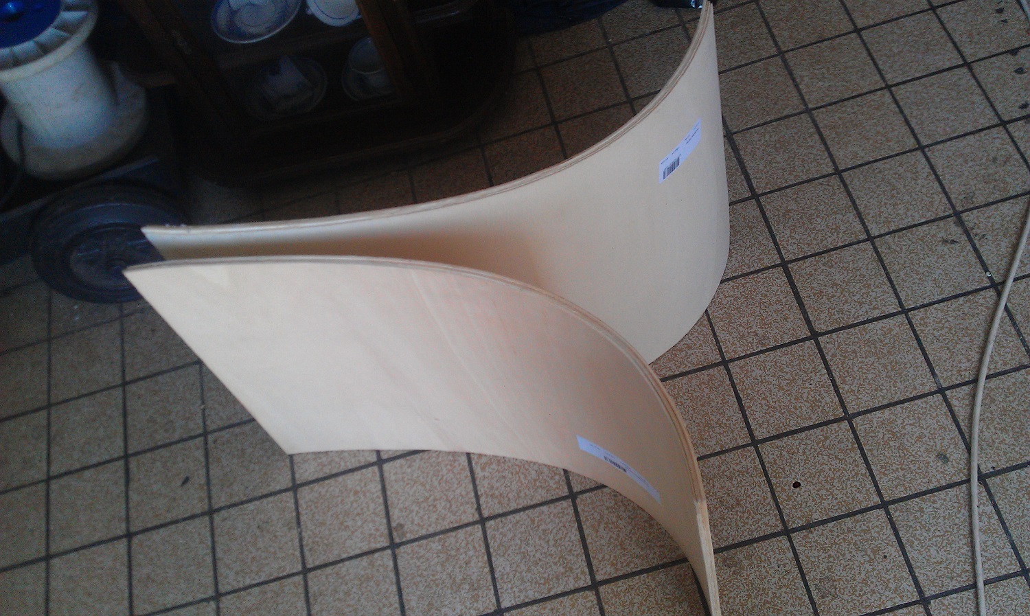

I used the very same technique (minus the cool DIY clamps 😉 ) when I built the curved reflector panel for my Karlson SK8's. I used two sheets of 3/16" oak ply - perhaps not the best choice in retrospective, a softer wood would have been much easier to bend. Once the glue had set, it was extremely rigid. Imageshack has lost the pictures of the gluing process, but here's the assembled result:

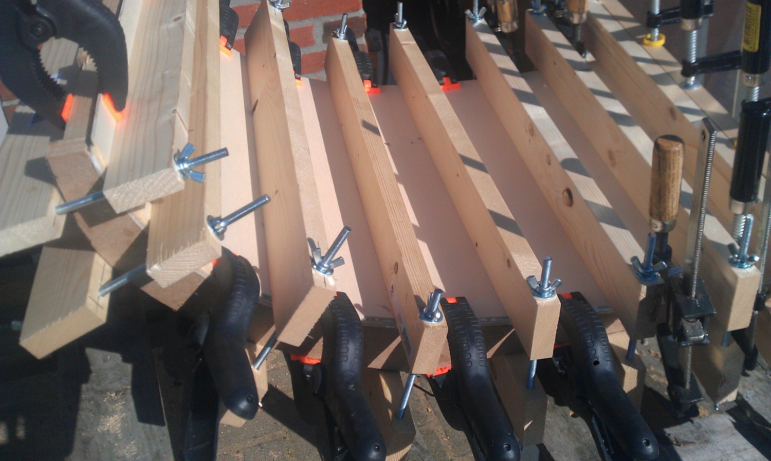

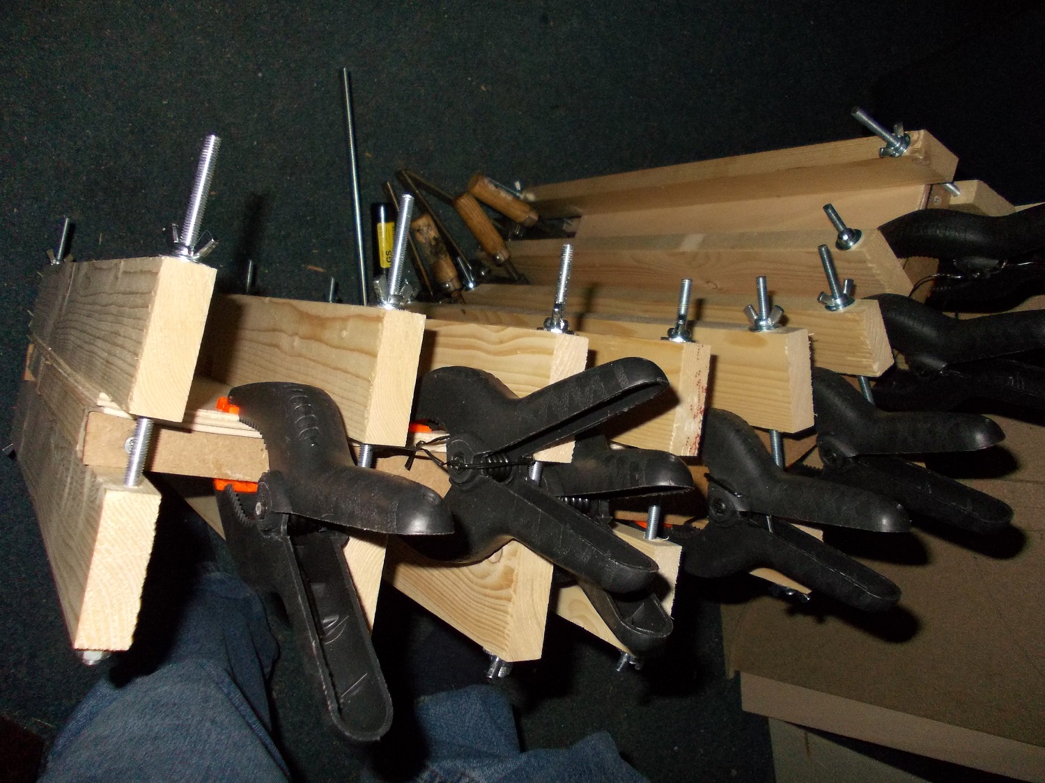

Anyhow, looks very nice. :cheers:
Yes I did make a mold by first drawn the horn in sketchup and print it on multiply pages for the form of the flare, and cnc it with the form as a model cnc see post 508 to make the mold, get three 0.3 mm plywood and put with white woodglu all together and clamp them on the mold with self made clamps. Two 0.3 mm plywood was to thin, three was a better one and really stiff looks good.
Whay concern use them in the rover car, no it is for home and high end audio, as far it will give that high end. I have to see and measure with ears and equipment.
It was not very difficult at all, with the mold I can make horns fast and precise, see the part on the throat the important smaller part is also in it.
PS for the rover, I get work like welding with it, however parts is not so easy to get.
regards
kees

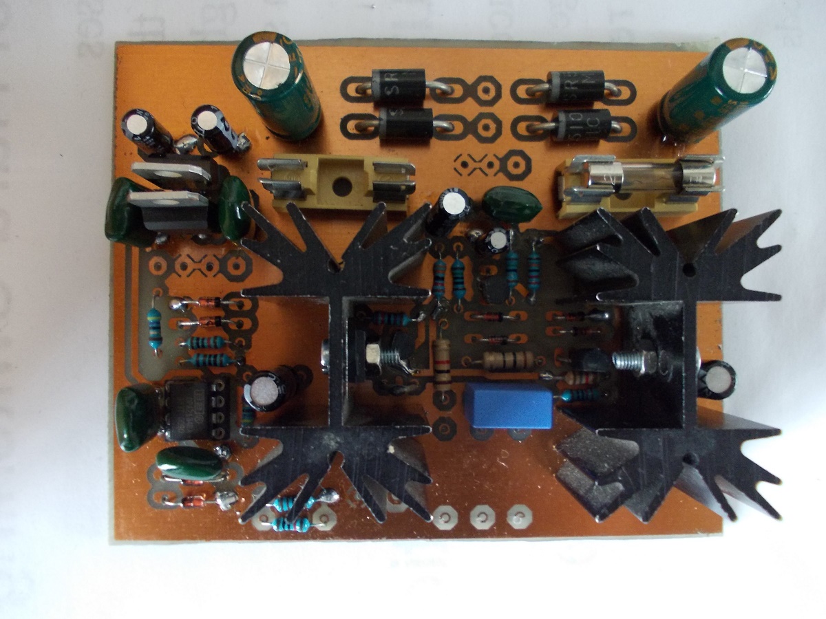

Did start with the speaker measurement jigg who has a class b 6 watt amp on it and works for get thiele small parameters.
So I go work further on it to sdee what happens with this horn.

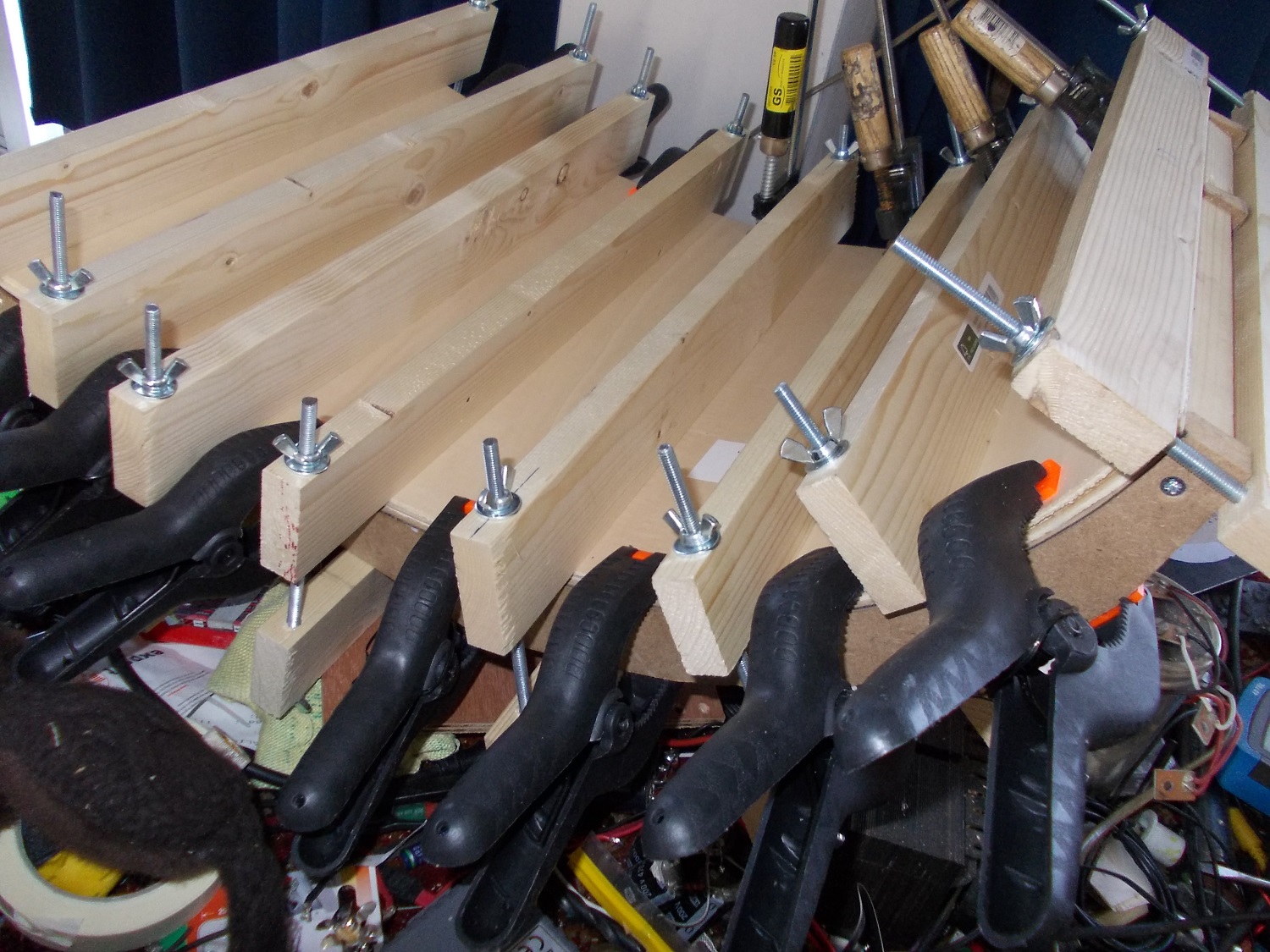

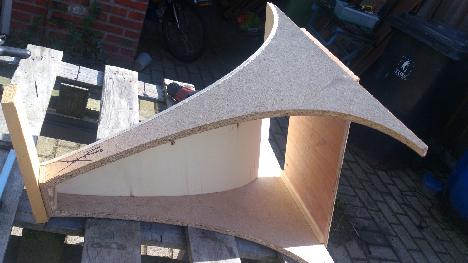

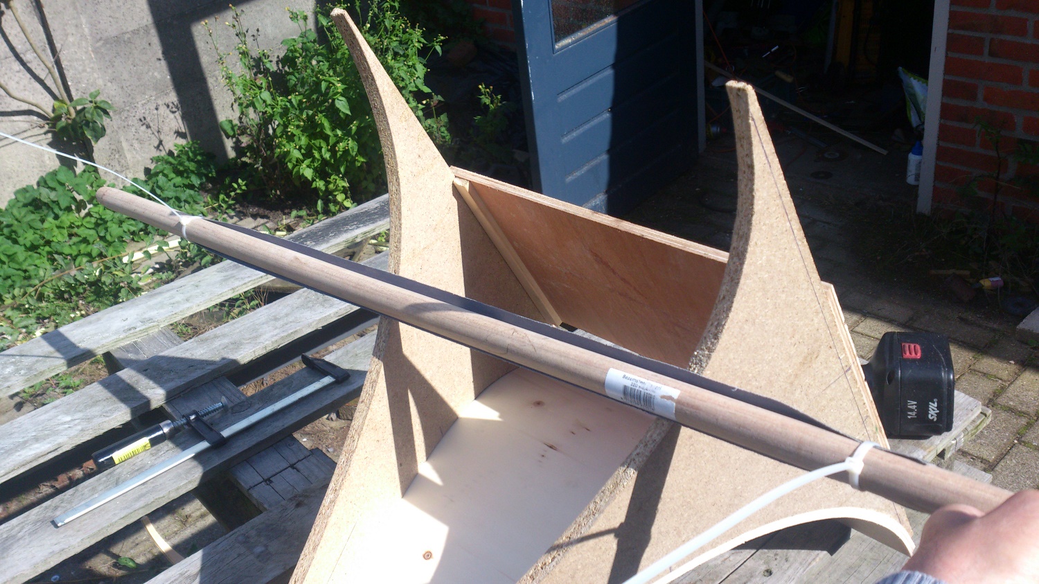

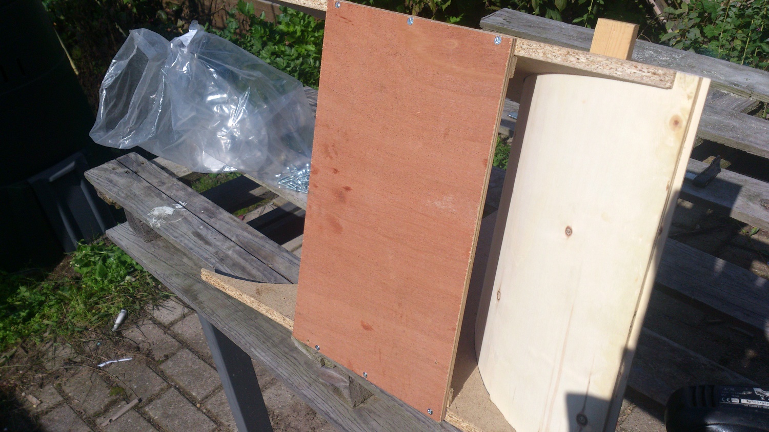

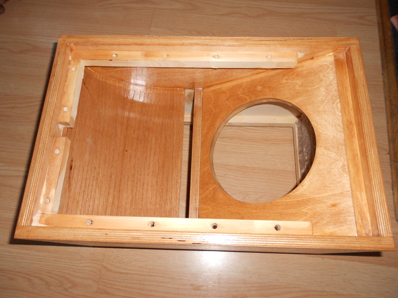

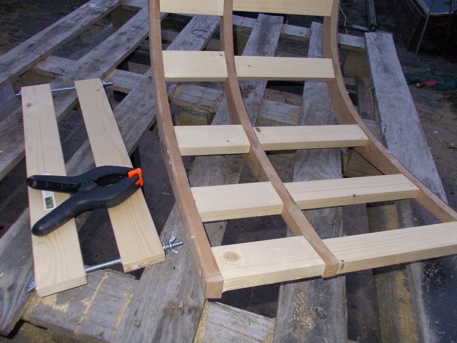

I am started with the horn build, it looks already nice the full wood horn, but it is also some work but fun. the wood file I have make myself to flatten the horn flare connection, this is some heavy work.
regards
