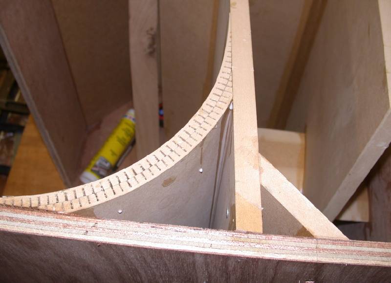

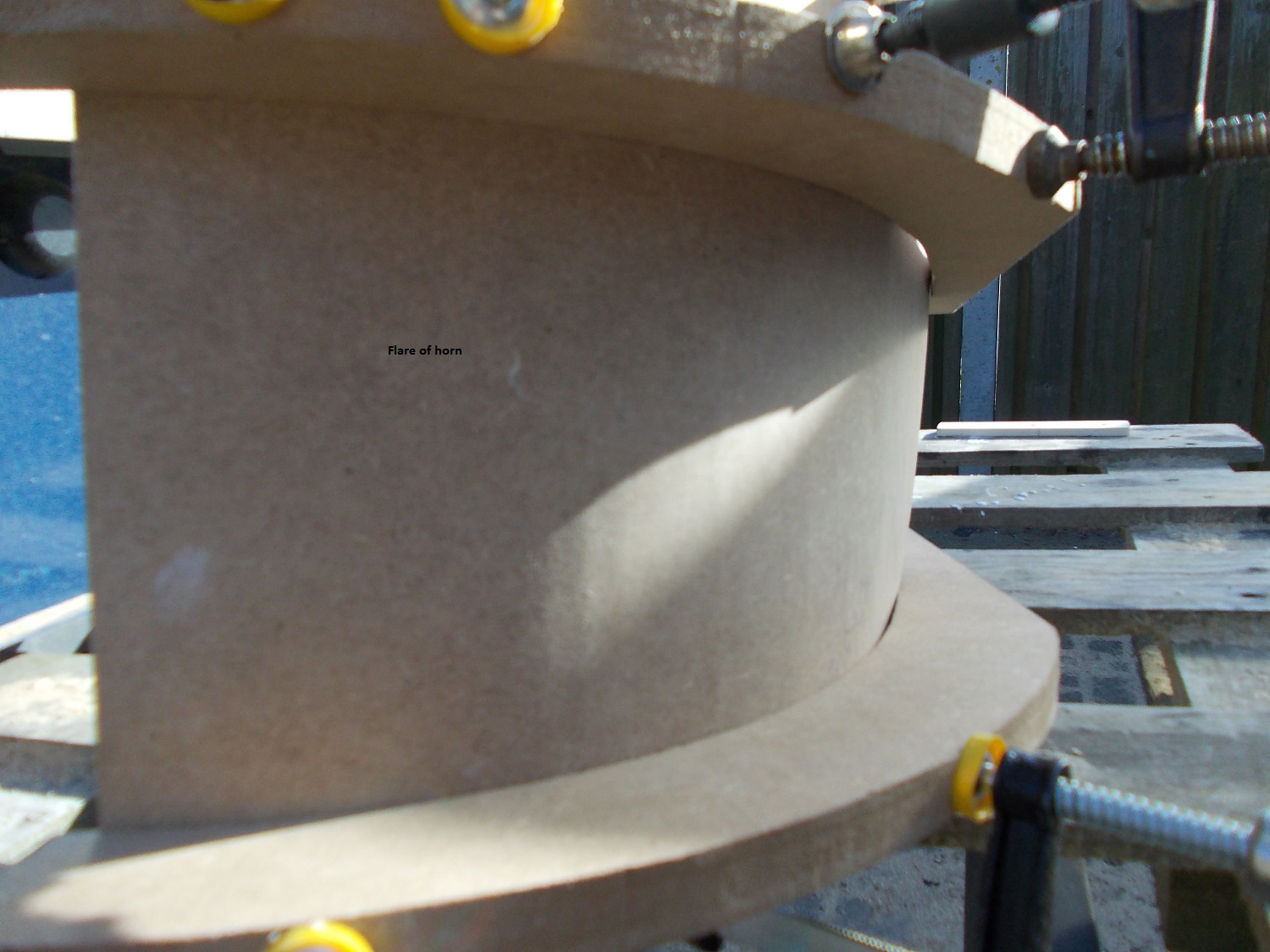

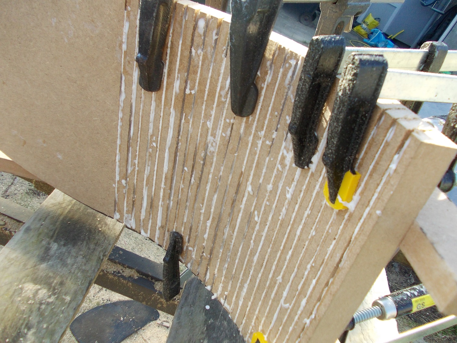

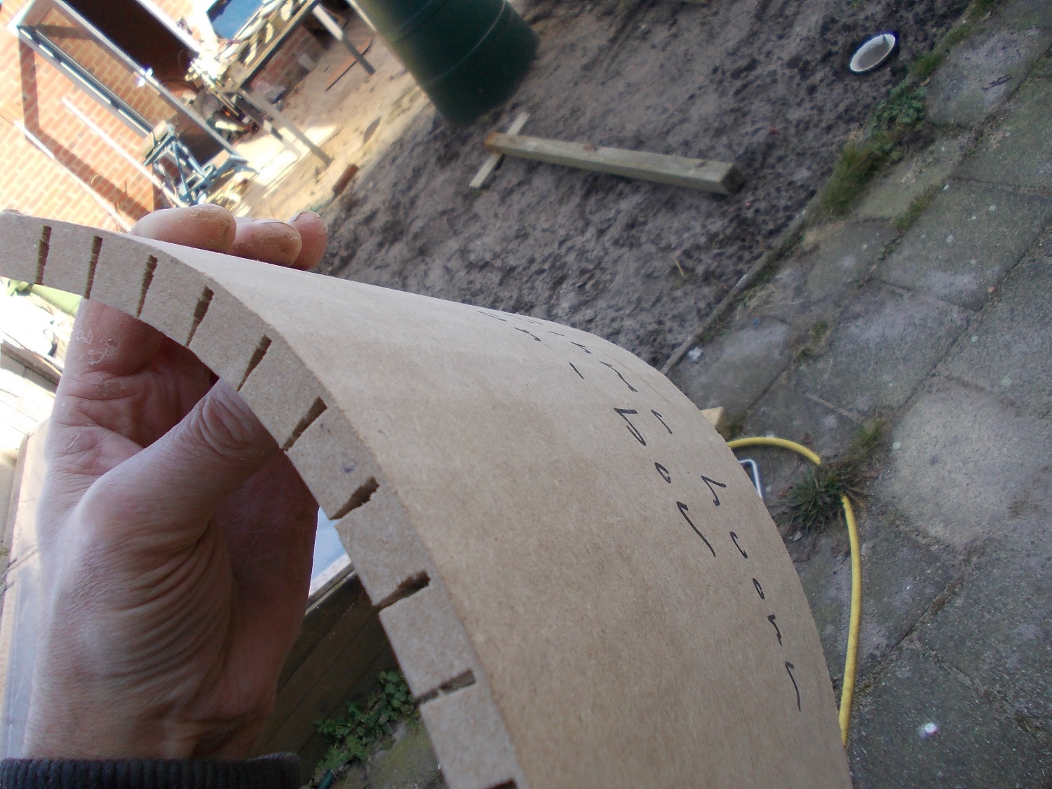

I have found a way to make a heavy flare, just cutted mdf sheet.
I did saw every 1 cm, I can do also 2 cm, for here part of 1 cm and part 2 cm cutting.
glue in it and it is strong, best I can do two sheets 1 cm sawing in and glue on each other.
regards

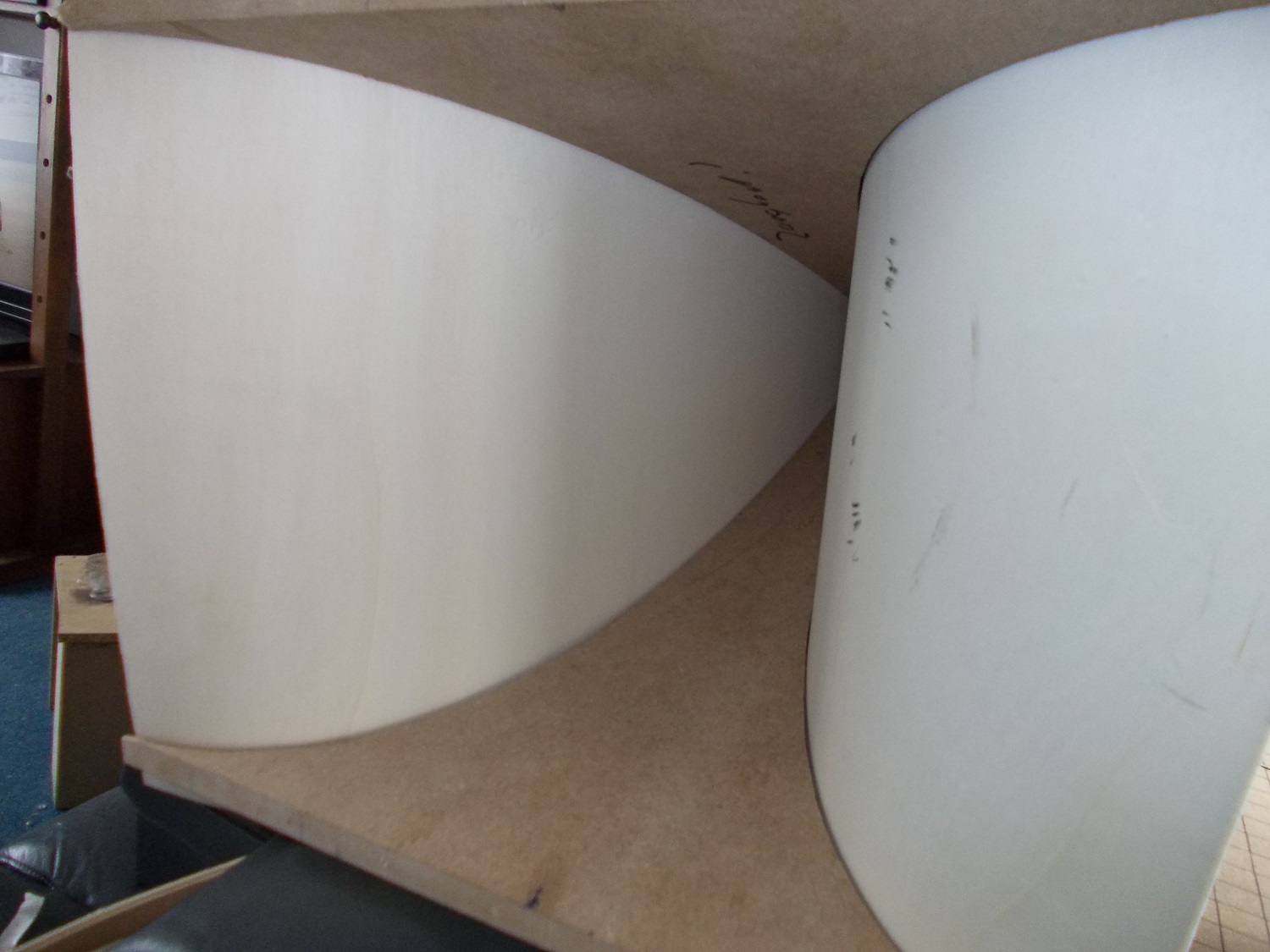

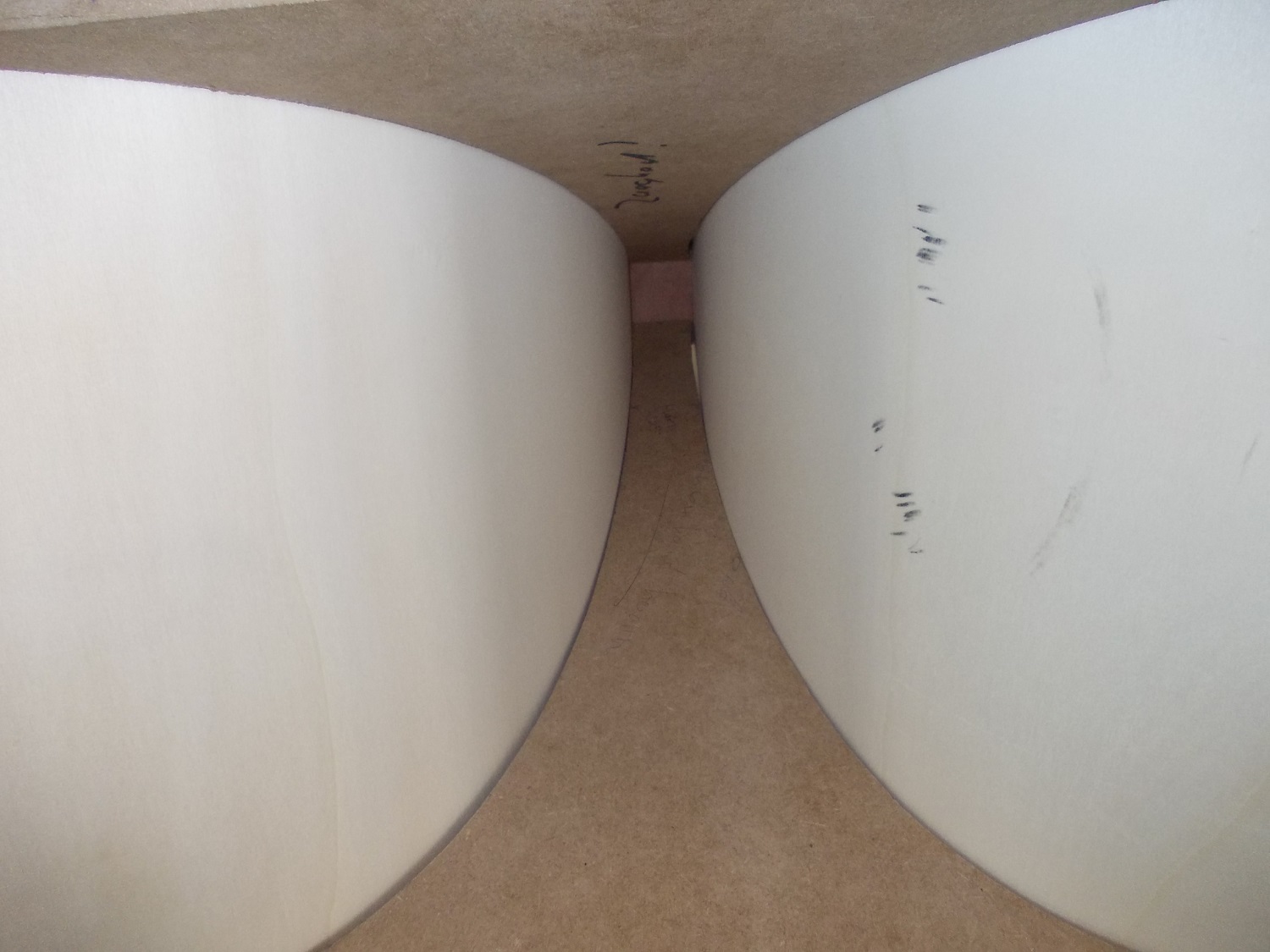

I have done search some wood who can be used for bend the horn flare, I have found 3 mm plywood who bent nicely, use glassfiber glu to make a nice heavy bend. like Rectavit Structan.
It looks very nice, it is not ready glued but just test with some bolds.
regards
regards
Your bendy MDF was looking good, why switch to 3mm plywood now? It looks good though.
MDF get water in after time and break, the box who has the mdf bent was not mine but saw it on the internet.
This version I did post now is 3 mm bendable plywood, I go glu four on each other to make ad thick plywood horn flare, I go use a molt for it.
It looks also very nice, and mdf has less audio properties also.
I have to remake the upper and lower conic parts because I did not use a extra 5 a 10 mm and so corners do break, I make a precision molt and cnc the parts from it with a copy routing bit.
regards

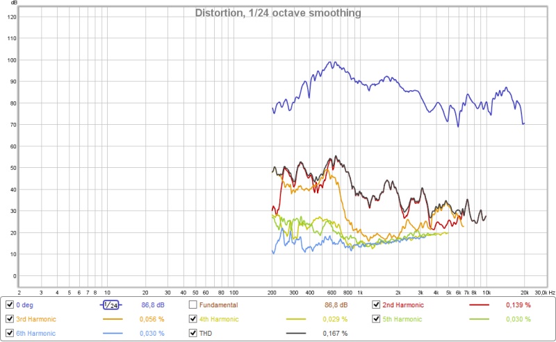

I did try some things in akabak, but why the woofer is so low efficient in this horn? a gain of 3.5 is needed for 96 dB output, when set on gain is 0 I get at best 87 a 91 dB even with a 99.8 dB watt woofer, so I get losses, maybe you now why this is.
Th wideband go 108 dB watt, and so this works fine, I have seen that also the normal synergy is also independent of the woofer efficienty because also these are not hornloaded.
regards
regards
There is no gain on the woofer - the horn is too short to effect gain in the 100Hz range. You would need at least a 1 meter long horn to get any semblance of horn-gain for 100Hz, more like 1.5m for an expanding (flared tractrix) mouth horn. The woofers ports are simply there to make it all a virtual point source for the higher frequencies (circa 400Hz or 500Hz where the XO is). So to get the 96dB, you need lots of woofers in series-parallel. Notice how Danley has typically qnty 4 woofers? Use a pro audio woofer with 8ohm 91dB and in series parallel, you get +6dB at same voltage so 97dB net.

I expect (not swear) to measure ~tomorrow.
2380 throat is questionable and Paudio clone cost of one horn is about two 3fe drivers..
I'm planning to try some ~10" wide 1" throat cheap and not using horns I having, may be with cutting throat.
Directivity control will be lost at higer frequences - let it be)). At xover freq. both LF and HF will be about omni.. With cheap 10-12" woofer..
Well, stop dreaming . I don't know will this work low enough or not..
