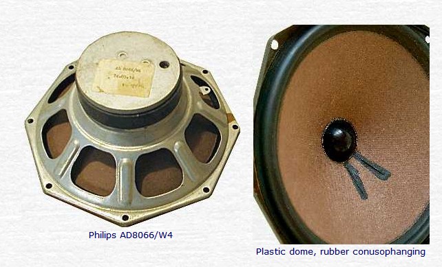

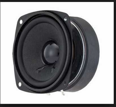

What driver are you using in this script? Is this a 2-way?
I did use your script and old 1976 phillips drivers and a visaton FRS8M.
change some things afcourselike port rear box etc.
I did post it earlyer with Xmax.

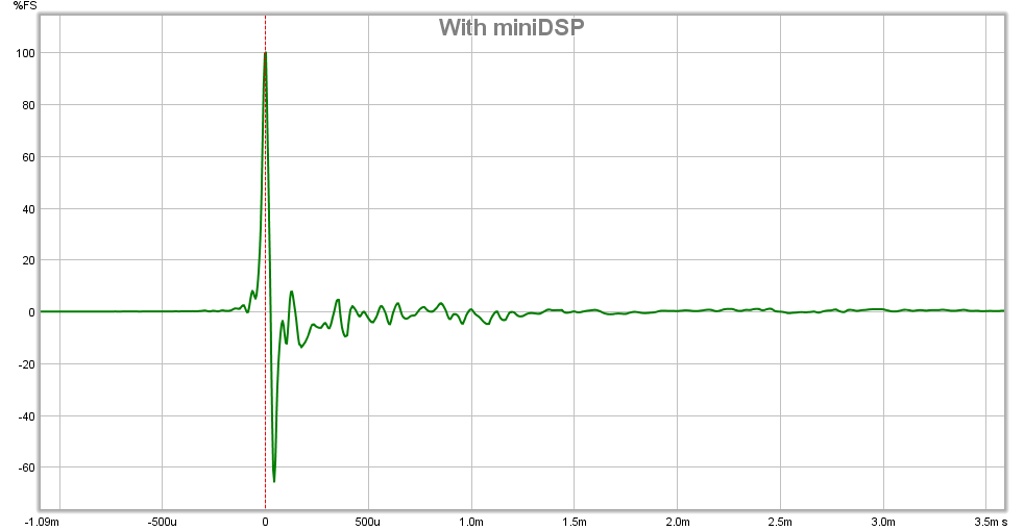

Wesayso,
I think much of the ringing artifacts you see in this example of the Vifa in the tractrix stems from the fact that the Vifa is underdamped (high Qts) and not ideal for horn loading where there is a lot of chamber pressure that feeds back onto the driver as it is moving around. The horn then amplifies these little pressure fluctuations resulting from the acoustic impedance variations onto the driver. If you run the Vifa in the Nautaloss, for example, where the acoustic impedance feedback is very little (open face on front and tapered sealed spiral TL in back), the Vifa can do a much better job with the impulse response. A lot of it can also be attributed to the digital domain processing that imparts the extra overshoot. See for example this IR result for the Vifa in the Nautaloss without miniDSP (just going straight through to a class D amp) and with a miniDSP in between but set to be "neutral" no gain or EQ applied but only with a 50Hz HPF.
No mini-DSP:
With mini-DSP (and 50Hz HPF):
You can see that the Vifa actually does a respectable job, and certainly without DSP in between, you will get a technically cleaner IR. However, to my ears, I cannot detect the presence of the overshoot imparted by the DSP. Maybe more trained or sensitive ears can? I think the overshoot is the artifact of a HPF function in the DSP. However, the DSP improves the phase linearity over analog! That should be perceptible as enhanced spatial imaging.
In any case, look at the Vifa in the Nautaloss and compare that to the much more expensive Dunlavy - not sure I could hear the difference in a cymbal or high-hat strike with those two IR curves.
More details on my study of the impact of miniDSP on sonic performance can be found in the Nautaloss thread here:
http://www.diyaudio.com/forums/full-range/247598-nautaloss-ref-monitor-26.html#post3808837
Edit: Just saw your post above - looks very similar now to the miniDSP and TC9FD!
No mini-DSP:
![398257d1391713081-nautaloss-ref-monitor-no-dsp-ir-nautaloss-i.jpg](https://www.diyaudio.com/forums/attachments/full-range/398257d1391713081-nautaloss-ref-monitor-no-dsp-ir-nautaloss-i.jpg)
![398258d1391713081-nautaloss-ref-monitor-minidsp-ir-nautaloss-i.jpg](https://www.diyaudio.com/forums/attachments/full-range/398258d1391713081-nautaloss-ref-monitor-minidsp-ir-nautaloss-i.jpg)

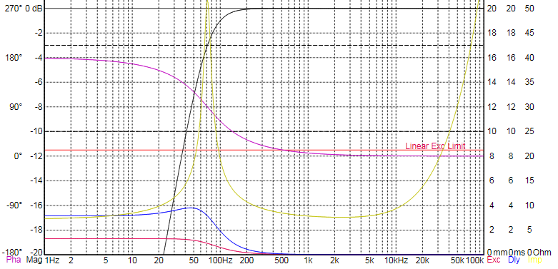

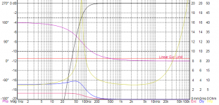

Am i wrong about Danley Synergy have phase turn magic as in first plot.
Here example sealed box BW/Qtc0,707/Fsc71,48, and this represents single pointing full range driver, lets pretend it's real world linear from box HP and up.
180º phase turn (Purple) from DC-HF because of box HP filter and this makes the un-linear error in LF group delay (blue). Could i believe listening headphones have same minimum phase turn as seen here and is possibility some sound very good just without live room modes added but a form of CD.
I percieved Danley's Synergy have nearly same plot (magic) as above acting as a single pointing driver even it's 3 way passive and at same have acoustic CD feature.
Now fullrange synergy, here last plot:
HP filter 6,5" and XO to Vifa gives 720º phase turn in relative narrow band and doesn't this give too crude group delay and spoils device to be perceived as real single pointing driver though the CD feature is in place. Don't know if clever passive SERIEL XO or DSP linear XO can be used here.
![SealedBW.PNG SealedBW.PNG](https://www.diyaudio.com/community/data/attachments/400/400358-484a16a3dd5ea35921d4f065c9581ca0.jpg)
![0.7x.png 0.7x.png](https://www.diyaudio.com/community/data/attachments/400/400374-9937084f9b291c01da732db79e204b59.jpg)

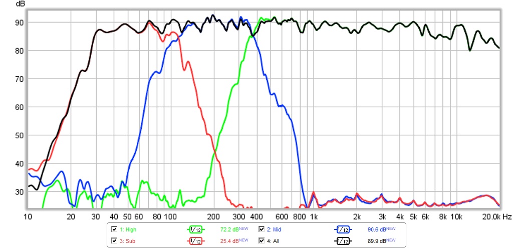

3-way Synergy with sub
I got the 4 way XO plugin for miniDSP and tested it out to add a subwoofer. Kind of cool what you can so with a miniDSP board and two class D amps. Lets you make a 4 way active speaker. You can see that I need to work on time alignment at mid to high XO. I am using 48dB slope here.

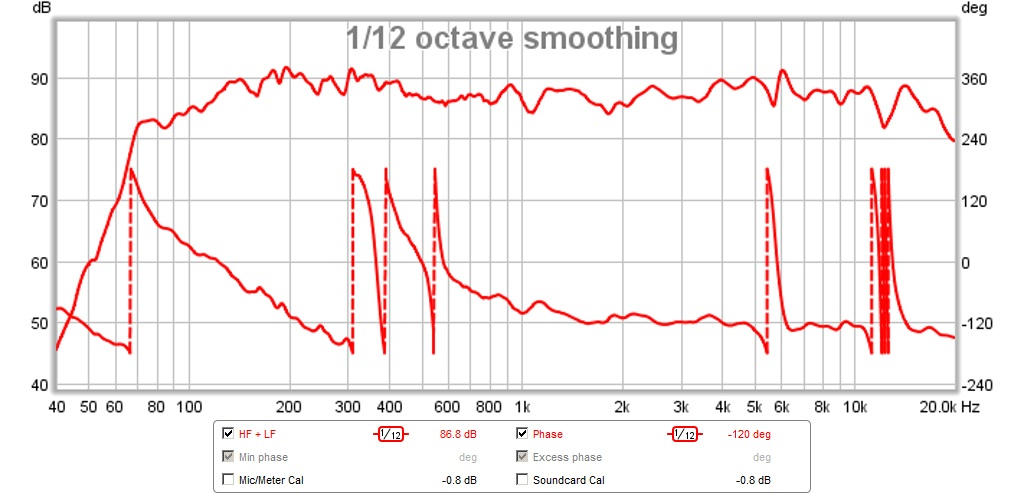

To measure phase in room, you should adjust the time window very short (ideally so short that it filters out the floor bounce, which is usually he first early reflection) or measure right at the mouth, otherwise reflections are gonna affect the measurement.
X, did you try the time widowing in REW before when we spoke of it?
Cone resonances can cause those "wraps"/phase distortion, for example dust cap can (and usually will) resonate/radiate "as separate radiator" and the acoustic crossover between the cone and dust cap distorts the phase. This is usually more severe with whizzer designs. It does not really matter whether the xo is electrical, acoustical or mechanical.

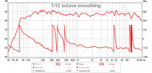

A good example of that phase behavior is the measurements from Halair. If I window to 4 ms to leave out most reflections the phase plot (unwrapped) looks like this:
Above 12K is probably the dust cap doing it's thing? But the array seems to measure as one speaker as far as phase goes. about the same as a full range speaker with a 180 degree turn from low to high. This is a no EQ measurement. Hope Halair doesn't mind me posting this
![phase.jpg](https://www.rsr-concepts.com/diyma/phase.jpg)
Legis,
Can you walk me thru the menu and selections to do this? There are a lot of time window options - not sure if I looking at right menu or pop up.
Above 12K is probably the dust cap doing it's thing? But the array seems to measure as one speaker as far as phase goes. about the same as a full range speaker with a 180 degree turn from low to high. This is a no EQ measurement. Hope Halair doesn't mind me posting this.
Is that "real phase" or minimum phase and how was that measured? From listening position the phase usually goes totally haywire.
Could you post a picture with phase, (generated) minimum phase and excess phase plotted?
