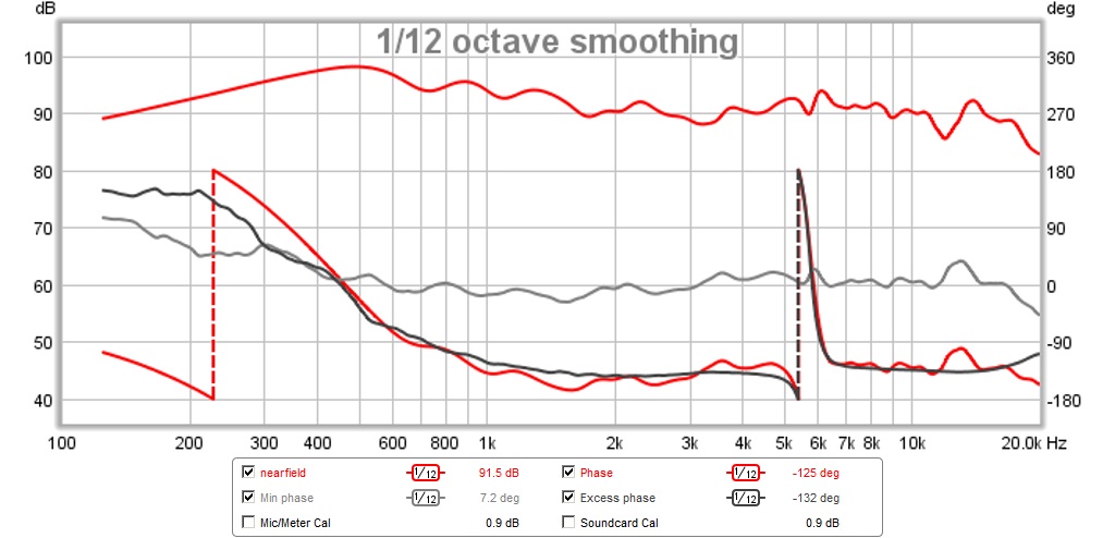

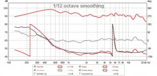

Gated Min Phase nearfield
This was measured at 4ms gate and 12cm away with Vifa and 6.5in woofer. I think it looks good except for phase wrap at 5.6khz.
I still have not done a careful time alignment. Just set delay to equal distance from Vifa throat to injection ports plus 2 inches.

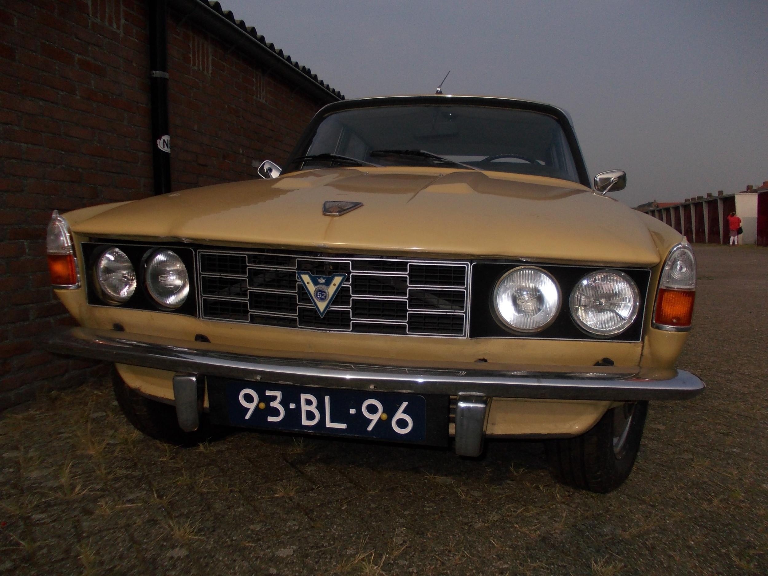

Classic car?
Yes a rover P6 needs welding.

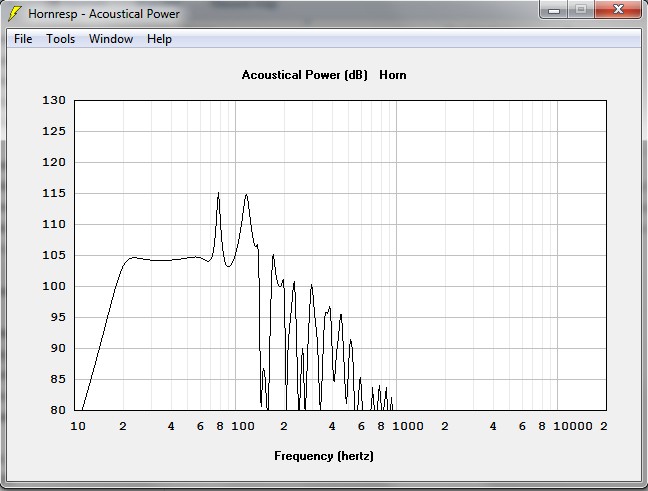

I have resim my tapped horn, when in a corner it go easely above 100dB 105 in this case, minus 3 dB is 102 dB real because of 4 ohms woofer.
One tapped horn do fine with two synergy tractrix of conic.

Nice looking British car! I used to have an mgbgt as my first car - beautiful design but sure was a good car to teach you how to repair cars!

When I was a kid my dad drove a couple of Rovers of that vintage - lovely car at the time. He said they had in-board disc brakes and any oil leakage under the car mean poor stopping distances - a terrible design feature!

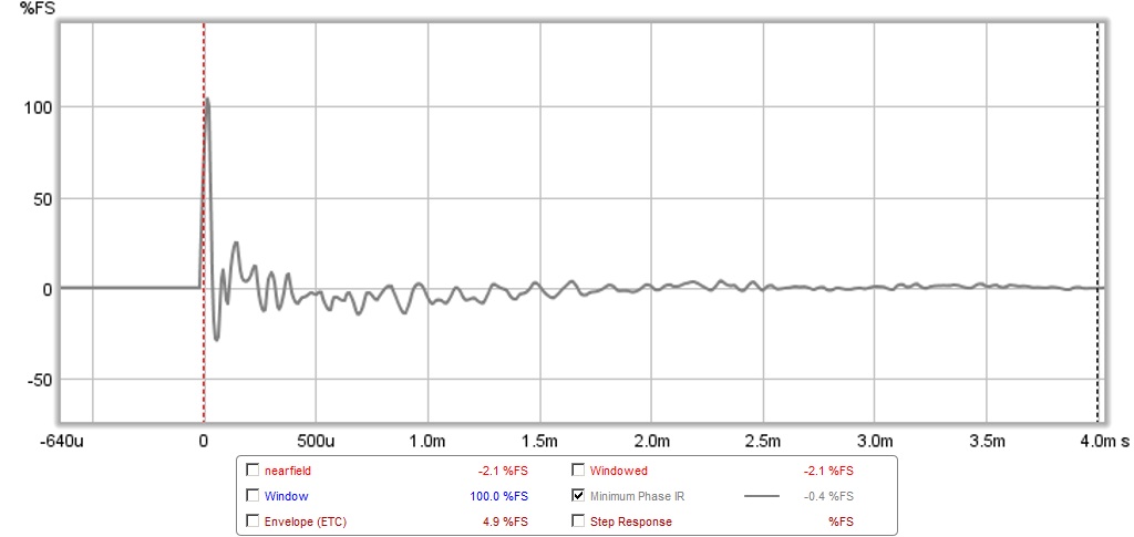

Not bad! And step?Here is the minimum phase impulse response.
Not bad! And step?
You mean step response? How do you measure that in REW? I am wondering what to use to measure square waves ? Just use Audacity?
Not that Vifa didn't do well .....The 3FE22 (Nd) and 3FE25 (Ferrite) should be coming today.
![checked :checked: :checked:](https://files.diyaudio.com/forums/images/smilies/checked.gif)
Wonder TrueRTA will do has four licence levels starting with the free one. Link www.trueaudio.com.You mean step response? How do you measure that in REW? I am wondering what to use to measure square waves ? Just use Audacity?
Export the impulse and one of us can produce the step in arta
