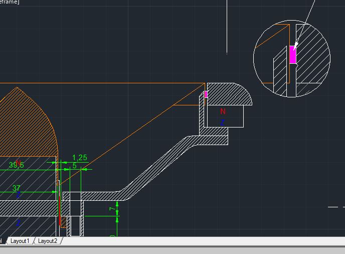

An idea just popped in => ferro fluid for the surround.
It is complicated and not cheap but i think it has some great advantages.
A little extra mass and good damping characteristics (you can choose in different viscosity samples) + totally air blocked.
No surround resonances in the well known important freq. range.

Jef it could work but even if you say no extra mass you do add a shorted ring there in the upper rim? depending on diameter that could be alot more than surround material. Also you need steel and magnet structure with high diameters which are very costly as you know.
In the mean time i changed it to little extra mass ;-) You are right on this.
For production too expensive, for one of a kind do-able i think

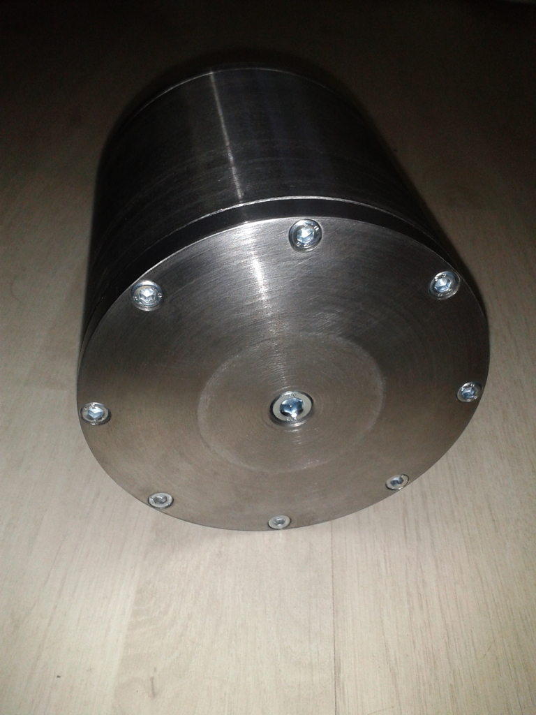

Is that my new motor? It looks awesome, what is the final weight? I am a bit concerned don't think the basket I am using now is strong enough to hold it. Well time will tell. You mentioned that the surrounding will absorb some of the energy from the cone.....I never thought of that, you may have a good point there.

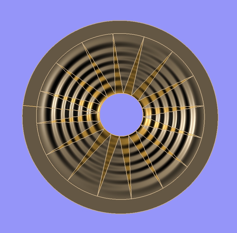

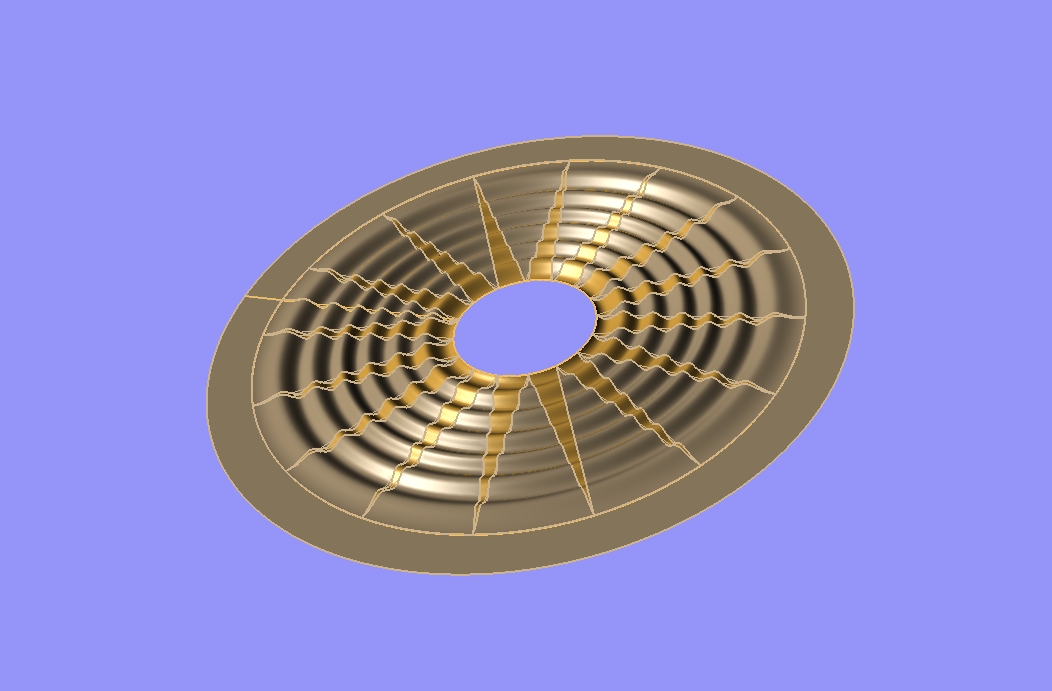

I have a idea for a spider with a suspension that varies with frequency, I will make a drawing and get back.

Radial centering is possible with ferrofluid. between the inner voicecoil and the polepiece. That is the main reason why the motor has two airgaps to hold the whole cone with ferrofluid stable as there is no surround. After simulating this structure i found out that the double airgap brings a lot more flux density to the bottom airgap. (two magnets opposite to eachother, they wil attract eachother because of the iron between them) Axial centering is also possible due the use of a second underlying coil. => the main advantage is that you can soften or harden the suspension like disired. But the main advantage is that the suspension has the same force reduction as X increases like the voicecoil (see curve i posted). So X-I curve is full lineair. i think is almost impossible with a normal spider. The first type is already made and working but the parameters were the worst ever (nothing was calculated) now with the new motor system everything looks good on paper. Within a few weeks it must be ready to test.
It is possible to drive the suspensioncoil with a current driven source this eleminates the fluctuating inductance till 20Khz
It is also possible to drive the suspension with a voltage driven source the inductance wil fluctuate in the same way as the voicecoil so this effect on both the suspension and voicecoil will compansate eachother.
So X is more lineair but Q will fluctuate in this case. With a total BL of 20NA I think this is less or even not noticable.

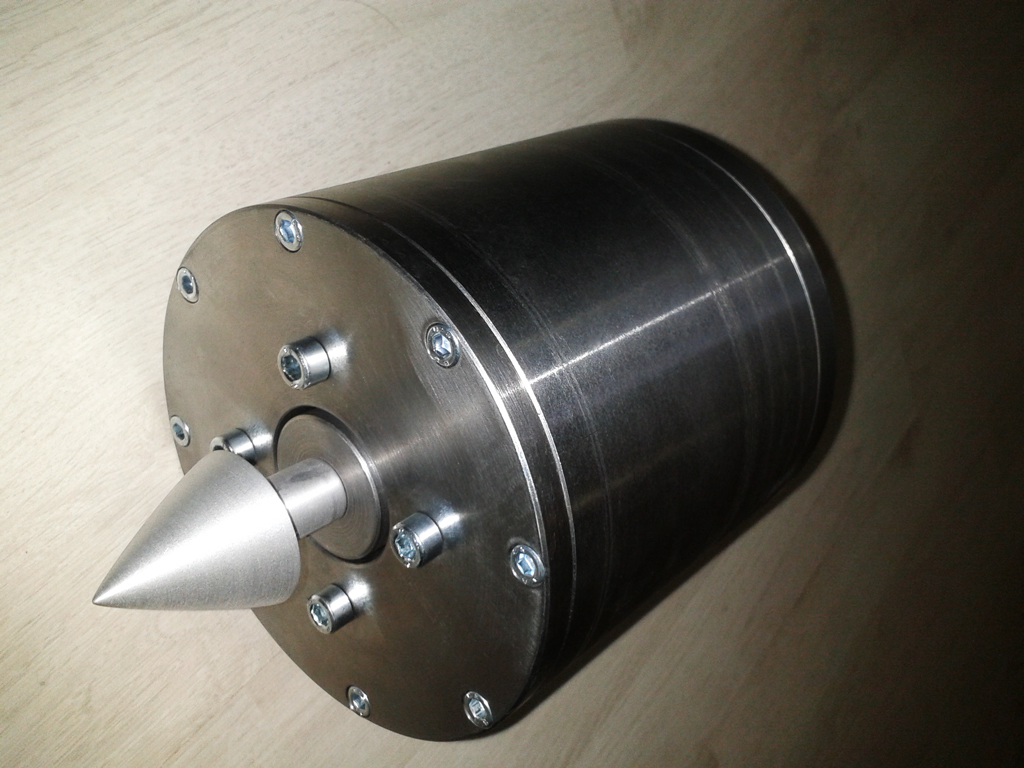

a couple more pics of the 124mm diameter motor
Very nice machinery man. What type of steel you using?
Haven't weighted them yet but i would expect around 15kg. It will definately not hold with just the holes in the frame. You need to make a holder for the motor inside the speaker so that the motor rests on something solid.

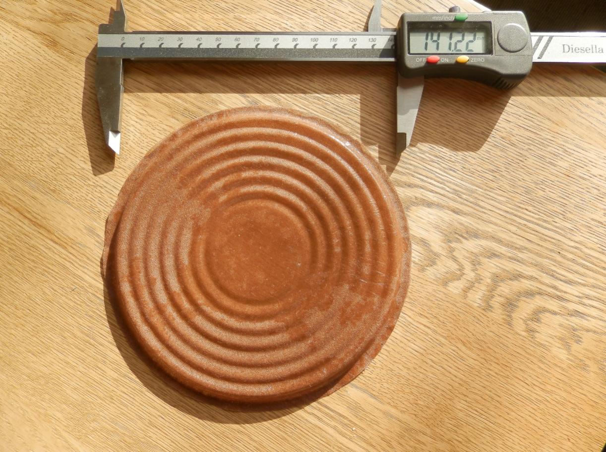

Hi piotr z
I did try making a cone from paper pulp but it did not work out for me, it wasn't as easy as I thought. Making a composite with fibre glass is definitely a possibility, but it will ad to the mass.
But in the end it is all about finding the sweet point between weight, stiffness and damping of the cone.

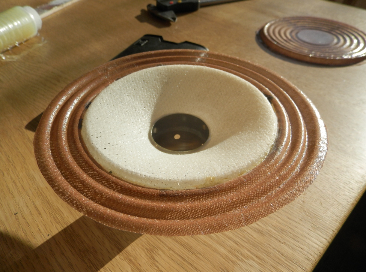

I did managed to make a spider and a cloth surrounding, still waiting for the epoxy to cure fully.

wow surround looks awesome. Good work!
