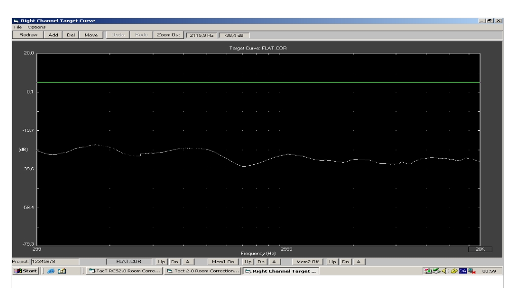

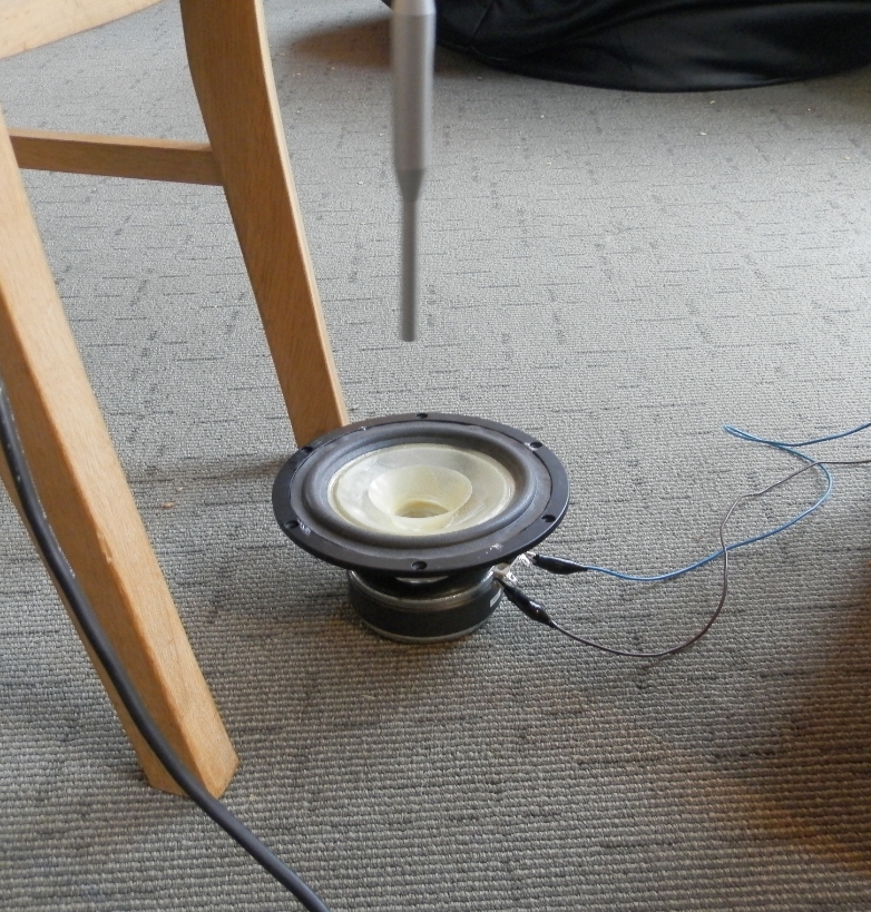

Here is a update on the full range project. I would like to back up my impression on the unit so I decided to use my Room correction unit, to make some measurements.... And it confirmed what I was hearing.......But I still have some doubt can this relay be true? it's almost to perfect, sense the unit is not in a box I cut it at 300Hz.
Here is a pic one how I measured it and the result.
Take care

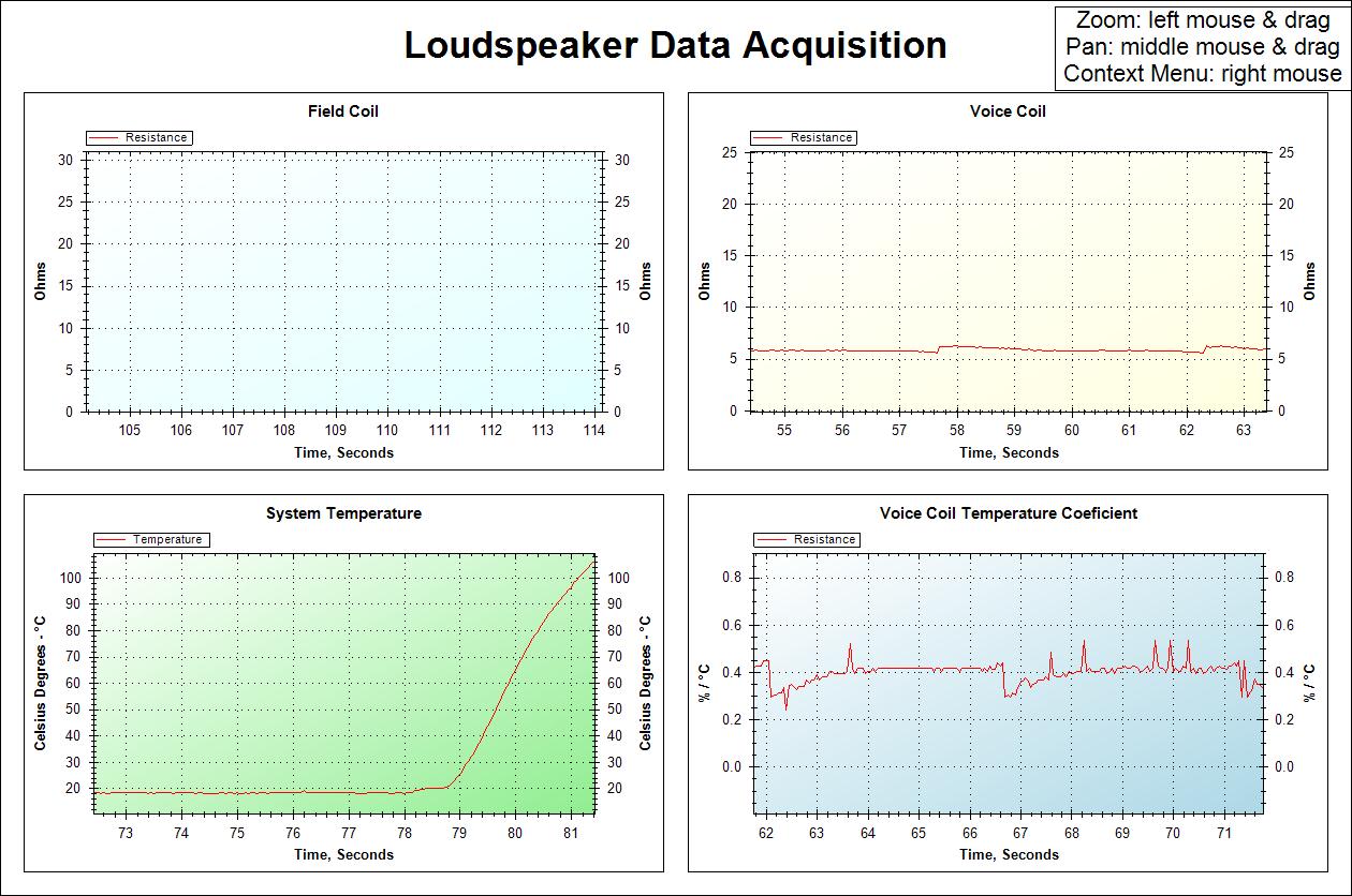

Hello audiofilofine,

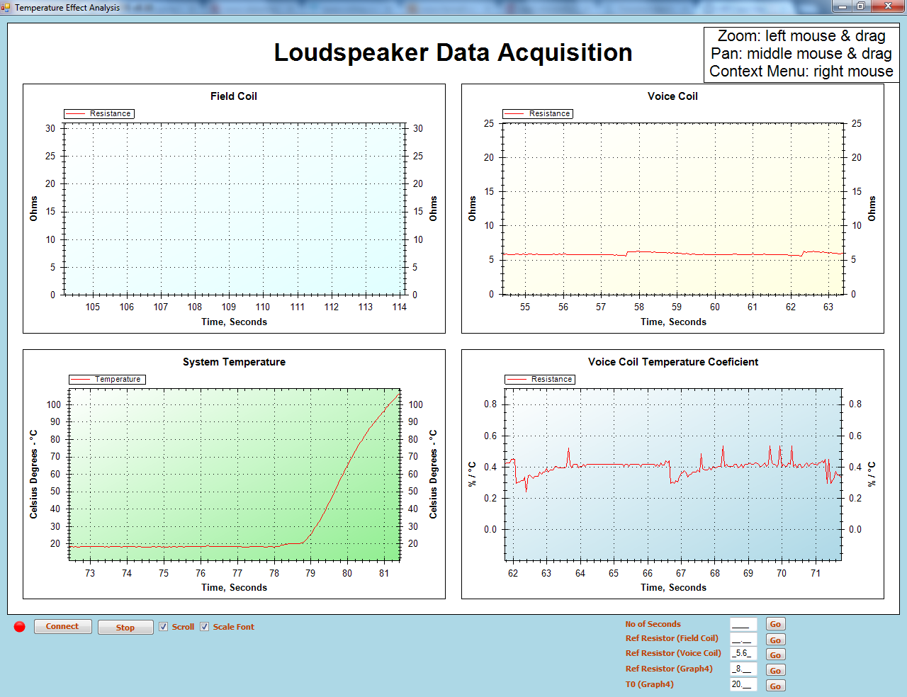

Temperature of the whole system depends on a few factors. Fieldcoil power disipation being perhaps the most important one. The amount of steel and geometry plays a role also.
The drop in current with increased field coil resistance due to rising temp i found to be around 0.1-0.3A depending on the driving current with the same number of turns on each layer.
About formulas, there is no general formula for what you are asking. Giving inside and outside dimensions all you need to calculate is a coil that will a specific DC resistance in order to meet your power requirements.
In my design proccess i started from the voice coil actually, chose diameter, underhung topology, voice coil height, plate thickness and then moving down to fieldcoil. Core diameter is in close relationship to voicecoil diameter about 150-200% so that you dont saturate plates too soon.
So designing the field coil i did knowing what i want to get in the gap and the structure around the gap.

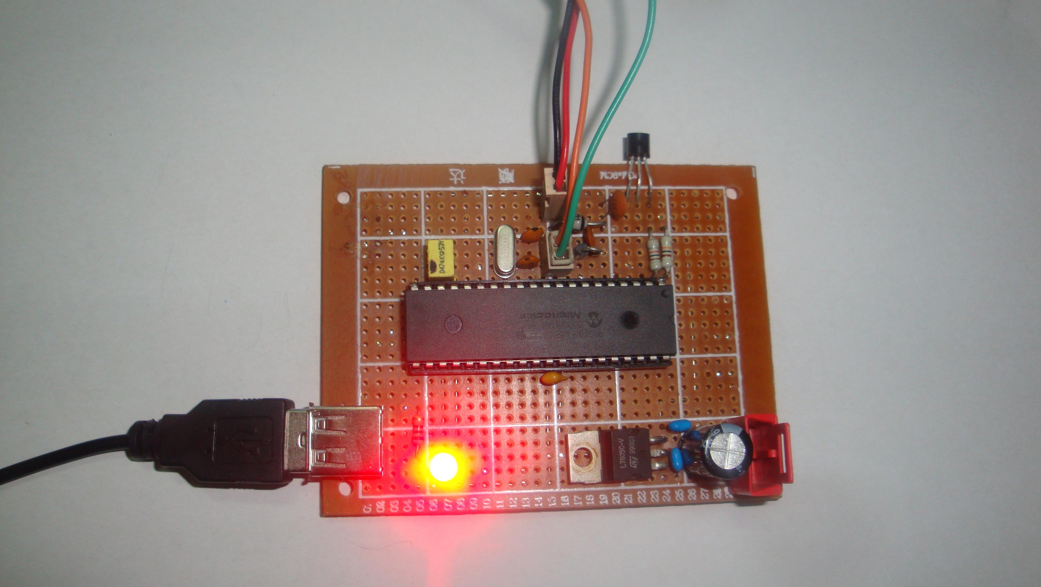

Since you brought up the temperature subject, i am developing a tool for this kind of analysis. It is almost done and will allow monitoring of fieldcoil resisntace increase and voice coil resistance increase in time. A temp probe can be placed on the center pole piece near the voice coil to calculate a temp coef. This can help in determining large signal parameters and create a more precise model.
The tool is based on PIC18F4550 and connects to the PC via USB for data logging and visualization. It can export data for archiving.
Will show you what it can do once it is completly done but here are some teasers with a test unit, i heated up the temp senzor with a lighter thats why it goes up. Im designing a PCB now hope by next weekend to be done.

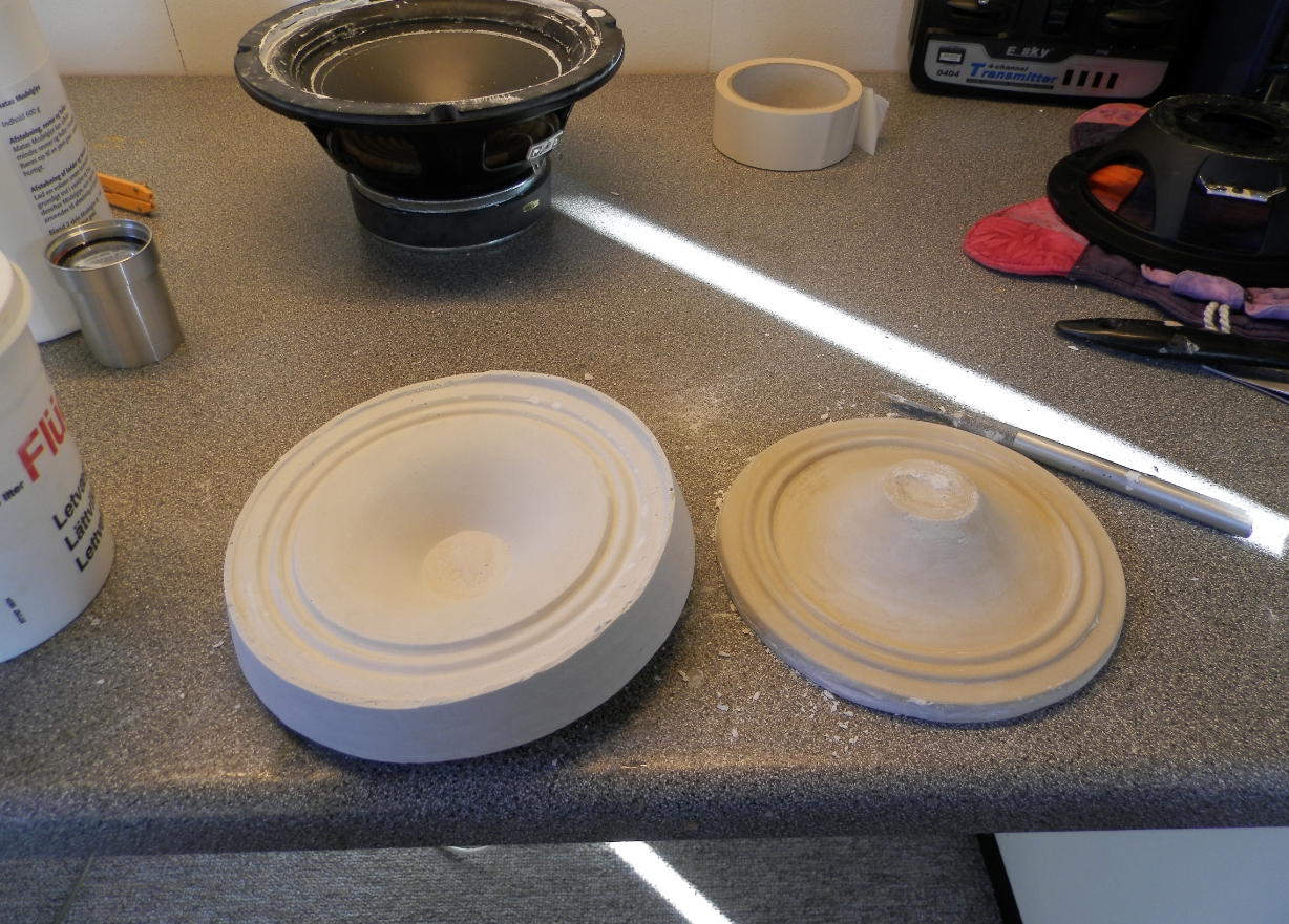

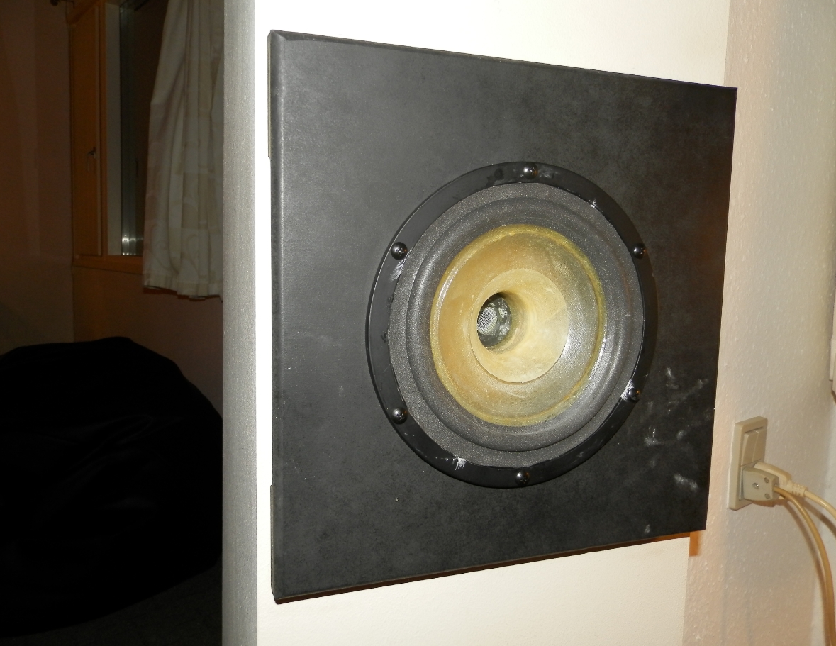

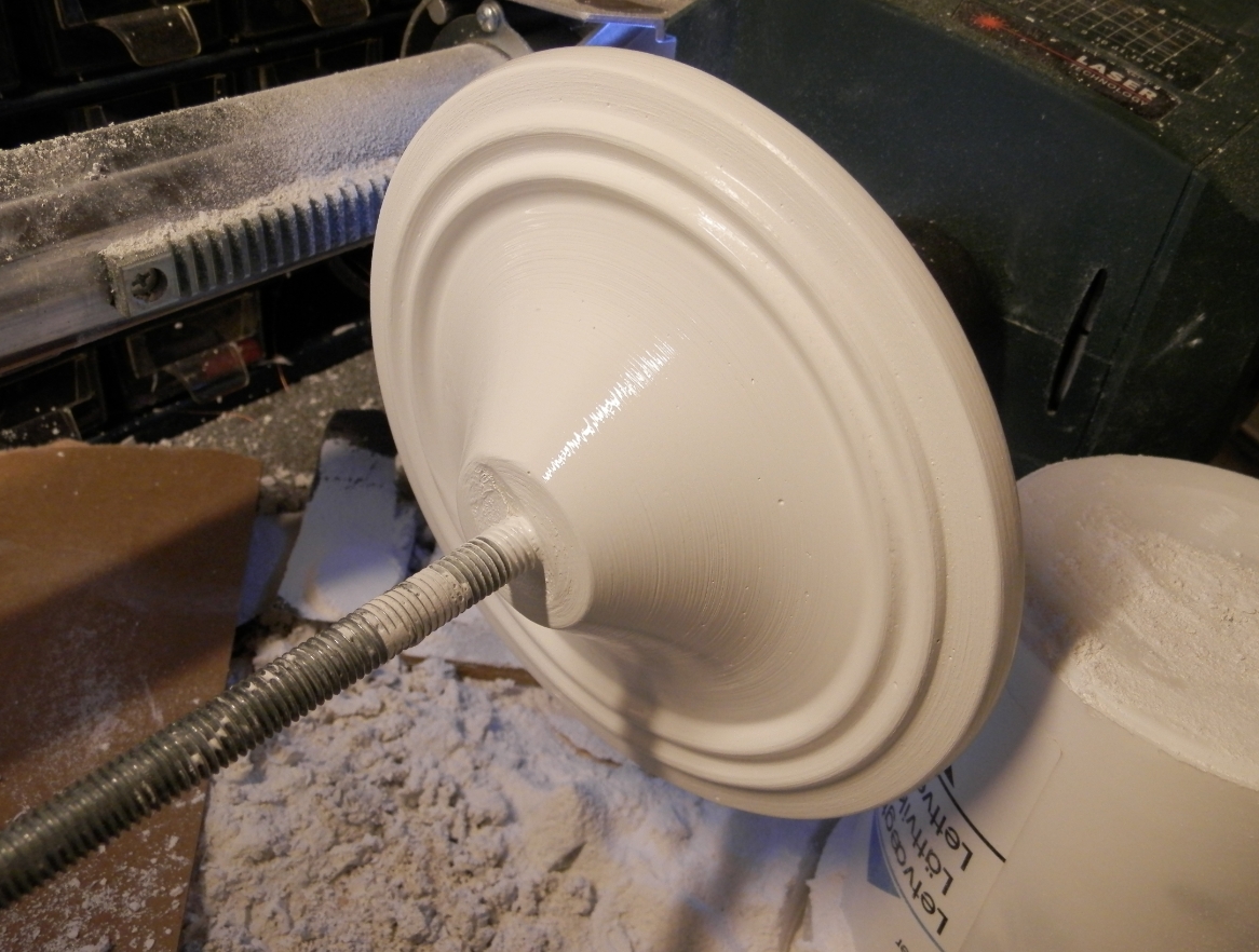

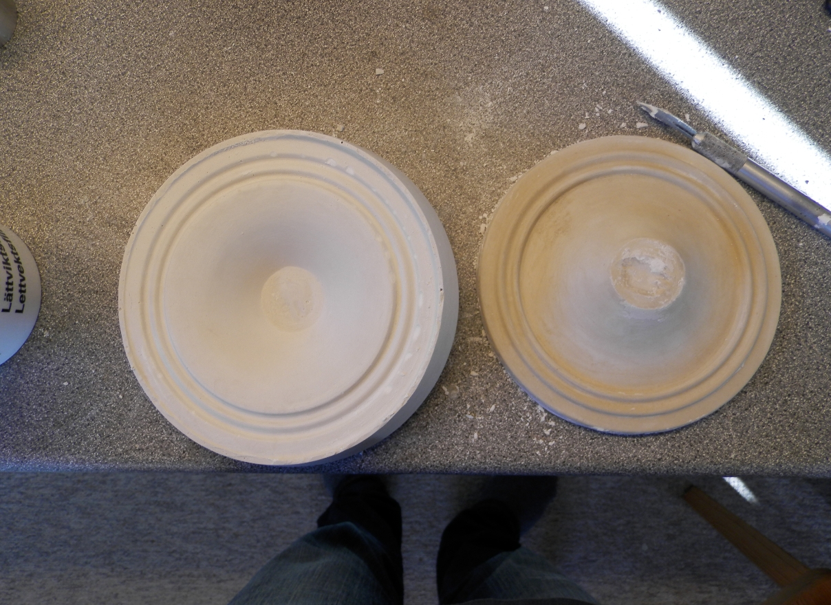

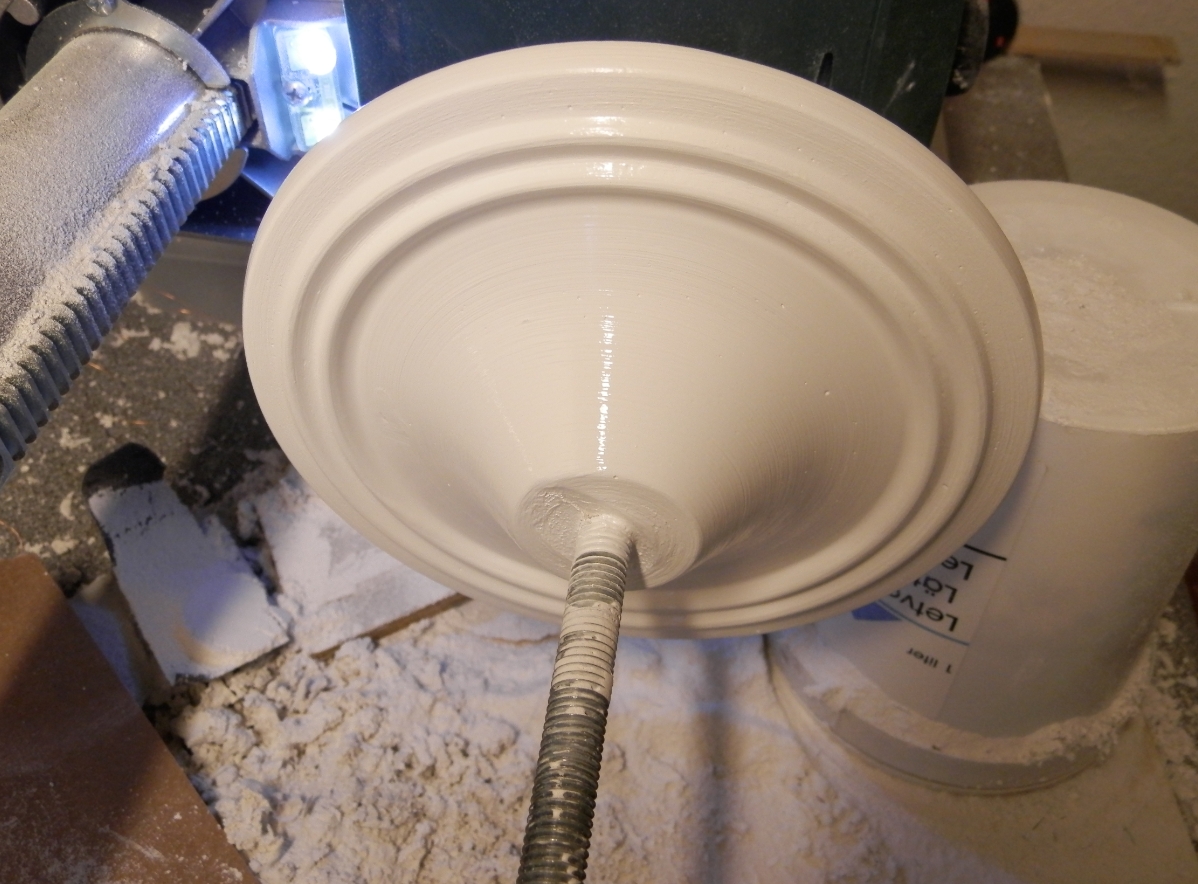

I am working on my new cone, this time I will make it with a positive and a negative from. I bought some two component silicone to make the positive from, this will make it easy to experiment with other cone materials. The new form has a build in surrounding, It is my goal to make cone and surroundings in one part.... But I have to see how it works out.
A note of observation.
I was in a hurry to listen to the driver so I used a standard spider that I had, it has a very high suspension. I have always believed that a spider should be soft, so I was surprised how good it's sound. Any comments regarding the spider, pro or cons on soft spider will be appreciated.
Take care

Hi Frank,
Good work there.
Regarding spider and Cms value. You need to reach a balance somewhere. I too like softer suspesions because it will enable the loudspeaker to perform well at low volumes and seems to be more revealing in details.
However it must be carefully chosen as there is the danger to have a long impulse response because the recovering force that brings the cone back to its resting position is smaller.
In your case and mine with a low moving mass the inertia will be lower and allows for a softer suspension system. Also a powerful motor will help in controlling its movement.
