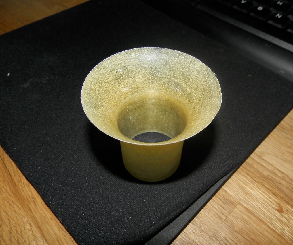

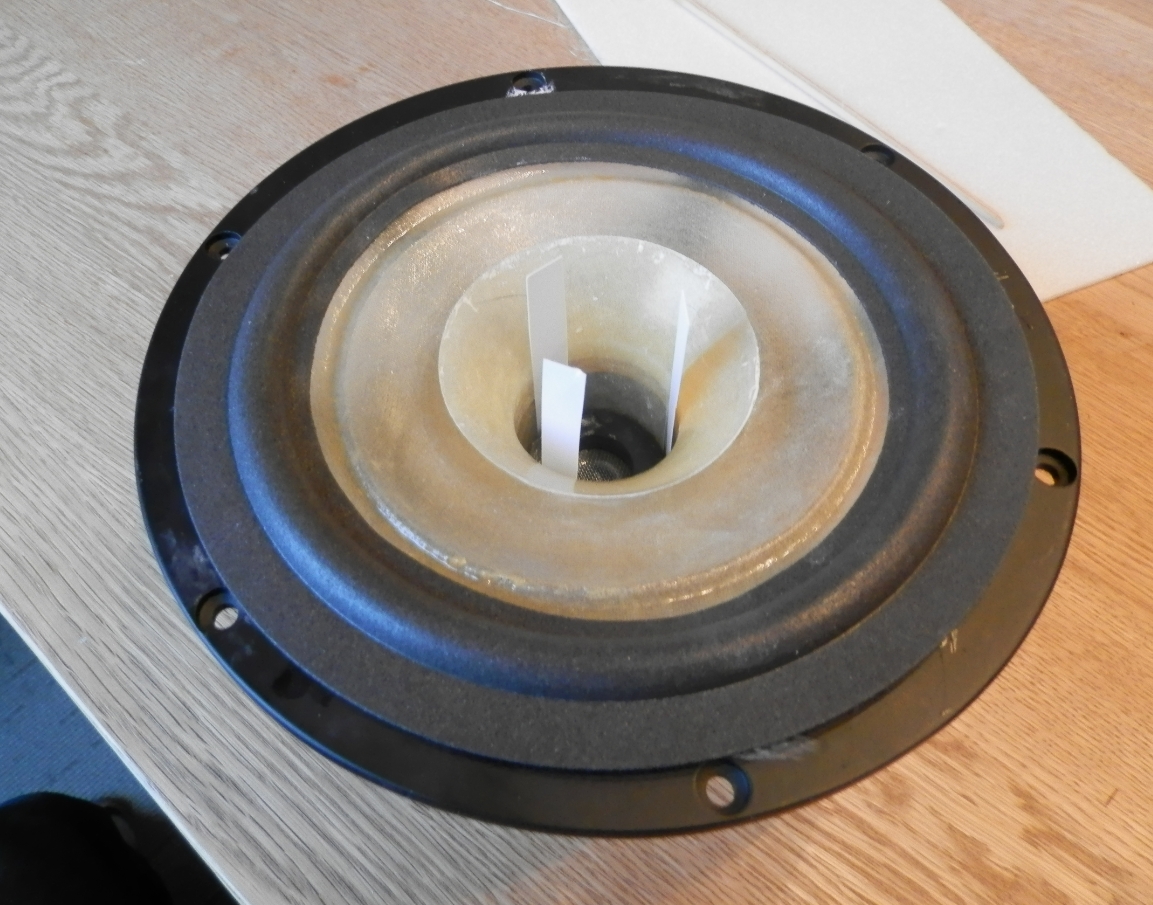

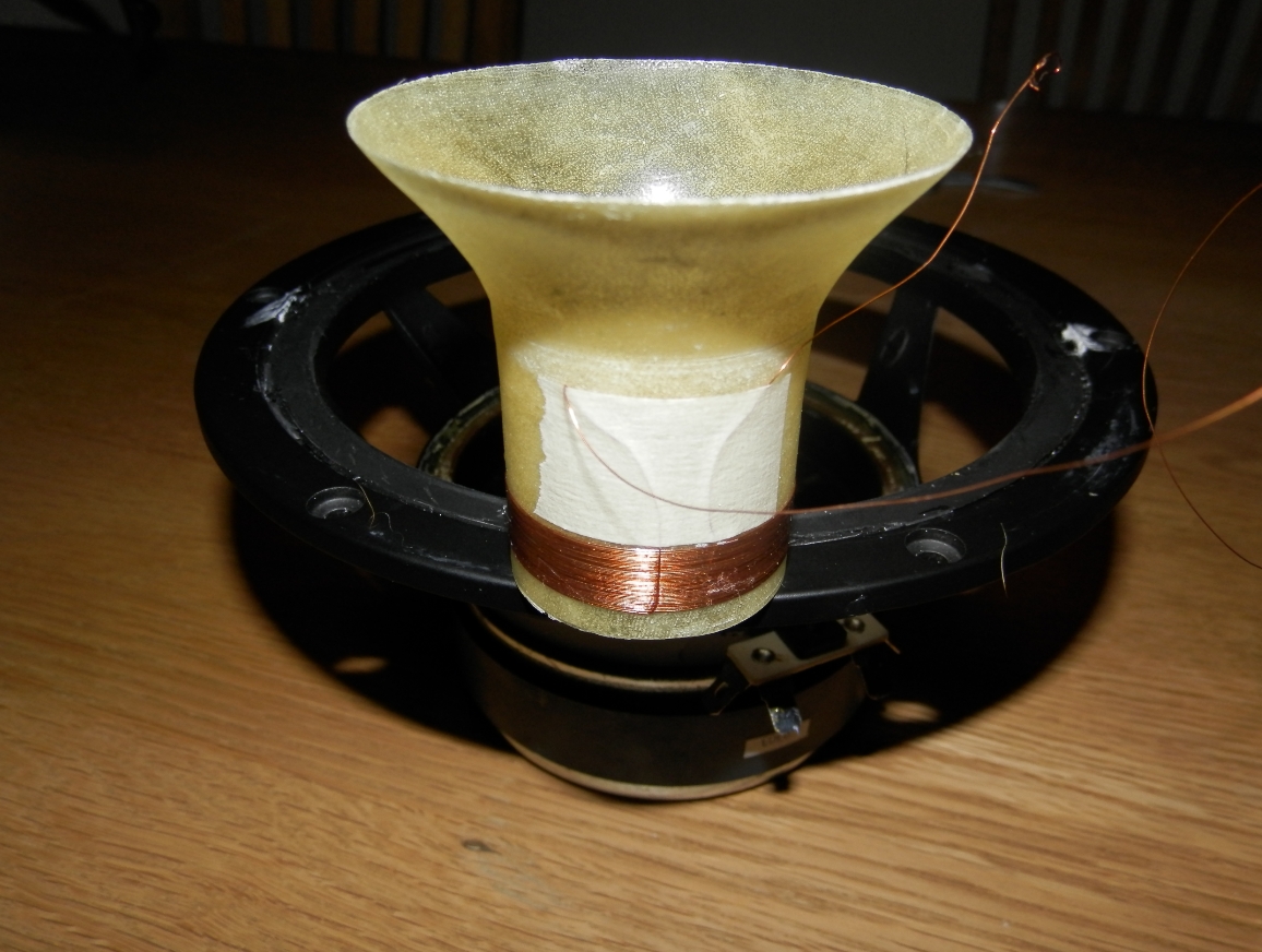

Here is a update on the wizzer/voice coil former. It went pretty well, it is durable for sure but for now I need to make a former a each wizzer. Hentai, I can try to make one with paper for you, but what kind of paper do you want to use.
Hi Hentai
I am sorry to say that I had no luck in making a wizzer with paper, I only had silkpapaer so that is what I used. But I think if you are going to use paper it is best to use a positive and a negative form, under high pressure.
The weight is 3.8 gr with the voice coil. I did a quick test and it relay works...There is plenty of energy in the high frequency range, a super tweeter for real. My guess is that it start a around 4-5KHz and up, but this is just by judgeing by ear.
Here is some pic's:
Here is some pic's:

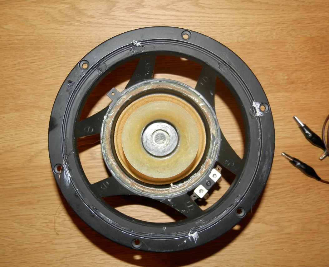

Dave Zan, I measured the air gap on the two different I took apart they were 1.5mm. Since I am using ties magnet for starters , that is what I will be using.

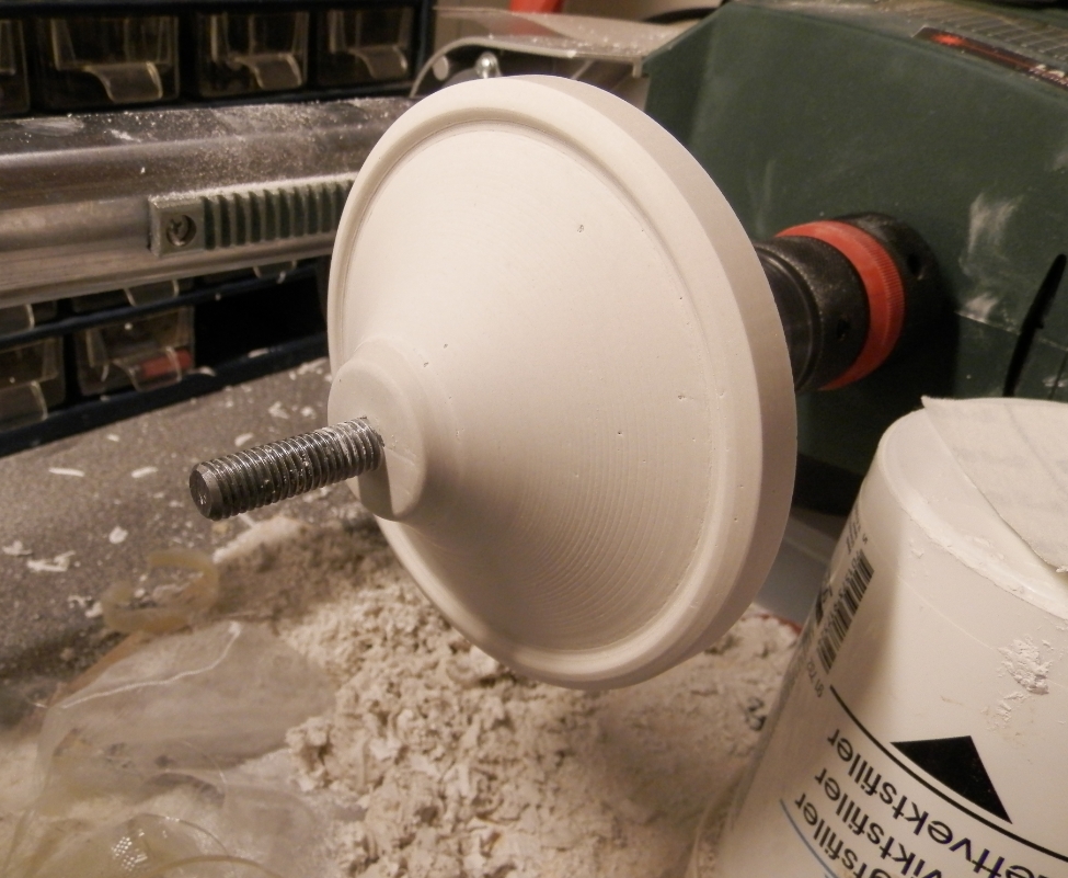

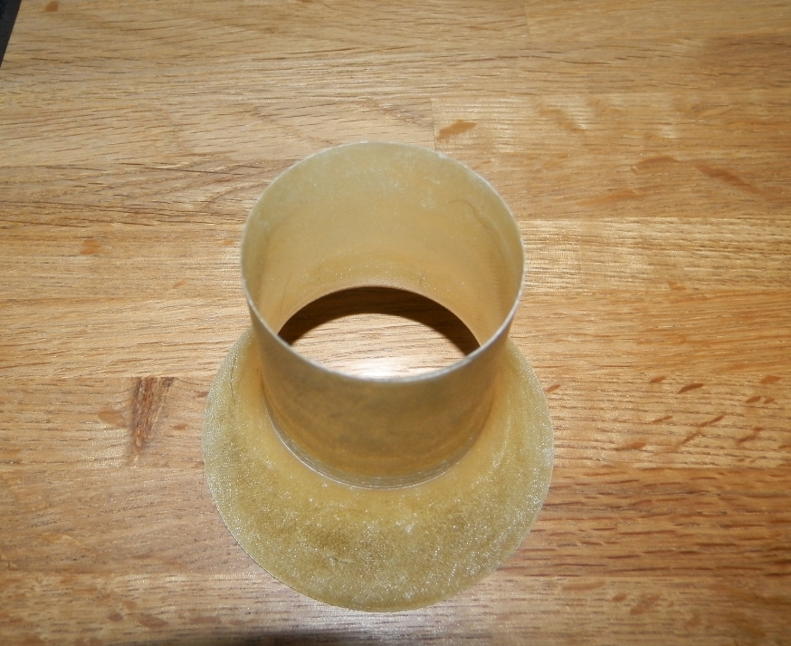

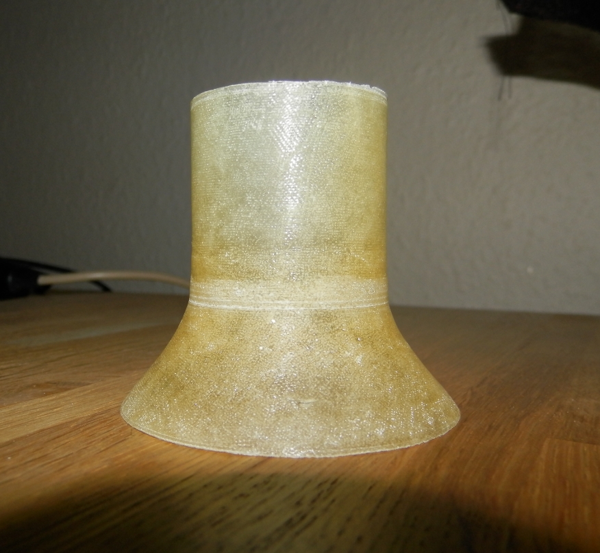

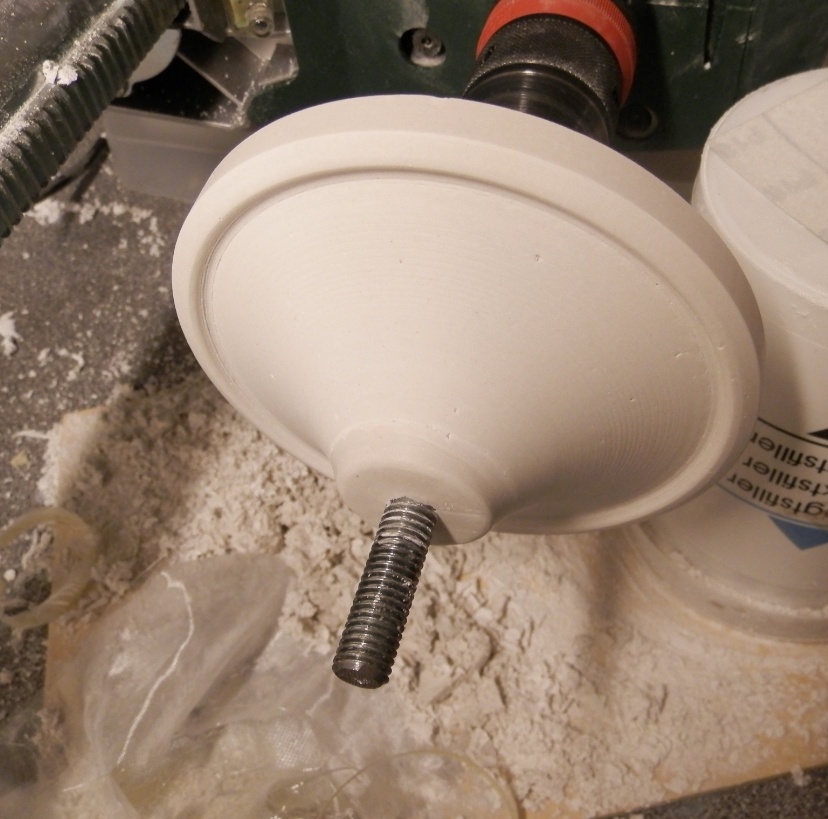

I did make a new former for a 6,5” without wizzer, I want to se if it will work whiteout the wizzer. If it doesn’t I have the former to make a wizzer. Also I am trying to copy the former using liquid latex, but it is to early to say if it will work.
Just a note: I did get a normal voice coil and the weight of it is 6.5g.
Here is some pic's of the new former. The former is slightly modified now.
Take care
Hentai, Thanks.... But I did placed an order now, and they had a min. purchase of 25$ so I got a variety of sizes.

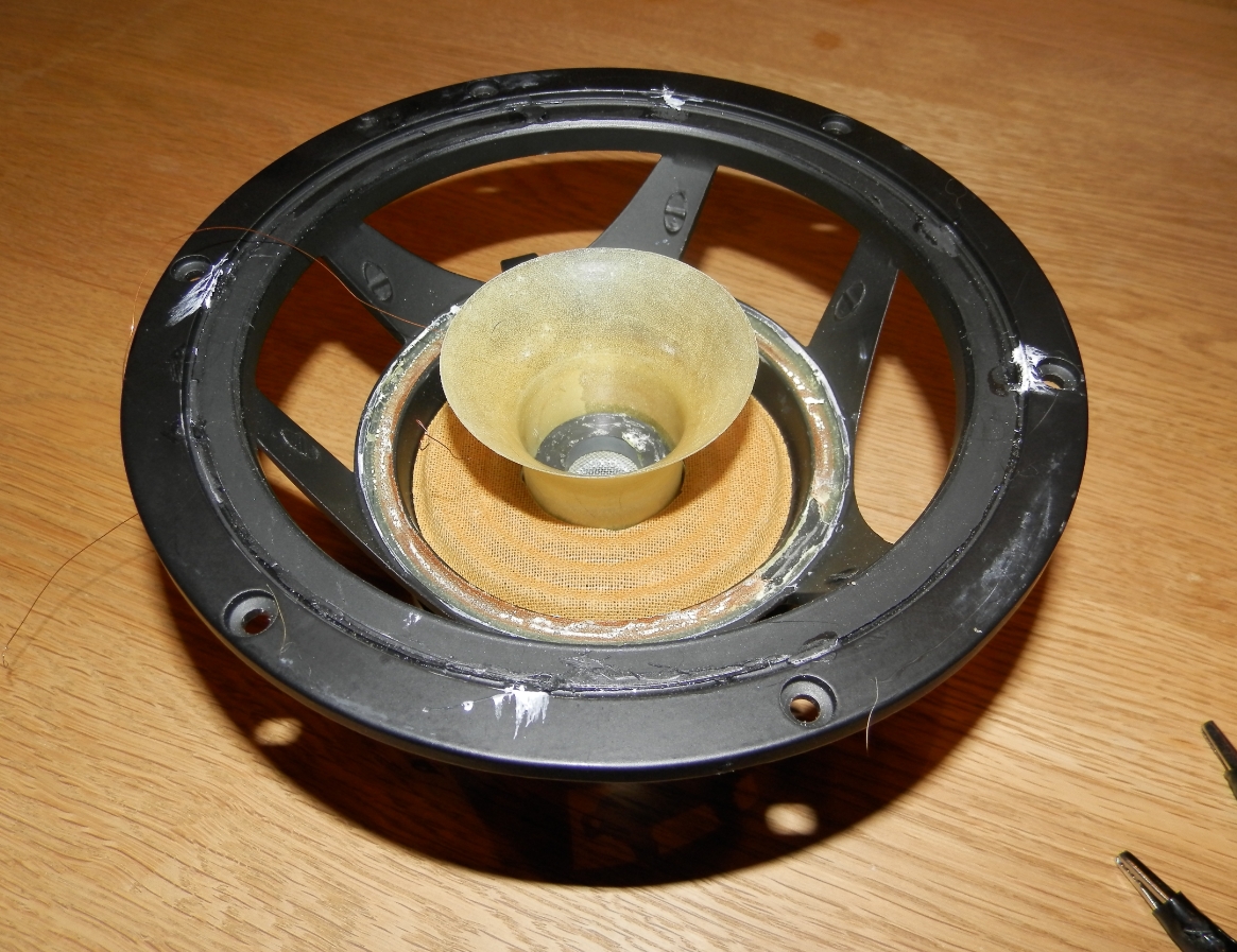

Hi JMFahey,

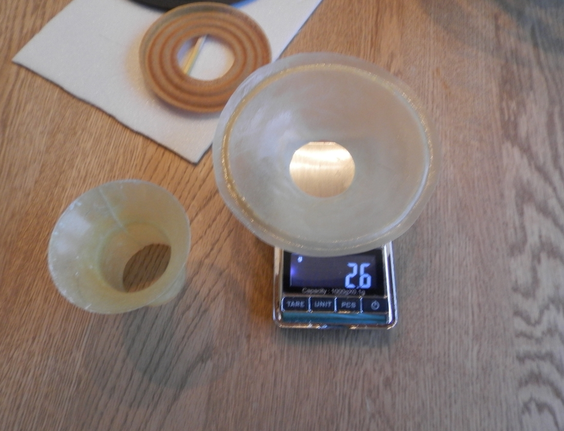

Thanks for your answer....If there is any chance for improvement I will use it, no need to not to try to make it better. I can se you like paper cones, I my self do not have a preferences.... what ever sounds best.
A cone that weighs 20g is heavy.... The new light weight cone I made is only 2.6 g. I have added some Thixotropiennittel, this allow the epoxy not to harden fully this will increase the damping of the cone.
This is how it will look when done.
Take care
Take care
