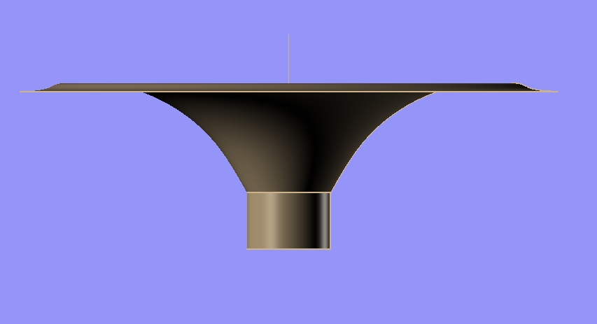

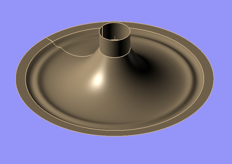

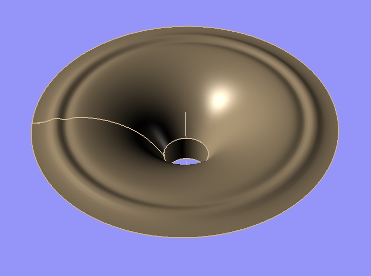

Here is a thought... To eliminate traditions between the voice coil and membrane and from the membrane and the surroundings you could make a combined unit like show below. This way you can make the hole thing extreme light, I am guessing about 3-4 g without the copper. Also you don't need to glue the hole thing together with more or less know glue spec's.
I know you don't have a lot of Xmax but this is no problem for me, as they will be cut at around 80Hz. Please coment.

Well i think it is a great idea, making the former as an extension of the cone. I would assume it would be difficult as a DIY procedure tho?
For a home system, high efficiency full range, i dont think we need to worry about the former handling large temperatures. I just needs to be thin enough and ridig enough.
Great idea Frank, do you think it can be done in diy conditions?

Agree, very neat and economical thinking.
Possible to vacuum form as well. However the vertical wall of the coil former would be very thin compared to the more horizontal parts and the sharp angles will cause high stress regions and therefore need to be much more rounded - all stuff that is fairly easily addressed when designing the pattern.

Glad you liked to idea. I think it can be done by us DIY's but I wouldn’t use the vacuum forming technique....as Johno mentioned, the vertical walls will be to thin. The tricky part is to get the thing of the former. I would use glass or carbon fibre, at this point fibre glass sounds best but haven't tried carbon fibre yet. I don't know if you know this, but you can get epoxy glue for many purpose some can handle high temp. and you can get a variety of softer and harder types. You can also ad different additives to change it's properties.

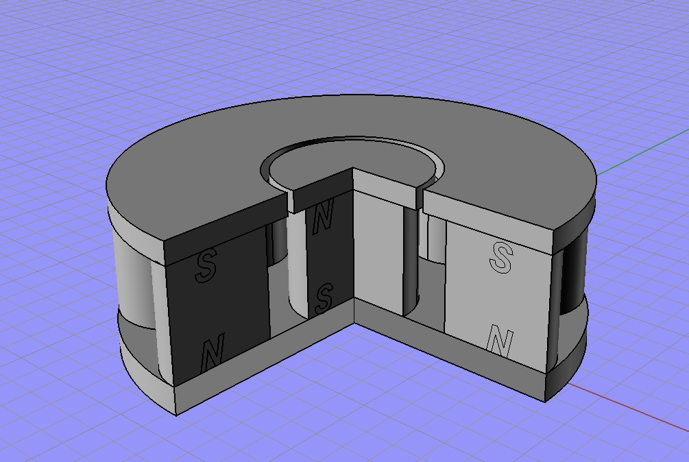

Here is another thought, see the picture below. I have replaced the centrer pole with a magnet, this should work like stacking magnets and increase the flux and help to saturate the iron . Please comment.
Because of the magnets lower permeability than irons the flux in the gap will be less than if it was iron and maybe that will be not the the only one negative effect.

Frank my first thought was saturation of the pole pieces, stefanyovev has a point tho. If i can find the time this weekend i will run it through FEMM.

Stefanyovev. Are sure that magnets are less conductive than iron, this dose not sound logical to me. And it dose not correlate to my findings on the internet, see these two links.... Maybe I misunderstood some thing.

Yes, of course.Are sure that magnets are less conductive than iron,
That's why magnets are used to "generate" the magnetic field, at a lower flux density, and soft iron is used to *guide and concentrate" it, in the desired gap.
By the way, a magnet used as a polepiece, besides being a *terrible* material for that, will have the added disadvantage of *opposing* the main magnet flux because it will be magnetized the wrong way, at least in any "normal" magnetizer.
This depends on the permanent magnet material and is partly a matter of perspective.
It helps to concentrate the flux for low flux density sources like ferrite.
For Neodymium the main reason to use soft iron is the difficulty and cost to produce a magnet with a radial field.
An axial flux magnet and steel pole piece is just cheaper.
The old Aura 18 NRT sub-woofer did use a Neo. Radial field magnet but was rather expensive and had consequently limited production.
Earlier in this thread "Linesource" showed a simulation with more than 2 tesla field where the elimination of the pole-piece was actually the key. Not a practical structure as shown but of interest. Pity he never followed up.

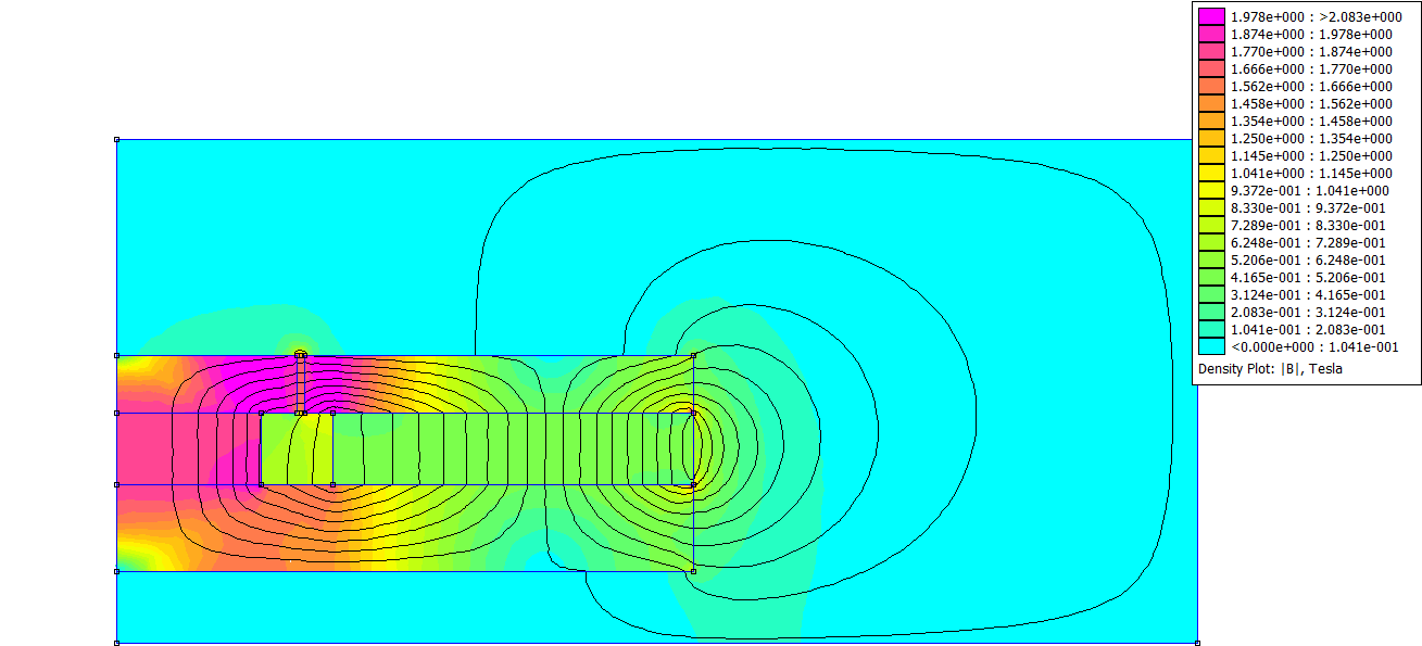

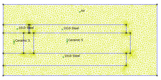

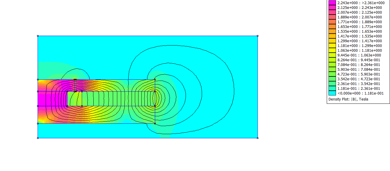

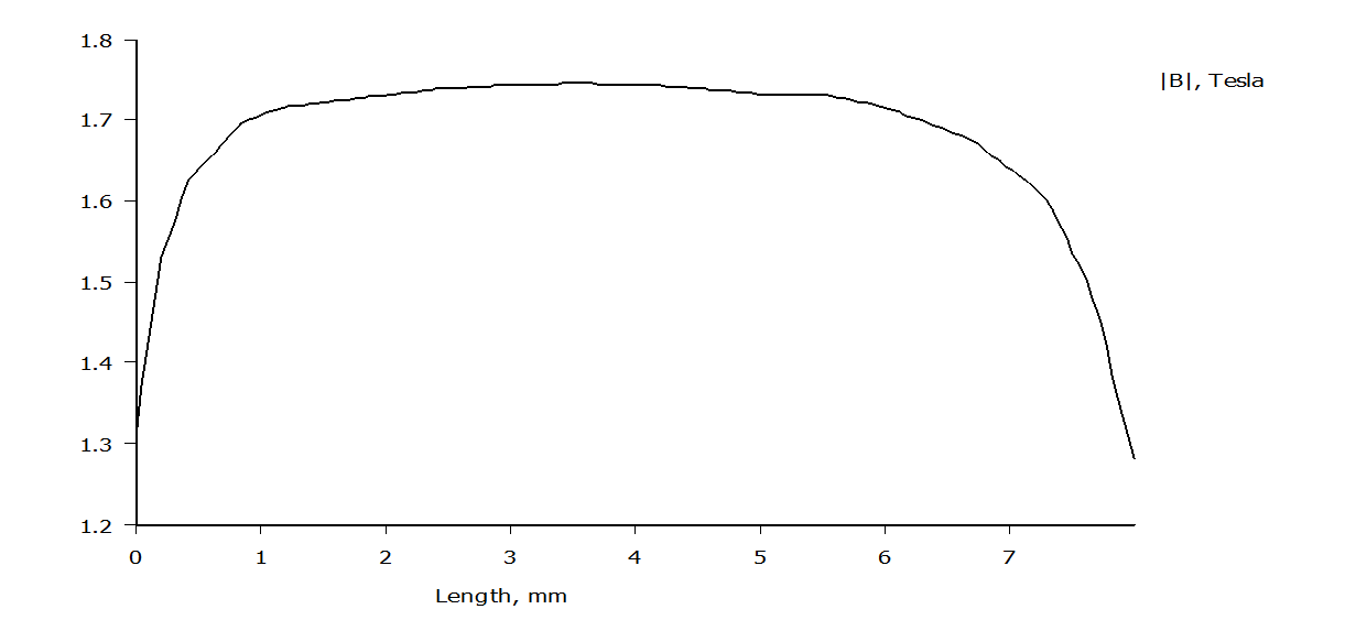

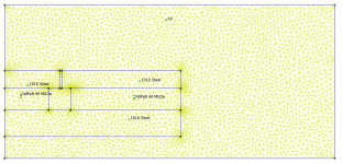

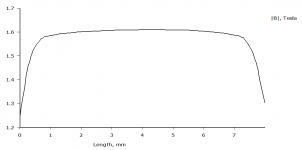

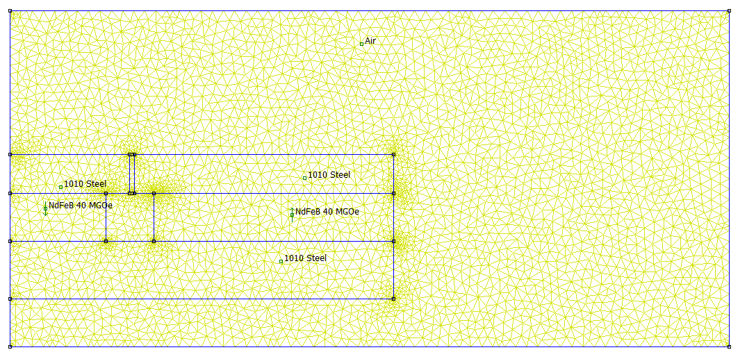

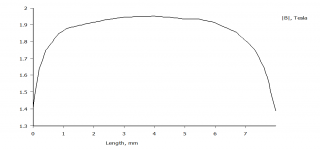

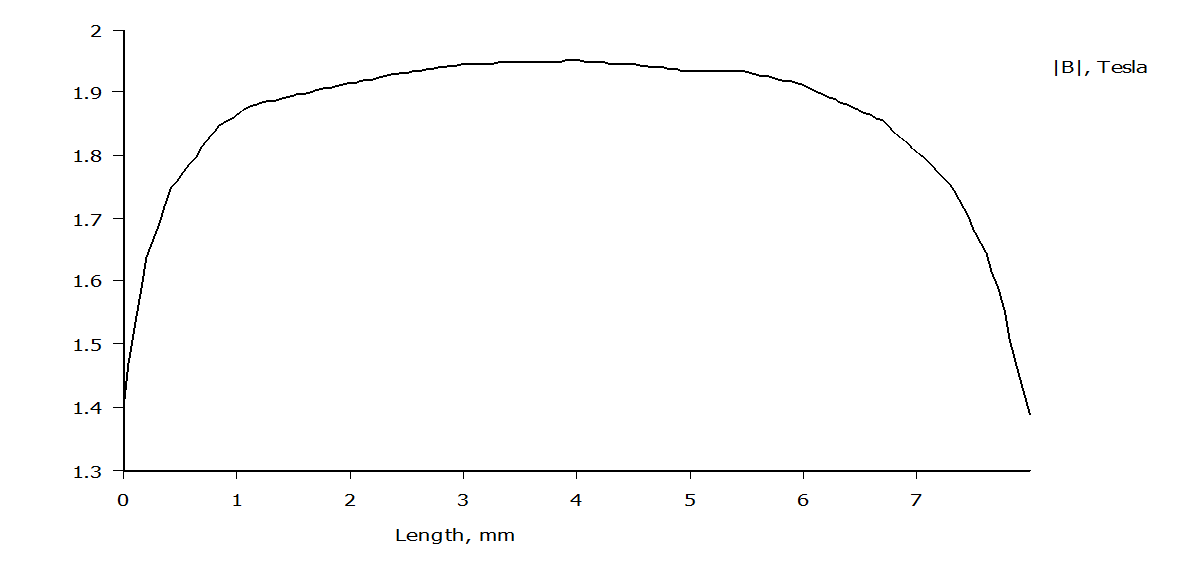

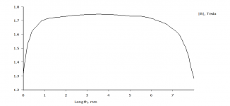

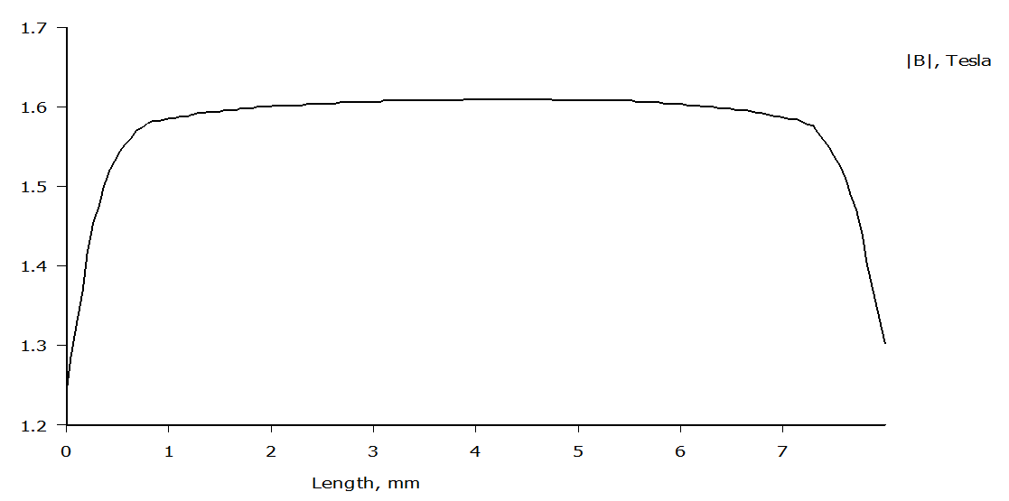

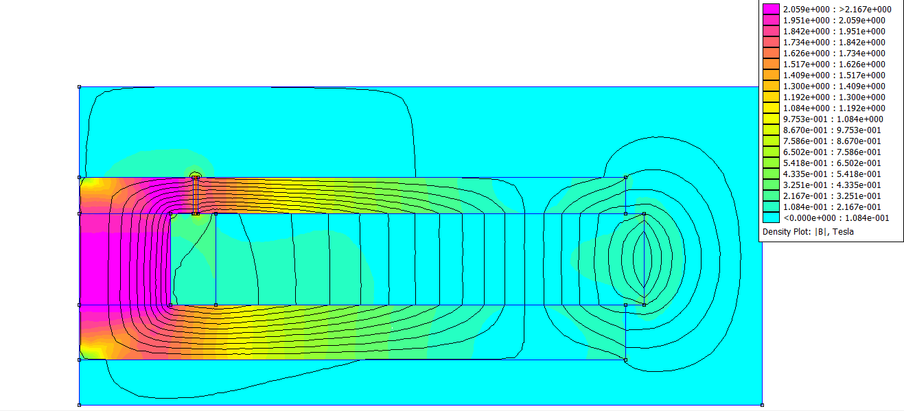

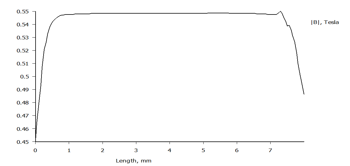

Here are the Femm results:
For ceramic 5 PMs, 8mm gap 1010 steel:
Structure (showing polarity of PMs):
Central pole made of PM, magnetic lines:
Central pole made of 1010 steel, magnetic lines:
Central pole made of PM, B value across gap:
Central pole made of 1010 steel, B value across gap:
For NdFeB40 PMs, 8mm gap 1010 steel:
Effects are less noticeable with Neo PMs but still steel wins 😀

Thanks for simulating and posting.
And let me repeat something many don't notice:
you simulated the center piece magnetized the opposite way (geometrically) to the main external ring magnet, meaning: if, say, the outer ring has North up, you simulated the magnetic material "polepiece" North down .... which only happens in simulations 😉
Hey!! , in Simulation World you can simulate *anything*, even if it's technically impossible 😉
Notice I didn't say "physically" impossible.
But I stick to real world speaker production technology.
But if such speaker is magnetized in any commercially available magnetizer, *everything* within the magnetizer coil or gap will be pushed the same way, by definition.
Say, everybody "North up" , including the pole piece and any other magnetic element of that structure.
So? ........... what happens after you cut current off?
The soft iron (SAE1010) polepiece will "forget" that induced magnetization and happily take whatever the hard magnetic material tells it to (Ferrite/Alnico/Samarium/etc.).
If you use a hard magnetic material for the polepiece that will not happen and it will fight the main magnet.
In practice, it will be worse than even not using a polepiece at all 😱
I have built my own magnetizers and use them everyday in speaker production.
Of course , I had to design them from the ground up.
No real data on Internet even today .... and we are talking mid 70's , not even Internet !!!
And one point to consider was that beyond fully magnetizing Ferrite, I had also to saturate the polepiece, or it would act as a very real magnetic short sucking lineforces from the Ferrite.
That's why magnetizers are such power guzzlers.
My "small" one at the shop, good for 105mm magnets, needs over 40A @ 220 Volts monophasic, do the Math, over 8 KW.
In fact, when magnetizing, I go "outside" and clamp it straight to the 220V Power Company line, to avoid resetting PCs , etc, at home.
The "Mid" one, good for ~150mm magnets is at a friend's factory, because it needs 3x380V full wave rectified (equivalent to around 500V DC) @ 47 Amperes= over 20 KW.
Magnetizing pulses are short, but the line must be able to deliver.
I'm building a large one, good for 190 and 220 mm magnets (so I can clone EVM, JBL, etc.) but it will be capacitive discharge because , simply, I can't afford the special reinforced Power Line it will need.
So in a wayyou took the "easy" path😉
You just built a "dedicated magnetizer" and made it part of the speaker.
