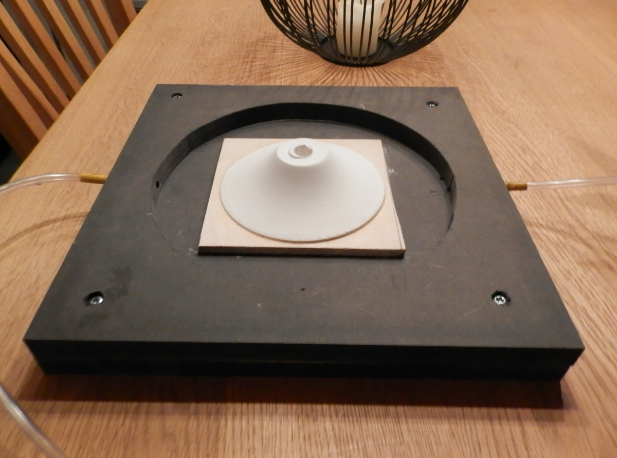

Sorry for the late replay.....I made a vacuum form of plaster and made a little jig for suction, for suction I used a vacuum cleaner. The Depron (3mm) was taped over the jig and the Depron was heated up with a hot air blower, when the Depron is getting bendy (Just a bit soft) the vacuum is set on in a slow manner.
You have to bee very careful when using the hot air blower, Depron is a very good insulator so on side can be hot and the other side cold.. So I think it will be easer to work with if it is heated up with radiated heat, or even better if the hole thing is heated up and vacuum-ed in a oven in one process.

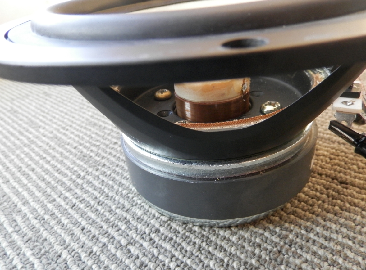

I have tested with shorting ring inside the gap but because the copper material had to be thin in order to fit the gap it wasnt as effective as a thick ring placed just below the gap. The electrical resistance of the ring is much more important to me than placement. If you attach it to the central pole piece the coupling is pretty good.
Sorry for image quality, im not good at taking pics:
Overhung yes has lower inductance but first i wanted the lower distortion of underhung, second if you make the cone light enough (you have) than inductance isnt such a burden.
Personally i think you should drop the idea of using shorting ring in voice coil. It wont be effective being thin and aluminum. It will add to mass and will interfere with damping. Using a copper or silver 🙂 ring attached to the central pole piece as thick as possible is best imho. Also designing the voicecoil itself in a good way to reduce inductance. as small a diameter as possible, as high a height as possible things like this.

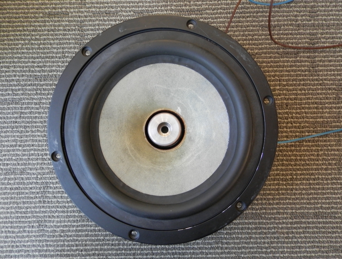

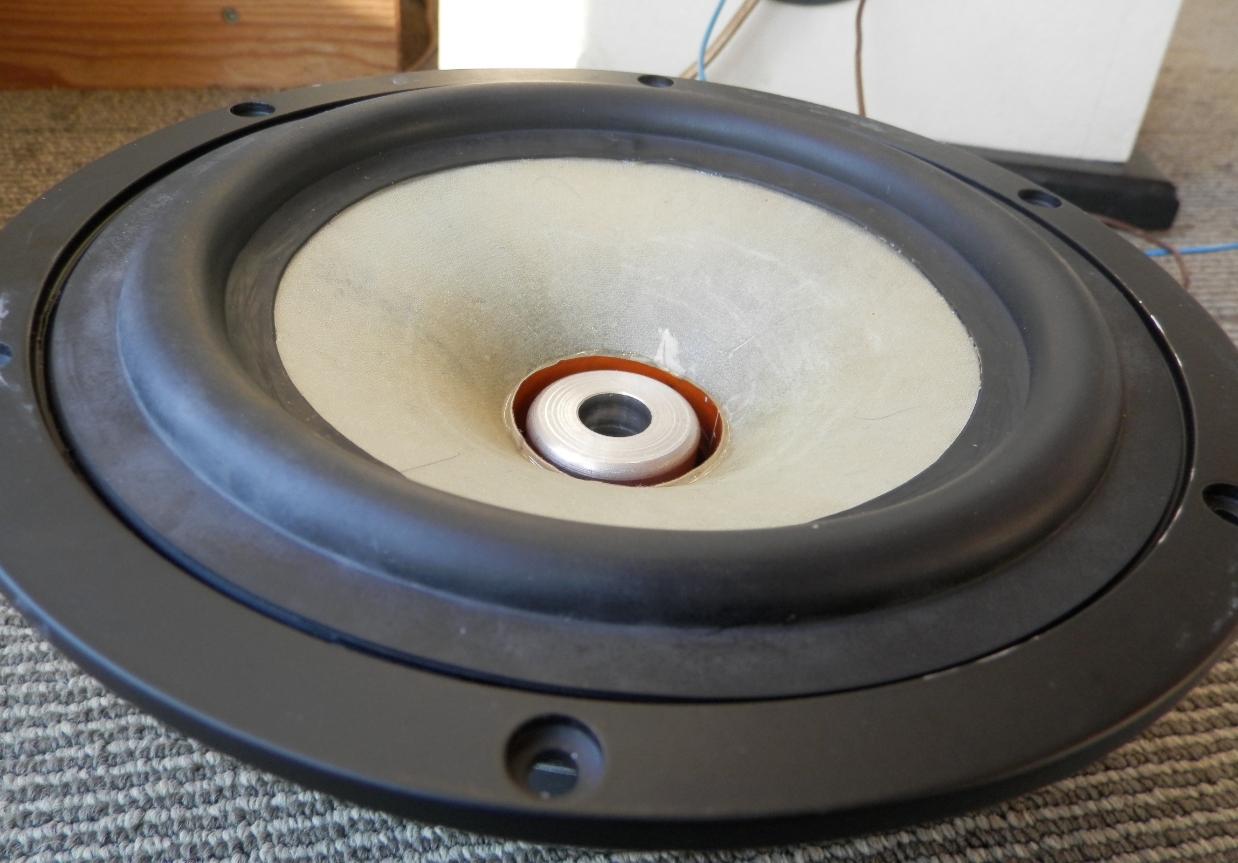

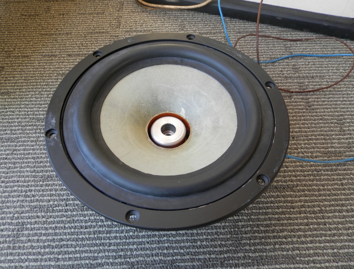

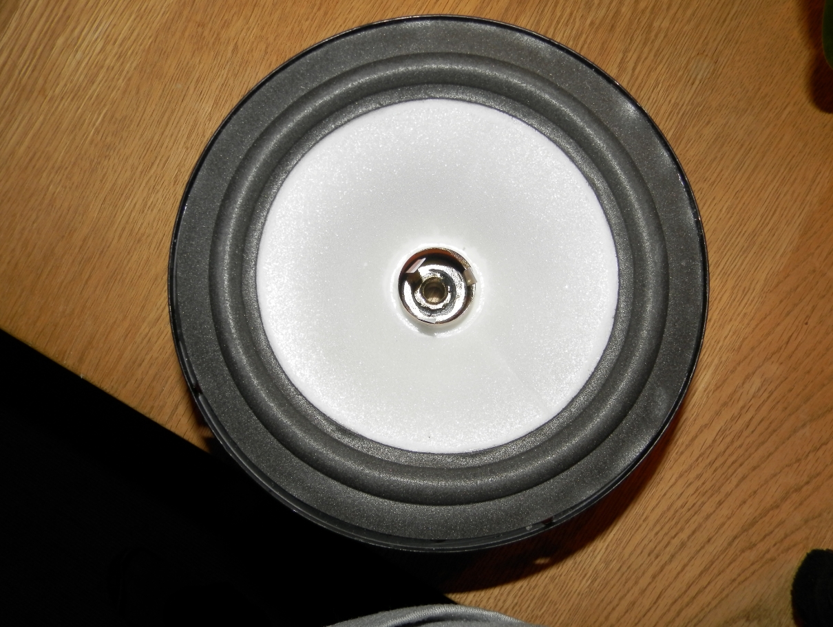

Just some note on what I learned. Depron is to soft a material to convert energy from the voice coil to the membrane at higher frequencies , it will require some other material that are very stiff.
I did a new membrane with 4 layers of 25g/M2 fibre glass, it weight 1.9 g for the membrane alone.
I used a voice coil from a Monarco SPH 170C. The voice coil was glued to the membrane using 5 min. epoxy glue.
This relay works, it sound like a full range now, I compared it to my F200A and the new one sounds like it has more dynamic in the top. This might be the one that I keep, but I got a few ideas I need to try.
