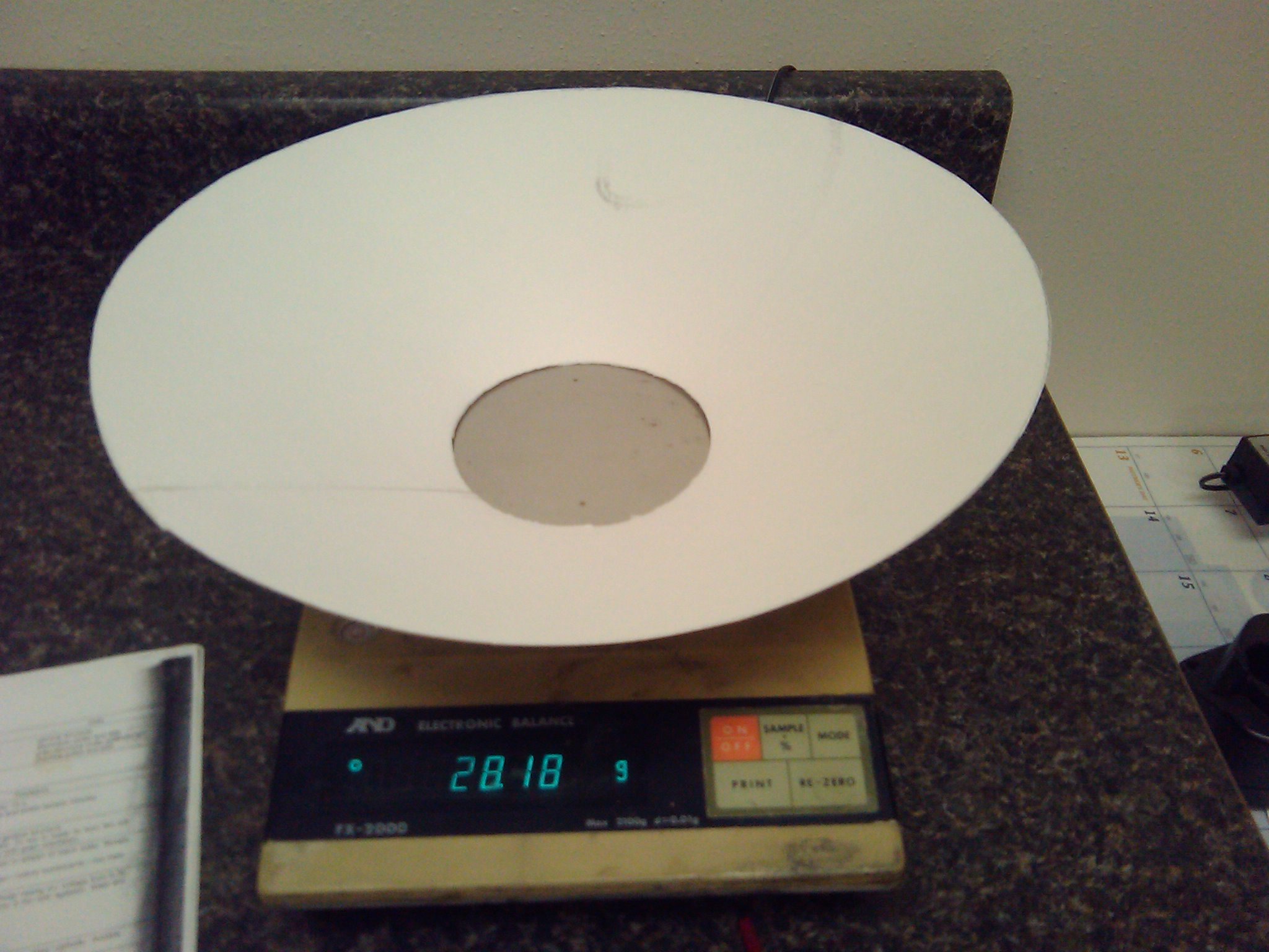

First attempt at a diy cone. only 28 grams. The thickness of the paper is 17 mils. It was fairly out of round where the glue joint is. But it's seemed to have straightened out over time.
I did a test with the coatings. I tested both pva and damar varnish. With a single coat of pva I couldn't tell the difference. One coat of damar should a definite increase in stiffness. Now I didn't do any quantitative test. Just flexed the paper in my fingers and compared it to a non treated piece. I have 4 other cones cut out but not glues. I will try and glue them tonight and treat them with damar. These will be my first cones. Don't really care for the white color. But color isn't really a concern at the moment. I have not decided if Im going to buy stock voice coils or try and make my own. I bought a winding machine off ebay. So winding my own will be pretty easy compared to the field coils. It is a manual machine though.

I glued together another cone last night. I found that it was my method of securing the joint for drying that pulled the cone slightly out of round. I used 2 pencils and some spring clamps. Worked like a charm. The glue is aleen's tacky glue.
Just 3 more to go. I m trying to find some info on the coil dimensions for a jbl 150 bass horn driver. It will dictate the size of voice coil i'm going to put on these cones.

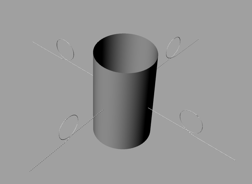

I have been trying to find another way to make spider suspension, and I came up with this.......Please feel free to comment.
As I see it a normal spider has two thing that I would like to do better. The first thing is the mass and second is that it has a piston areal which produces an unwanted sound. I have seen some that uses a thin solid material with a spring like patten, this one way to reduce the areal, but I would like to make it less than that.
My idea is to use four torsion springs, see picture. This would give a minimum of areal and the weight is very low. If the loop on the spring is made small it will also provide a horizontal stabilisation to help the voice coil to stay in the magnetic gab.
If any of you have an idea to where I can get thies springs, please let me know.

The spider idea is sound but i guess you wont escape the added mass issues because you will need a metal ring anyways to attach it to the former. Very thin steel could do the trick.
