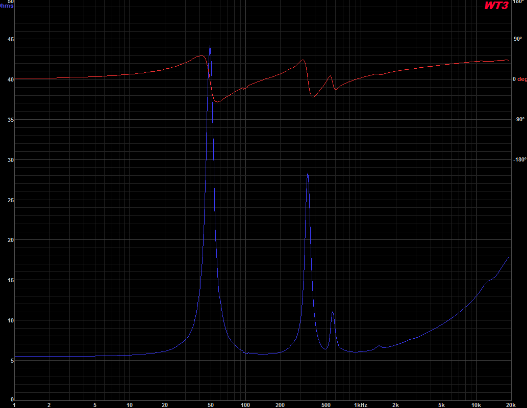

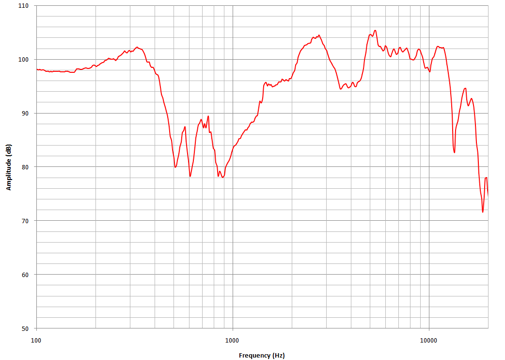

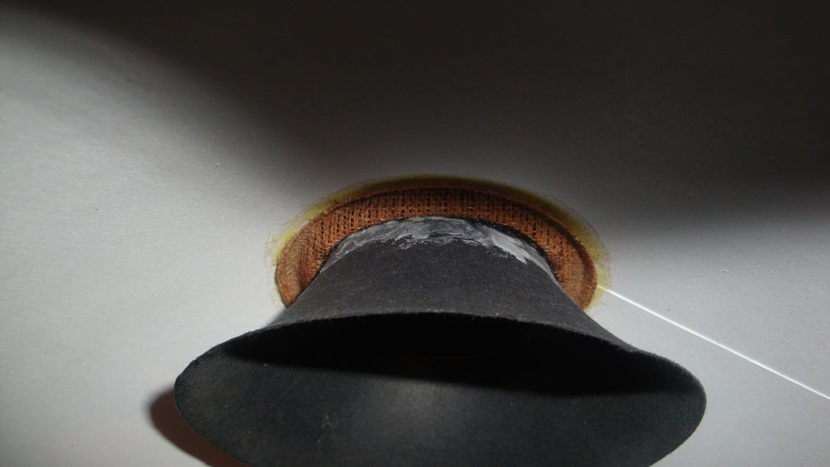

This weekend i tried to find the cause of the 1khz peak in impedance. I've seen this peak in other fullrange drivers more or less proeminent so as i said before my belief was that it was caused by transition between main cone and whizzer, just like a crossover in a 2 way system usually causes a bump in the impedance.
To test it i added a small spider between main cone and voice coil former to increase the compliance inbetween. Even so i chose a pretty stiff spider so that the main cone can move.
In the pictures attached you can see what i mean.
From the impedance curve it is clear how the xover point between two cones changed. The higher compliance moved the peak lower in frequency as expected and in the 1kHz region impedance is clean.
Measuring the frequency response shows the bandwith of the two cones. While firmly decoupled from main cone response goes beyond 10kHz but no much of a real gain compared to previous versions.
The lighter voice coil was used with a measured inductance of 0.4mH.
One of the reason why i find Frank's design of voice coil former and whizzer as one very interesting.
