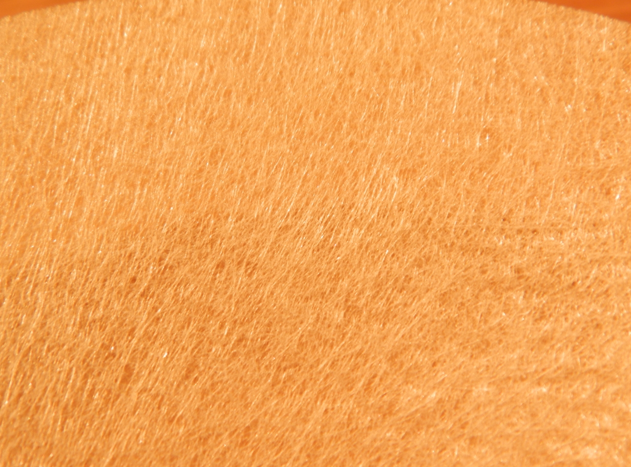

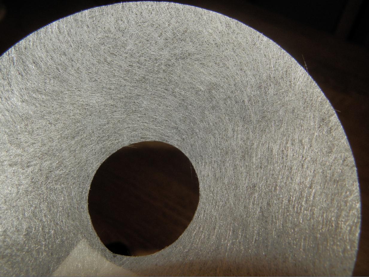

This is the martial I found and tested. It is made from fibreglass, but the fibres are thicker than other fibreglass I have worked with also the fibres is directed in a non uniform way. It is used for wall mount, a from for reinforcement for the wall.
The weight of a 115 mm cone is 0.5 grams including the tape on the back but without epoxy, the thickness is 0.25 mm. It is relay quit stiff in it self, but it needs some sort of treatment to make it airtight. I used black epoxy colour to make it look nicer.

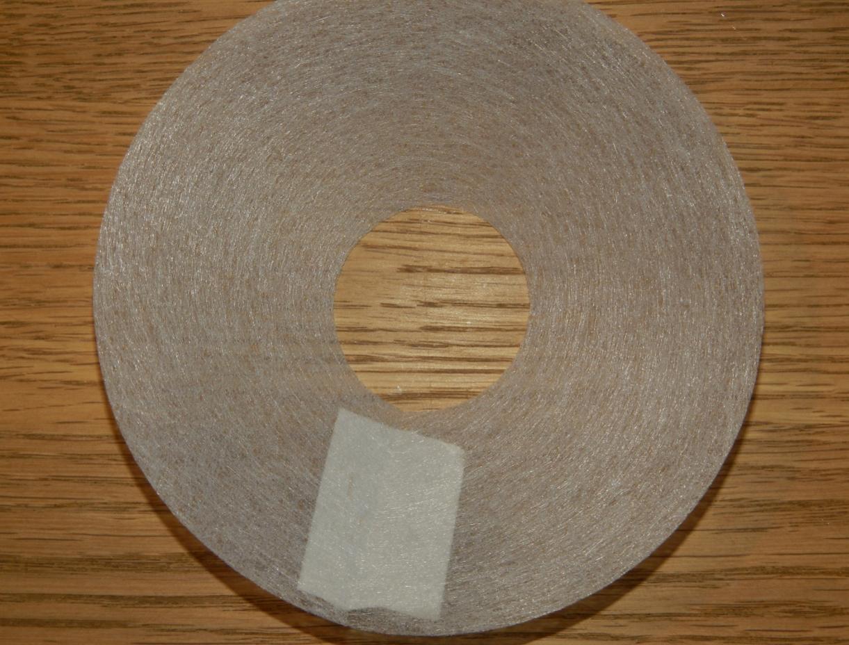

Here is some pictures:
I have thought about it too
and it is indeed very similar looking to the fiber I once knew as the lightes and finest fiber cloth available for yacht building
it was used as first layer when doing a new mold
Finishing Tissue perhaps?
You can get cloth down to 0.7oz per square yard, I used it a lot in Aeromodeling.
Here is a link to a German shop, you can get just about anything in fibres here: Fiber reinforcements | R & G Faserverbundwerkstoffe GmbH

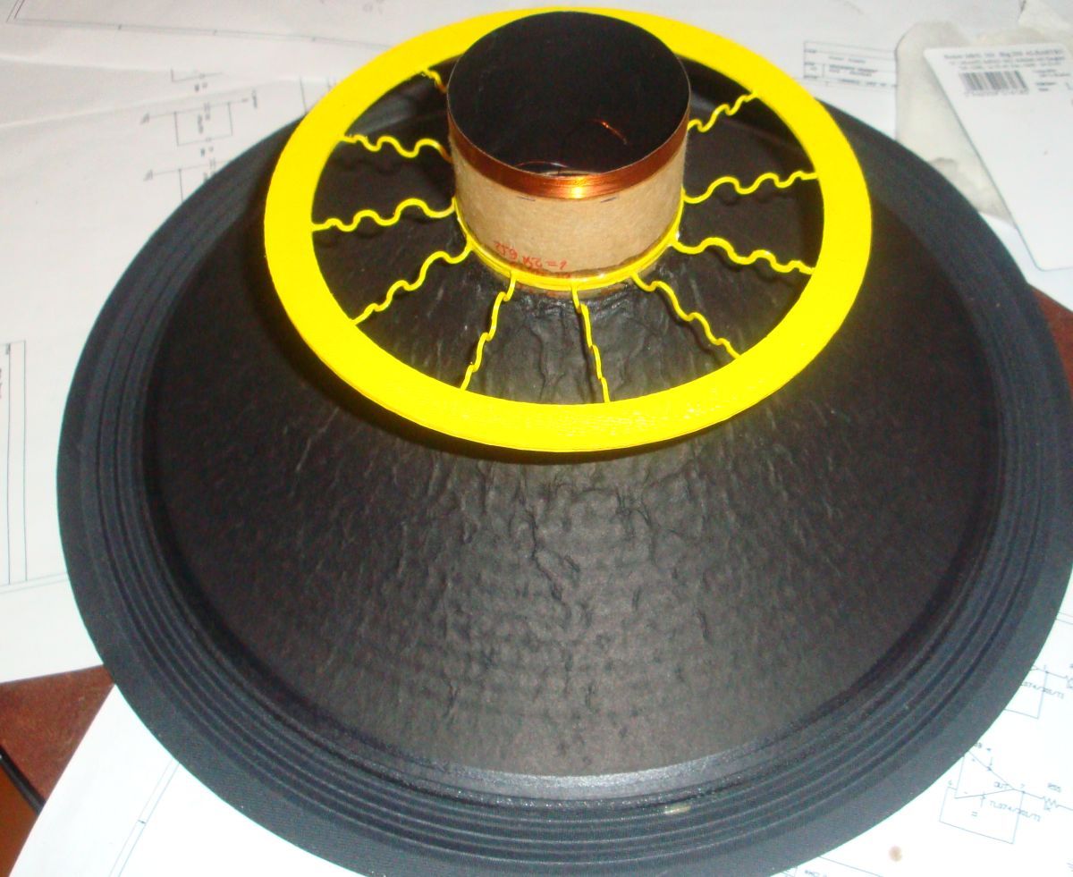

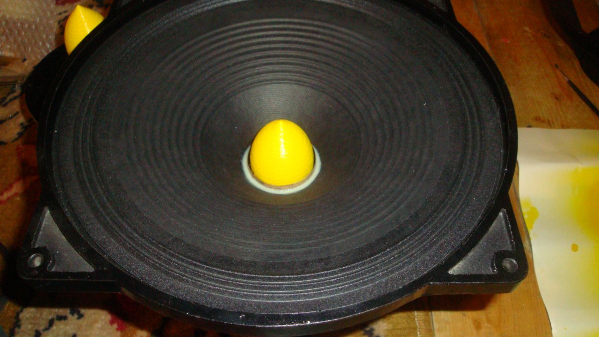

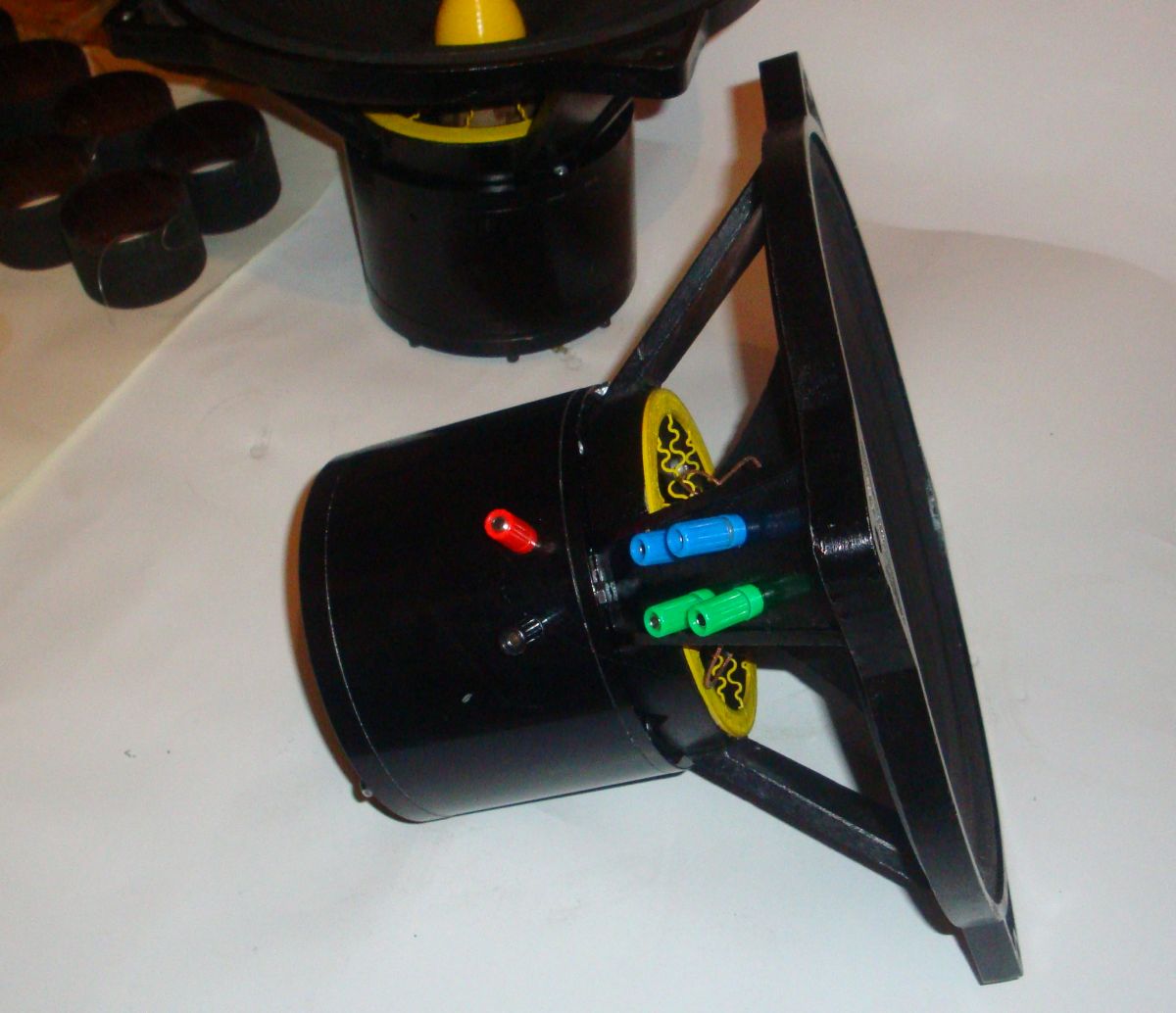

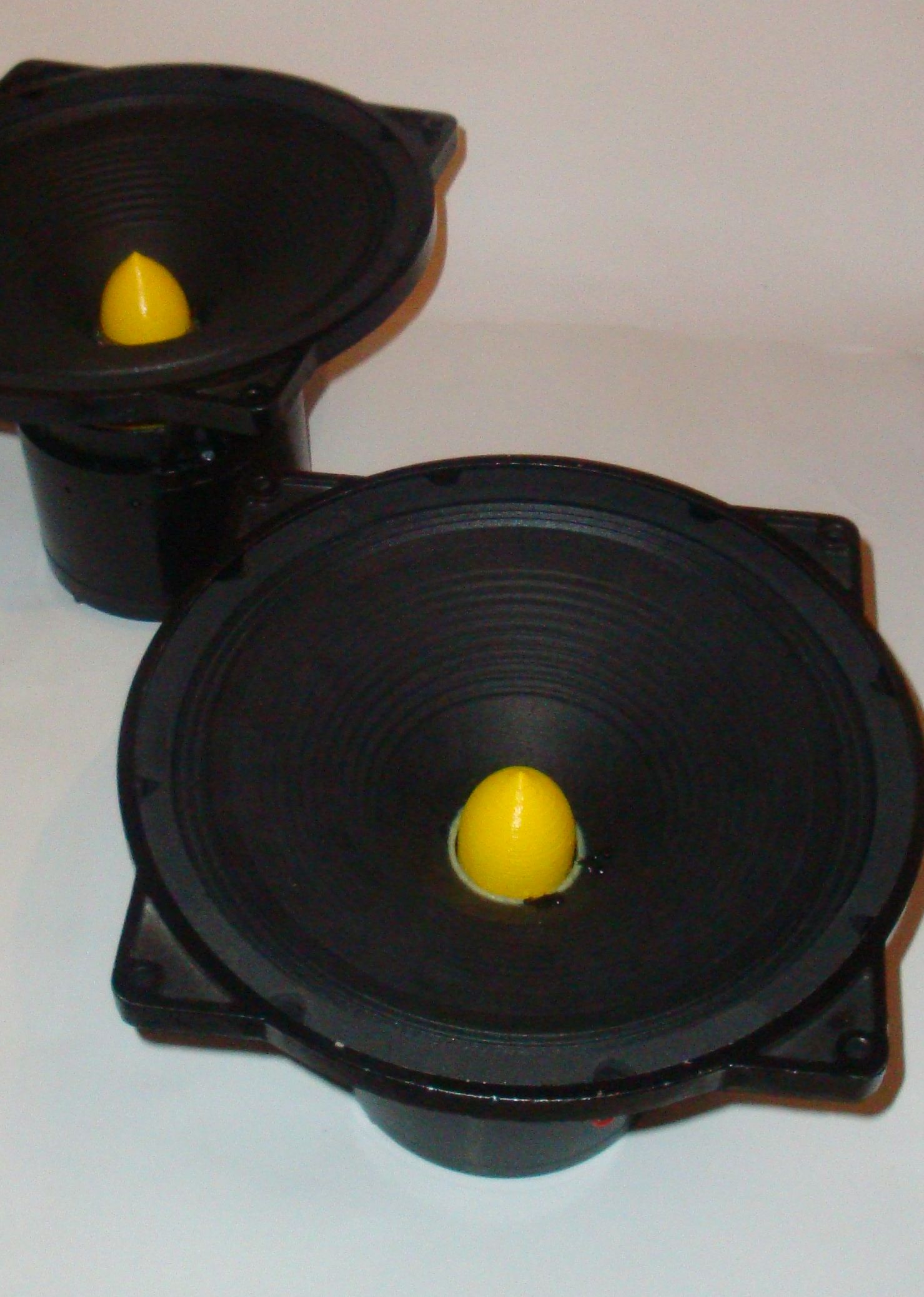

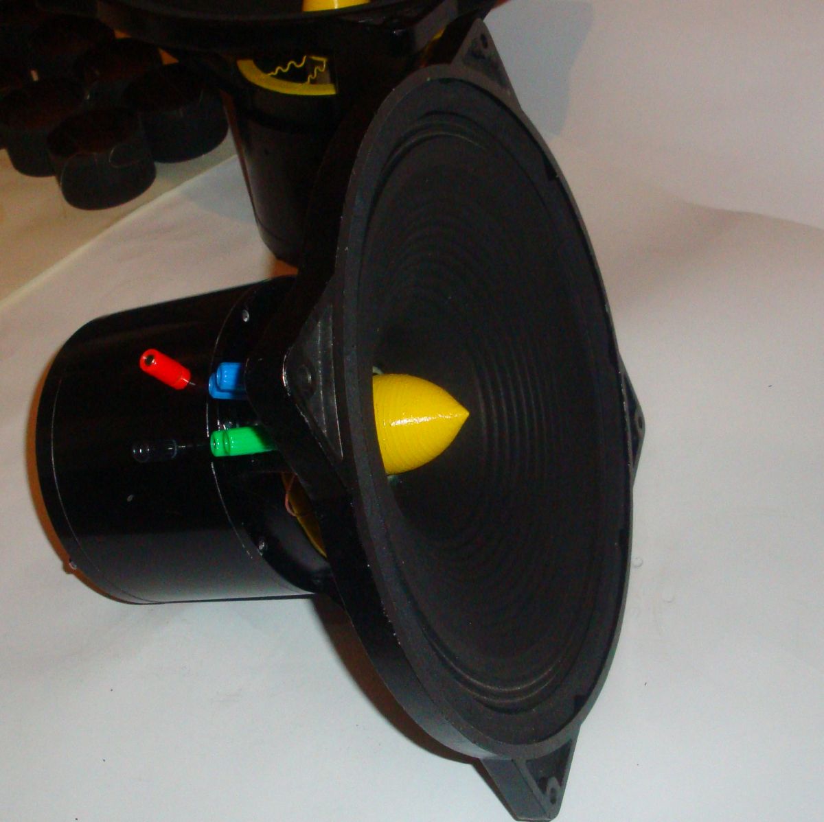

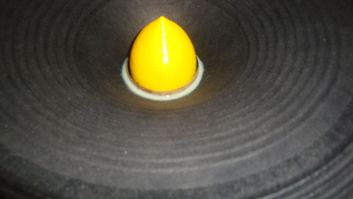

the mid-bass units are in tests
Features:
Field coil motor
2" bullet phase plug
Ryu spider
Dual voice coil
Measurements hopefully tomorrow.
