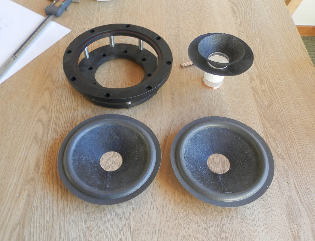

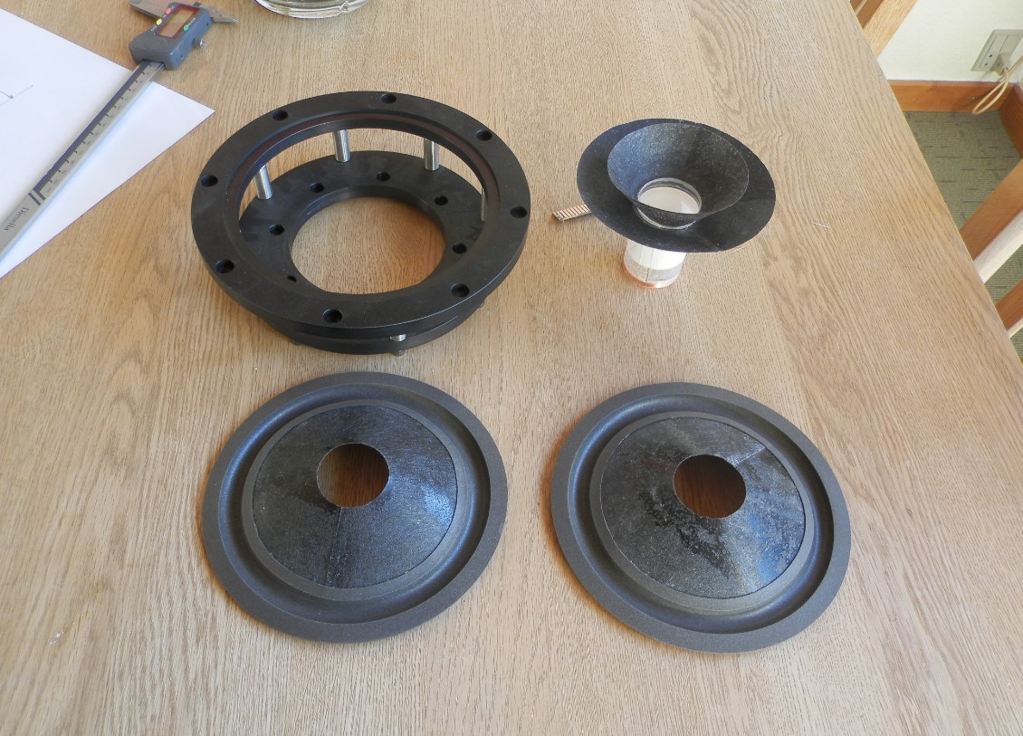

A little update on the project. I did mount a wizzer on the new cone, this made it less directional but there was to much output at high frequency. Without the wizzer it's sound more like lagers panel speakers in the high frequency range, it's like nothing is missing but it is more laid back in a nice way.. Dos this make any sense?
One thing I might try is to mount a centre dome, but this can bee done at a later time.. Here is some pictures.

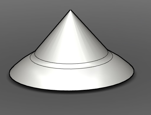

Hi Frank,
How about a vacuum formed hybrid one piece dustcap with this profile? Sort of a shallow dome with a ring radiator tip.
