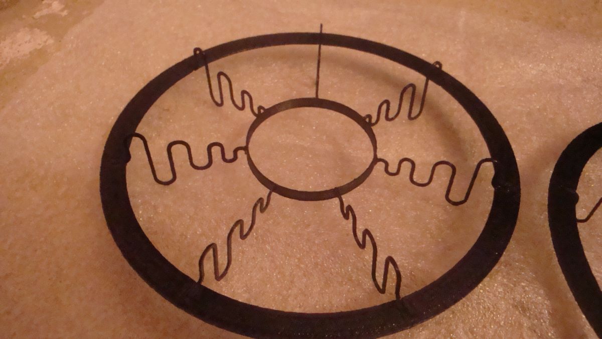

@ 454Casull, I did try out some other spiders, but I need a very high compliance to reach a low resonant frequency.

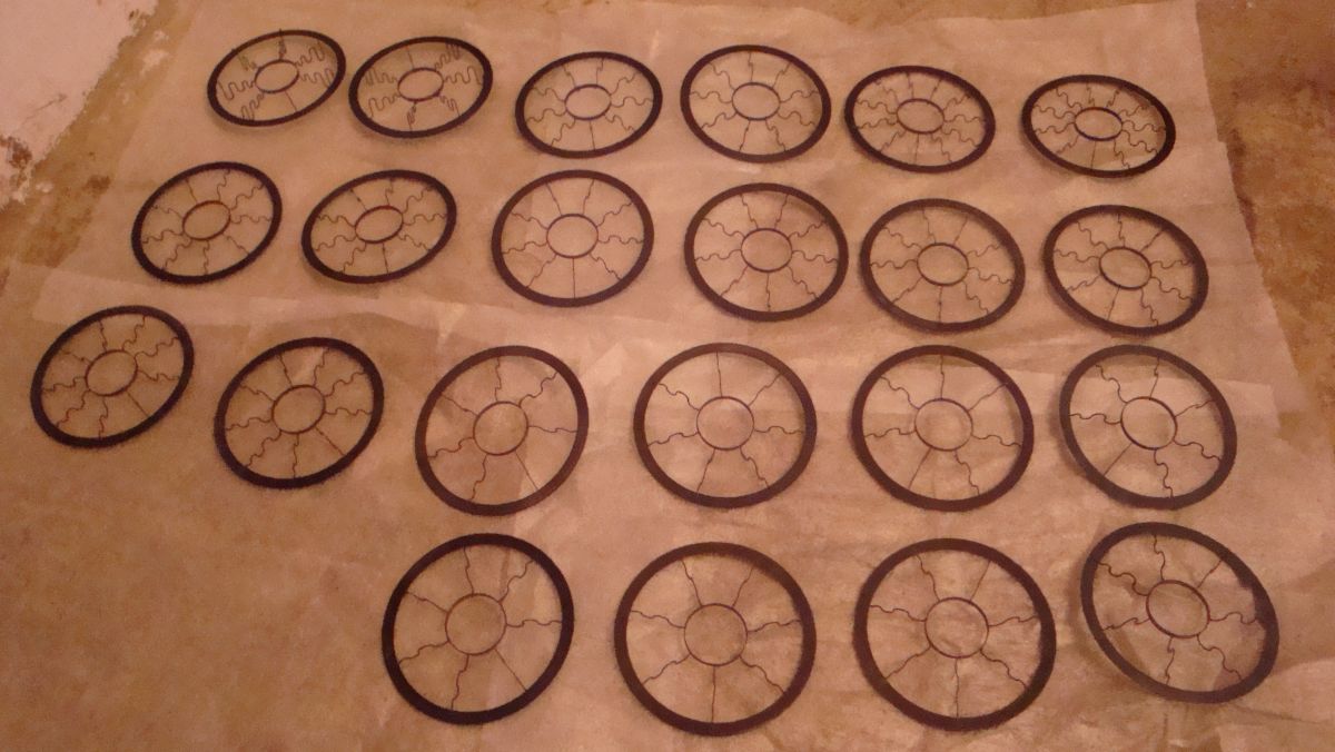

Ryu Spiders, you can see a high Xmax version in there.
Frank glad you like them.
The 6 yellow ones in the picture are Frank's.
Well i guess we could start a group buy if there is interest im up for it. Motors, Spiders, Phase plugs, Complete Units...
Who else would be interested in group buy?
If more are interested i will make a list of parts and cost.

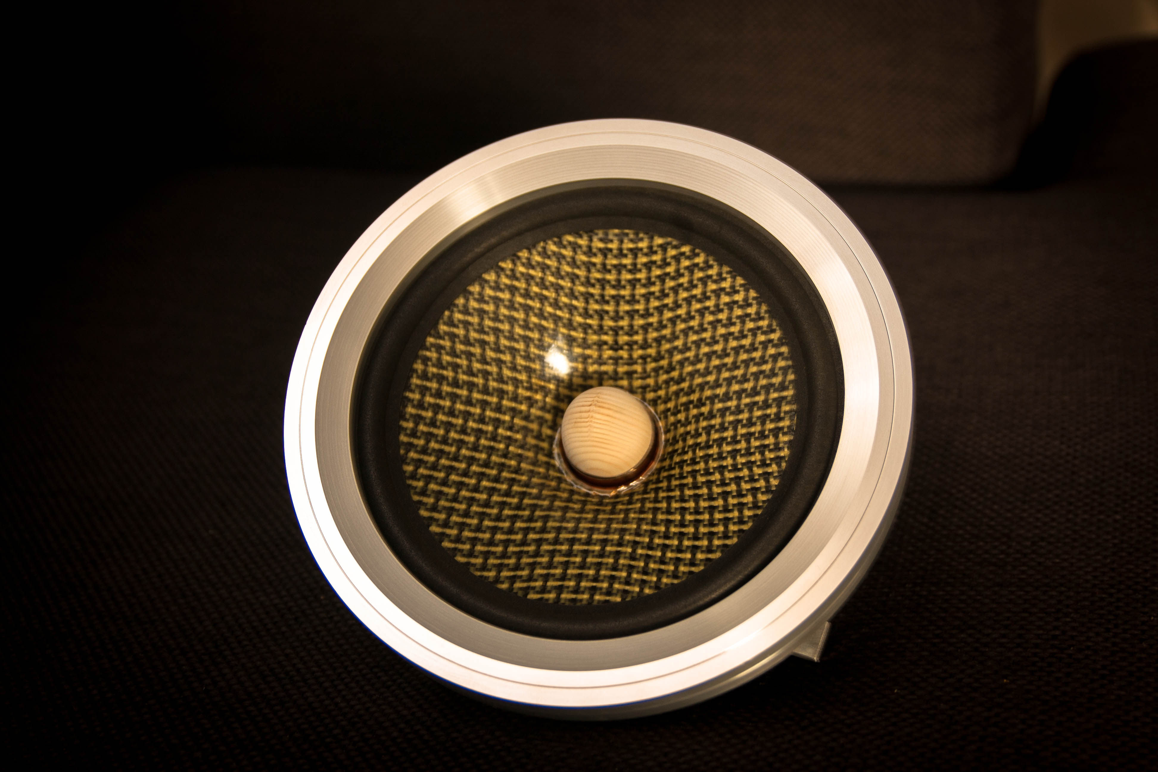

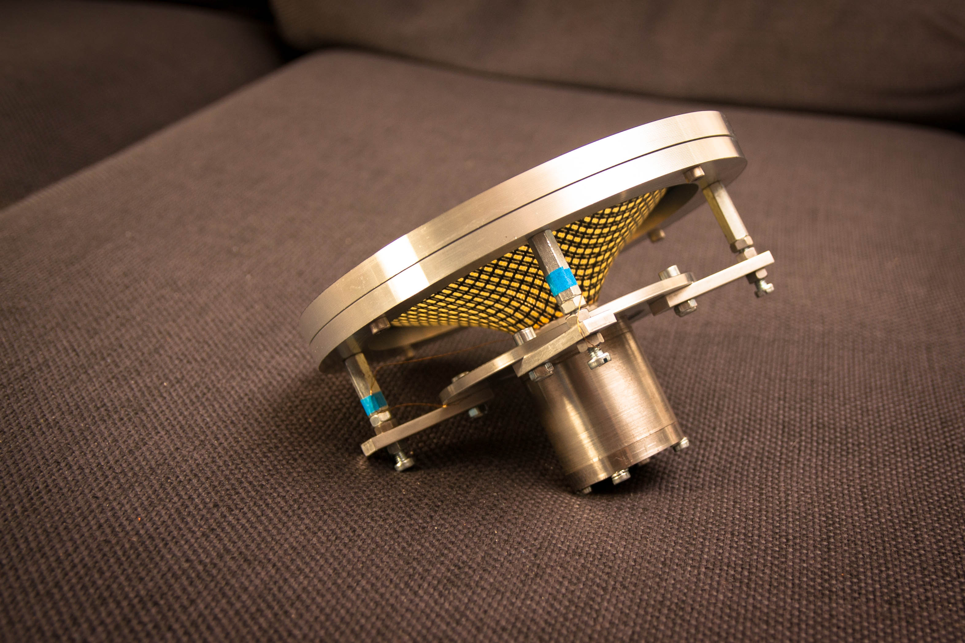

Hi Folks,
Some progress with the EM suspension speaker. (without spider)
Here are some pics of it. Did listen to it (open baffle) by ear but doesn't say much. Within a few weeks I send the specs of it. Question to Hentai, wich tool do you use for measuring the small thiel parameters? There are a few like woofer 2 pro or daytona but i want to test not only with small currents but also large. This is important to test the suspension on its whole range.
The basket is only for test purposes, it is possible to change the height and diameter for testing.
How do you insert tumbnails?
Take care,
@Frank Yes the speaker is fully functional and sounds good but paper cone is really on my wish list. First i tested with copper wire but it was to heavy because i have more then one winding. (oke no spider and within some time no surround so this is also weight reduction) but not good enough. The one I use right now is alu wire (parallel winding, wire 0.20mm) Re of 4.5ohm. What i already can tell is the good sensitivity, much better then my keff q75 speakers. B of the magnetic gap is 1.5T not bad and BL is 10NA. Xmax linair 8mm. Q, Fs, etc... I have to measure.

Awesome speaker Jef. Congrats.
Pretty good bass i get from the video. Nice.
T/S i use WT3 and/or LIMP. With the later you can use a power amp for higher current but you need to make a little test rig. WT3 is very fast to get a impedance curve tho.
