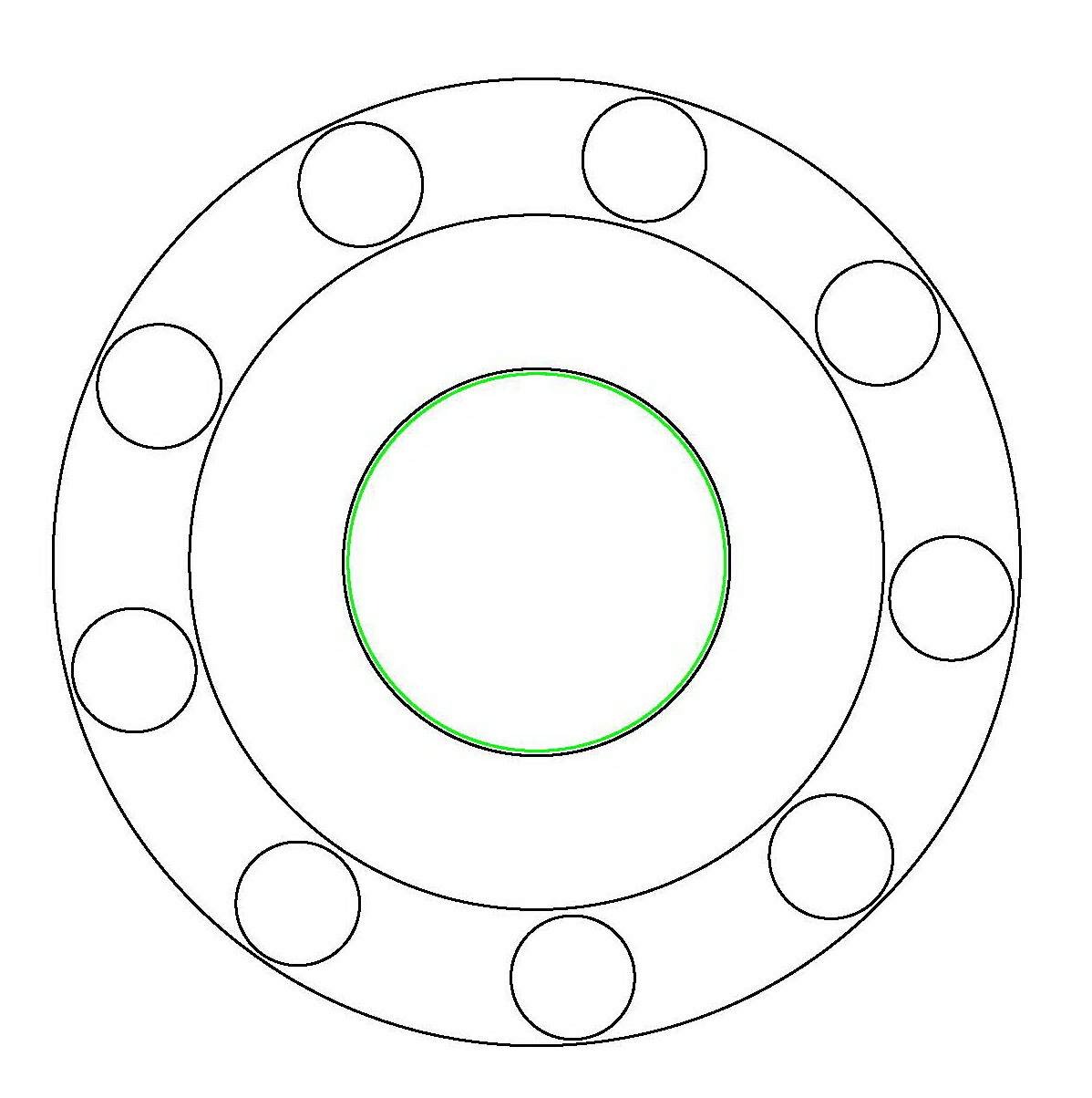

i 'm planing a 15" driver want to use field coil motor. but i don't know how to use FEMM to simulate. so i have to spend time to learn this thread from beginning first.
basically for the material and the structure of the motor i have two questions:
1. do i need lathe all the parts of field coil motor by the material i linked above? or i just need to lathe the pole piece to reduce the total cost? (the above material is more expensive than SAE1008 or SAE1010 steel)
2. from your design i can see the copper coil sealed in a sae1010 material can. because i need a more powerful motor to drive a 15" cone. maybe the current is over 3A. so is the open frame better for the heat radiation? (the driver will be installed in a bass reflex box). the picture is my thinking.
thanks in advance for your kind help!
Jason

Hi Jason,
You don't need to use that Armco for all parts, just around the magnetic gap. You can use 1010 for the rest.
Open frame is better for heat radiation.
Please refer to an article i wrote a while back about how to size your parts:
PROJECT RYU Sizing Steel Parts for Field Coil Loudspeaker Motors
What voice coil diameter you have in mind?

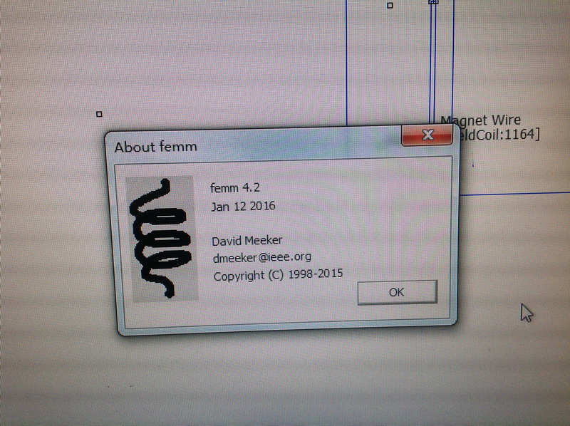

Hi Hentai,
i just downloaded your script and FEMM 4.2. after i run the script and input parameters there is a error message. it means there is no default block material. i don't know where i can setup the default block material or has to setup that in script? please see the pictures.
thanks!

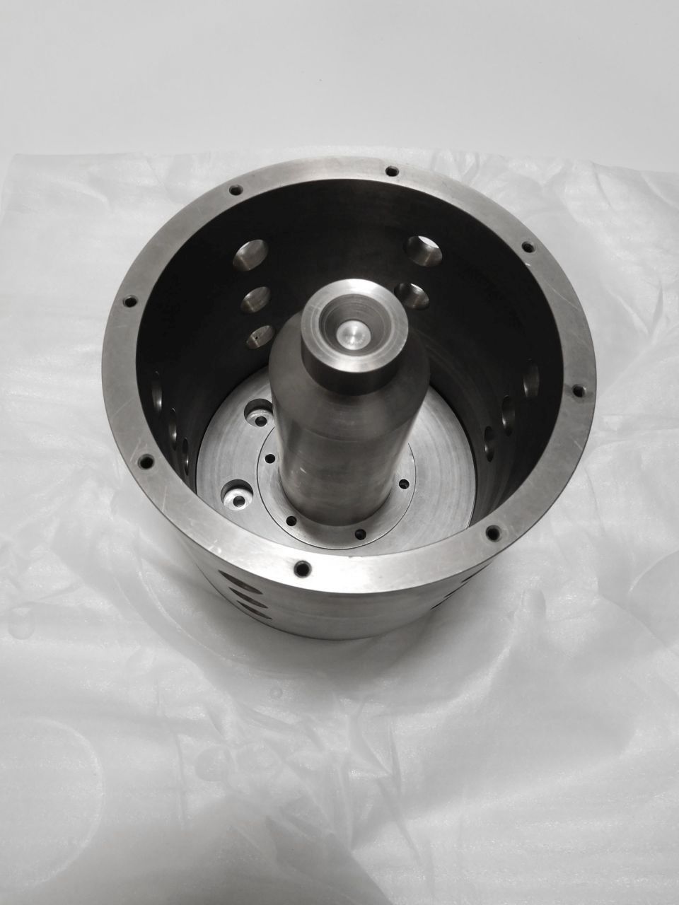

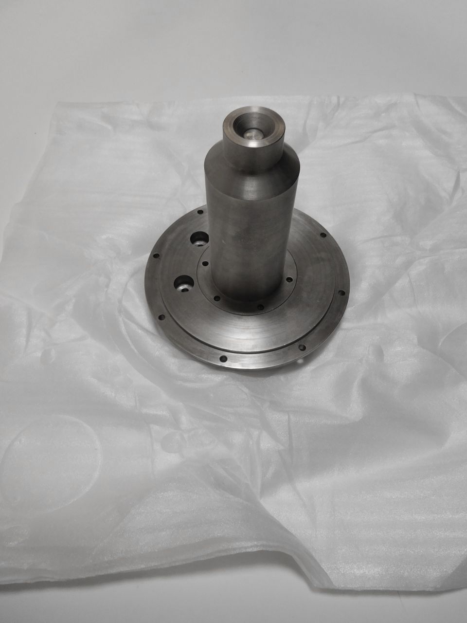

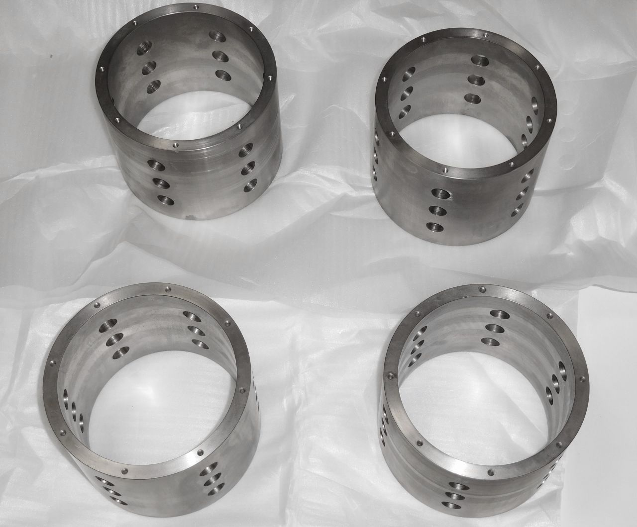

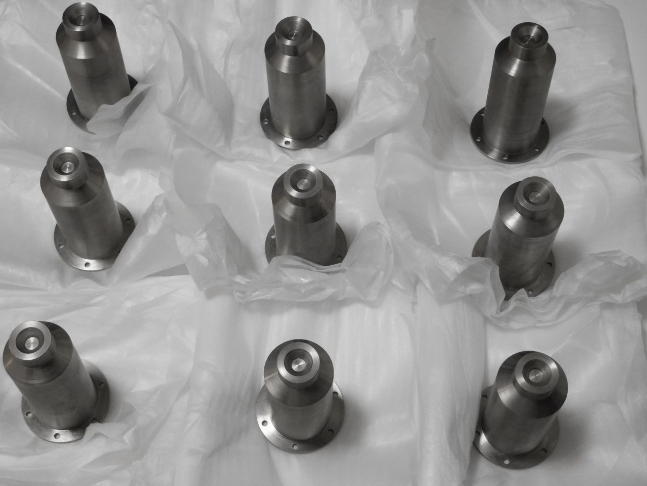

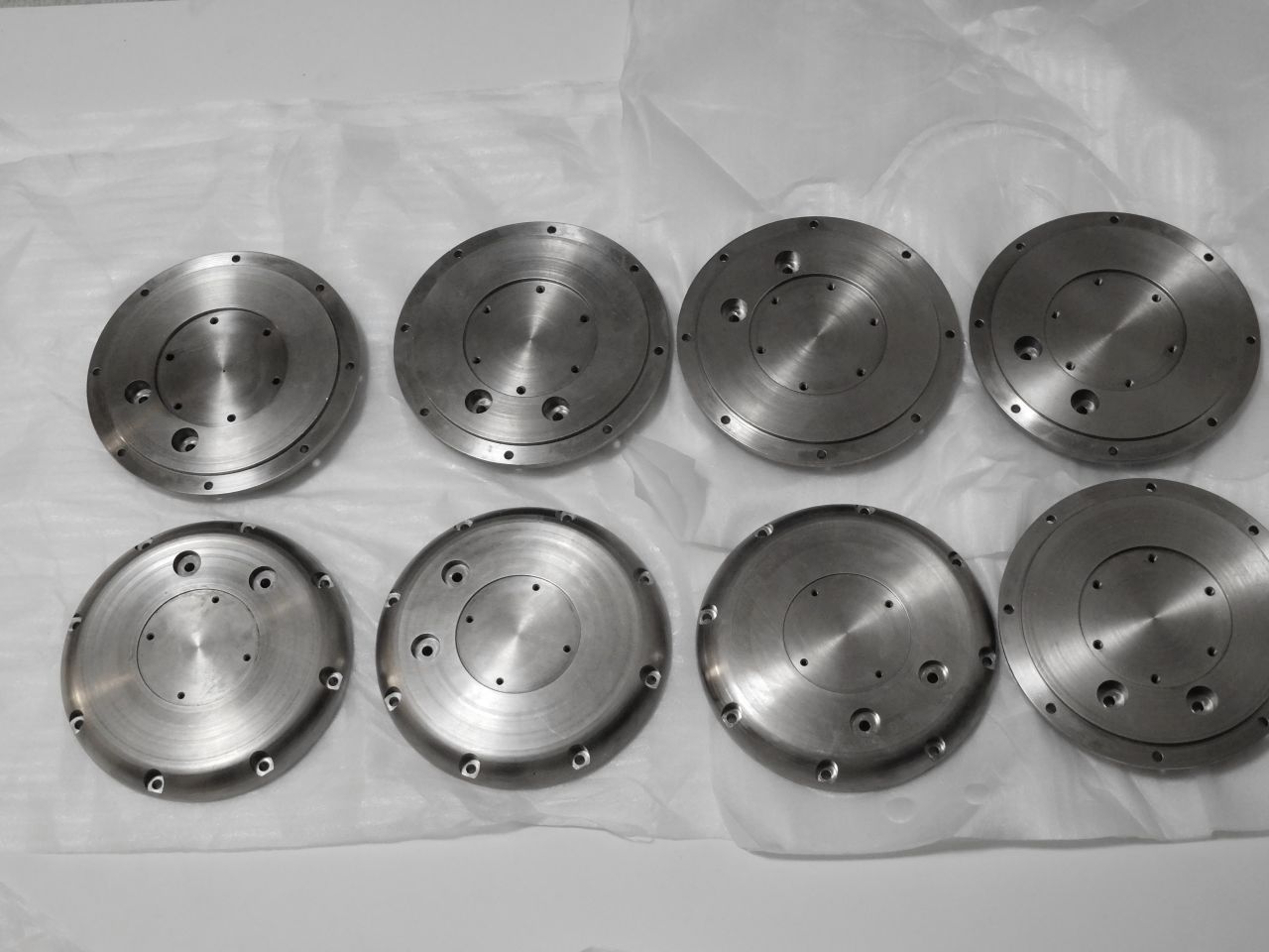

I uploaded drawings for a new motor, F144. It will fit a 31mm voice coil, so this time a smaller voice coil for lower weight and for higher frequency extension.
Will start soon winding the fieldcoil and will update the project with fieldcoil data.
You can get 2D and 3D files at the link below:
https://github.com/Taur-Tech/Project-Ryu---Loudspeaker-Drivers/tree/master/Drivers/F144
Some pics of machined F144 pole pieces. Very exciting!

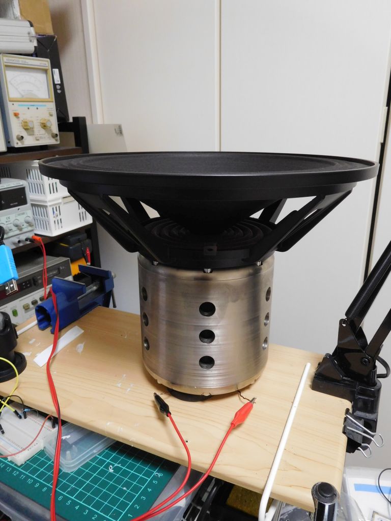

Getting ready to test the next drivers.
Absolutely beautiful work, Hentai, as always - really looking forward to seeing your measurements and results. If you don't mind sharing, I'm likewise curious about the sets of holes around the periphery of the casing, and would love to know what they do for your design.
